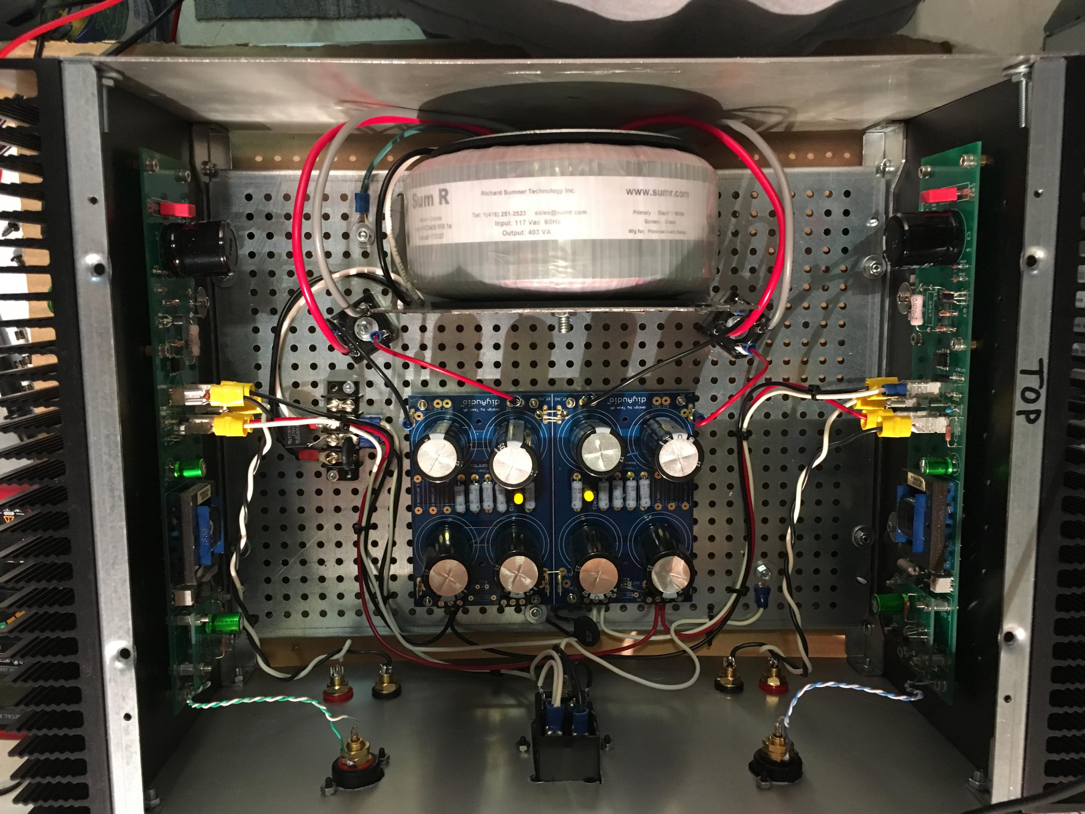

Hi Batty, yes the psu pcb from the shop can be used. Bridge rectifiers are ok to use, it’s actually what many of the builders here including myself have used. 15k uf caps x8 are good, as a matter of fact I believe that they are the size used in the stock First Watt amps and standard psu designed by Nelson Pass.
I would suggest that you read the entire M2 and M2x threads before your build your amp. Yes, it’s a lot of reading but they will answer pretty much all of your questions or issues you may encounter during your build, and may even offer some part substitutions or suggestions so you only need to order your parts once. Doing so for both my Aleph J and M2 builds made the whole process much easier and stress free.
As always if you have an questions someone will be more than happy to lend a hand. I was a noob once, and actually still consider myself one. Reading and re-reading the threads is a must for a successful build.
Here’s a pic of the M2x I just completed. You’ll see all of the parts you just inquired about.

Front panel looks good, saving the meters for later? How's the temp holding up with these sinks?
dB-
Sadly the meters didn't behave even with a little modification and I didn't have the staying power to put in the work/time needed to keep them. So went for clean front panel look.
The heatsinks sit at 52degC with 1.8amp bias. 18V rails.

While meters are cool, your clean front panel look worked out very well. A unique M2x with the small case and SMPS. Well done!
