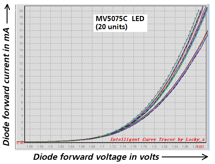

I just pulled twenty brand new MV5075C LEDs out of their shipping bag and put them on the curve tracer. These are the infamous "do not substitute" LEDs used in the bias network of the Mountain View daughterboard.
I don't exactly know why the data clusters in two groups with a gap between. Maybe it's just a coincidence, an artifact of examining too few (20) samples. Or maybe it's more sinister. I have no idea.
Hopefully this data is more useful than the min,max guaranteed never to exceed numbers on the datasheet.

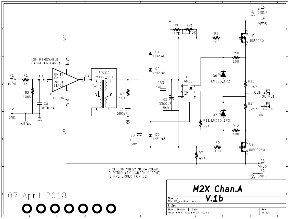

The amp was working perfectly with bias at 1.8A and offset adjusted to a stable 1mV. I built up the MtnView daughter board and tested that with an offboard power supply and it tested at what appeared to be normal. After I had pulled out the Norwood (which was sounding really great) and dropped in the MtnView the right channel came up with an offset of 500 to 800mV which I was only able to pull down to 180mV and it showed some sort of fluctuation - almost like it was oscillating. The LED on that MtnView was also flickering. I shut it down and swapped the daughter boards between channels and the right channel once again showed the same behavior but offset was now 800mV-1.2V. The bias seemed rock solid on both amp boards. It is really difficult to adjust offset - very little movement with adjusting the pot.
edit - left channel with the MtnView board that had been flickering is rock solid with 1mV offset.
I checked all connectors - all making good contact, I reflowed all the solder points on the affected board to make sure something spurious had not developed coincidentally.
My suspicion is that the little trimmer is not adjusting as it should but before I replace it, I was wondering if there is anything else that I should be looking for?

If the little trimmer on the amplifier main channel board ("RV1" on schematic) has indeed failed, and if that is the cause of misbehaviors you are observing,
then the misbehaviors are expected to continue with ALL daughter cards. Even with the Norwood cards. Even when you swap the two Mountain View cards (left swapped with right).
On the other hand, if there is a problem with one of the two Mountain View cards, and no problem with the amplifier main channel boards: we would expect to see misbehavior when that one particular Mountain View board is installed, and no misbehavior when it is replaced.

yes - I didn't detail that little part of my experimenting - when I put the Norwood back into the faulty amp board, I was again seeing large amounts of dc offset which could not be adjusted on the impacted amp board.
The problem does not follow any particular daughter card as they all work normally in the still functioning amp board.
Thus my assumption that something on the amp board itself was causing problems. As it biases normally I would work on the premise that the biasing components and the output devices are not at fault and that leaves the trimmer RV1 as the most likely element.
I did try and measure the effective resistant while in the circuit and after many many turns, it does change the total resistance a little but nowhere near what I would expect - I just have little trust measuring resistance when still in the circuit
I will get a replacement ordered and try that

Yes it sounds like the problem is with the one main amplifier board and not with any of the daughter cards.
After you remove the board from the heatsink, you can use your multimeter on "buzz" continuity test, to see whether each end of R6 connects where it should, to see whether each end of R7 connects where it should, to see whether each terminal of RV1 connects where it should. Example probing ideas attached.
You could touch one of your continuity tester probes to the metal lead wire on the body of R6 {not the PCB trace, the actual lead of the resistor itself} and touch the other probe to the VCC bolt of the daughter card mount. If R6 is correctly soldered and if the PCB copper is intact, you tester should say: Yes, Continuous.
Test both pins of R6, both pins of R7 (one way to test its top pin is shown in blue), all three pins of RV1, and pins 4&5 of the optoisolator. Prove to yourself it's connected the way it should be.
edited- don't forget to buy the same resistance value on the new trimmer, as on the old. If your board has (R6=47K, RV1=5K) then get another 5K trimmer. If your board has (R6=37K, RV1=20K) then get another 20K trimmer.

thanks will check this out - and yes, I am using the 37K / 20K combination.
I switched the optoisolator between amp boards and they seem to work , so device is operational. I did have to double check the orientation.
