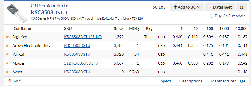

can I use 2SD669A in mountain view?
I don't know; I've never tried it myself. Doing a quick search on Octopart.com, I see that no American distributors sell the 2SD669A. Nobody here can buy one, including me.
A couple of places that specialize in obsolete, new-old-stock transistors seem to have 2SD669As to sell, for quite high prices. On the other hand, the NPN transistor called for in the Mountain View BOM and Mountain View schematic, is relatively cheap, and available from several sources; see Octopart.com results below.
Maybe you will bravely try the 2SD669A yourself, and report your findings here?

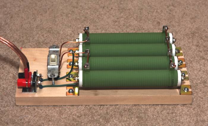

Connect a dummy load resistor rated for at least 25 watts
Ha- I can almost here ZM now: "Those are sissy power resistors..." 😉
Check out MPJA for a nice assortment of power resistors.
Two of these in parallel are good for 8R at 240w and four in parallel provides an 4R load rated for 480w. Install a regular wall switch in the middle and now you can change resistance load with ease!

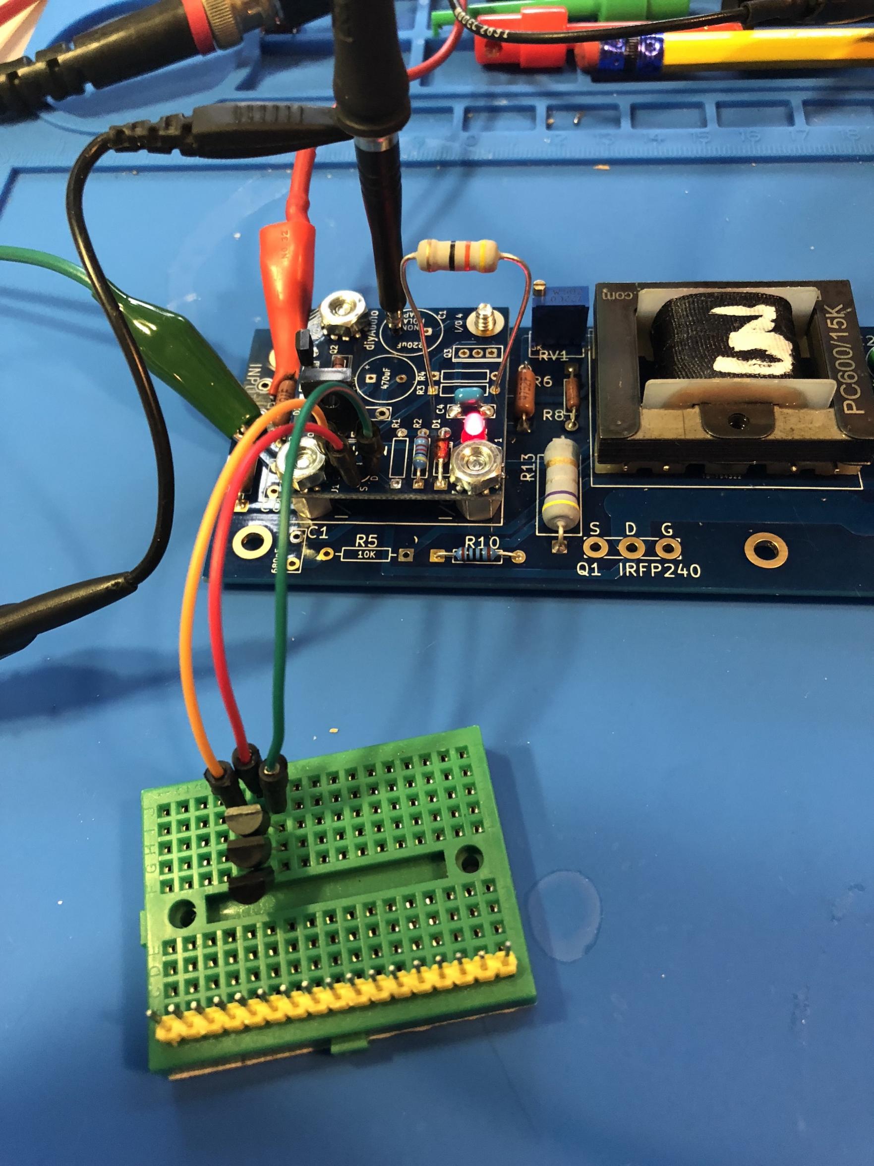

Back in post 432, Mark posted a fill-in the blank schematic for the Moffet Field. I've built a 24 mA version (pic below) but I'm shooting for 30 mA with another set of JFETs (J112). The zener D2 has been replaced with a ZTX450 npn, which I might or might not keep. I chose it mostly because it was small and had ebc pinout. I'll post a schematic and some data later after I'm sure it won't self-destruct.
