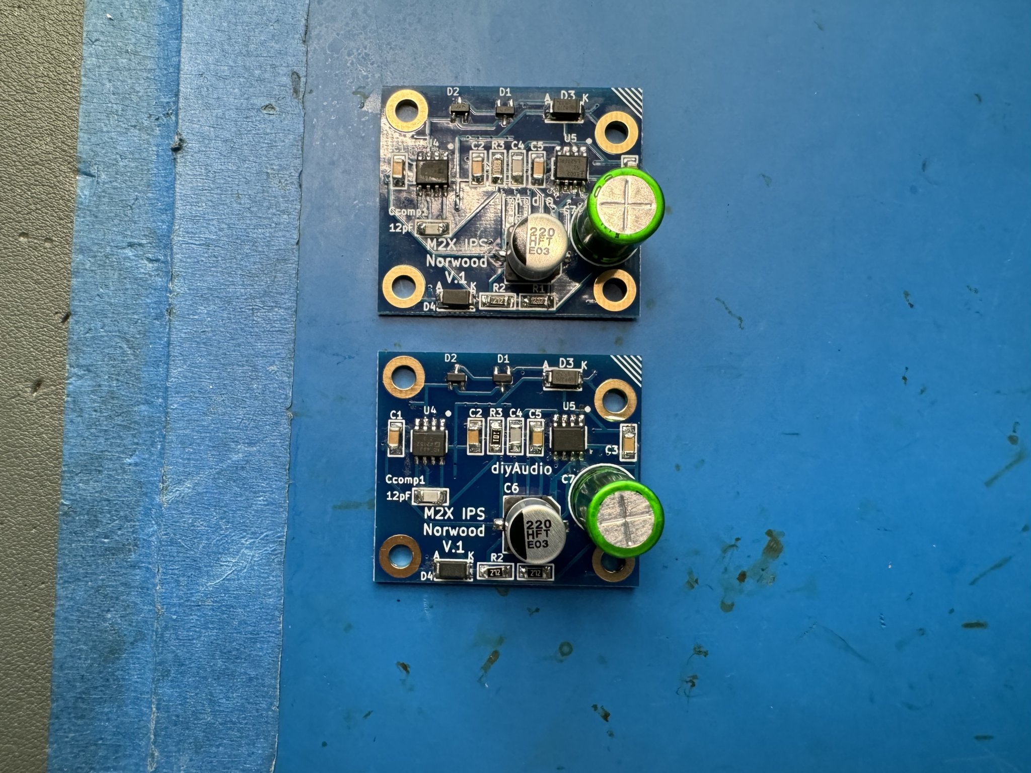

Made it through Norwood successfully but I still have a preamp board that was my first attempt at SMD and didnt end so well. Open to all pointers I can get!

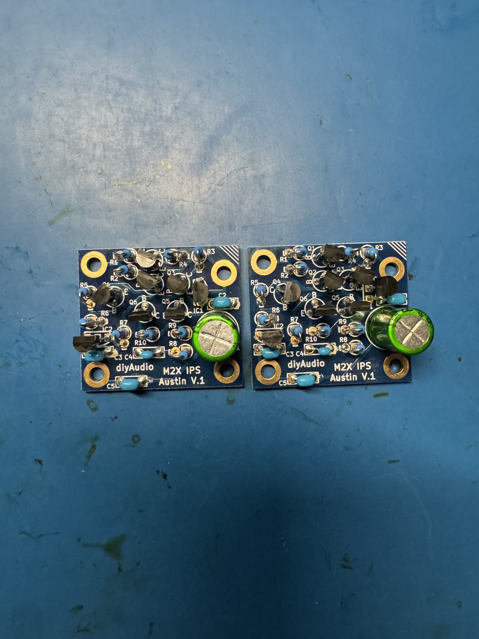

I've built out the Ishikawa, sounds as I would expect, from a Nelson Pass design front end, smooth. Put together the Austin, which is the one I'm staying with for now. It sounds clean, clear, no muddy bass or ringing highs - really like the music it makes. I'm with for the boards for the Milpitas, and have parts for the Norwood.

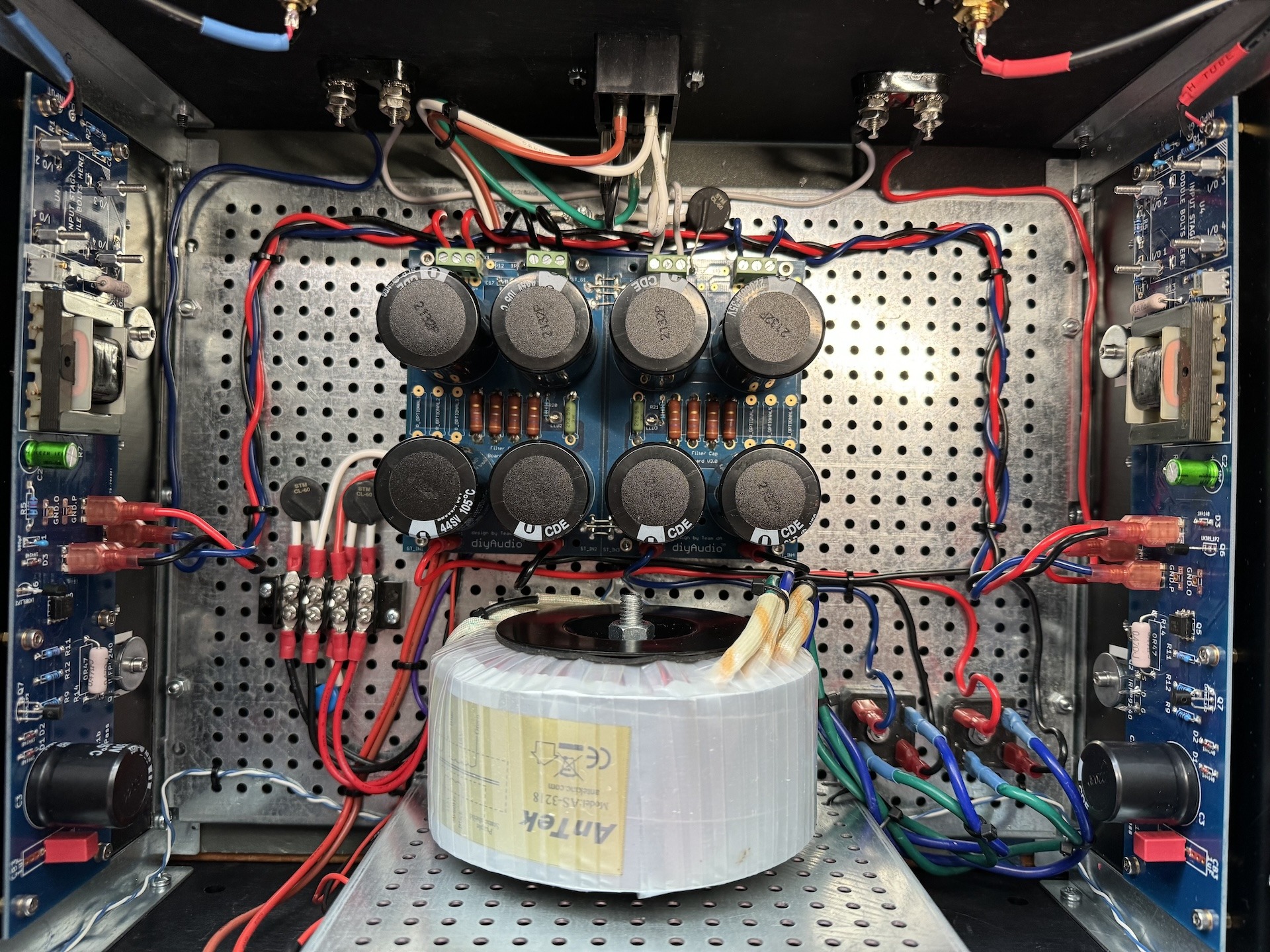

Here's pics of the main board ready to make some music.

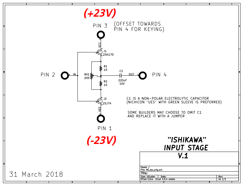

What rails should we expect for the Toshiba Jfet version? A diyer has asked management what
Idss is preferred there.
The M2x input stage card called "Ishikawa", which is included in every set of M2x boards sold by the diyAudio Store, is a direct and slavish copy of the First Watt M2's input circuitry, as exhibited in the Official M2 Schematic (link) posted in October 2015. Because the First Watt M2 used ±23 volt DC supply rails, the M2x does too. And so does M2x's input card named Ishikawa. Similarly, the First Watt M2 uses Toshiba K170/J74 JFETs, and M2x Ishikawa does too.
I've attached an annotated schematic diagram below. Hope that's what you mean by "Toshiba JFET version".

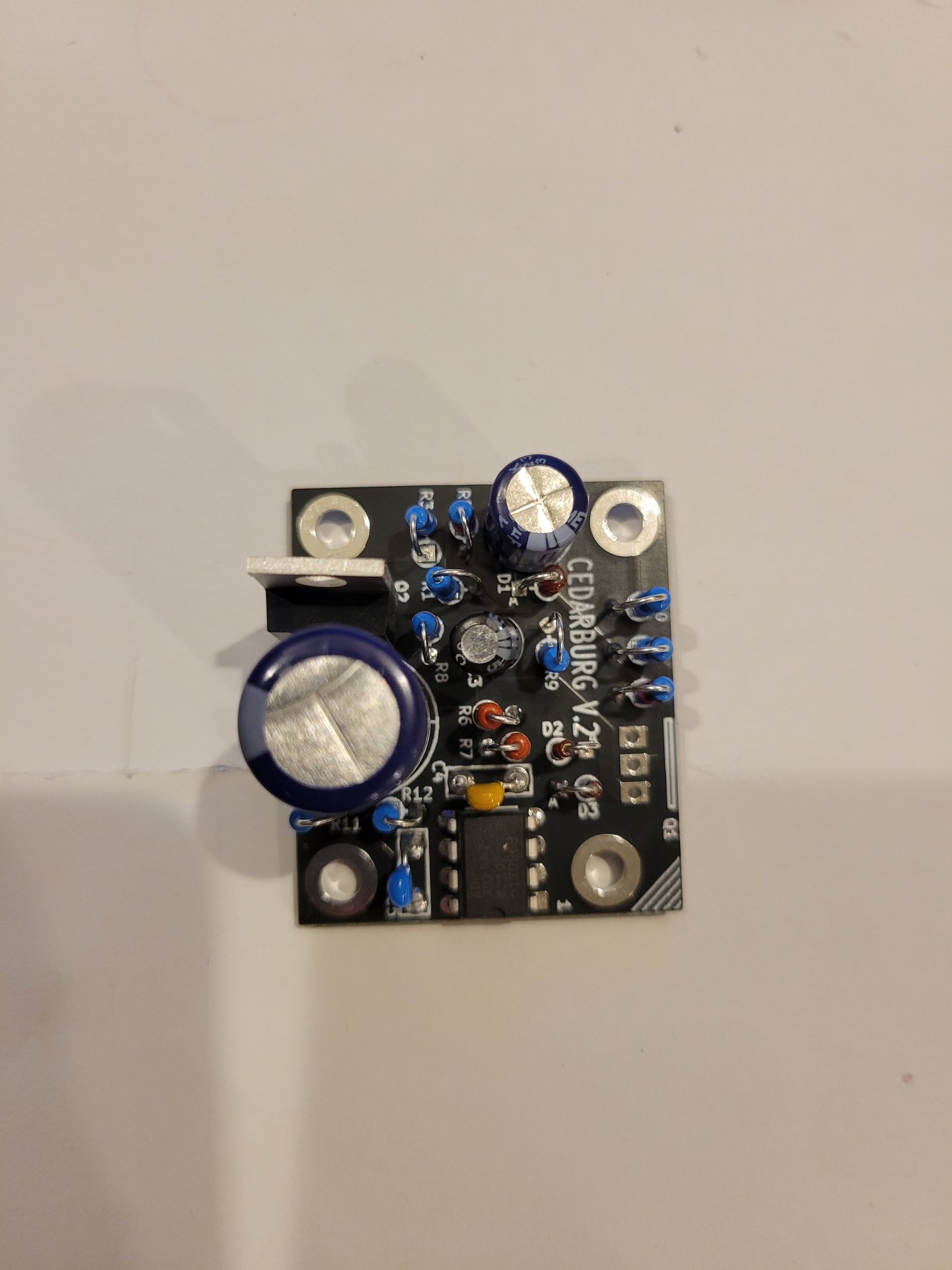

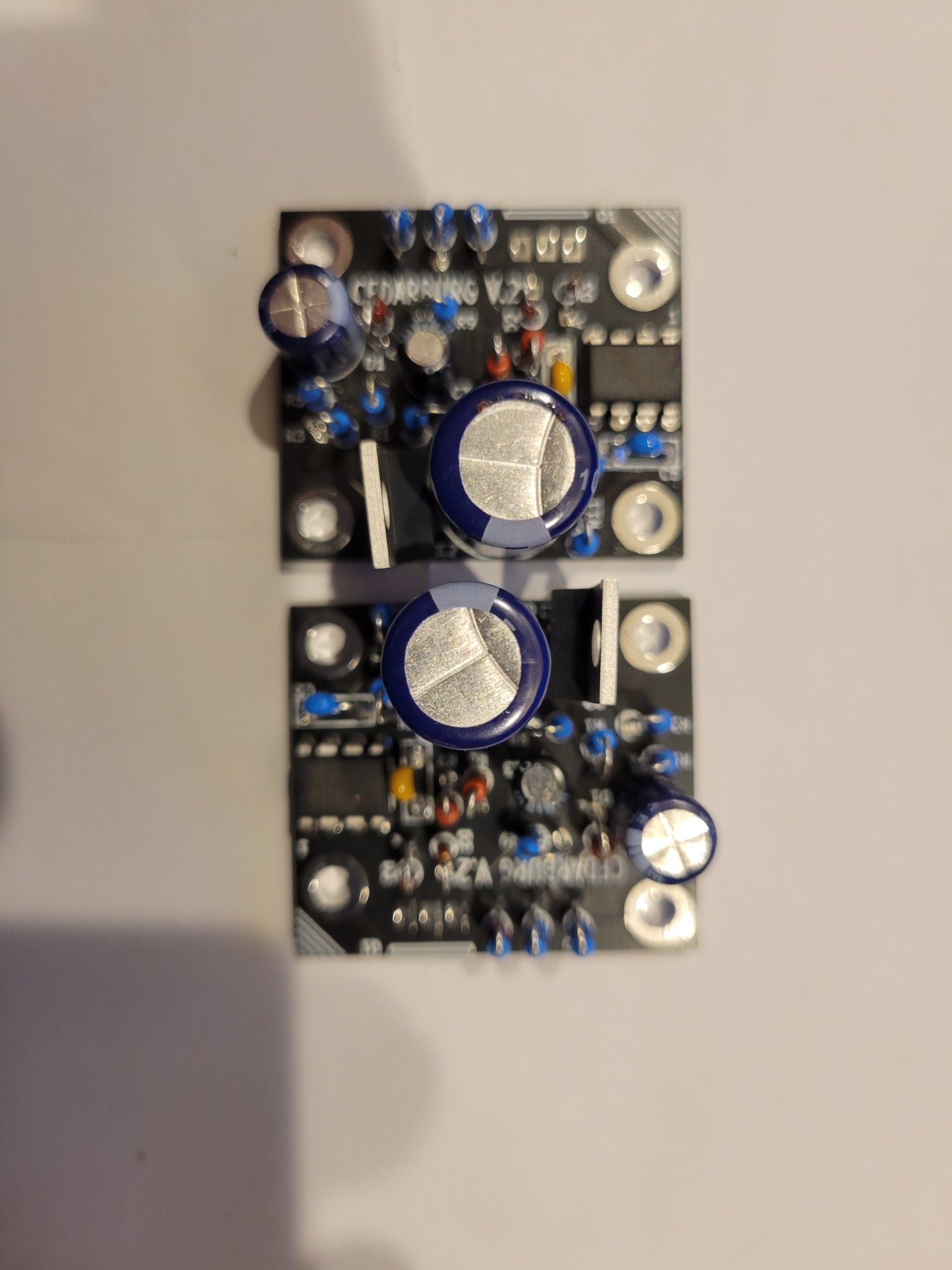

Cedarburg boards are stuffed, minus Q1, which was backordered at both Mouser and Digikey. They should be arriving in about a week. As I post these photos, I notice I have one R3 "backwards." Will OCD force me to swap it?

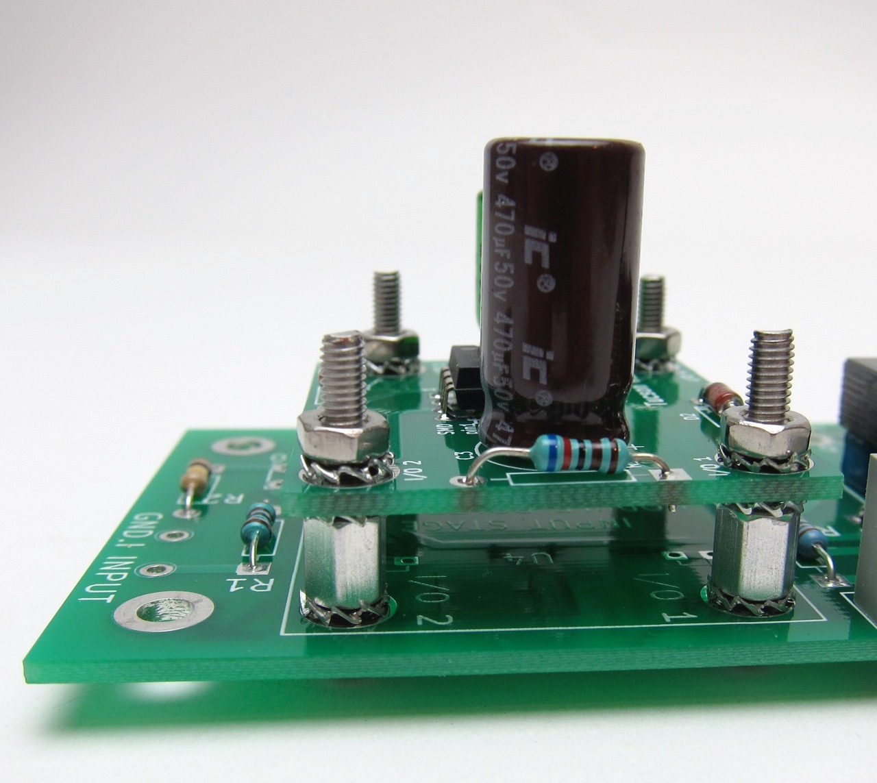

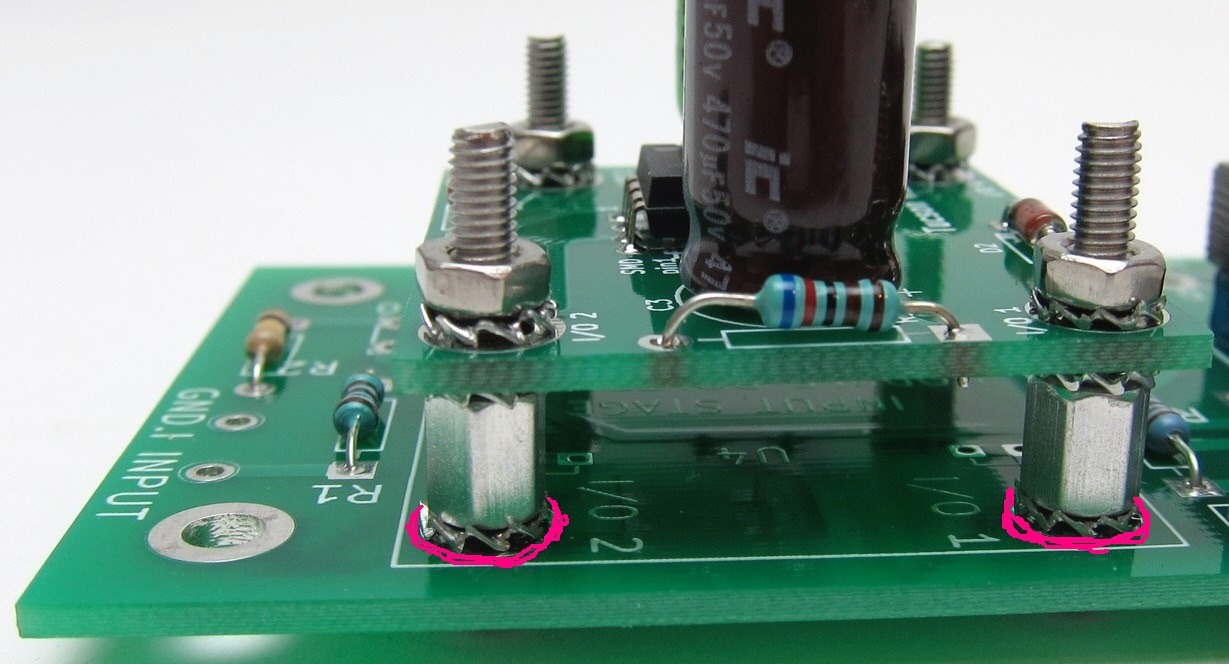

Have encountered a challenge I need some helpfuil input on. Each time I take an IPS off the screws washer and spacer nut loosen and Ive had to take the board off the heat sink and tighten everything from the bottom.
Am I tighten the top module to tight, yes subjective question?
Is this typical?
Will something like thread locker help?
I'm also worried that I'm goin to crack the main board by over tightening the cards.

Secure the cards exactly as shown.
(Which is to say, use all of the star washers, in the prescribed locations. Yes, it's a lot of them, but the point is for it to be secure with minimal stresses and without excessive torque.))

After the bolts and the first set of hex threaded spacers are installed, you could think about applying some liquid adhesive or paint, whose purpose is to seal the spacers to the motherboard. If you like pink nail polish for example, here's an idea. On the other hand you might have a royal pain in the axx if, some day in the future, you decide to disassemble the motherboard and remove the polish.
