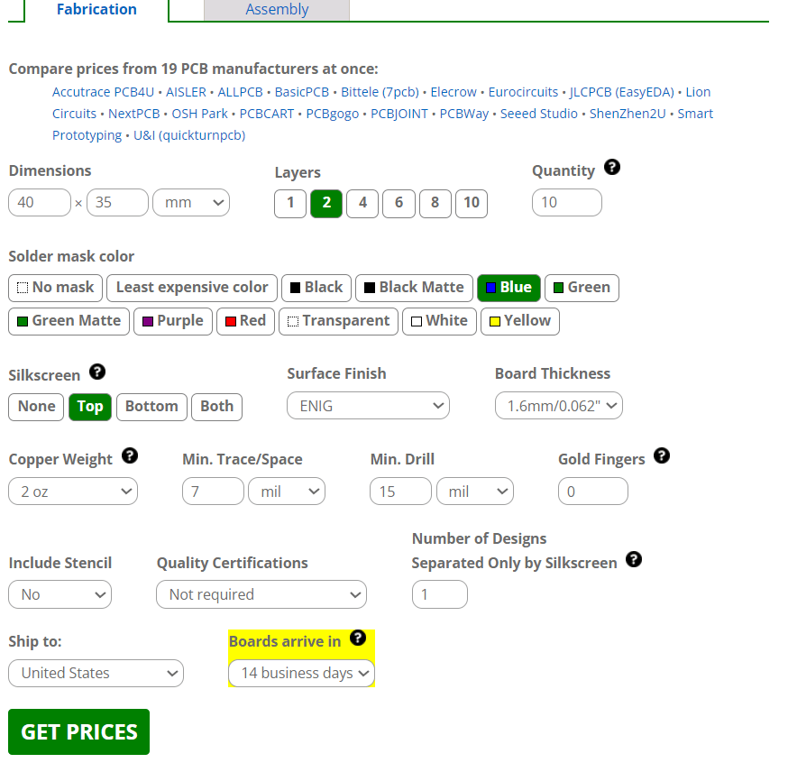

Milpitas is a thru-hole-only upgrade of the Norwood card ... Milpitas intentionally uses readily available, on-the-shelf-today ICs, arranged in the same general topology/architecture as Norwood.
The PCB Gerber files for board fab are attached below. I recommend you use the price quotation service www.pcbshopper.com to get an idea of PCB cost, for your ship-to address in your country. Milpitas is 40x35mm, two layers, and I suggest you get quotes for 11 business days shipping, as that seems to be the sweet spot of price versus delivery delay. Then you can refine the quotes after getting initial ballpark estimates, to see how much extra you must pay to get faster shipping. Or to see how much you can save by accepting an extra week of delay.
I already had a Mouser order tee'd up so just added the Milpitas parts to the mix. They've already arrived. All that remains is ordering the boards.
This will be my first time ordering PCBs this way so please pardon the noob questions 🙂
I'm not particularly concerned with when they finally arrive or sensitive to cost; more that I place the right order for boards comparable to the DIYA store ( or perhaps Broskie GlassWare ), which are as pretty as they are durable and forgiving if cleaning up a mistake. But, I have no idea what attributes make them that way.
Any other features I should be concerned with, or add, to accomplish that? What surface finish is best for this application? Thickness?
Have a look at this little tutorial, I think it may resolve all your doubts
Ordering PCBs online (using Gerber files): A walkthrough. --- featuring the fab "JLCPCB"
