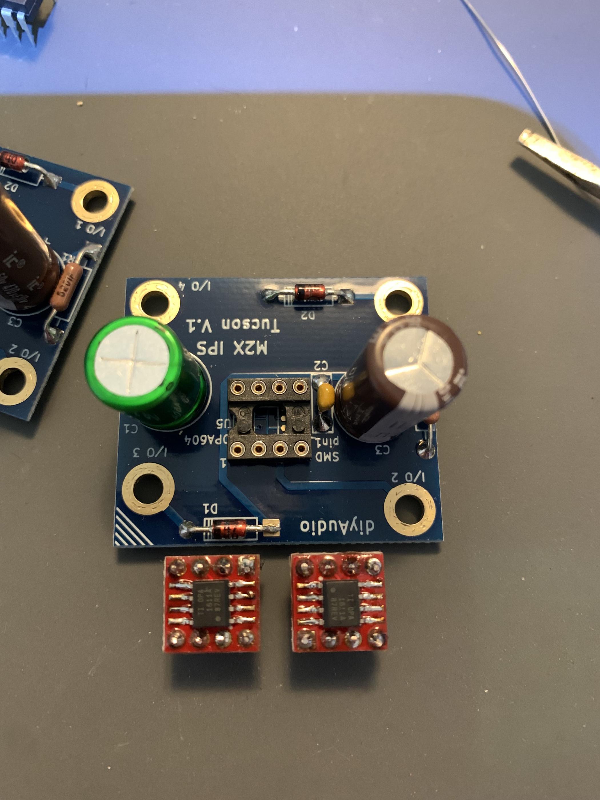

question about sparkfun adapter
Does the sparkfun adapter turn the smd 180º from the way it would solder directly to the board? The one on the right in the photo has the square pads lined up. I finally got around to putting these adapters together with the opa1611 and this is confusing me. I've tried Austin, Cedarberg, and Tucson with the opa604 and lt1122, now I want to try the opa1611. I wish we could buy these daughter cards in individual pairs, somehow I lost one Norwood board. I'm currently enjoying my F6 (led bias mod and IRFP150) now that it's cooling off here in Austin.

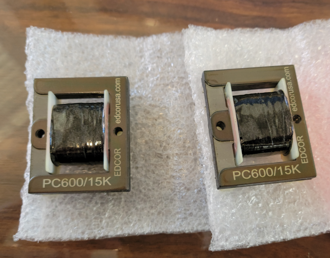

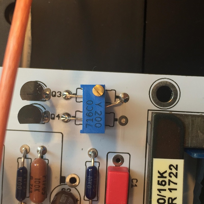

I have a question about the Ishikawa card.
I tried to bypass C1 but had a few mV offsets.
This can be reduced on the M2 Tea-Bag's PCB by installing a 20R pot as shown in the picture.
Can the same be done on the Ishikawa card by installing RV1 = 20R instead of R1 and R2? Then set 0r on the Edcor input?

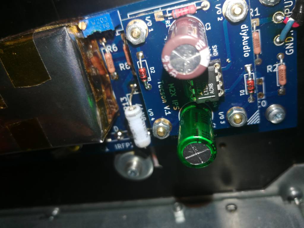

I had the Mountain View card for half a year. Yesterday I launched M2x with Tucson. The first thing I had to do was set the offset. It was 120mV. It floats definitely more, but I managed to set it to +/- 5mV. The opamp is LT 1122. I am a bit worried about the high temperature of the opamp because it burns my fingers quite quickly. The listening comparison is not ready yet.I have a question about the Ishikawa card.

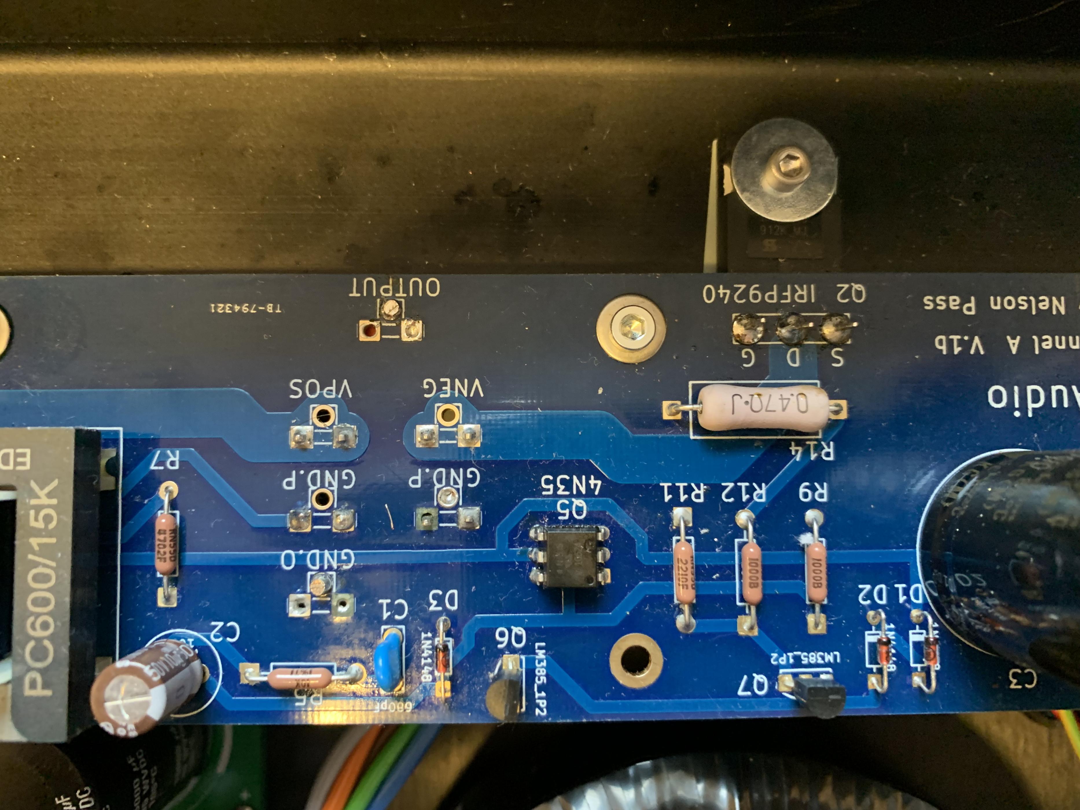

Hello All,
I just finally got around to finishing up on my MX2 build. But I have an issue with one of the channels.
I have about .744v dc present at pin4 and R5 on channel A and this is not present on the other working channel. I am a bit lost where to go from here to locate the issue. This is also present with the daughter card(s) removed.
so far:
R13, R14 - 0.630v
offset - 0.0v
PS - 22.5v +/- on both rails
Sound does come out of this "bad" channel but its not good or even close to the other channel in volume or quality.
Thanks in advance to anyone that can help point me in the right direction.

Yes I did swap the cards between channels and they work on the good channel B and the same issue is present on channel A.
Ishikawa - W/ Toshiba jfets from the diyaudio store
and thank you for the quick reply.
Quick note: I am using a T style heatsink and the connectors have been moved to the underside of the board

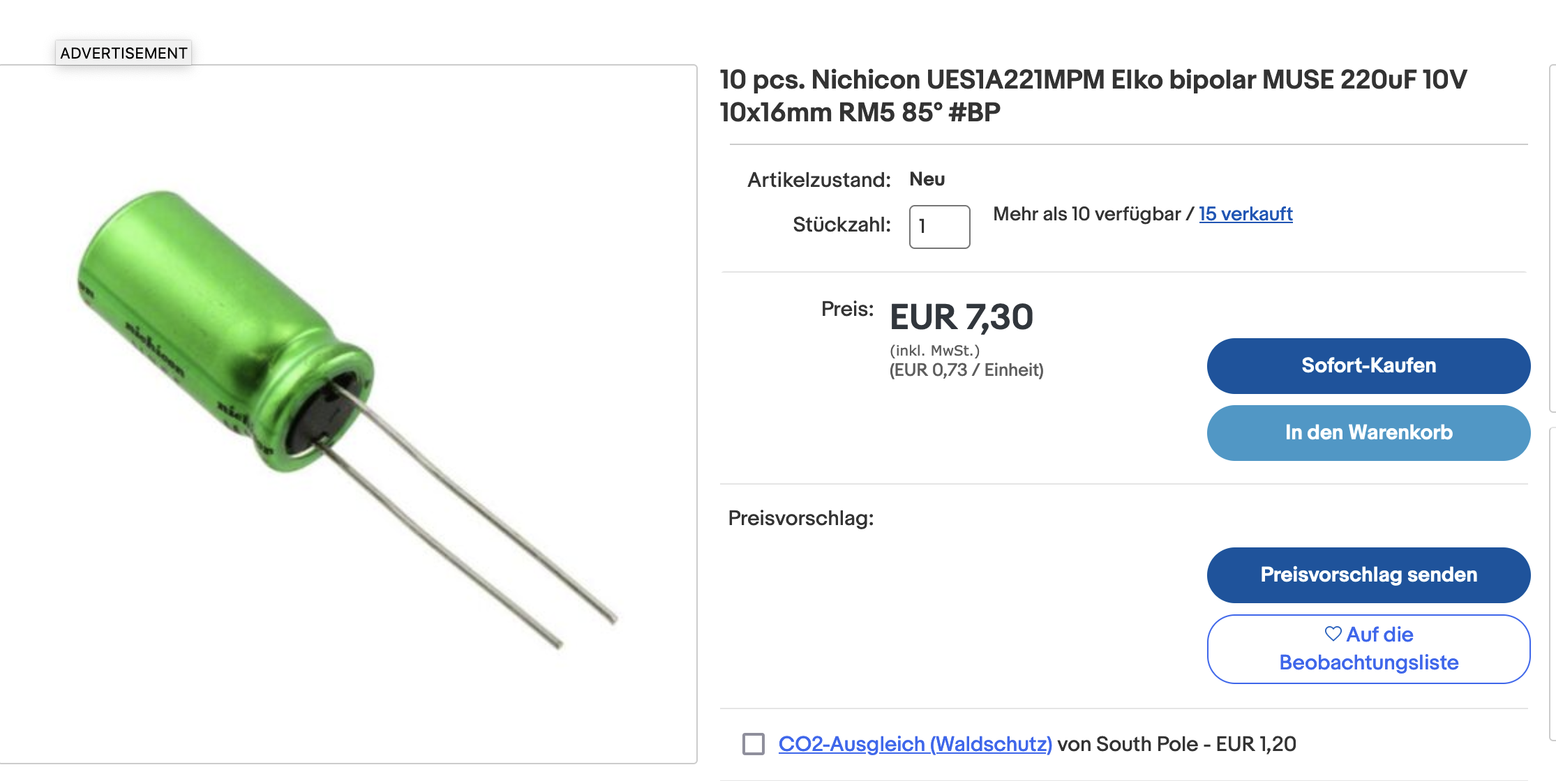

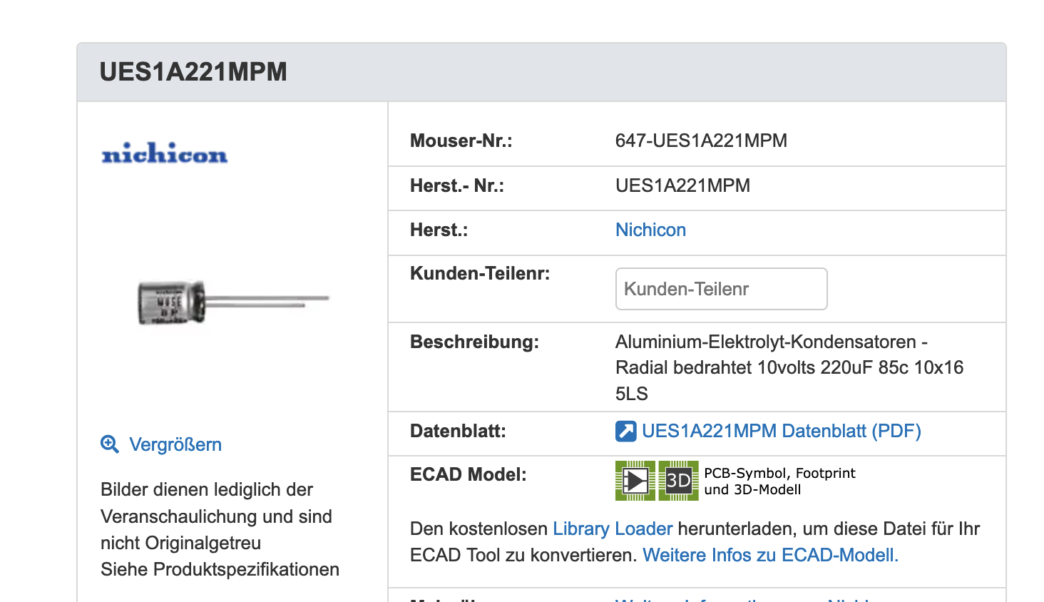

Ishikawa board C1 question
i´m just in process of ordering parts for M2x Ishikawa Iteration.
When i crosschecked the mouser parts (actually im ordering from reichelt in Germany) i came across a probelm.
C1 (Ishikawa board) is specified by Mark as "nonpolar", preferred is Nichicon green sleeve (Muse?) but all the C's i find are polar ones : (
The symbol for C1 in schematic shows two equal thick lines, indicating nonpolar.
And yes, of course, it shows that my knowledge is too poor to understand what C is asked for electrically in this situation
So the attached ones seem to be wrong, right?
tnx very much,
stefan
