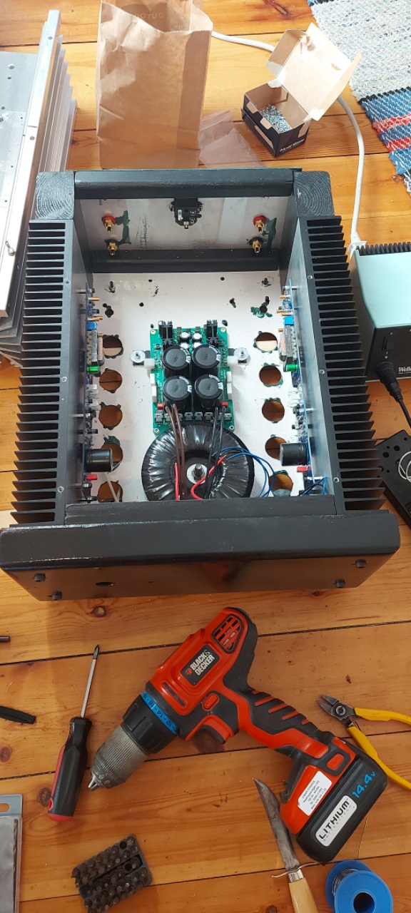

Ryssen,
For this build, you have stained the wood of chassis black instead of keeping the natural color?
Looks like the project is coming along nicely.
Pass DIY Addict
Joined 2000
Looking good! I had to extend the rear of my DIY chassis for the M2 as well. I'm always into creative approaches that solve problems!
Can´t decide to use a elyt after the capmultiplier or not..
Will there be any benefit If I use one ?
Åke,
What is the voltage of the secondaries of your power transformer?
The image you shared earlier of you build in progress shows an SLB power supply on the chassis floor if I am not wrong. The SLB PSU uses the LT4320 ideal bridge rectifier and a capMx, and is very low noise. However there is a voltage drop associated with the cap multiplier.
You are right, with 2x21V secondaries using a power supply with capMx like the SLB, you will probably get +/- 24V DC to 25V DC level at output.
