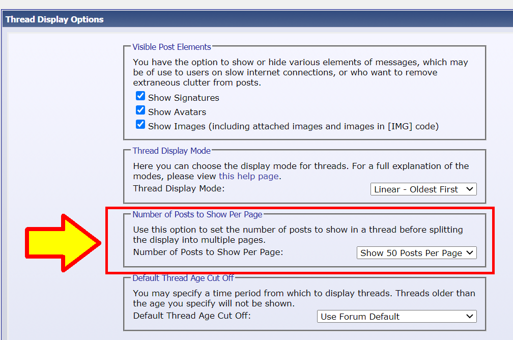

Page 1 of this thread includes the first ten posts (if that's your setting in the User Control Panel) or else the first fifty posts (if you're a Big Dog).
The answer to this question is found on Page One. When someone asks a question whose answer is found on Page One, I like to wait a while and let them have the pure joy of discovery. When you teach yourself to play the harmonica, or to change a tire, or to caramelize onions in a skillet: you remember it forever. Similarly, when you teach yourself to read Page One, and find out how many inquiries that pre-solves: you remember it forever.
