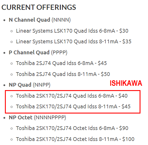

I notice the store has 2 jfet mA ranges (8 to 11 mA and 6 to 8 mA)for the quads needed for this amp. Which is the correct one for the ishikawa input boards? Or will either work?
Here's the Matched JFET page from the diyAudio Store as of today. Either one of the two options in the red box, will work very nicely in the Ishikawa input stage boards.

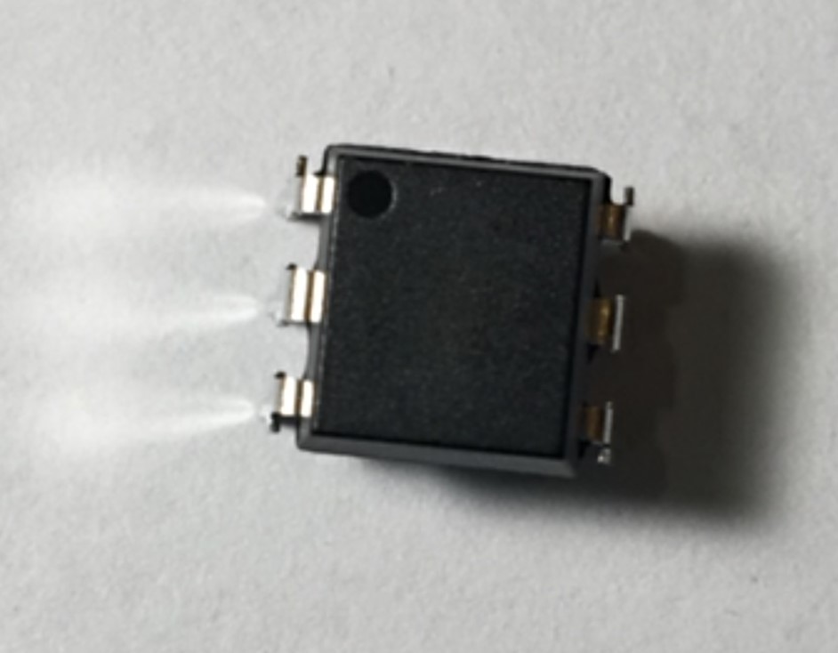

The Vishay 4N35 I bought for the M2X Q5 optoisolator doesn't have a notch or any markings for pin numbers except for a single dot on the top of the package. The datasheet doesn't appear to include any relevant information for this packaging about the pinouts. I assume the dot is pin 1 but can anybody confirm that?
Thanks.
