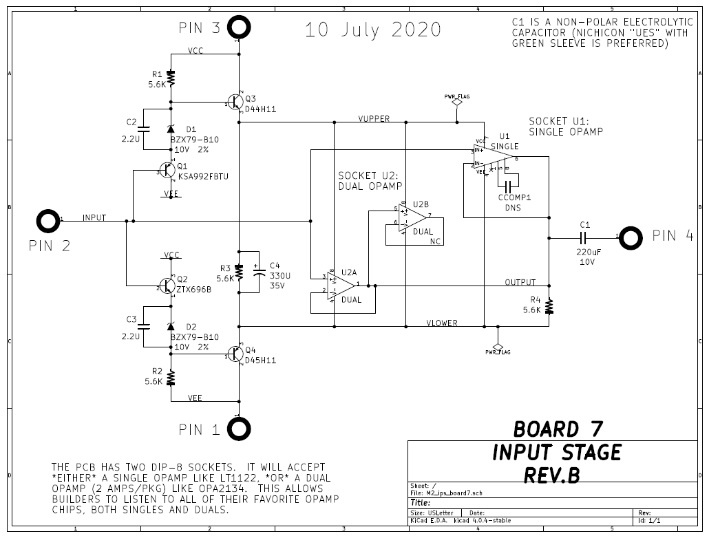

The Burson V6 has a max. rail voltage limitation of -+16.5 VDC......I think that be a problem using IPS7 boards?
It's seeing +-10V, so I think I'm okay... if it goes up in smoke I will know I was incorrect. lol
It's not to bad to cut them out after you do one. IF anyone is going to do it contact me and I'll share. The area to watch out for is the top, you can't go deep with that cut, or you will cut the board to board jumpers. Even if you did, you could always solder a connection in, but if you are careful you can get them out, just take your time and don't cut anything deeper than you absolutely have to.
Here's the IPS7 schematic. The opamp's power pins are connected to "VUPPER" and "VLOWER", which have the input signal (music) superimposed upon them. You can analyze the circuit by assuming the phono needle has been lifted out of the vinyl groove, so there is no music and the "INPUT" signal is zero volts.
_
_
Mark, I'm not there yet on the math, so I did it the way I knew how... fire it up and check the hot pins. 🙂 +- 10v

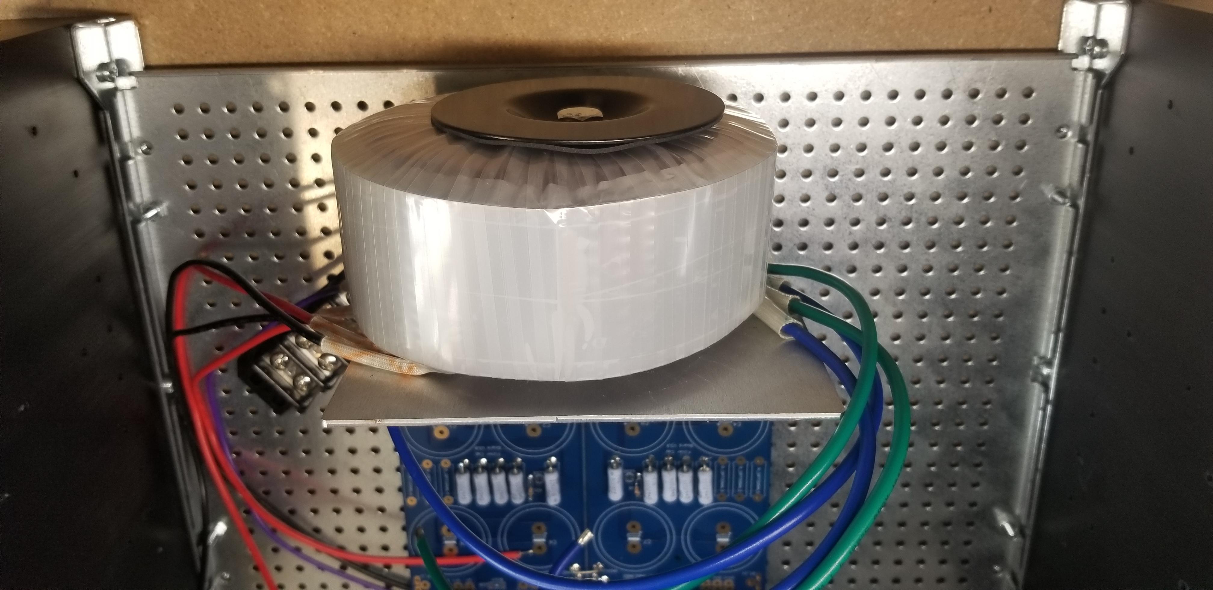

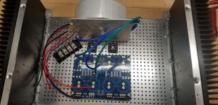

Laying out my M2X chassis 4U and parts
I'm working out my layout for the M2X. I've found a way to make the custom hinge work and be secure. the website for it is: Par-Metal. I think it cost around $12.00 and had fast turnaround.
So I can recommend it.
I have a rubber liner between the hinge and the transformer, correct?
Hinge?
So far the transformer mounting looks good.
Your perforated baseplate is upside down... 🙂
Hinge?
It is, but if you don't need the space under it's a much better way to mount it as the other way bends the crap out of it with any screw tightening at all. 😱
