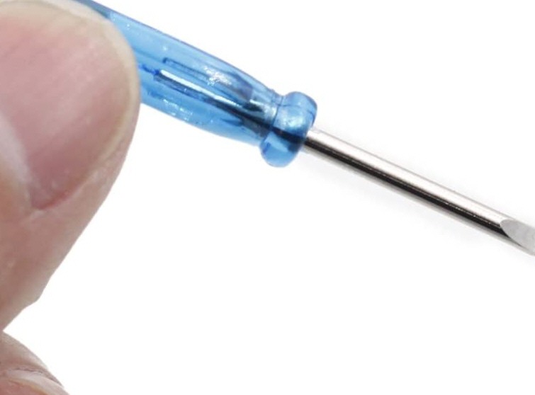

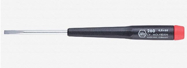

Since IPS7 intentionally and deliberately puts the DIP8 sockets at the outer perimeter of the PCB, you have an unobstructed path to use a flat bladed screwdriver as a "wedge"; to gradually lift a chip out of its socket. Gently rocking up and down.
You can use the screwdriver as a temporary & interim workaround, while you wait for Jameco to deliver your Truly Important IPS7 Ownership Tools
Here is success-with-IPS7 tool #1
Here is success-with-IPS7 tool #2
I purchased these Jameco products, and sent them to the original Listening Reviewers of IPS6 and IPS7. I wanted to be certain they had everything they need, to perform whatever experiments they could devise. The reviewers seemed quite pleased with the gift.

The trick is to pull the opamp out of the socket 100% horisontal without one end flipping up first which will bend the pins.....and maybe a pin stuck in a finger which does not feel very nice.
Even the expensive sockets with round holes tend to be a bit looser when an opamp has been inserted a few times. So it will be easier to insert and pull out but connection will not be as good as first time an opamp is inserted in a brand new socket.

How right you are!. I just bent a coupe of pins changing op amps. On one side I used the Jameson tool Mark mentioned above, on the other I got brave (stupid?) and just tried to lift it with a screwdriver. I'll go back to the tool that was made for the job.

ya! I generally end up bending all four pins on one side. Even a little bit is all it takes to make them not go back in. I have a fine needle nose pliers to bend them all back and even. I now put the op amp in the socket only as deep as I need to make electrical contact during testing.
In my experience the quality of these special opamp pliers varies wildly. A few are going to work great and others are gonna be worse than using screw drivers.

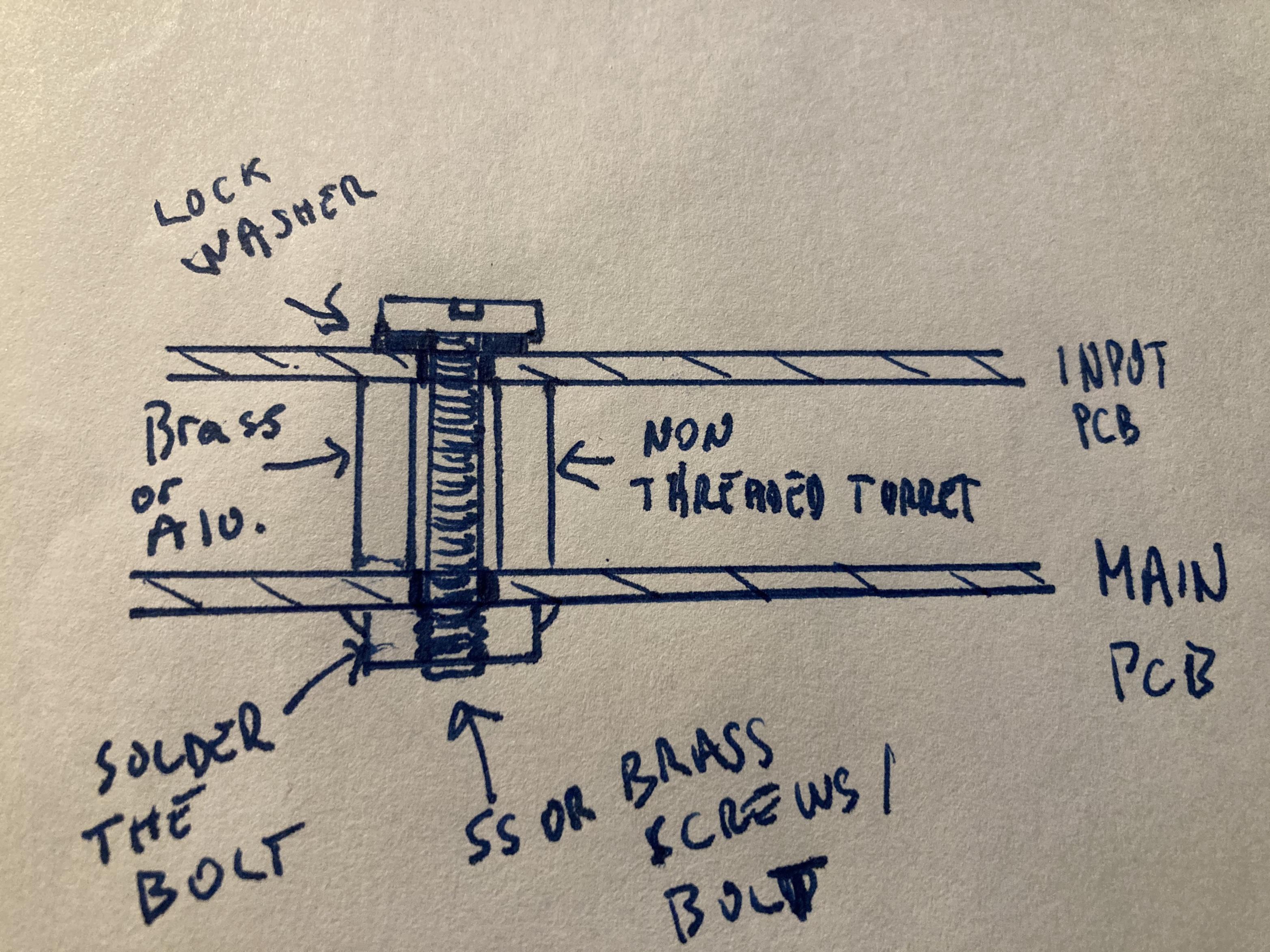

Another super simple solution is pictured below. Center the bolts in place with screws, solder them to the PCB and you are done. All the input boards swaps can be done from the top. You could even solder the turret for that matter if you find a narrow enough one.

On the drawing do you mean to say solder the "nut" rather than the bolt? If not, I am not understanding the drawing. I'm lazy, I'd like a pull out and plug in option.
You are right of course. Pesky dyslexia.
The other option, see mouser link, is a good but expensive one and you need to be careful to set it up right or you boards may endup slightly misaligned and not interchange.
