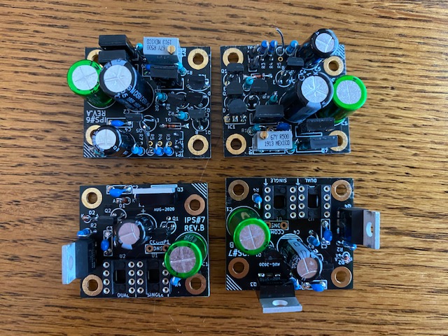

Good catch AB! Yes, there is a jumper there and no you did not F-Up, the jumper is optional per Mark.
"OPTIONAL: if you wish you can solder in a piece of wire (a "jumper") for R5. I never did, for all of the boards I built and tested and adjusted and sent out to third party listeners / reviewers. But you can do so if you wish. It's your choice; it's your option."
EDIT: Looking at the schematic, it doesn't make sense to me that R5 be installed as it shorts R4. I'm thinking that the jumper would at least have to be removed for tuning. I'll wait for Mark to jump in with his reasoning here.
I compromised by just soldering in a lead as a test point which I can snip off later.
I'm a day ahead of you. Photos of IP6&7 attached (if it works--never tried this way before).
Okay--that didn't work. When in doubt read the instructions again.
Listening begins soon...assuming the boards check out ok.

I haven't decided which op-amp to try first. Maybe flip a coin.
In tab 362 posts #3616 #3620 maybe relevant to you.
Mark mentions there is a single version of that chip LM4562 but I have not tried that.
And the new IPS7 board accepts BOTH single opamps (like the TL071) AND dual opamps (like the NE5532). So you can install whichever opamp you happen to like ... or you happen to own ... no matter whether it's a single or a dual.
See post #3408 of this thread for more info.
@grataku. I had read your posts which is part of what caused the dilemma. Having re-read them you have convinced me to try the LM4562NA first because that's the only one of the series I have. @Mark Johnson I will for sure try out both sockets.
I can't wait to see if the contrast when I change boards hits me in the face or is just noticeable. I am quite fond of the original design with the Ishikawa board. It only gets better from there. I'll report back after a few days of listening.
Each of the seven (!! seven !!) input stage boards has raving fanatics. Does that mean "in fact they all sound exactly the same and people are misguided / deluded / pre-biased" ?? Make up your own mind; my own answer is: no.
For me the GIGANTIC surprise is that nobody hates the sound of IPS6 even though its "principles of operation" are so wildly different ("orthogonal") than all the other IPS boards. It leads me to surmise that what individuals prefer, and the circuits which deliver those preferences, are highly personal and somewhat idiosyncratic. Ya likes what ya likes and ain't nobody can tell youse otherwise.
But, please, try your own experiments and select your own favorites. You can design your own IPS boards if you see fit, the physical dimensions and drill hole placements are documented -- have at it. Or just play with the PCBs made by someone else, there's plenty of diversity to enjoy.
