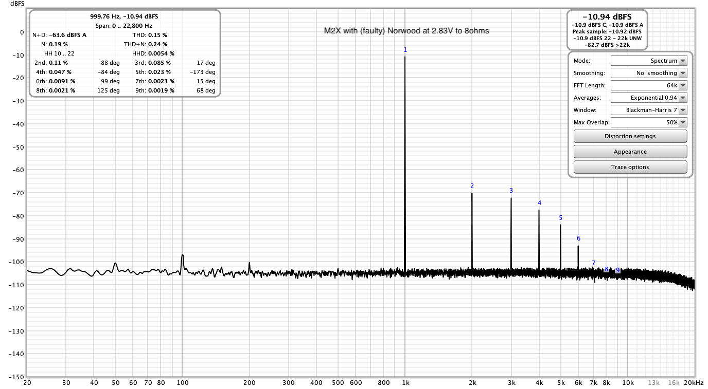

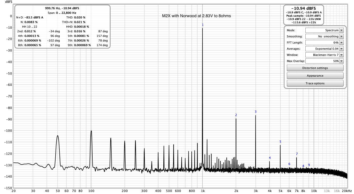

I don't know why it decreases in 13K-20K region - no filtering that I would know of.
And I do not hear anything with the ear to the tweeter, I only hear the mains hum from the woofers. But what is interesting, I hear more mains hum from the left channel, the right channel is less noisy to the ear, I am absolutely sure about this. Strange.

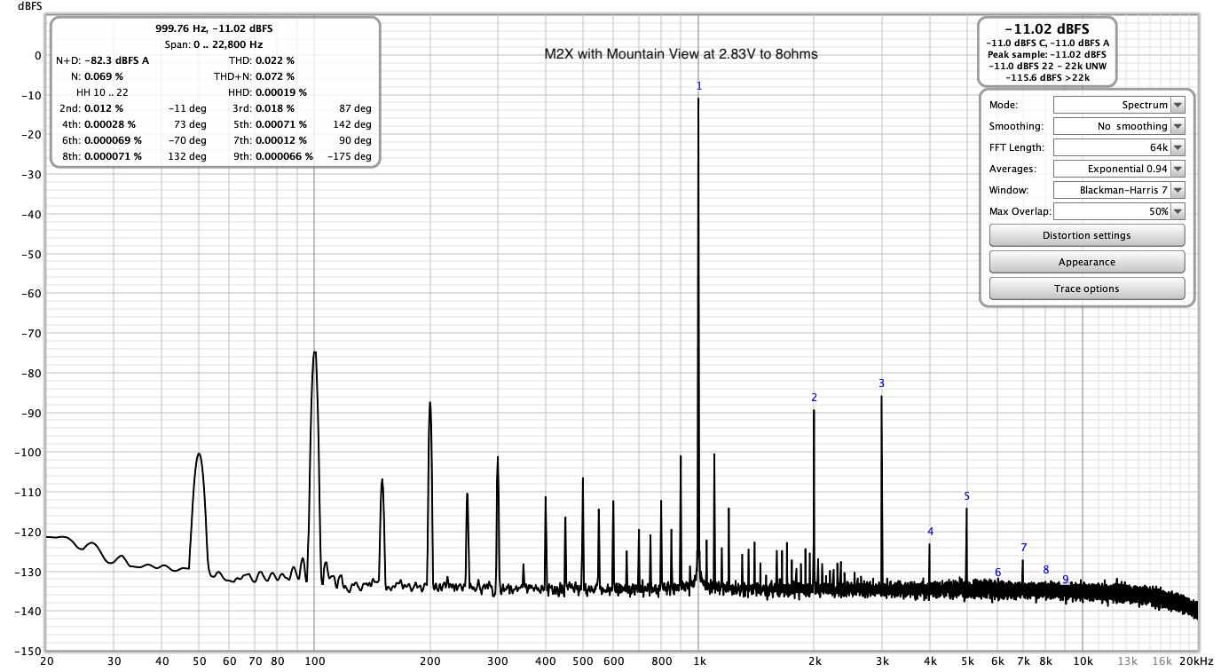

Strange but the R-channel looks nicer apart from the higher noise floor.
My 94 dB speakers are "hum-free" with ears as close to the woofer that is possible. Also tweeter is very silent.
So both your L and R channel was measured in same conditions. The 2i2 (or what you use) and internal sine generator was set to same values?
Can you repeat the measurement results?
Have you checked bias on both channels?
Also maybe perform a loop-back test on 2i2 to check that setup is perfect. Then noise floor should be at -140 dB or so......and very low distortion.
Yes, L and R channels were measured in the same conditions and the same 2i2 and REW settings, just reconnecting the cables to the input and output of the amp.
I cannot redo the measurements today, but I also have another measurements from the same session, but with the lower signal level - generator signal directly from the 2i2 output to the amp input, without the pre-amp. This gives 1.92V on the output of the amp, instead of 2.83V as in the measuments above. You can see in the pictures attached that on the lower signal the floor on the R channel is much lower, but still a bit higher than on the L channel (-130dBFS vs -138dBFS), and then you can see all the same hum as on the L channel. When the signal is increased, it makes the noise floor higher and it hides the lower mains hum peaks.

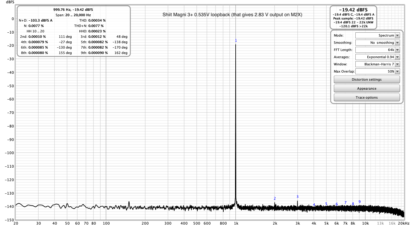

The loopback of 2i2 with pre-amp is fine, please see the last picture.
My only suspect after visual inspection of my amp is the soldering of one of the R channel output posts. It does not look perfect so perhaps a cold joint could introduce more noise on the higher signal levels? I will try to reflow it tomorrow and then make measurements again.
I do not know how to measure bias in M2X, I suppose it's automatic. But I did make DC adjustments on the output with shortend inputs, and it gets to just a few mV when the amp is up to the normal working temperature.

Bias can be measured by measure the voltage drop over one of the source resistors in output stage. It is almost identical with rail current.
The loop back test looks fine and the drop in noise above 13 kHz is something in test system.
Do you feed the 2i2 with 2.83 V or do you have a divider network from the 8R resistor?
I use a 1/10 divider from my 6R8 resistor to be sure not to overload the input of 2i2 also so I can measure THD when amp deliver some watts.
I feed 2.83V directly to 2i2. It's input can handle up to 22 dBu (9.75V) on minimum gain, so it's perfectly fine for 2i2 and I do not use the divider network. Another thing is that I am still waiting for the 8ohm 100W resistors to arrive, so I measured with the real speakers (Overnigh Sensation) attached, therefore the signal is not exactly 1W anyway. But that doesn't matter for the difference between the channels (I used the same loudspeaker in both cases).
Concerning the bias current, if I understood correctly, I measured the votage drop on all of the 0R47 resistors (R13 and R14). It was 0.62 V after the power up and changed very little (0.610-0.618 V) after half an hour. So the bias current should be about 1.30-1.32A - the same on both channels.
Ok, the speaker is a more complex load so maybe reason for the many spikes. Your bias is fine.
I could probably get a bit lower noise floor without the divider and then reduce gain for 2i2 input. I usually have monitor turned up to max. as far as I remember.
But this does not explain the difference between your L and R channels.

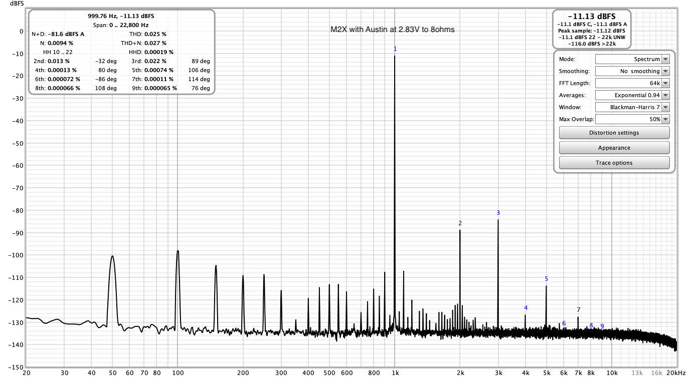

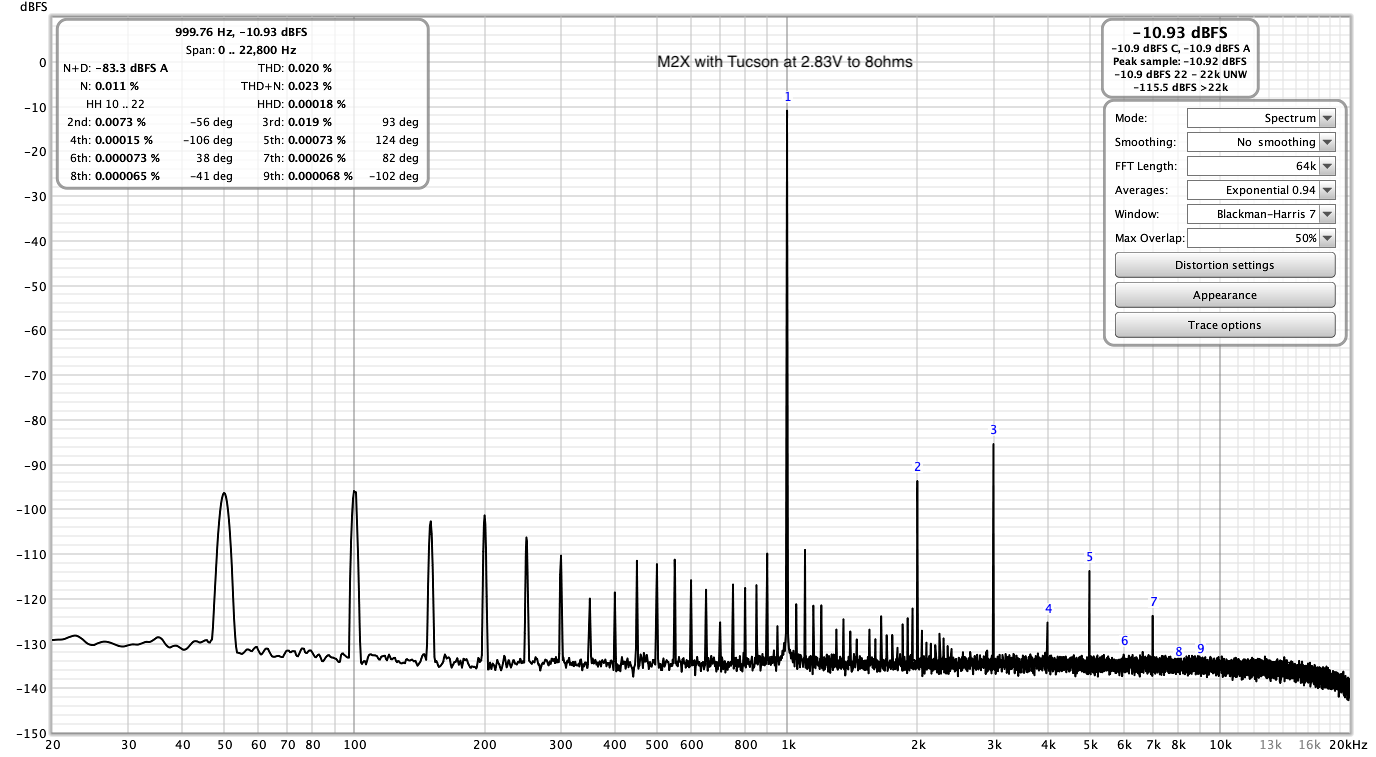

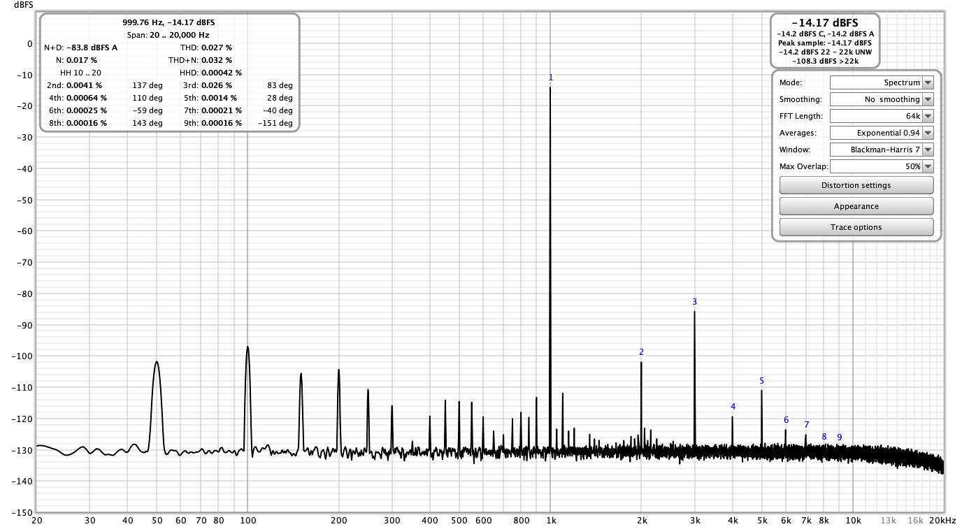

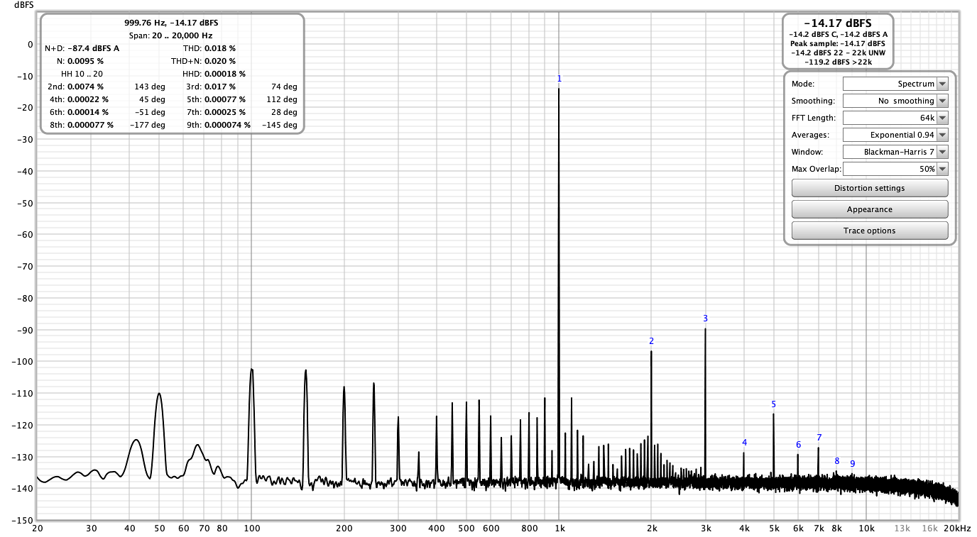

Hi all. I had time to tinker with REW and M2X again. And I found the culprit of the higher noise floor and additional harmonics on one of the channels! This happens to be one of my most beloved Tucson cards 🙁 This is, probably, quite subtle in reality. I do not hear any problems when listening to it - but you can definitely see it in the graphs, and it's there for real - I made measurements with all the cards I have (I do not have Ishikawa built). All of them measured well and very similar, except of this one "faulty" Tucson.
Please see the measurement graphs below. Again, please disregard the mains hum - this has to be dealt with yet. But looking at harmonics, I can say that preferring one of the buffer cards over the others is very much psycologic and subjective - I cannot see any significant differences in harmonics signature of the amp between them (well, maybe there are other differences that are not shown on FFT analysis).
The graphs also confirm one thing that I can actually hear - my Mountain View is a bit more sensitive to the mains hum that other cards.
Over all, a very interesting experience with REW measurements.
But it made me sad about my Tucson - for all the unexplainable subjective reasons I like them most (perhaps of the "fault" of one of them?). What could make one Tucson increase the noise floor by about 25dBFS and add even order harmonics (mainly 4th and 6th). It uses SMD OPA1611 chip. With so small number of the parts on the board, is the chip the main suspect? I soldered it using hot air, contacts look clean and nice, chance of overheating while soldering is minimal, I think. Could it be the faulty chip itself?
