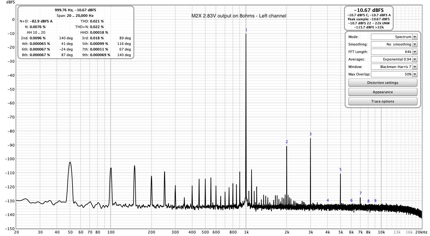

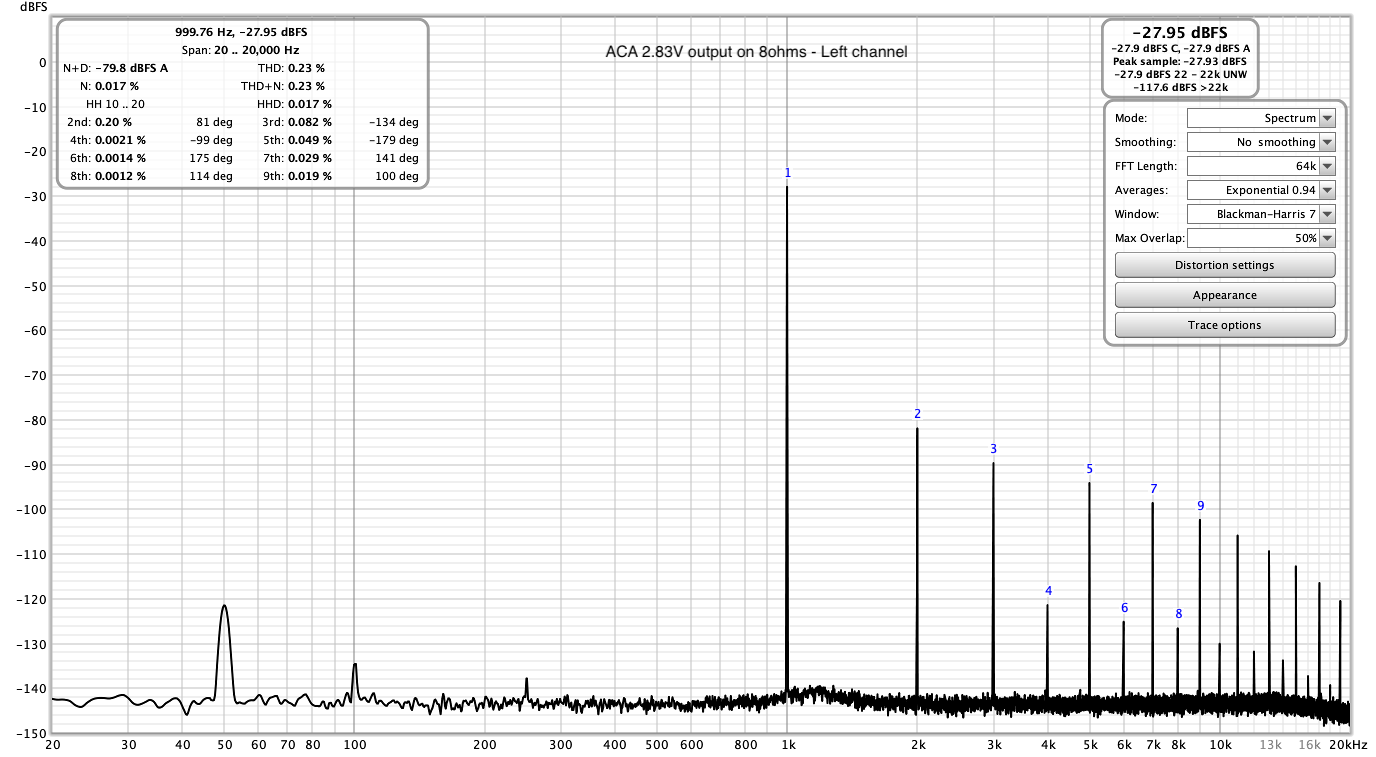

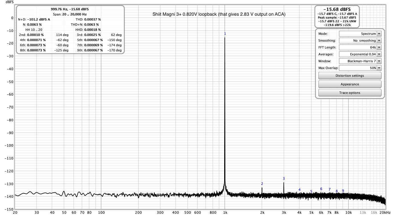

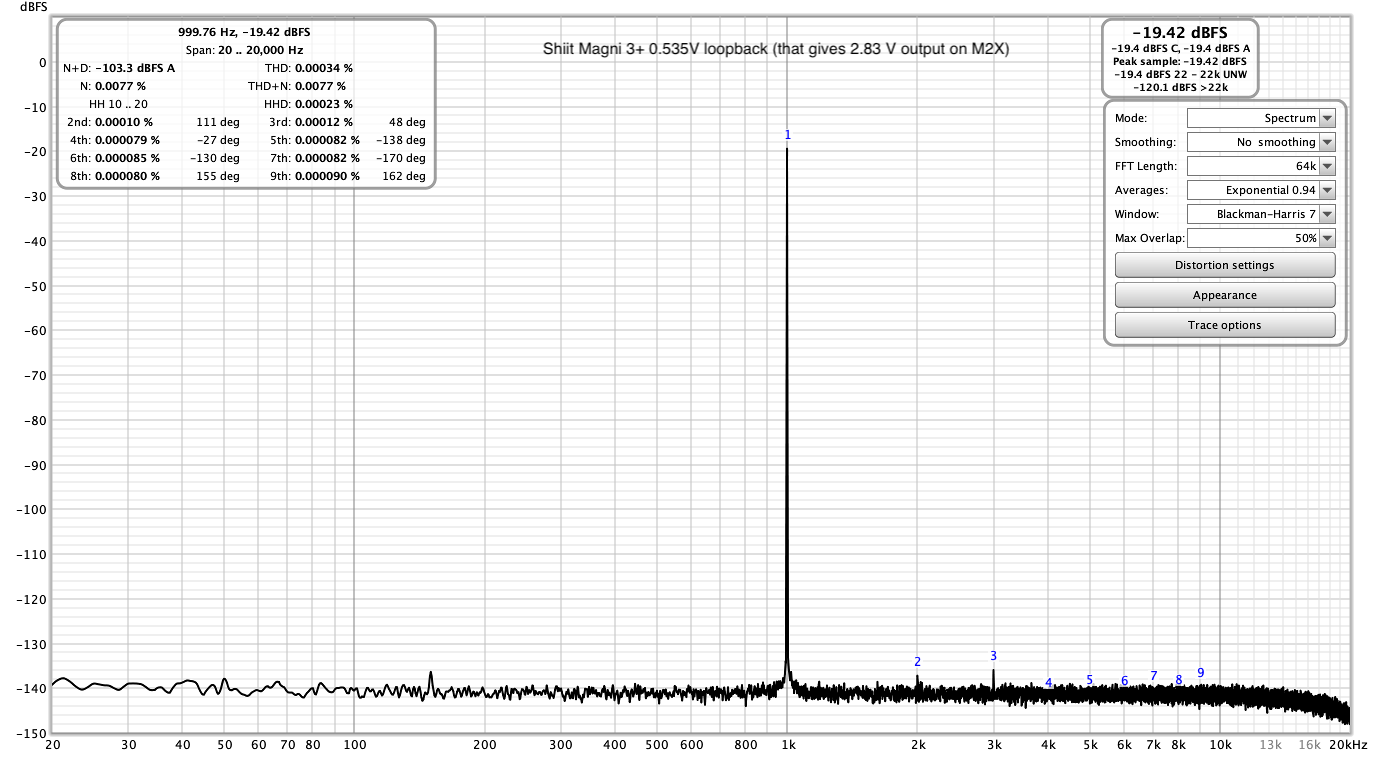

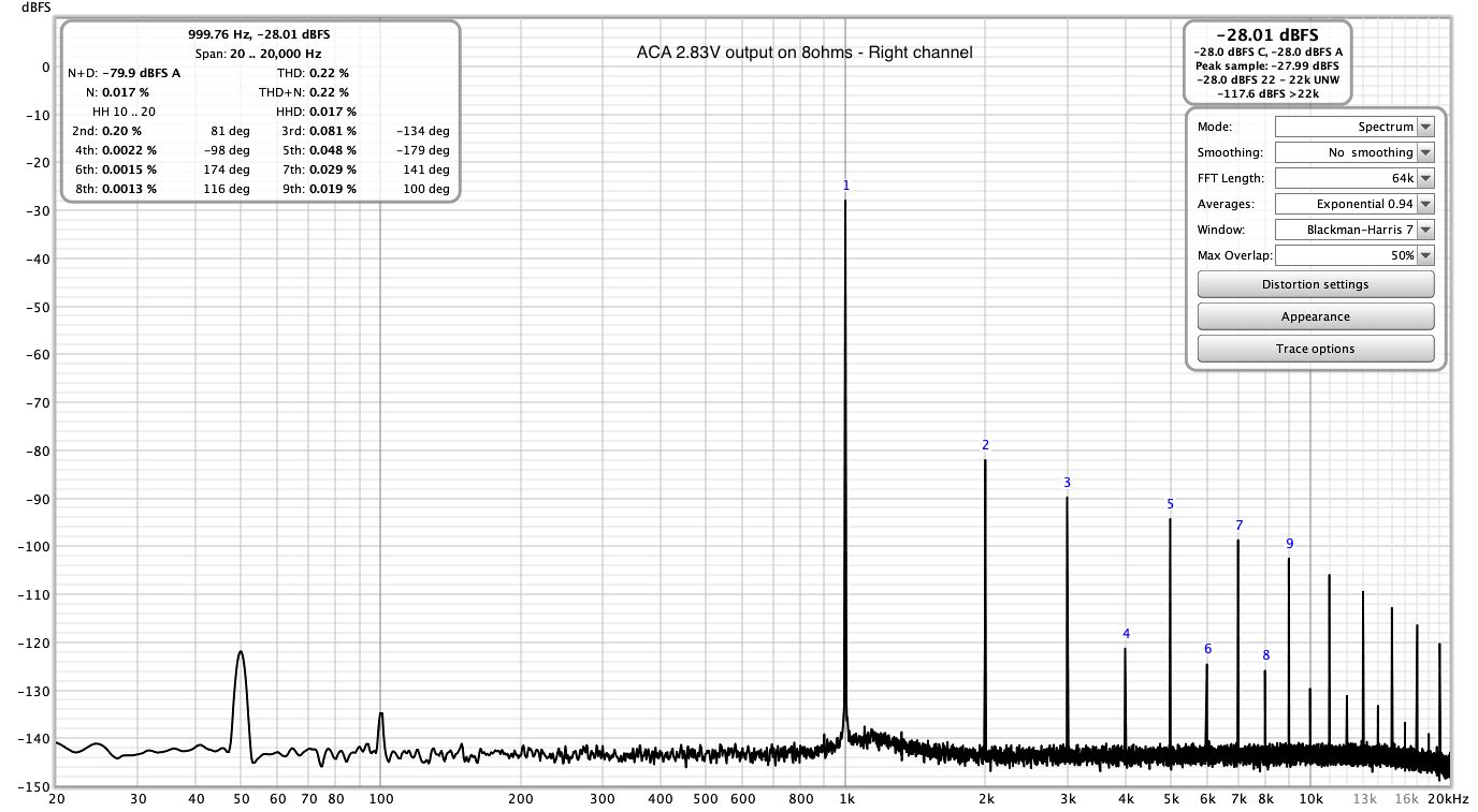

Hi! I did some experimentation with Focusright Scarlett 2i2 and measured my ACA and M2X. Got some strange results is one case and would be happy if the community could comment on that.
My setup was as follows:
- I used internal generator of RAW, set at -10dBFS, 1000Hz
- that gives about 360mV on the output of 2i2 with max monitoring volume, and it's not enough to get 2.83V on the output of ACA or M2X
- so I routed the signal via Shiit Magni 3+ pre-amp on 5.5x gain, setting the volume at the level that gave 2.83V measured on the output of the amplifier (it required 820mV output from pre-amp for ACA and 535mV for M2X)
- I am still waiting for the 8ohms 100W load resistors to arrive, so I measured with the actual speakers (Overnight Sensations) connected
- 2.83V signal from the output of the amp went (in parallel to the speakers) to the line input of the 2i2
- 2i2 line input can take up to 22dBu (9.75V), so I did not use any voltage divider network
- the gain of the 2i2 line input was set to minimum
I got nice and consistent results on my ACA (see the 3 first pictures: Left channel, Right channel and the direct loopback from pre-amp to check that pre-amp did not introduce any significant noise or distortion). THD measured at 0.22% (much better than oficialy stated 0.7% distortion of ACA), and it is 2nd harmonic dominant, but I see the whole handful of other order harmonics, and mainly odd-order harmonics. Also notice that the phases of harmonics are very consistent between the channels (just 1-2 deg of difference between the channels). The hum from the mains is low and really not audible in reality.
With M2X I got mixed results that I do not fully undestand.
Left channel measured well and as expected. THD 0.022% (very close to "official" 0.025%), 3rd harmonics dominant with nice 2nd and a bit of 5th - very much as described by NP (my M2X is with the Tucson buffer now). Hum from the mains is very visible and this was also expected - neither toroid not the auto-formers are shielded yet in my M2X (waiting for the steel cover for the transformer and mu-metal for Edcors to arrive). This mains hum was actually the main reason of these measurements, as I wanted to see it before I make changes and then compare.

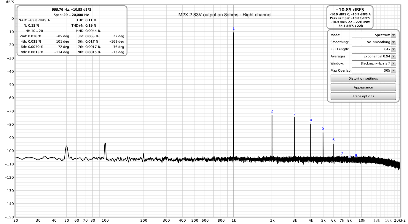

But on the right channel I am confused. Please see the picture (5th picture in the attachments). The overall noise floor rose by 25dBFS (from -130 to -105) hiding in effect much of the mains hum, and the harmonics look much different than on the left channel (and if you look at the phases of harmonics, they are totaly different than on the left channel - though in ACA measurement the phases matched almost perfectly between the channels).
What happens here? Why the increase in noise floor level?
I tried to change the loudspeaker used as a load, but same result. If you feed less V to the input, the noise floor on the right channel drops, but with inceasing levels of input the noise floor rises. But it does not rise on the left channel.
Does that hint to some problems in my M2X right channel? What could that be?
When listening to the music, though, I do not hear anything specific on the right channel, it plays as fine as the left to my ears.
Any ideas, please?

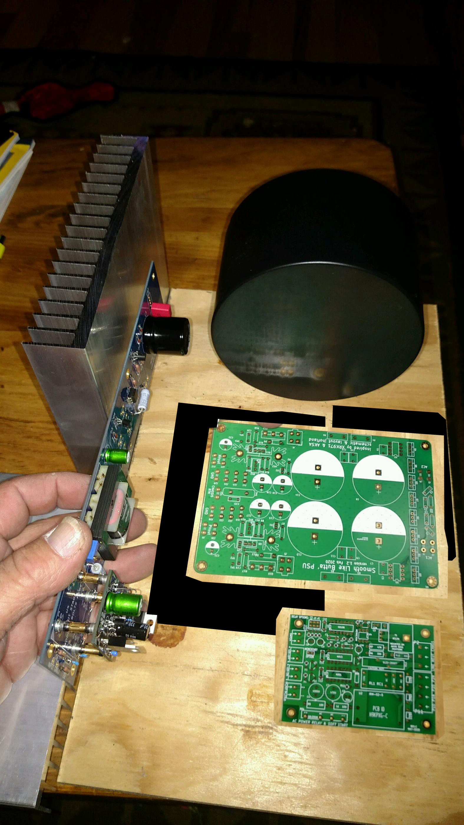

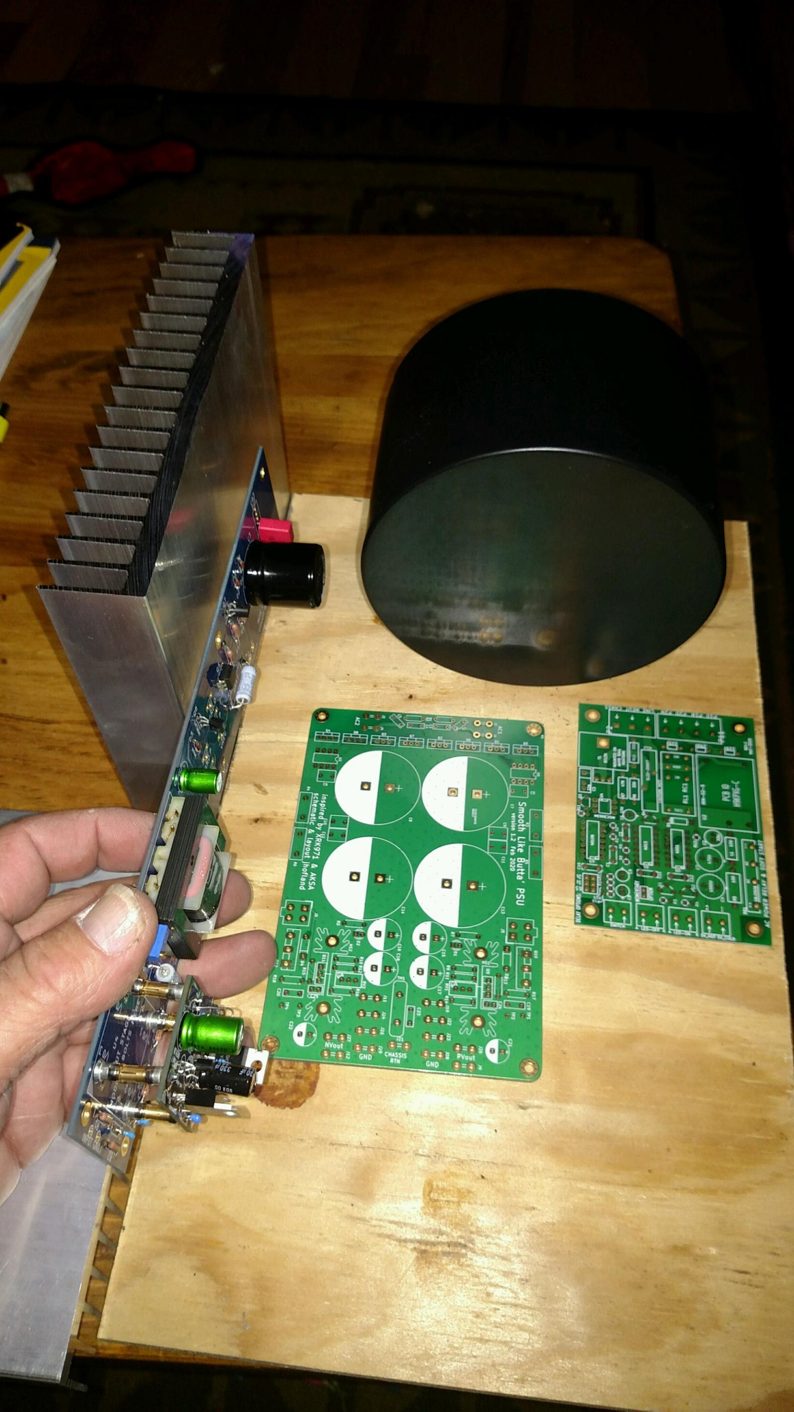

Laying out my amp
It's closer than mine & not far enough. The shield on the transformer should help though. If you want to compare I posted pics of mine in earlier post.
BTW with the SBL the speaker GND need to go to the PS board directly or you get a ground loop.
Another BTW: the after ~1 hr operation the transformer in that case will be the hottest part of the setup. I measured 65C in mine. Can't hold my hand on it. Heatsinks are 44C for comparison.

Hi @grataku! It would be very interesting to see your measurements too!
My setup is explained in details in the post. I could only add that I used REW software (V5.20 beta 61) on MacBook Pro running on batteries. I used TRS (stereo) to RCA adapters for input and output to 2i2, then normal RCA-RCA cables from 2i2 to pre-amp and from pre-amp to the amp, and a specially made banana-plugs to RCA cable from the amp to 2i2. You will not be able to reproduce the setup verbatim, I think, but that does not matter so much.
As for my measurements results, the left channel looks very reasonable - harmonics are like expected, I suppose, and the hum from the mains is what I am going to deal with.
But the right channel is strange. Why the noise floor could go up so much on one channel? This makes me wonder and any suggestions would be very much appreciated.

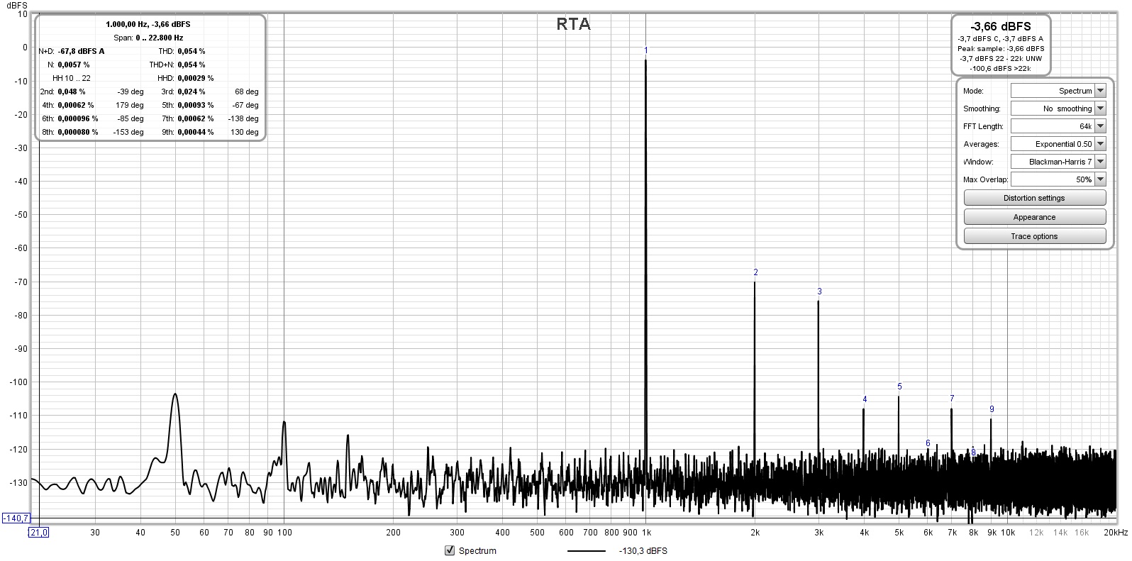

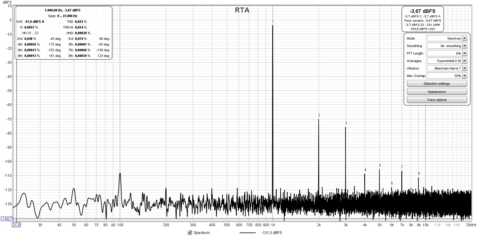

I have REW measurements here using 2i2 and a homemade interface box from speaker out to 2i2. The measurements are with 3-4W output into a 6R8 ohm resistor. Depending on mains quality and how much DC are on mains the 50 Hz peak goes a bit up and down. Therefor I have a heavy type DC-blocker under ways and I am also thinking about investing in a mains AC regenerator (not a conditioner).
Thanks for your measurements, @MEPER. Looks very reasonable to me and quite similar in harmonics to my left channel. And I notice the phases of harmonics match on both channels very well (as it was on my ACA measurements also).
So what could make my measuments of the right channel of M2X so different in respect of the floor level? (I attach the files here again for easier reference).
You have a bit more averaging therefor you curves seems not as "busy". Right channel shows much more noise.
I output more power so probably why I have a bit more THD if we compare left channel.
Is it same chassis so both channels use same PSU? ....or mono blocks?
My are mono blocks.
Also interesting that you noise level decrease from 13k - 20k......like there are some filtering.....
