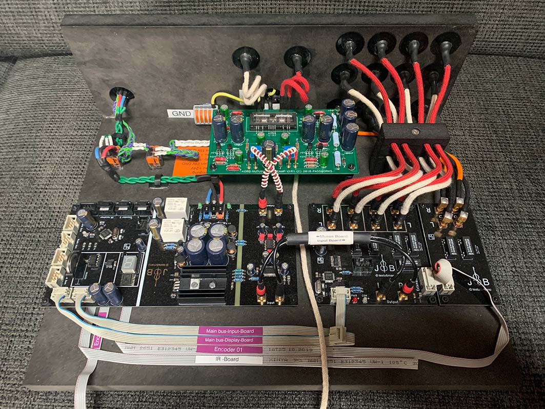

I developed a Muses Volume and Input selection module
and build it into my Korg Nutube Preamp.
I called the whole module „PCU“ Preamp-Control-Unit.
In the photos you can see the structure of the preamp.
On the left the muses and digital board. On the right the input module with four inputs and next to it an input-expansion-board with two inputs. The PCU Modul is controlled via two encoders, alternatively with an Apple remote control, in the future also with an IOS app. I’ll make a description of the „PCU“ and post it here. I think I need a day to do that, so I could post the description here tomorrow, Sunday.

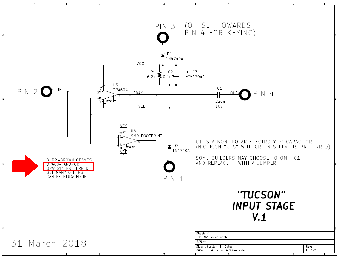

Was so impressed with the OPA1612 in my Whammy that I bought a pair of OPA1611 single channels for my Tucson boards. I am so glad I did. My M2x now has that same lush, yet detailed sound I find so appealing in this opamp. Worth the effort to put them on the adapters, although I did buy an extra fine tip for my Hakko solder station. It helps a lot.
Allow me to mention that the original Tucson schematic, which is attached to post #1 of this thread, suggested two opamp part numbers. One of them was a thru-hole device, which builders can stuff and solder into the thru-holes on the Tucson PCB. The other was a surface-mount device, which builders can solder directly onto the SMD footprint of the Tucson PCB.
Alert readers also snapped up large quantities of extra Tucson PCBs so they could try out many different chip+package combinations.
