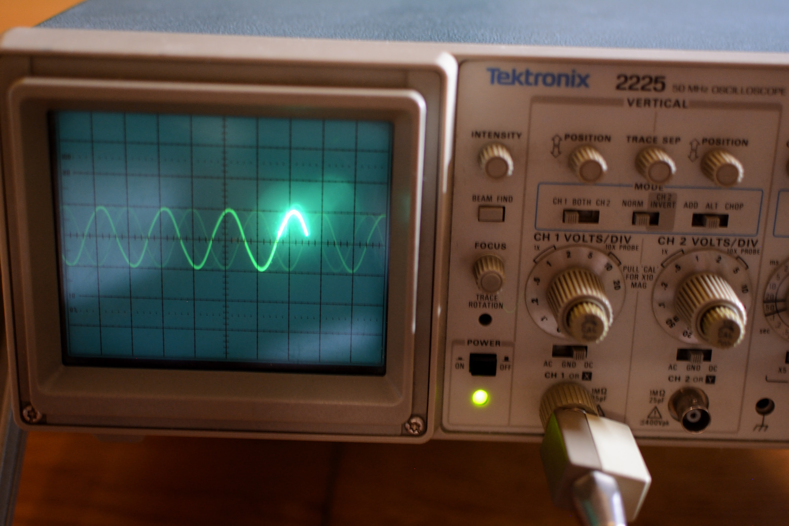

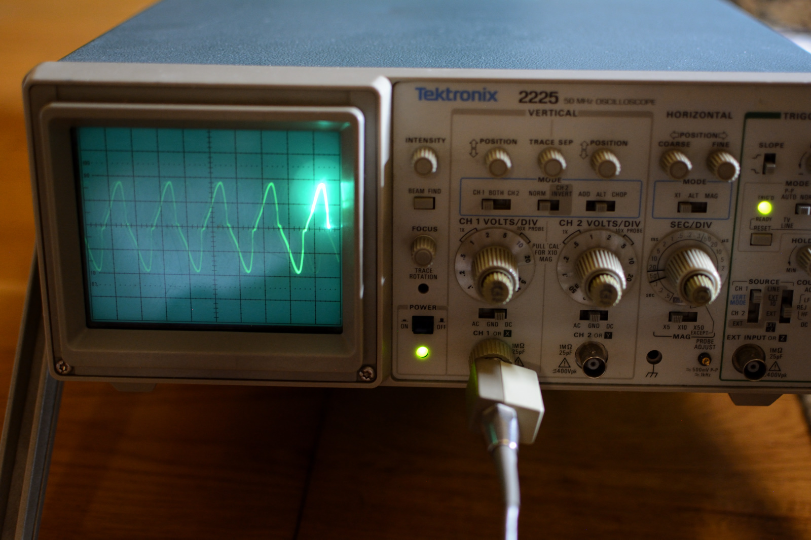

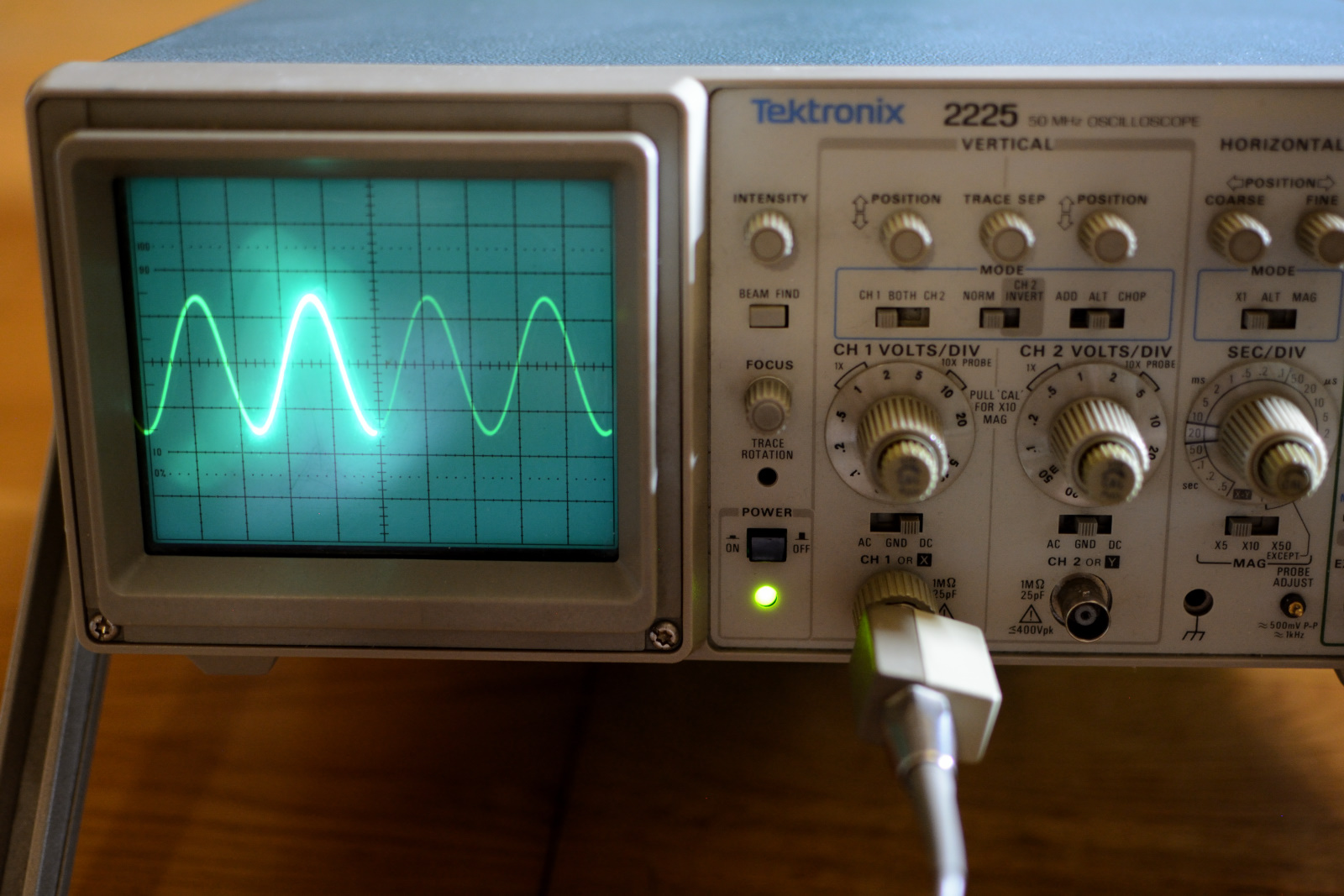

I have started testing my M2X mono blocks. If looks ok so far.....I think. I use 8 ohm resistor as load. Sinus generator as input signal. I have added 3 scope pictures. Settings is 10V/Div. Frequency set to 20 Hz looks fine but if reduced to 10 Hz signal looks like cross-over distortion? ….is that because amp runs out of bias? If I reduce input signal a bit signal looks ok again as seen in last picture. Rails are +-23V and bias approx. 1.3 A.

Swap in another of your daughter cards to find out. I happen to know that you have you two working Norwood boards, because I built them myself and shipped them to you on 07 Jan 2019. Put them in and see how well or how poorly they work, when the M2x output looks like photo #2 of post 2250.
Maybe you will conclude that you can accept or tolerate an M2x amplifier whose maximum undistorted output power begins to fall when producing output sinewaves at frequencies below 20 Hertz.
Joined 2011
The purpose of the test is to discover whether the Edcor transformer is working well and the daughter card is misbehaving, or whether the Edcor transformer is misbehaving and the daughter card is working well.
Or perhaps the data in post 2254 tells us the answer immediately. Input to Edcor is slightly bad, output from Edcor is very bad. What does this mean, Dr. Watson?
Edcor may be the largest contributor to the distortion. …..but will be interesting to see with other input boards that has more driving power so there is a clean input signal to Edcor. I also need to check that input boards has good connection. We see when 2nd board is tested on other amp.
