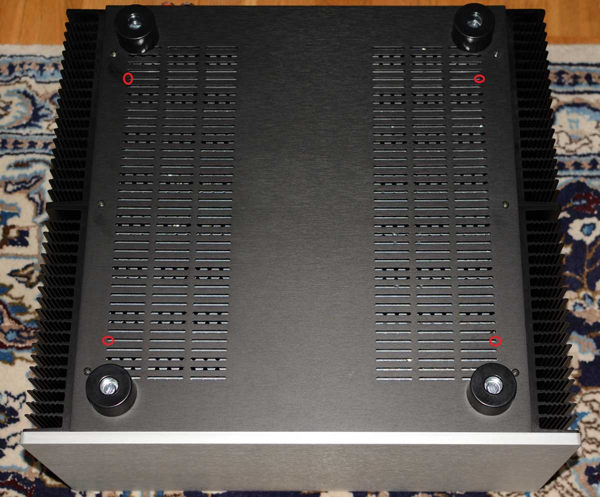

Today I mounted rubber feet on my M2X mono blocks. The thin plastic feet in the Deluxe kit is not very "Deluxe". The placement is important as the mount screw has to go free of the edge of base plate as it bends down at the edges. Then short screws is also necessary as the "free room" to baseplate is limited. But think I did quite well. Now blocks are warming up for the final DC offset adjustment. I have installed REW distortion software and will try it out using Focusrite for distortion measurements.

best place is very end of fifth slot in each corner
that way each foot will have support on heatsink angle/bracket , while corner screw will be away enough
it is tricky to make 4mm or so hole in slot , but easy if you use round 4mm (or little bigger) Dia round file instead of drill bit
Ok.....so screw is fastenet to base plate? …..so you get support also from baseplate?
I drilled 6mm holes for feet in bottom panel only. It feels stable and I just tested it using my weight on chassis (only 80 kg) and this was no problem :) …..but will think of the other option next time. 6mm should also be possible. The 4mm hole in base plate can be drilled to 6mm. But maybe also something for Modulo shop to look at to make a better "feet solution".....for an easier build with "quality feet"?
Ok....will have a look. L-bracket is going full length of heatsinks but at the red circle the base plate attach to L-bracket. I assume that this is the argument for that this area is the strongest. Then I maybe was "overthinking" that 4mm holes in base plate was used for the feet screw.

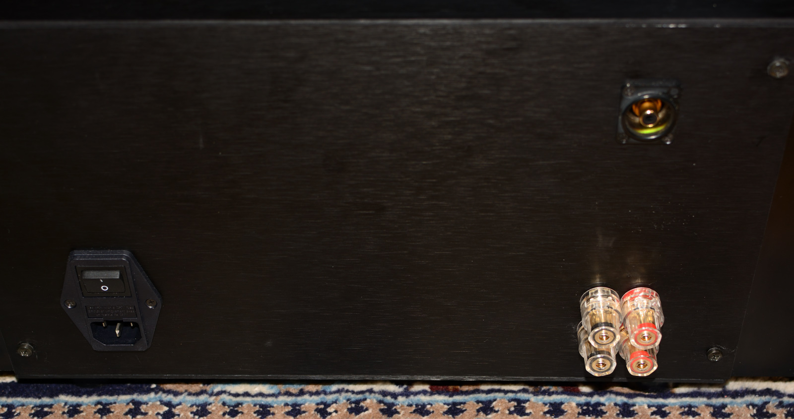

But one more suggestion for Modushop (HiFi 2000) to improve is the relative thin back panel which bends a bit inwards (probably from the machining). Maybe 1mm thicker could solve this or some supports on top and bottom panel. It is quite easy to press outwards by hands to align back panel.

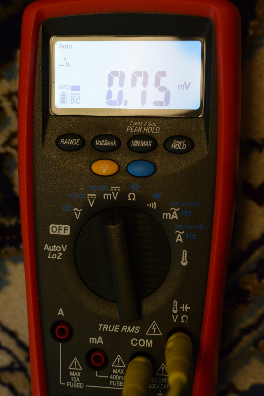

After fine tuning chassis of other amp it was time for final offset adjustment. After a good hour of warm-up I did the adjustment and as the picture shows it is possible to get down to just around 1 mV DC. Then I switched to AC mode to check if DMM could measure any noise/hum. It just shows 0.0 mV AC. On other amps 0.1 - 0.3 mV is quite normal. So design of PSU and placement of components and shielding of Edcor seems to have "paid off". I am quite happy with this as some had problems with noise pickup by Edcor. Now this may be the most silent amp I have built so far. Will see when I get to the distortion measurements.

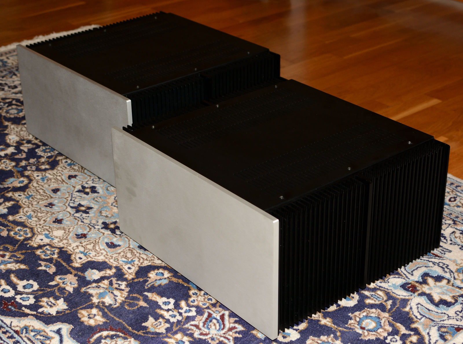

Now after M2X blocks are finished and I got the back panels adjusted using washers it looks quite good. 1 mm thicker back panel and top and bottom cover would help a lot regarding "perceived quality". The L-bracket on heatsinks could also be a machined part instead of "bended metal". But it is also about learning how the parts "interacts" and make small improvement your self.
