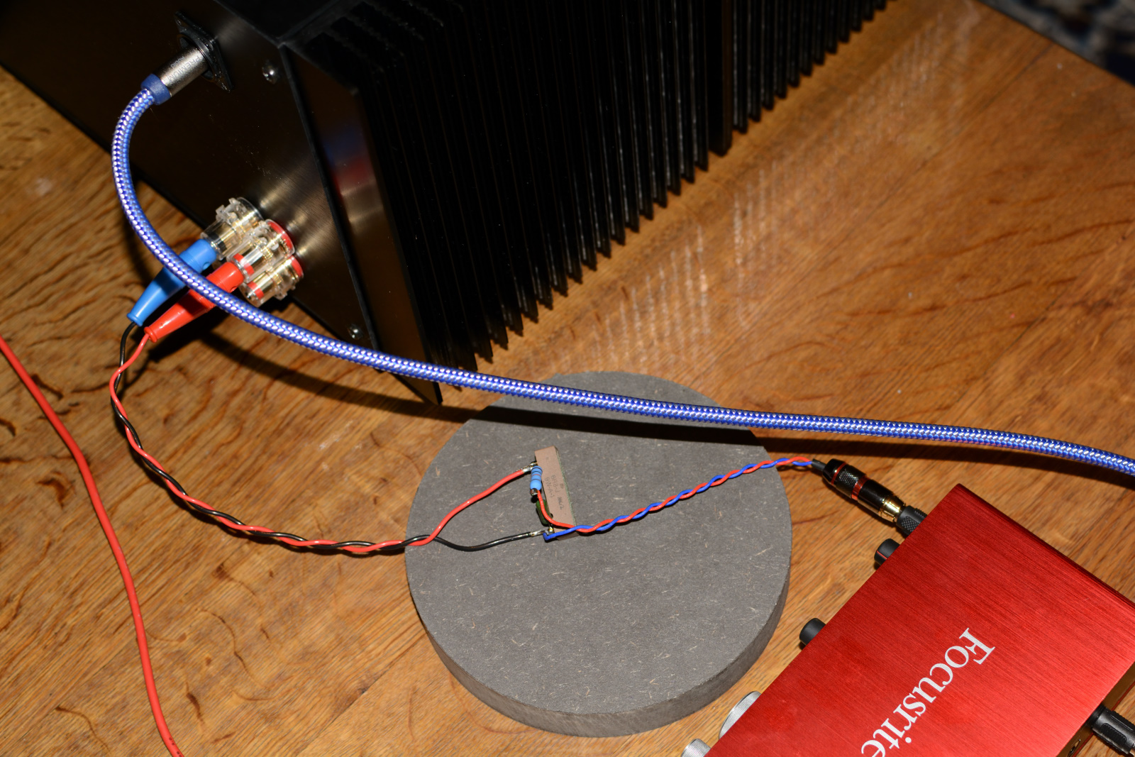

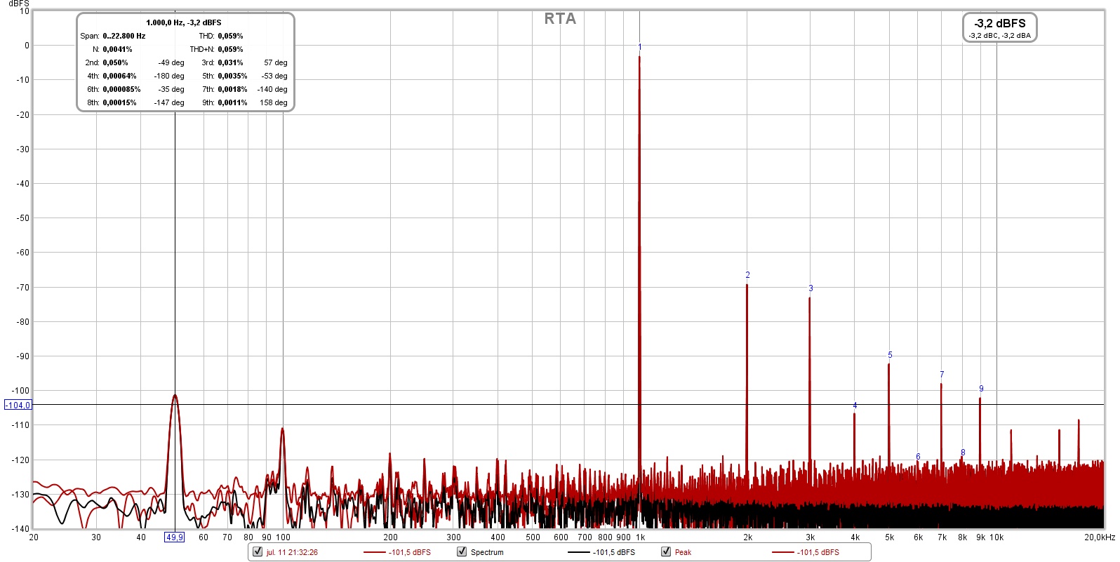

I made my first distortion measurements on M2X mono block using REW software. I made a "quick and dirty" adapter from banana speaker out to RCA connector and a voltage divider (10:1). Measurements is with 5.3V RMS out in a 6.8 ohm resistor so 4.1 W which is relative high output. The measurement shows 2nd harmonic dominans which is different from FW M2 which is 3rd harmonic. Input board is standard Tucson. I think distortion is on par with FW M2? …..I am a little disappointed with the relative large 50 Hz noise but I can see that some is from external pickup of the adapter I made. If I try to screen with mu-metal etc. I can get it some dB down also if I put my hand on the chassis it drops a few dB. I have no earth connection in the outlet so this could also reduce it if I get earth wire installed. The 100 Hz noise is relative low so it seems PSU filtration is ok and Edcor pickup is minimal?
Will see if other mono block shows same result. It is my intention to make a small adapter box in metal with chassis mount female banana and RCA connectors to reduce noise pickup so what I measure is from amp and not from environment. Warm up was about 1/2 hour.

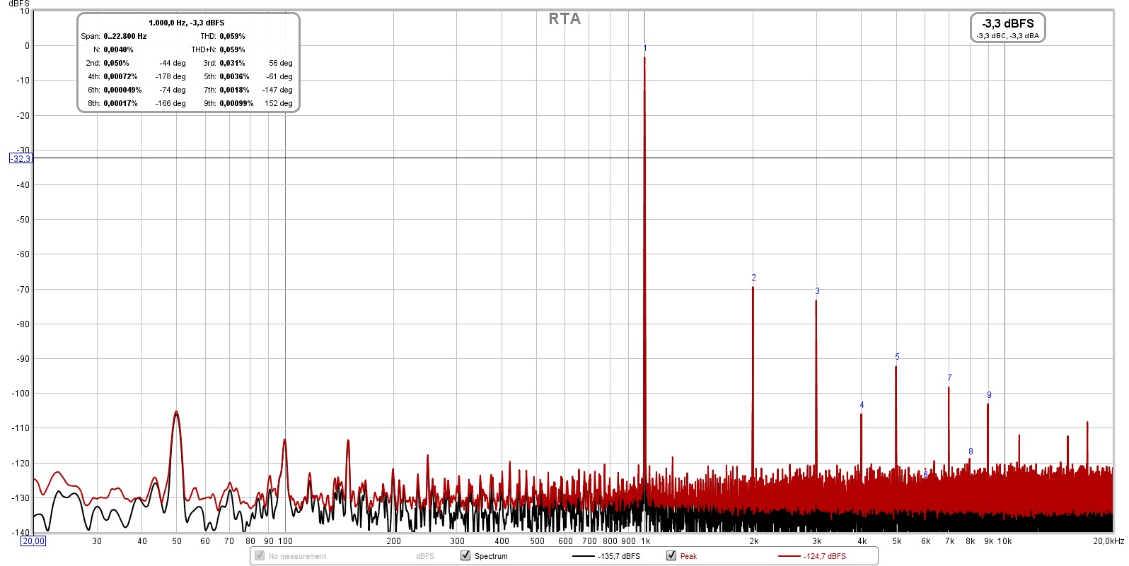

Now I also got a measurement on 2nd M2X mono block. Have attached both results for comparation. Think they are similar enough in performance to call it "stereo". Next step is to set it up for a listening test.....maybe in the weekend...….but hard to believe Korg + M2X can beat BA-3 + MoFo? ….let's "see" :)
Ok.....this is with 5.3 V RMS out in 6.8 ohm. The supply is an old school CRCLC with 4-pole Jensen as last caps. Since both channels looks identical in distortion and also match what you got then everything should be ok......even that M2 in theory should be 3rd harmonic dominant. 2nd harmonic probably from Edcor?
Since the M2x has different FFT footprints when different daughter cards are installed, it's Best Practice to mention exactly which daughter card was used for the measurement.
And in the specific case of the "Tucson" daughter card, where many different opamps can be used, it's Best Practice to mention exactly which opamp was used on your particular Tucson daughter card.

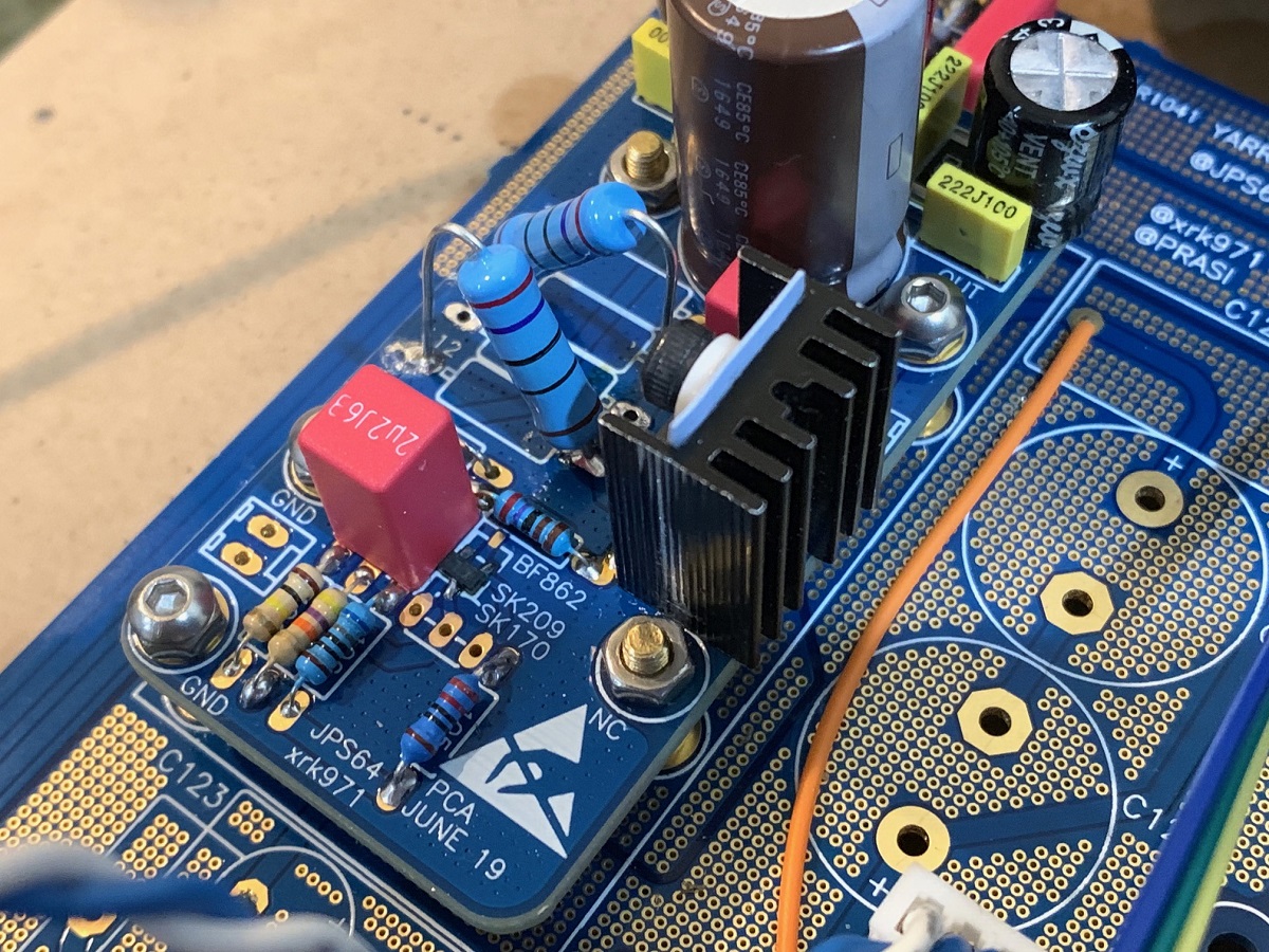

Another option for an M2X compatible input board is now available - it’s based on the PCA (Pocket Class A) JFET input and MOSFET source follower. It will provide about 12dB gain so no need for a separate preamp. Board also works on the Yarra preamp of course. JPS64 did a great job on the layout and this board has a built in CRCRC to help clean up the positive rail. Provides choice of 2SK209, BF862, and 2SK170 input JFET footprints. The latter two, becoming almost unobtainium. Each one has a different setup so follow values on table provided.
767953d1563001650-yarra-preamplifier-hpa-melbourne-db-buy-yarra-pca-build-05-jpg
I have tried it on an M2X yet, but should work well. I have used it in the Aksa Lender chassis to drive the M2X (Austin) and that sounds great.
768005d1563033903-aksas-lender-preamp-40vpp-ouput-gb-al-pca-verification-05-jpg
Joined 2011
If the new board is an inverting amplifier like the PCA was, be sure to notify users to swap the (+) and (-) plugs of their loudspeaker cables. Just as Nelson Pass alerts builders of the Amp Camp Amp to swap (+) and (-). {Amp Camp Amp is another inverting amplifier.}
PCA consisted of a JFET input stage (inverting) with a MOSFET source follower (noninverting) output stage.
