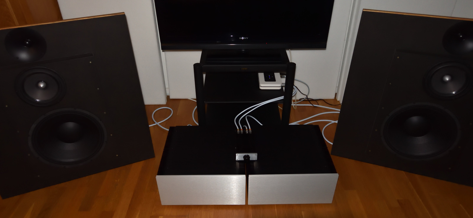

I had my first M2X listening session tonight. First with Korg as preamp but it seems there was too much amplification in the loop. This caused a bit of "hiss" noise from tweeter with ear close to the unit. With input to M2X shorted tweeter was silent so I decided to go with passive pre. In my case it is a 10k Goldpoint 24 step attenuator. With passive pre this gives perfect amount of amplification with normal listening level at around 2-o'clock. I need to listen more to be able to write about the sound. But so far very positive. Sound image seems a bit "lighter" than MoFo which seems a bit to the "dark side" compared to M2X.
Yes, different input boards…...but I feel right now that I stay with passive pre. Seems to work perfect (no need to add more "noise" in the loop ). I stream high res music via a Bluesound node which seems to have a good output driver. Probably the best setup to hear pure M2X sound. I have received a lot of Tucson boards from MJ. Now I just need some opamps to put on them. I have the OPA 1611 which will be the next Tucson. Probably hard to find opamps with better specs than OPA 1611?
