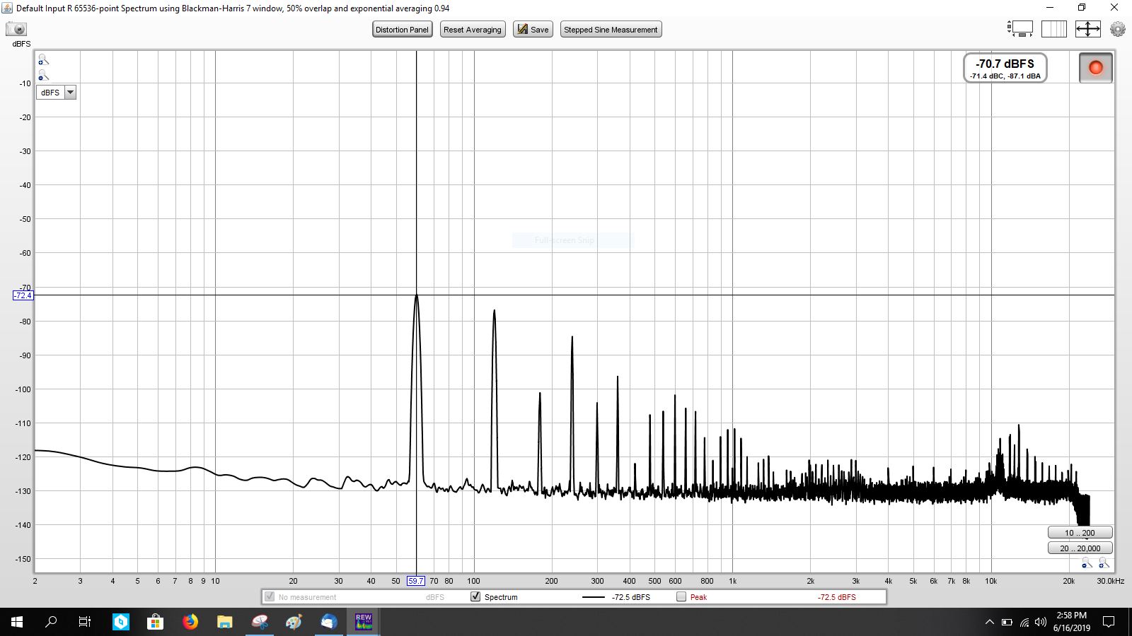

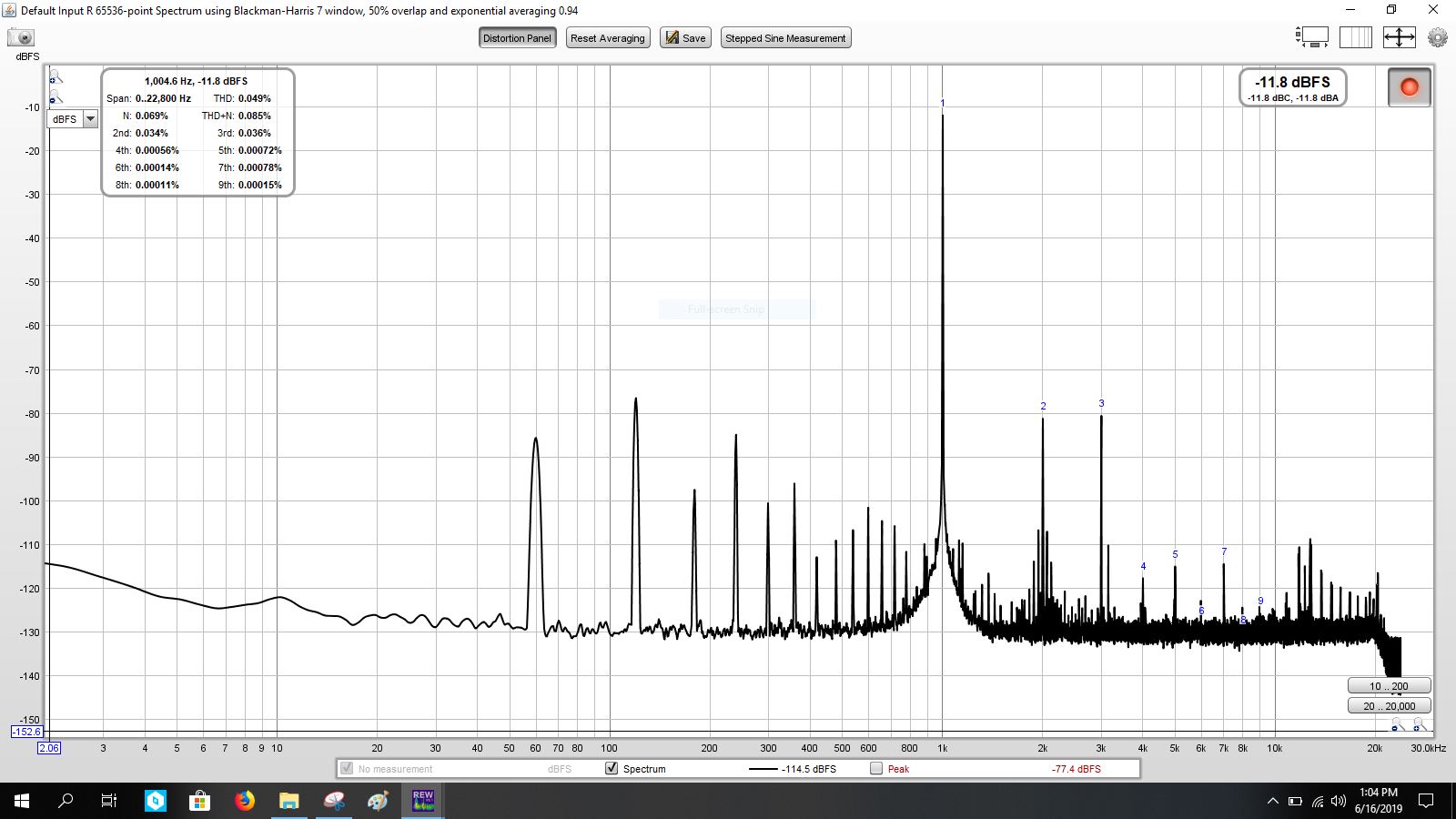

I spent yesterday chasing 60 & 120 hz noise, no luck. So, today I installed Ishikawa, here is the initial distortion analysis with RV1 at dead center.
Once again, the amp was allowed 1 hour to warm up, measurement at 1 watt @ 4 ohm load.

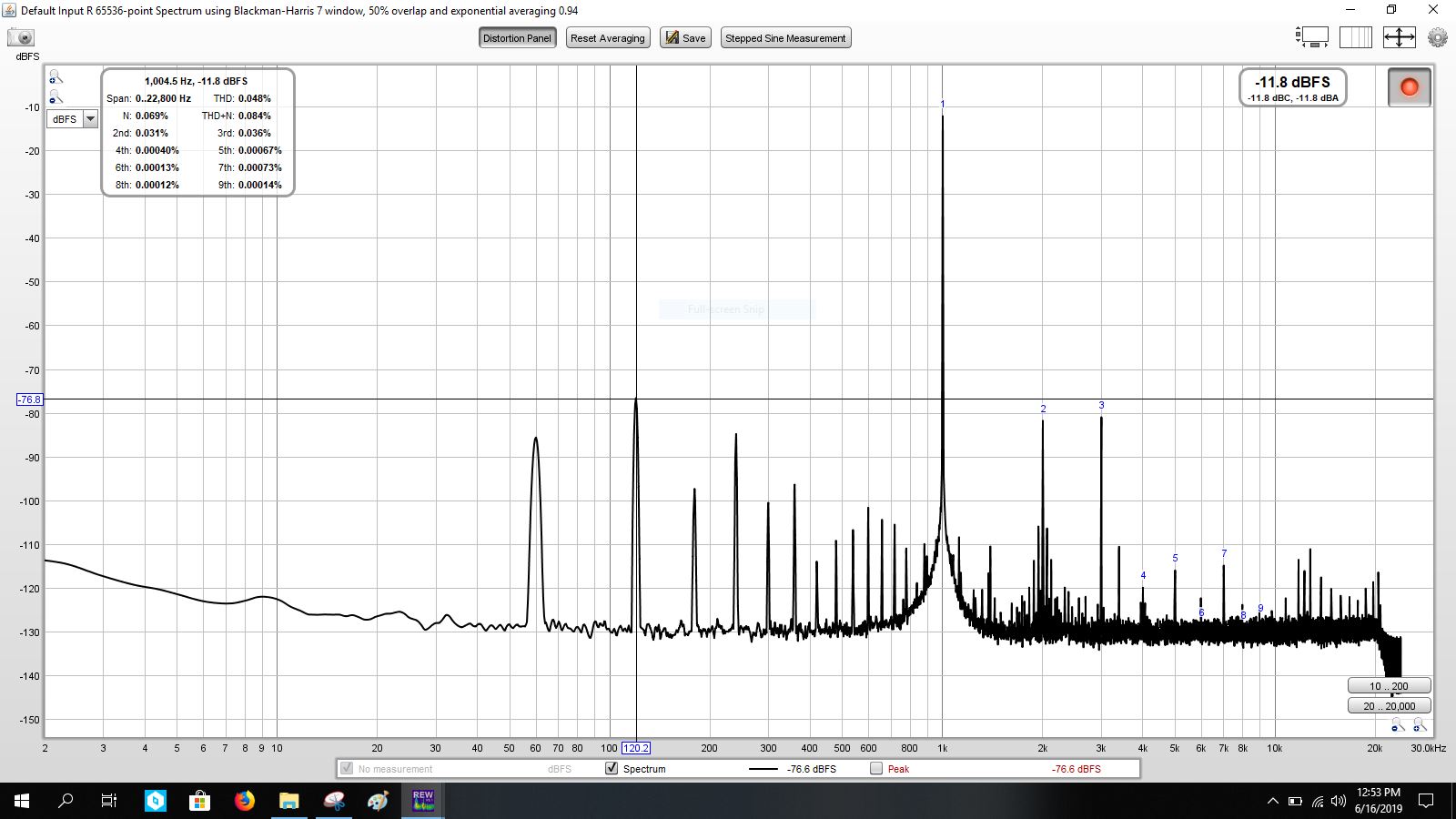

I adjusted RV1 for equal levels for 2nd and 3rd harmonic, within 0.001 - 0.002% difference. About 1 1/2 full turns CCW adjustment of RV1.
In regards to the 60 & 120 hz noise, I performed the following with NO heard or measured difference.
1 - Removed ground wire from EDCOR shield to ground, NC.
2 - Removed the ground from the Toroid shield and case, NC.
3 - Removed the EDCOR shield, NC.
4 - Moved the speaker ground point from the amp pc board to the power supply pc board, NC.
5 - Removed Zen Mod mod of run caps, NC (except the sound stage shrank as far as depth). I used piggyback spade terminals so I could swap them in and out.

Then it must be "Edcor pickup"......probably only solution is mu-metal shield?
If you ground output of Edcor (with shorted RCA input) …..then noise must disappear. It should be safe to do it at the "Edcor side" of C2?
Just to verify that it is not something else…….

Dead quiet even with ear to tweeter?
The 120 Hz noise is 65 dB down or so......it may look worse than it really is.
Enjoy music 🙂
Enjoy music 🙂
I rotate the volume control on the preamp to full volume, the speakers are dead quiet, no hum, hiss, etc.
Perfect! You are done, no need to worry, enjoy the amplifier!!
