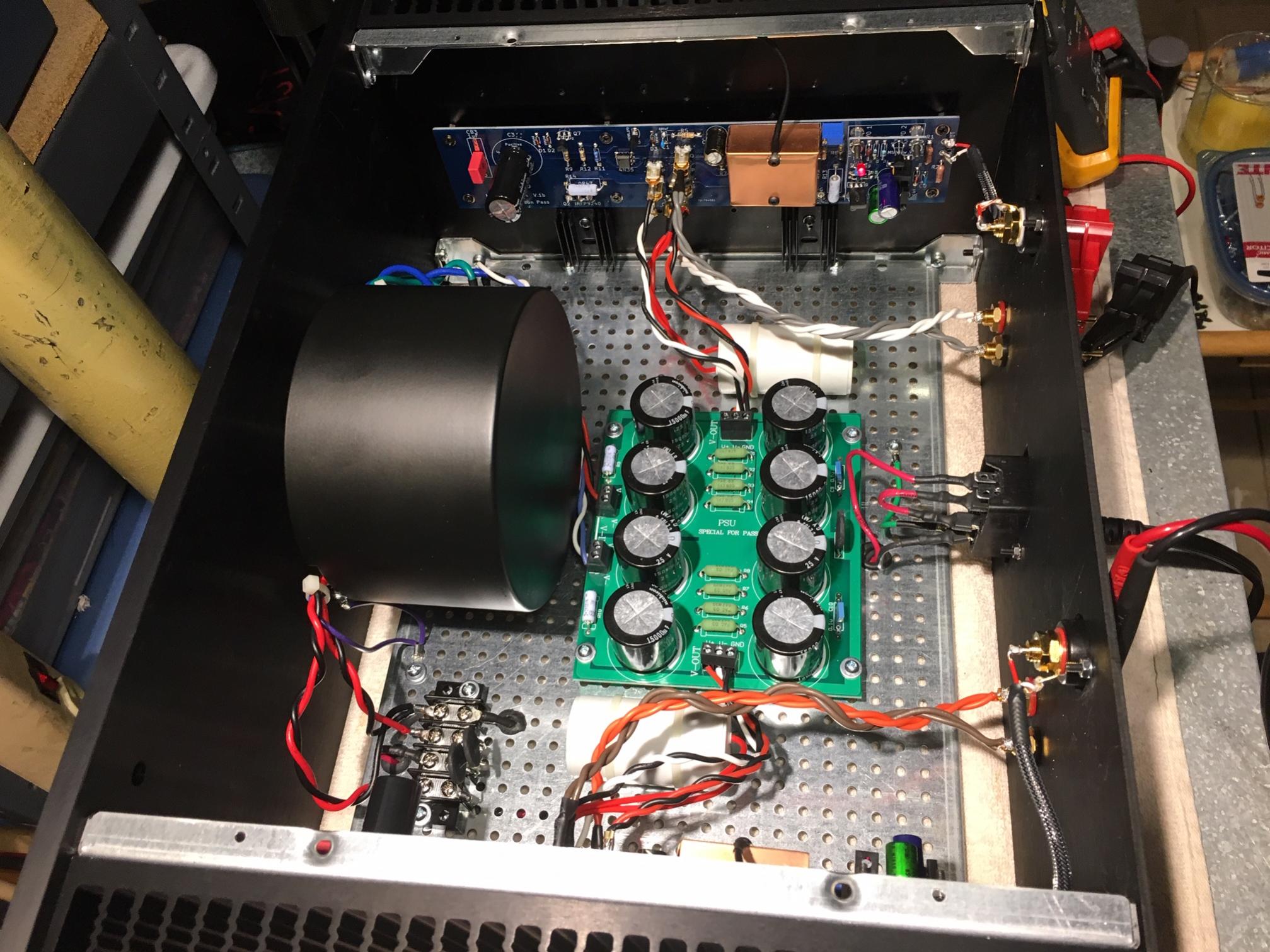

From the FIRSTWATT website, THD for the M2 is listed as 0.050%, noise is 500uV with gain at 15dB.
My M2X ripple measured from each diode bridge = 0.150 vac
Ripple measured at each rail = 0.050 vac (50 mV).
Since I built an F5 power supply, I checked in the F5 article and found ripple as 0.070 vac (70 mV).
Distortion analysis for Tucson IPS, 1 watt @ 4 ohms.

I have shielded Edcor with both copper tape and mu-metal foil and I am building the PSU's for M2X in the moment. The goal is to have very little 50/100 Hz at the amp output. Will see how all my efforts turns out. Need to make a power amp to Focusrite interface so I can measure the distortion. First try will be with Tucson input boards with OPA604 opamp. Seems to be an old classic FET input opamp.

Were you going to try the SLB power supply? It is the best Class A PSU I have ever used - it stops mains hum in its tracks. It has a bunch of extra ground spade terminals on the main star hub ground plane. Makes going to true star topology for grounding very easy. Also has built in NTC and bypass cap for connection to chassis/earth ground.
No....my approach is more "classic". I build mono blocks. The toroid has a magnetic shield and as I use 5U Deluxe x2 I have a lot of space inside so toroid can be placed far away from Edcor. I use DiyAudio store PSU board as basis using Cree Schottky diodes. Then I have extra LC stages using 2.5 mH / 10A DC filter chokes together with Jensen 4-pole caps as the last filtering. The simulation also say around 1 mV ripple at 2A current. Will post some pictures when I am almost there…..

My main intent with these measurements is to be able to adjust RV1 on the Ishikawa board. If Austin IPS has the same even 2nd and 3rd distortion, then I'll adjust RV1 that way. So far, Mountain View and Tucson have the same 2nd and 3rd characteristics, I hope Austin is the "three times a charm".

I think I may remove the ground wires from each shield and see how that measures. I agree, I'd like to get rid of the 60 & 120 hz noise, since the ripple measurement is better than what Nelson listed on the F5 power supply, I'm thinking ground loop issue.
Using REW and performing the measurements like xrk971 taught us, at least I have a tool to measure the 60 120 hz noise.
I was going to make a list of all the possible ground issues and then try them one at a time until......I go nuts!
