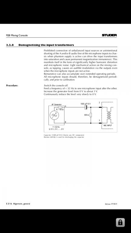

Is there a chance that Edcor can be permanently damaged by a large DC current…...like core gets magnetized?

even IF that happen , remedy is easy and simple
read enclosed , same applies - you just need (gradually) to bang it (point of signal xformer output) rail to rail (Vpp) and back to zero ..... and that's it (taking in account that there is some stage preceding xformer itself)
what amount of DC would cause permanent magnetizing of core certainly depends of actual xformer ...... though , I don't think that even manufacturer can give you exact values , covering all possible scenarios
NB - considering that there is preceding stage , amp must be on while performing process , but be sure that there is no load on output
personally , I believe that I would never practice that with my amps
