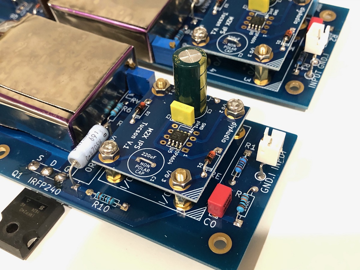

And here is my OPA1611 in the Tucson:

Boy that is a WEIRD looking electrolytic capacitor C3 on your Tucson board. Could it be a Sam Yong super discount capacitor from eBay by any chance?
It’s probably a fake “Sanyo” from Aliex. I didn’t have any other 220uF on hand at the time. This one is 50v rated. It’s just the rail smoothing cap so no audio signal flowing through it.

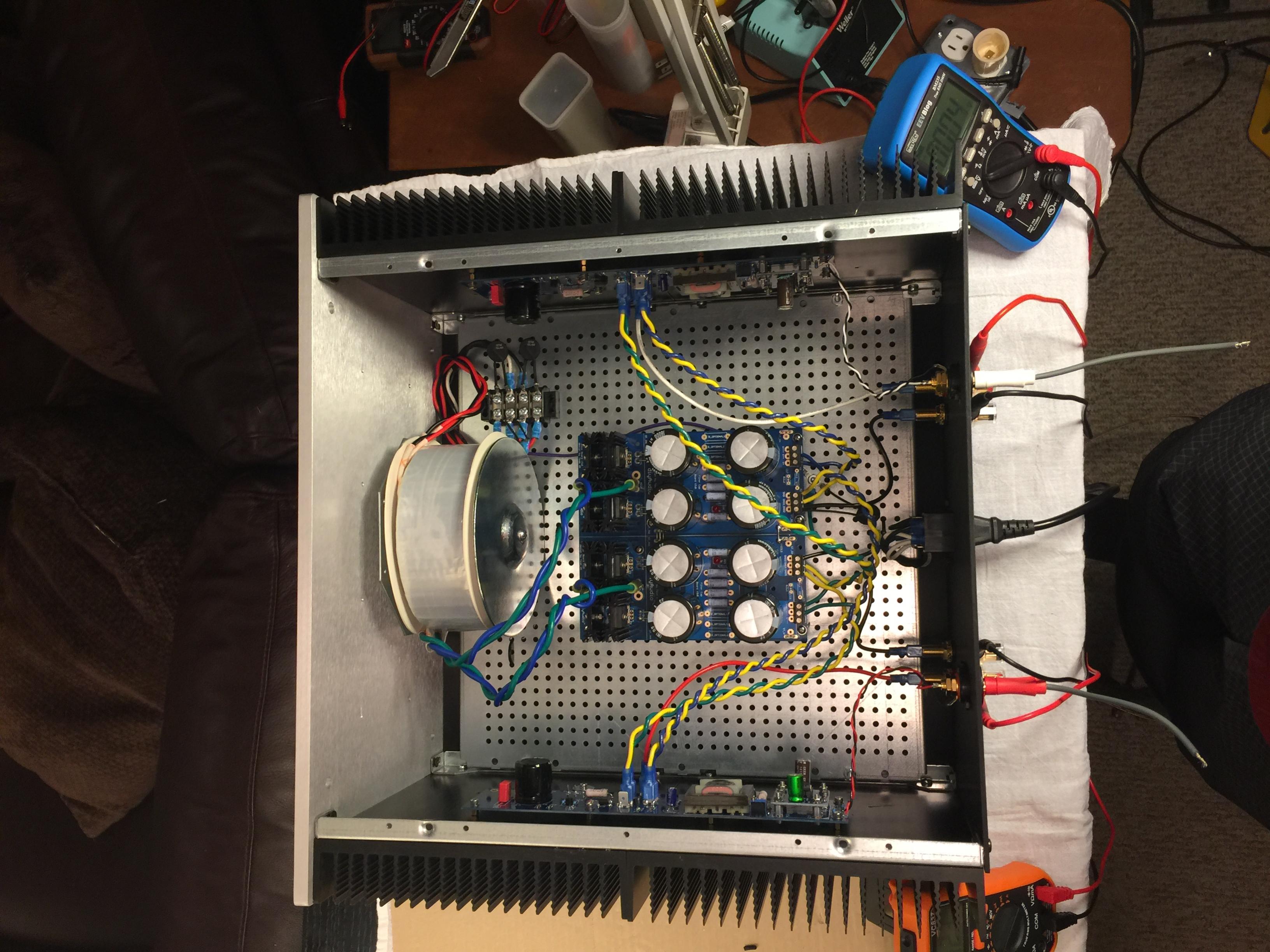

Here are a few shots. I was particularly happy to get the DC Offset to as low as my DMMs would measure. I'm sure it will drift, but simple pleasures.

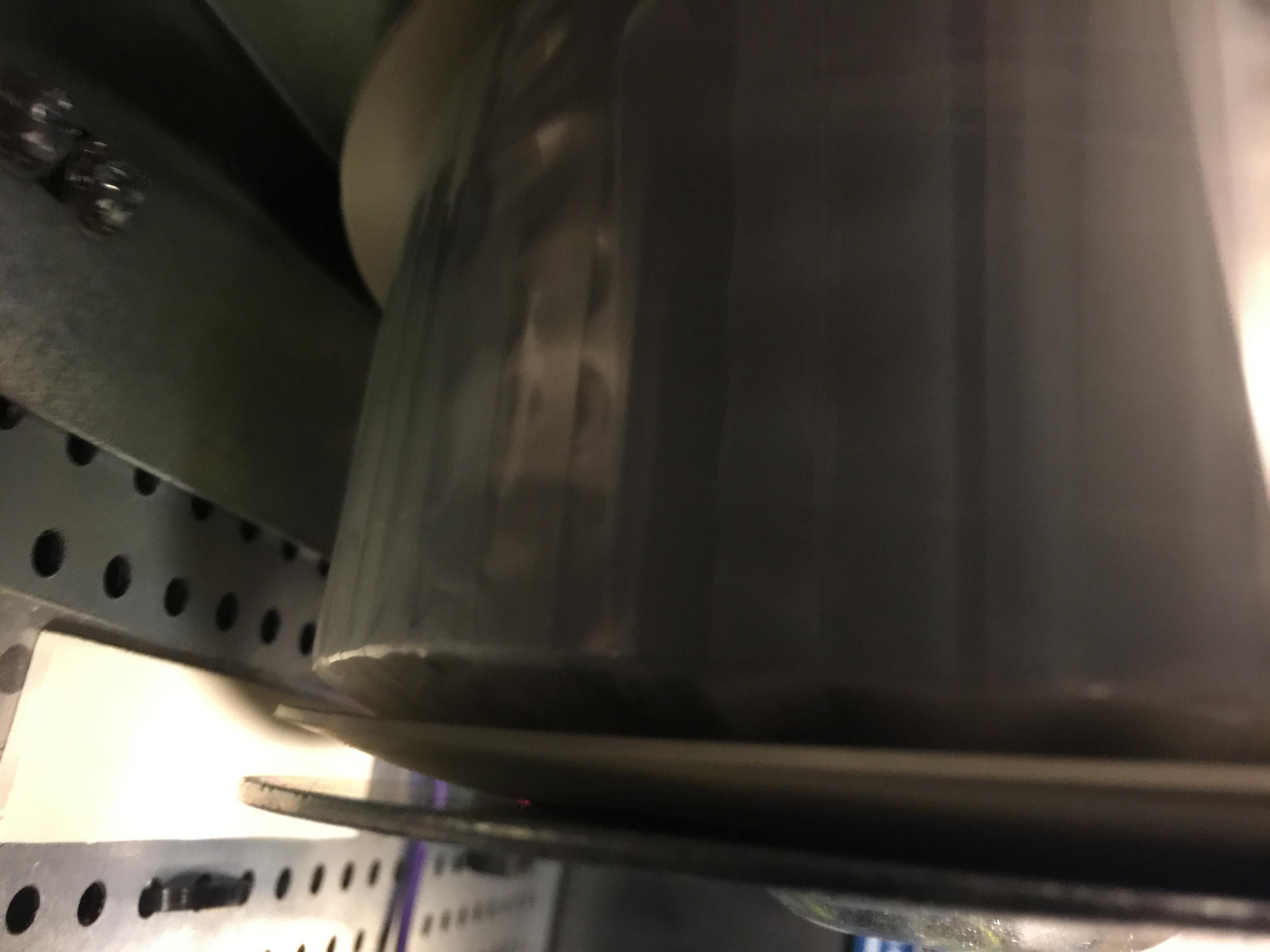

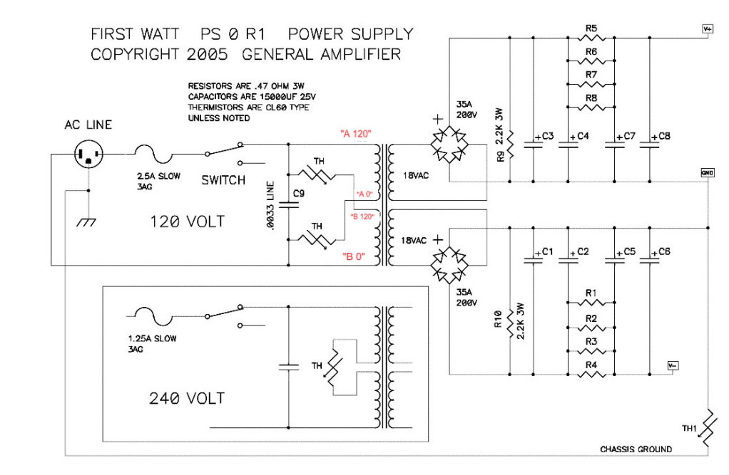

It looks like you have a shorted turn (look it up) in your transformer mounting, the metal retaining plate seems to be touching the baseplate, that's going to cause problems. Mount the transformer a bit higher on the bracket so it doesn't touch.
70C is much too hot for the transformer. That's just not right. Double-triple check everything again and see is there is an error somewhere in the wiring.

With a shorted turn, I am a bit surprised that your primary fuse didn't blow. Did you follow Nelson Pass's guideline for fuse selection?

@6L6 / Jim -
You of course were correct. I did a quick check to verify and sure enough, the top mount was resting on the base plate. I had no idea that this was something to be concerned with. I did a quick read on the term "double turn" / "shorted turn" - new information for me. A mistake I won't make again.
For those following the game at home - pic below of the result. I raised the transformer in the mount, and secured it tightly with a lock nut. For extra safety, I cut a piece of rubber from another mount and placed it under the top plate in the rare event it could slip down.
After about 20 mins it's running at ~47C. That seems much more reasonable. I'll leave it unbuttoned for another day just in case anything else crops up, but I think we're good to go.
