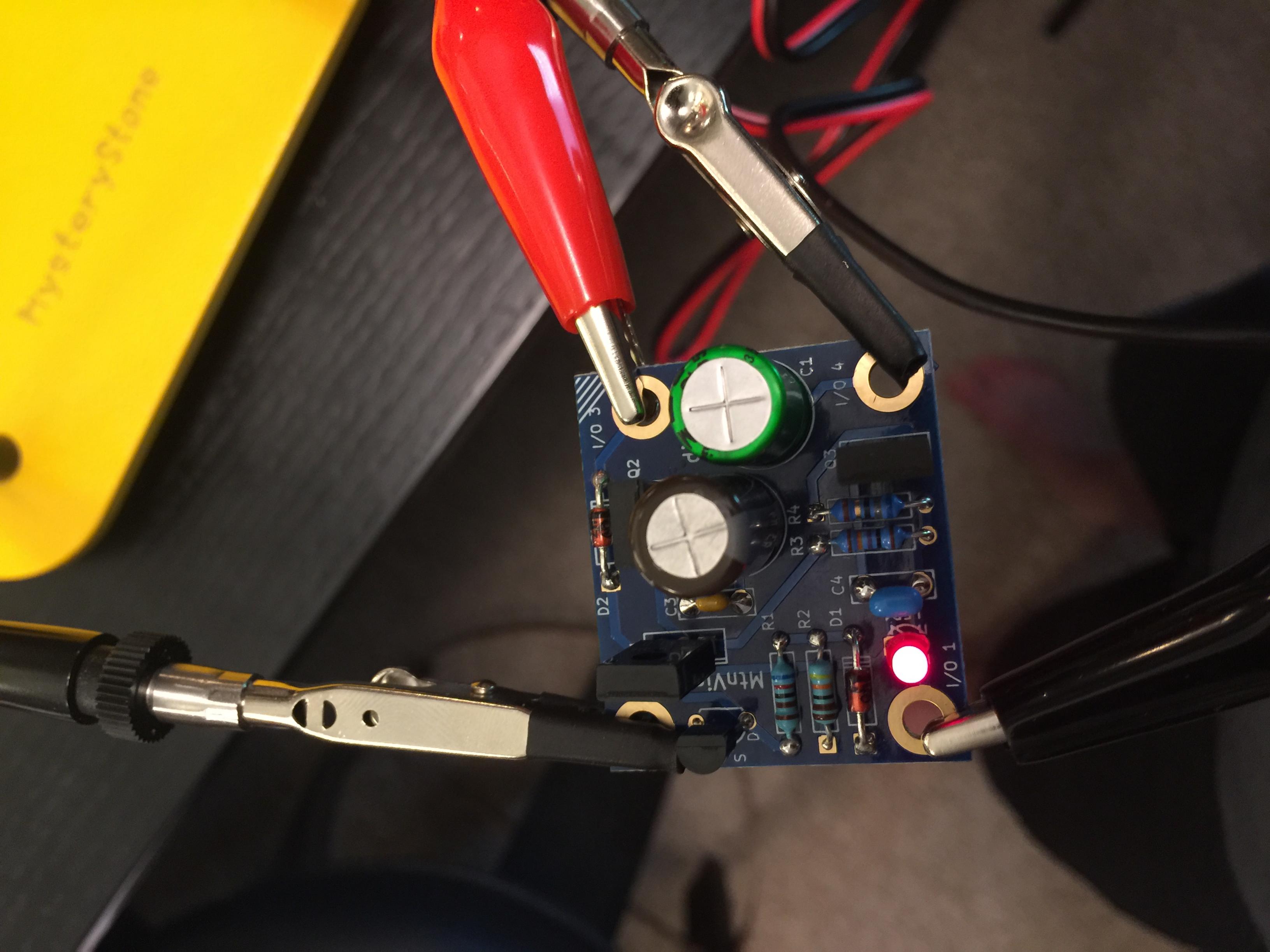

1) Set up my bench supply for 25.00VDC (verified with DMM) and current limited the bench supply to roughly 0.02A. That's about as low as it will go. The display I have only displays to the 100th of an Amp, and I am not sure how precise / accurate it is. No spec in the manual gives me guidance. I am not sure if current limiting the supply actually provides any safety net, but it made me feel better.
2) Checked the Mountain view boards briefly by applying +25VDC between I/O 1 and I/0 3. Positive to 3 and Ground to 1.
Verified that there's no magic smoke, no smells or anything that looks off. A lovely glowing red LED.
I'd like to learn a bit more re: how to measure the current draw. I reviewed the schematic, along with the previous posts. Clearly I incorrectly assumed that I'd measure between I/0 points 1 and 3. I checked between I/O 1 and I/O 3 and got no current. So, I stopped. I am using the DMM properly set to mA/uA scale with the leads in the proper locations on the DMM.
Any assistance to understand where the proper test points are on the boards for the overall current draw is appreciated. Any other thoughts for errors are also welcome. Still learning... 😕 but 😀

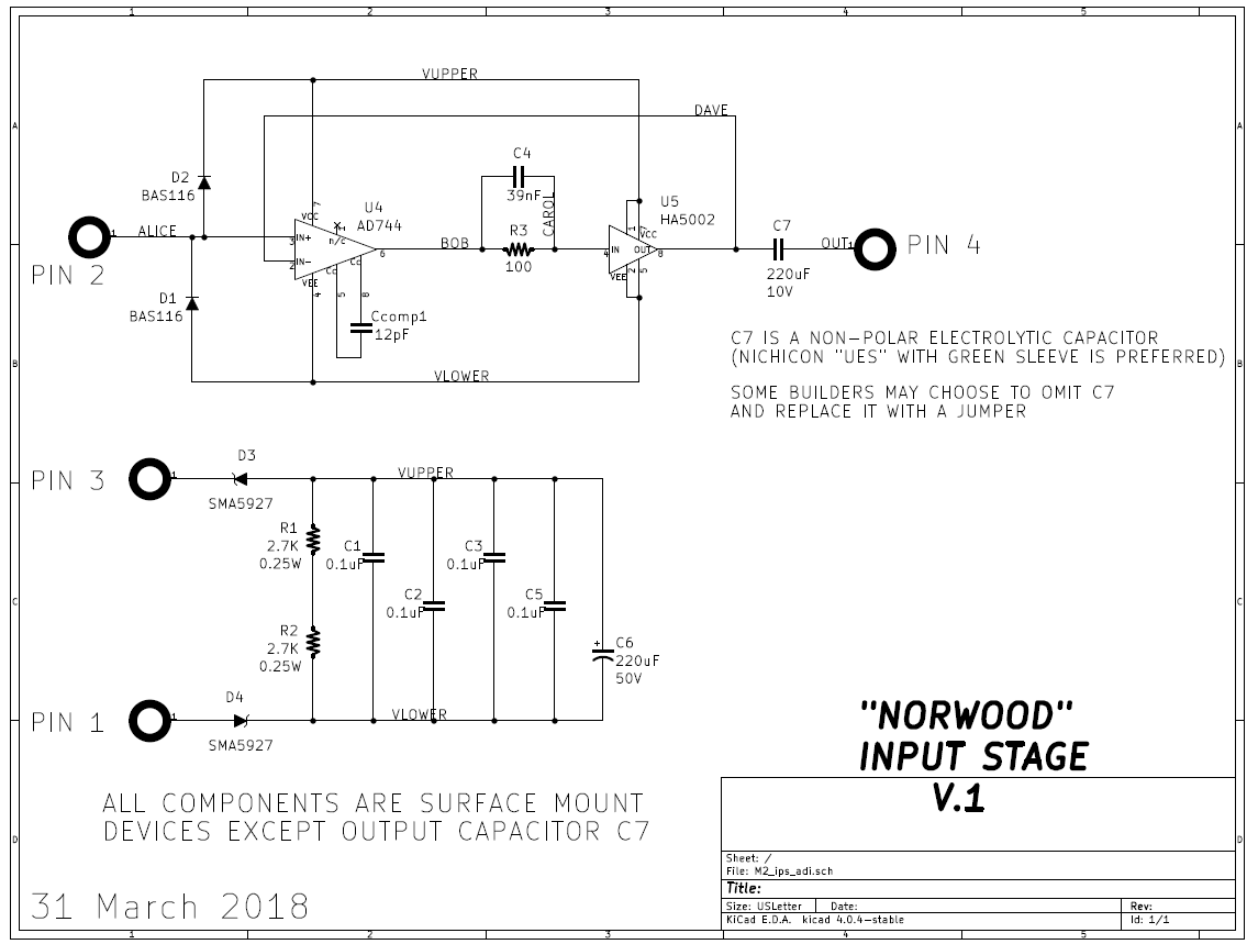

I greatly fear that you are trying to operate Norwood at an illegally low total supply voltage. Consider what's actually on a Norwood board (shown below). If you apply only 25V between pin 1 and pin 3, because that's the highest your power supply will go, then what voltage is applied to the integrated circuits themselves (VUPPER minus VLOWER)?
D3 and D4 are 12V zener diodes. Thus 12V is dropped across D3 and another 12V is dropped across D4. Leaving how much for (VUPPER minus VLOWER)?
The M2x daughter cards are designed for about 38V (min) to 50V (max) between the bolts called pin1 and pin3. "Testing" them at only 25V may not tell you very much.

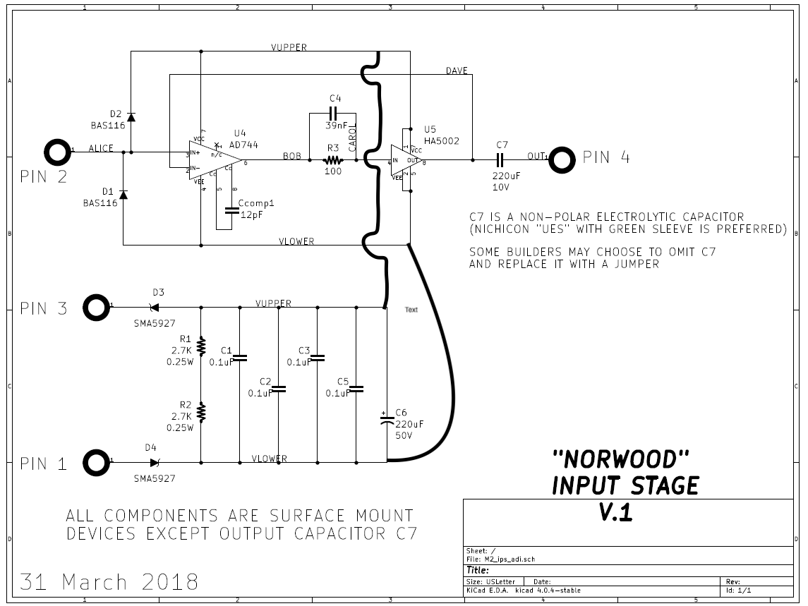

I'm at a loss for how the side of the circuit with Pin 2 and pin 4 ties to 1 and 3 through the amp board (even when I sit the amp board and the Norwood schematics side by side.
Note how "VUPPER" and "VLOWER" exist on the power section and the amplifier section of Norwood. These are common to each other, but the connections are not drawn in the interest of keeping lines to a minimum. I drew them below.
