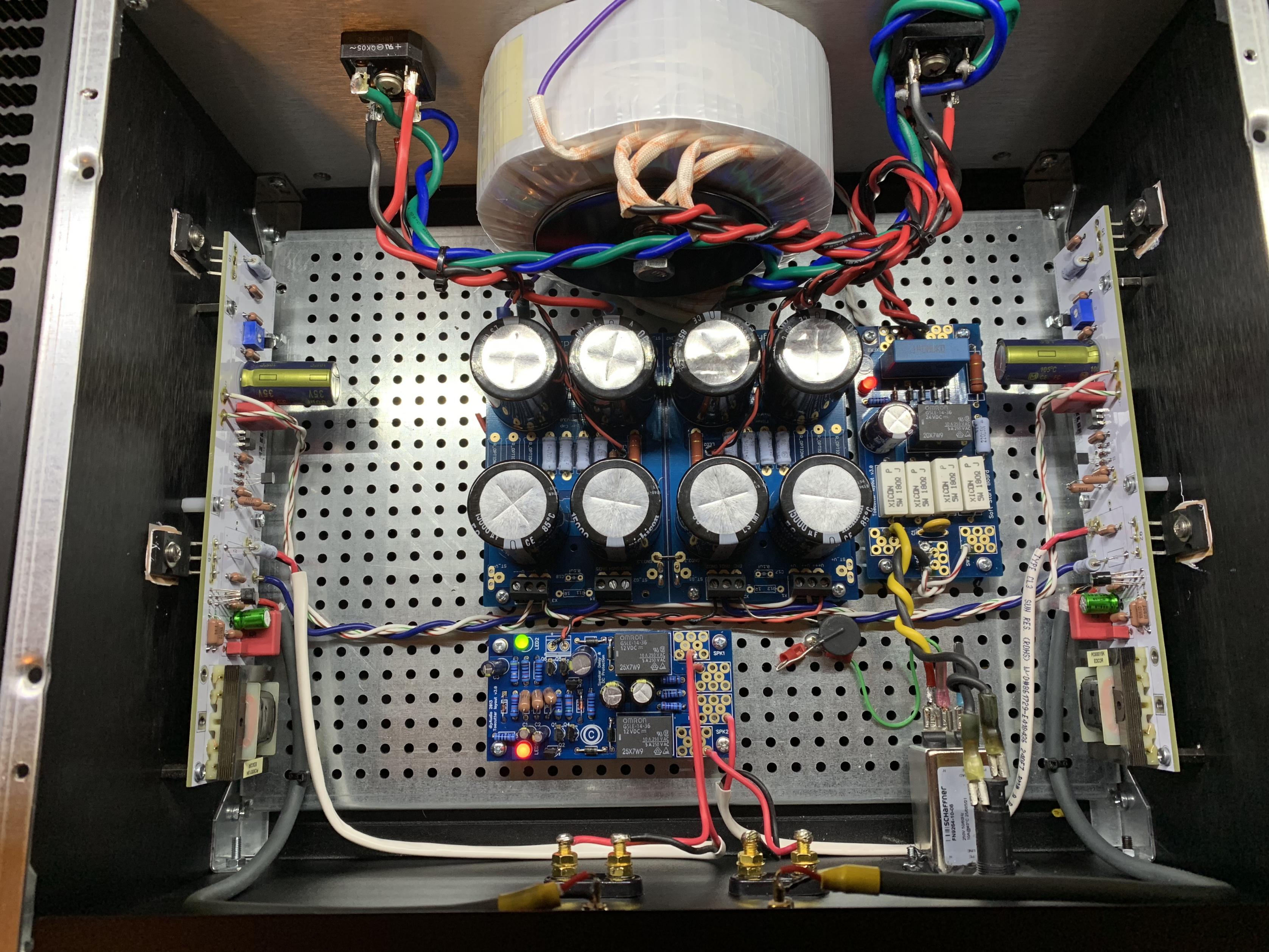

Just completed my build tonight, I have teabags boards in right now and building up the m2x for a comparison. Shielding wasn’t needed with the layout.
I used a 4.3k in series with R7 to mitigate the negative offset
This build puts out 22.5wpc at 1%THD

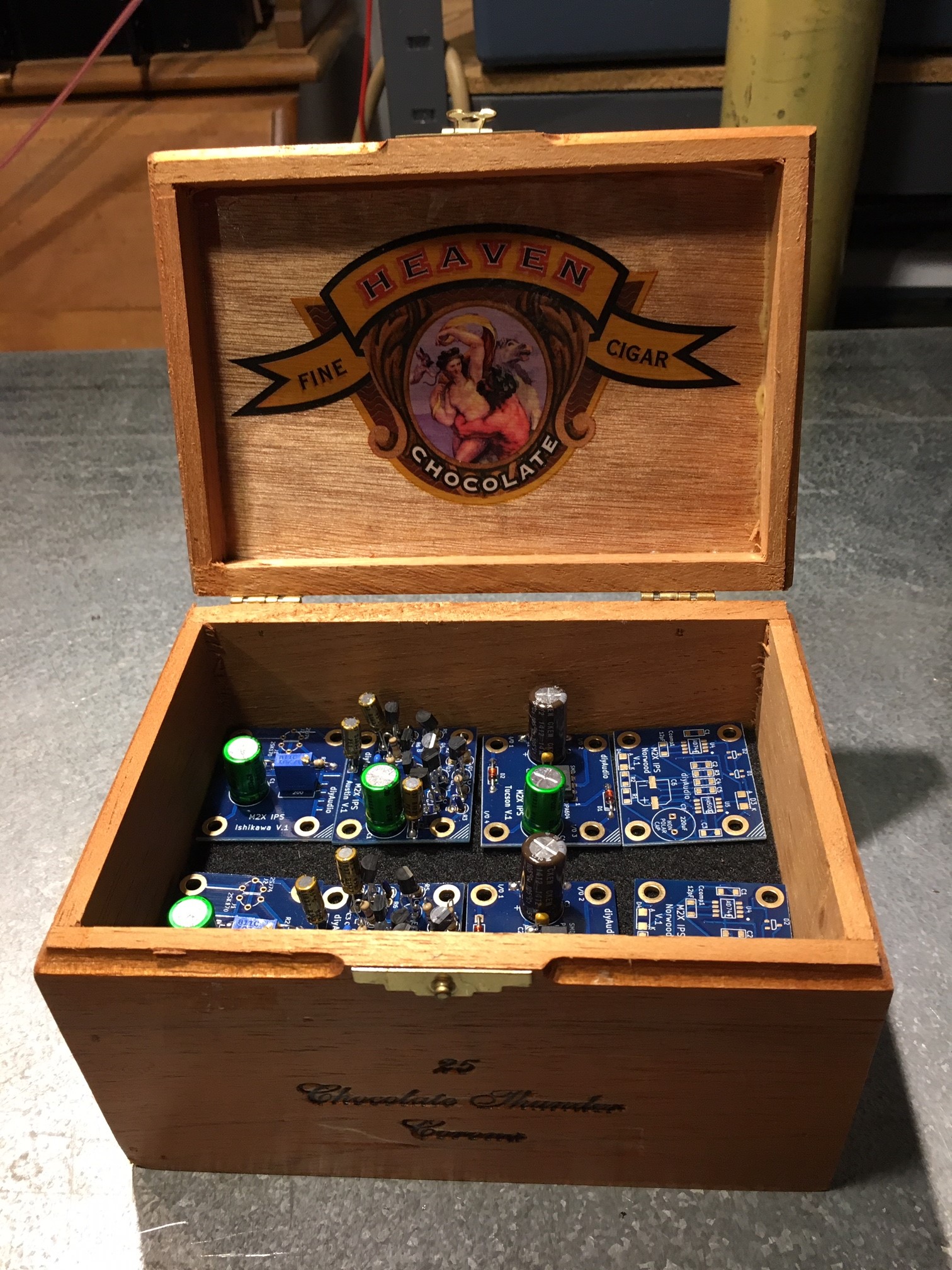

I spent most of the weekend listening to my M2x, what a difference compared to the ACA's. I'm very impressed by how quiet it is, no hum and very little noise at full volume only. Still using Mountain View and will continue for the next couple of weeks.
I found a nice wooden box to hold all the daughter cards, I like amplifiers with accessories.

That's a great box for the IPS boards!
The M2x is definitely a step up from the ACAs, even the ones that I've done a lot of extra work on. I've added some additional capacitance to the linear power supply of my ACA-220 v2, and it is now as quiet as my M2x. I still hear a wider soundstage with my monoblock and dual-mono ACAs than with my M2x, but that's dependent on which IPS I have in the M2x.
So far my Mtn View with the 2.048V precision reference IC has the blend of detail, dynamics and imaging that I prefer for most of my listening. The Ishikawa is a very close second, and only because it lacks the imaging detail that I get with the Mtn View. The Ishikawa has a wonderfully clean and dynamic tonal presentation, similar to the SMD Tuscon, but not quite so analytical. Today I will be testing some thoughts with a new pair of modified Ishikawa IPS veroboard prototypes that I built.
