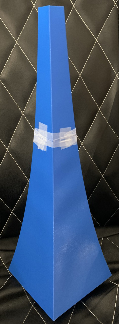

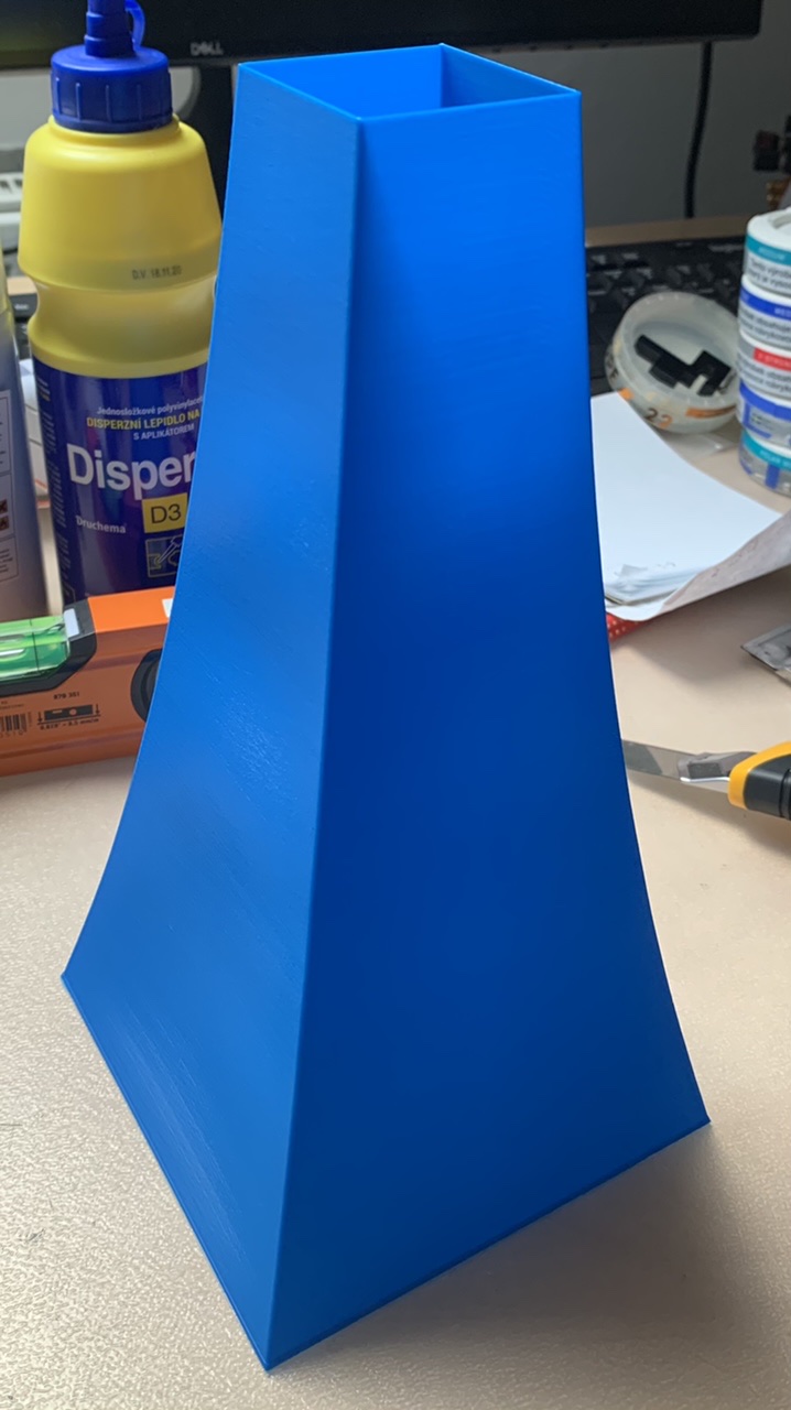

Proof of concept - lower part of a single cell printed in vase mode (PLA). With 0.4 mm nozzle, it feels a bit fragile, but might work when glued together and filled with polyester resin. Wall thickness is around 0.5 mm. I will try to print with 1 mm nozzle from PETG for a little extra strength. With a large nozzle, one cell prints in ca 2 hrs in two parts and consumes around 100 g of filament. A pair of 5x3 horns could be printed with 4 kg of filament (the extra spool would be for the adapters).

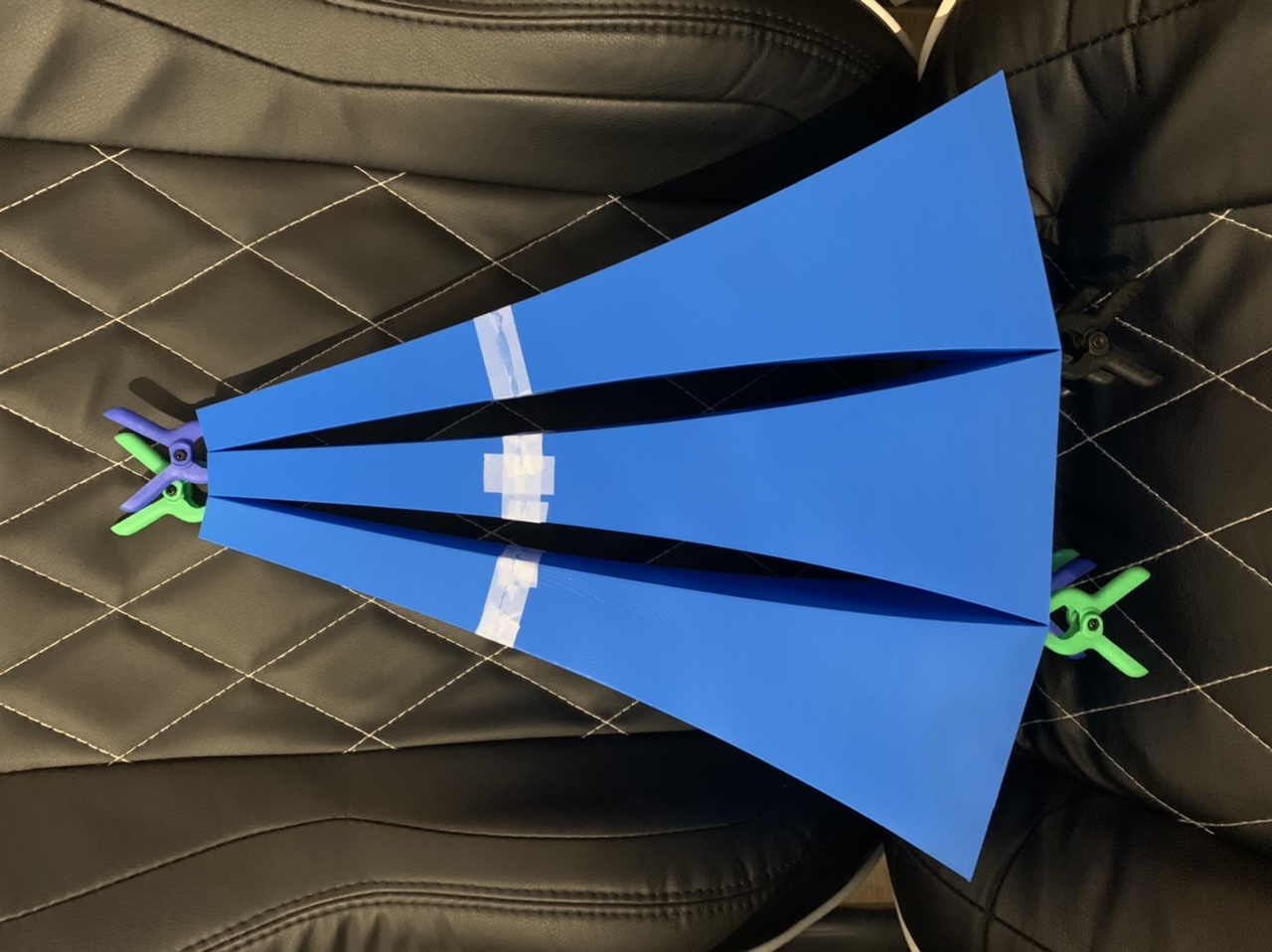

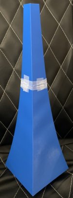

PLA seems to be the way to go. 50 g per cell, only the printing time is longer. Glued with CA glue, secured with tape. I will now print two more to test the 3 piece sub-assembly with resin.

I am printing from leftover filament, so the prototype will be an ugly multicolor monster🙂 I was advised against poyester resins - in the end, the casting material will need to be tested anyway. I have three cells printed, they need to be glued together and also test prints of the front spacers will be done today. And then, there comes the nightmare of 3D modeling the adapter for the driver🙂
