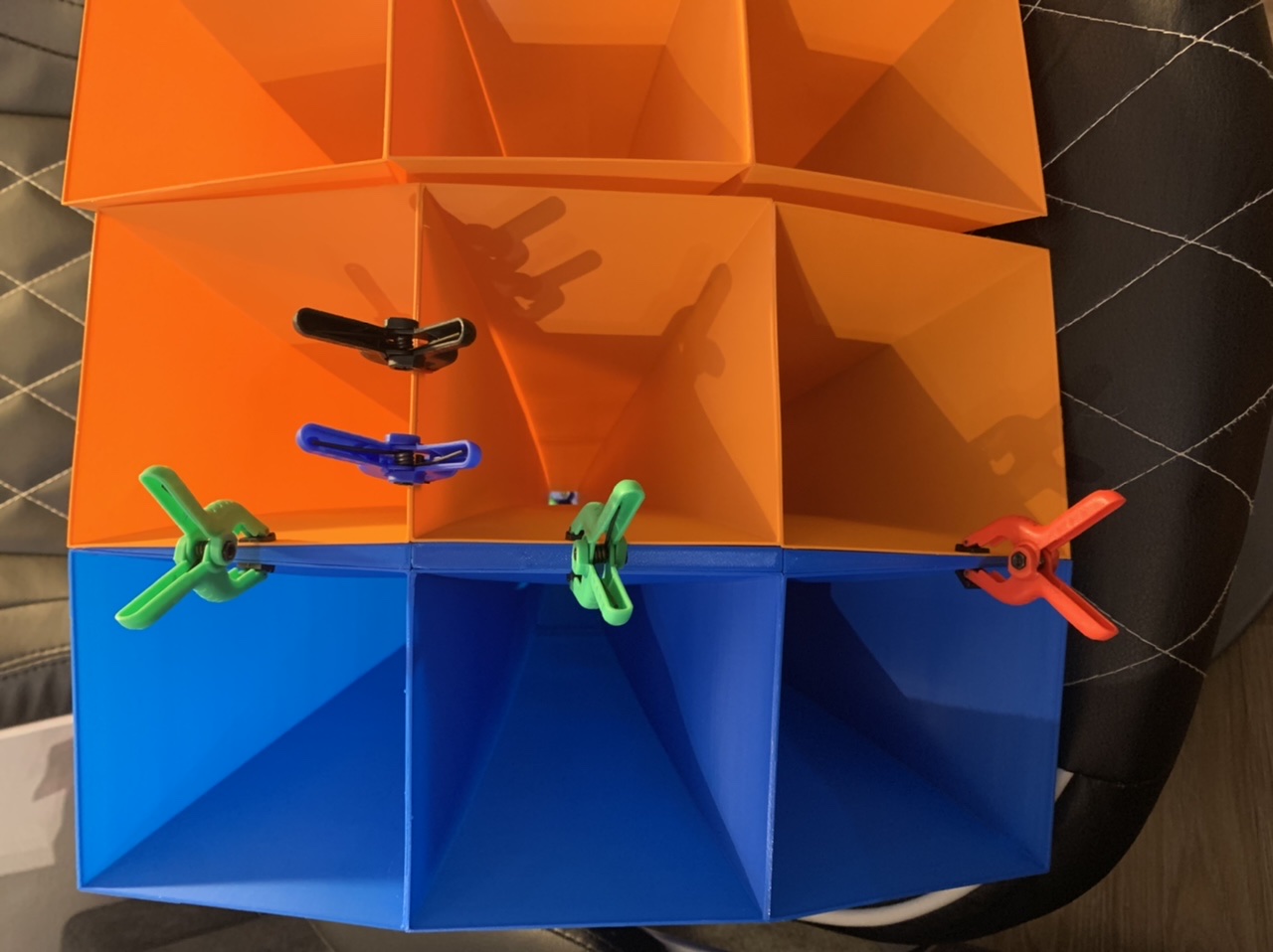

Dry fitting the front spacers. You can see that I did not glue the cells together perfectly. Luckily, the plastic is soft enough not to matter much. 9 cells printed, 6 more to go.
The front spacers make the mouth pretty stiff. I hope the casting will also make the walls stiff enough. Stil not decided on the material, casting with liquid silicone sealant seems to be a good option now.

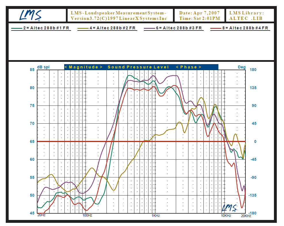

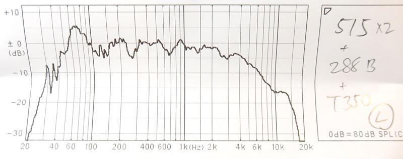

Here are some graphs;
OBJ's ( over at LHF ) old 288B's were mounted onto 1005 multicells ( if I recall correctly ).
- One can see that example #2 had a surround that was suffering from a case of extreme "work-hardening" ( or something similar ) .
This interesting pic is lifted from a french forum ( a 288B on a 1505 ).
- I have a hard time believing the T350 was actually working.
One can see ( hopefully ? ) that the spreading of the HF energy into large quantities of individual cells creates the need for some sort of Constant Directivity "like" compensation .
1-That extreme LF loss with a HF peak would likely result from a frozen diaphragm, from a shifted pole piece or top plate, or a chunk of debris or corrosion stuck in the gap.1- One can see that example #2 had a surround that was suffering from a case of extreme "work-hardening" ( or something similar ) .
2- This interesting pic is lifted from a french forum ( a 288B on a 1505 ).
3-One can see ( hopefully ? ) that the spreading of the HF energy into large quantities of individual cells creates the need for some sort of Constant Directivity "like" compensation . 🙂
2- The T350 has about 104 dB sensitivity at the top end, the 288B mid-band more like 115, so the little top end shelf may be the tweeter response- or not, impossible to say from the chart if the tweeter was in phase (adding SPL) or blocking the HF response of the 1505's center cell. The EV-T series diaphragm alignment and depth is particularly sensitive to error, which can result in huge (-3 to-10dB) sensitivity losses.
3- Yes, though the HF EQ boost won't change the HF cell "fingering", if the 1005 was measured "on-axis", the amount of HF compensation may be less than the chart would suggest.

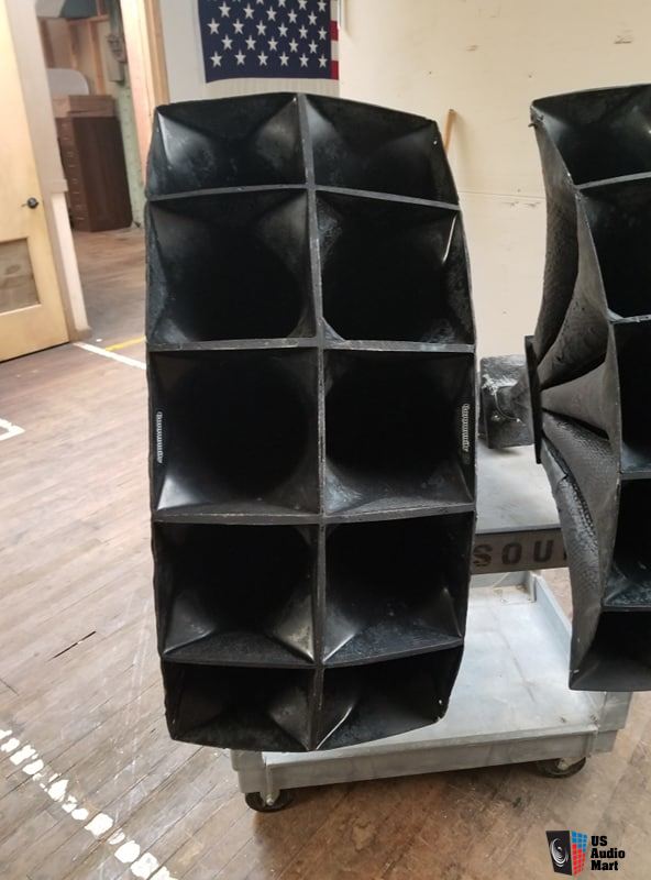

I've never seen a multi-cell where the cell throats where anything other than square, like the cells themselves.
Yeah, at the time I posted, all that I could remember in detail was some with round throats, but in retrospect thinking it was some Jensen 'K' series multi-cells, though the main thing was it sounded better overall than my then ex-cinema 805 tar filled, which I don't recall ever taking apart except at the drivers to have them refurbished, i.e. my not fixing what ain't broke mentality at the time.
GM,
You might be remembering these;

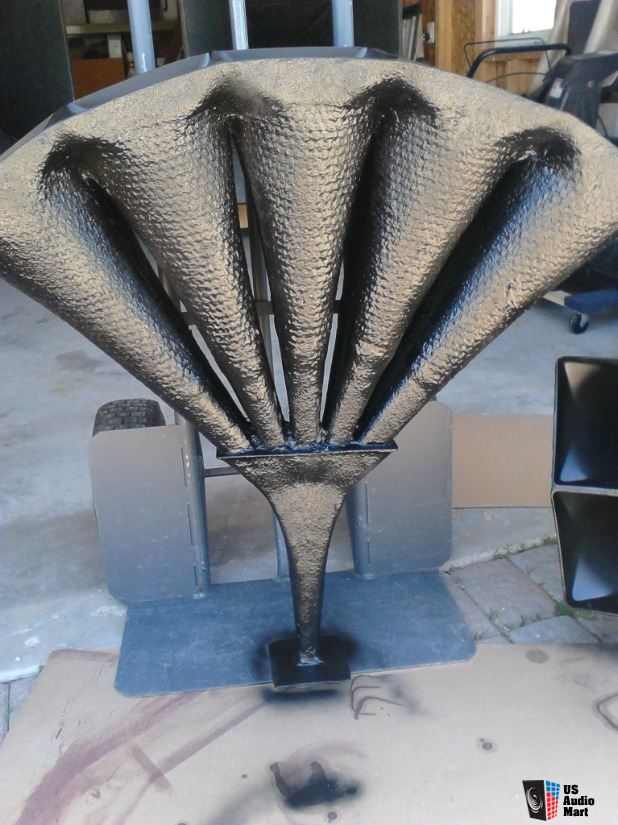

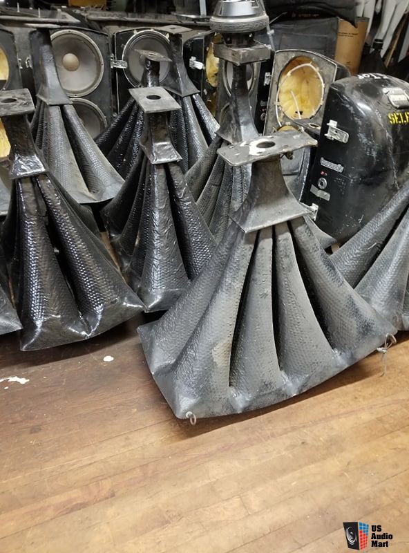

2480241-c2989d21-8-or-10-cell-250hz-large-multicell-horns-pairs-for-altec-tad-jbl-1-14-2.jpg81.6 KB · Views: 976
2480243-1e6c65db-8-or-10-cell-250hz-large-multicell-horns-pairs-for-altec-tad-jbl-1-14-2.jpg57 KB · Views: 1,011
2480244-ce6ddf07-8-or-10-cell-250hz-large-multicell-horns-pairs-for-altec-tad-jbl-1-14-2.jpg93.9 KB · Views: 941
2480246-bb4be95e-8-or-10-cell-250hz-large-multicell-horns-pairs-for-altec-tad-jbl-1-14-2.jpg62.8 KB · Views: 978
2480245-ab475d30-8-or-10-cell-250hz-large-multicell-horns-pairs-for-altec-tad-jbl-1-14-2.jpg113.9 KB · Views: 930
Yes Earl, I thought of those horns when GM mentioned round. I've never seen those in person and have wondered what they did at the cell entrance. If the are round then it leaves a lot of gap between each cell. I'd love to see and hear those.
