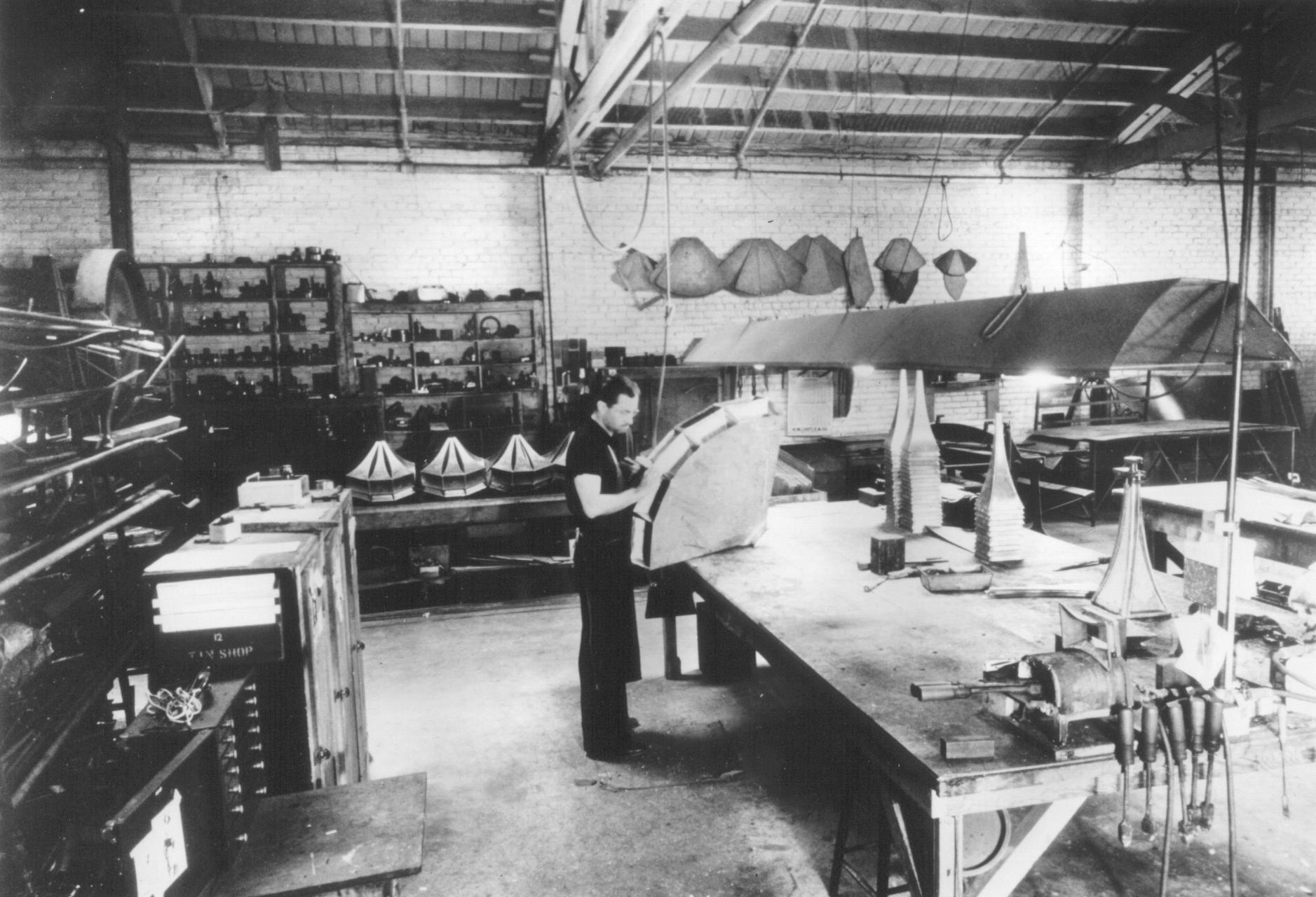

You got to go aways further to keep up with the pioneers as they hand seam soldered individual tin pieces:
Would have loved to see this in process. This is my favorite description of diy multicells its from Audio, 1947. It details the entire process and at one point states "A complete horn should be built in about 8 hours time" - :p
