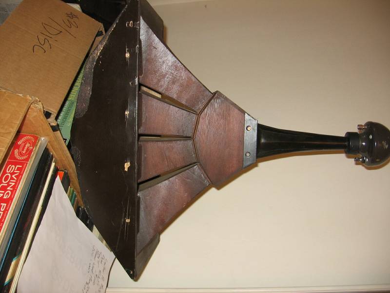

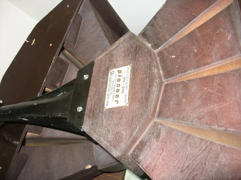

To clarify a detail of the spreadsheet. The throat section is calculated to be of the overlapping style as seen in the photo below. If you want to make the more familiar Altec style with a flange, you would stop the throat at 10cm.
