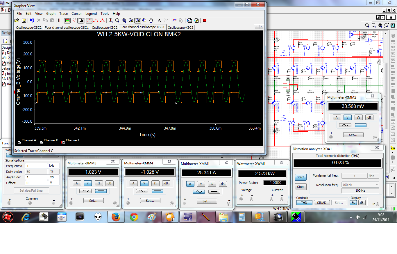

hello all.
am planing to make the 1500w class-h amp. i have a
82-41-0-41-82 with 15v and
19v toroid trafo weighing about 9.5 kg. i want
to diy the amp from
start to finish. i just need a few questions sorted
out.
1 what is the bias voltage?
2 the schematic shows that 1 uf4007 on the bias section is not
applicable buh the pcb layouts show it is. may
i know the one is correct
3 can i use mbr20200ct diode in place of
stps20sm100s?
4 what equivalent diode can i use in place of
bas21 because in my country its not there.
5 of all the zener diodes on the schematic only
1n4744 is there in my country. i believe these
are one watt editions. can i use 500mw
type in place of all the zeners or any equivalents i can use
6 the 220 and 150 ohm presets are marked
with 40%. am asking what it means
sorry for many questions i just want to be sure
when making that am
fed with expert advice.

i think :
1. bias v to gnd 1v - 1.25v max or 2,5v max b to b
2. uf4007 replacement with byv26e or other
3. stps20sm100s repllace with mur 1560
4. bas21 can be replacement with bav21 or 1n4148
5. use 15v zener 500mw 2x is simple technics
6. 220r vr is dc offset adjustmen then 150r vr is bias voltage adjustment,..
with 40% rotary position u can get max dco and max bias volt,..
7. i try simulation with MS13 voltage rating 160vrms/80vrms get 2600wrms 4r load and u need 2,6 kva toroidal transformator...
8. i hoppe this can help
warm regard,..
