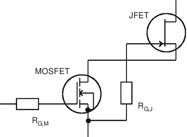

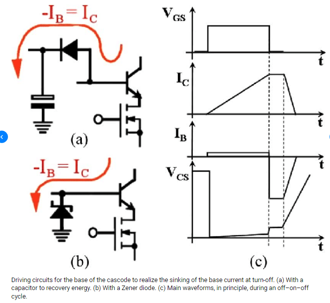

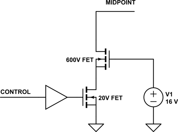

Thats no problem, very easy with self oscillating amp to synchronized circuitry
At +/-160 volts your can’t get away with just two FETs - 400 volt mosfets have too high an RDS(on)
Yes thats true, but problem solved due cascoded Mosfet driving +/-170 V DC without issues
hey malta do you have a link on a forum about cascoded fet driving in a class d amplifier? kindly shareThats no problem, very easy with self oscillating amp to synchronized circuitry
also is cascode driving of fets any advantage on kasd class h or any class h amp?
due the copyright I cant post it here
170 V DC Rail - 2500 W 4 OHM
4x 200V Mosfets cascoded without issues
