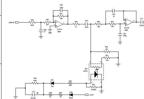

When you say 'light weight', the crown still weighs 77 pounds. QSC has a line of amps in the 20 to 30 pound range. Are these transformerless? In the 80's, there were theatre powered subs using the AC line as B+ and B-. Opto-isolators on the input.
I want no part of that for my home theatre system, Ground loop problems and speaker outputs tied to the AC line.

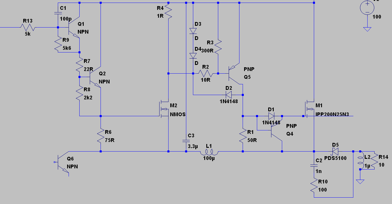

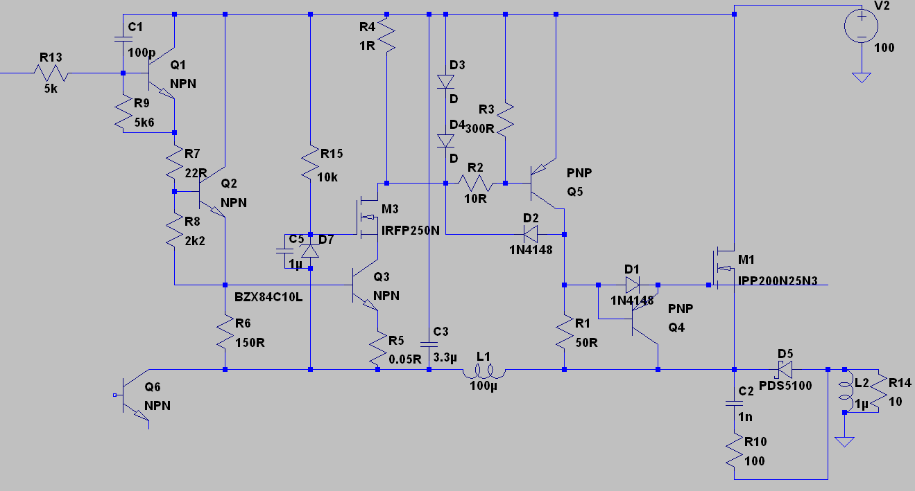

After glancing at Labgruppen and Yamaha eengine I'm eager to make something like that, i.e. adding a tracking downconverter or whatever this thing should be called.
Going Labgruppen way with a clocked PWM running at over 500kHz looks overkill for a DIY prototype, surely Yamaha'sEengine looks more attractive. However looking at Yamaha's EEngine downconverter cell I wonder: why do Yamaha's engineers use relatively slow and pricey BJT's in the current amplifier (downconverter 'G'-class part that powers output stage during high speed transients when the buck converter can't keep up with OP stage needs) and run it at pretty high Vce?
I think it's easy to make the downconverter cell more robust and even cheaper by replacing BJTS with MOSFET + BJT cascode combo this way (it's possible to use lower voltage BJT at much lower Vce to aid with SOA and use a mosfet that's don't suffer from second order breakdown plus is much faster) or just a MOSFET.
I'm attaching pics to illustrate what I'm about.
Any thoughts?
P.S. Can someone name other makes/amp names that use downconverter cells to supply OP with available schematcs on the Net which are worth to study?

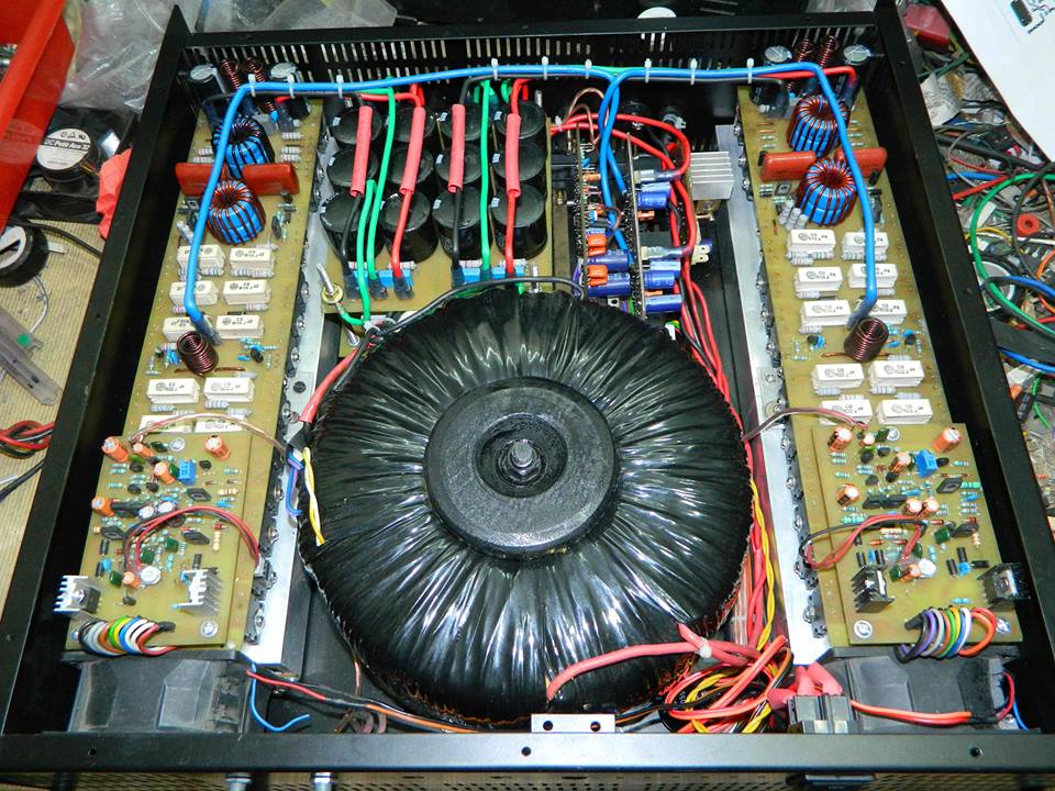

HD CLASS T5N
My diy efforts YAMAHA HD CLASS T5N with input signal limiter and overcurrent
protection want to diy labgruppen TD class
My diy efforts YAMAHA HD CLASS T5N with input signal limiter and overcurrent protection
What stops you from doing that? There are schematics for FP series amps on the Internet and even pics of the board to aid with layout.want to diy labgruppen TD class

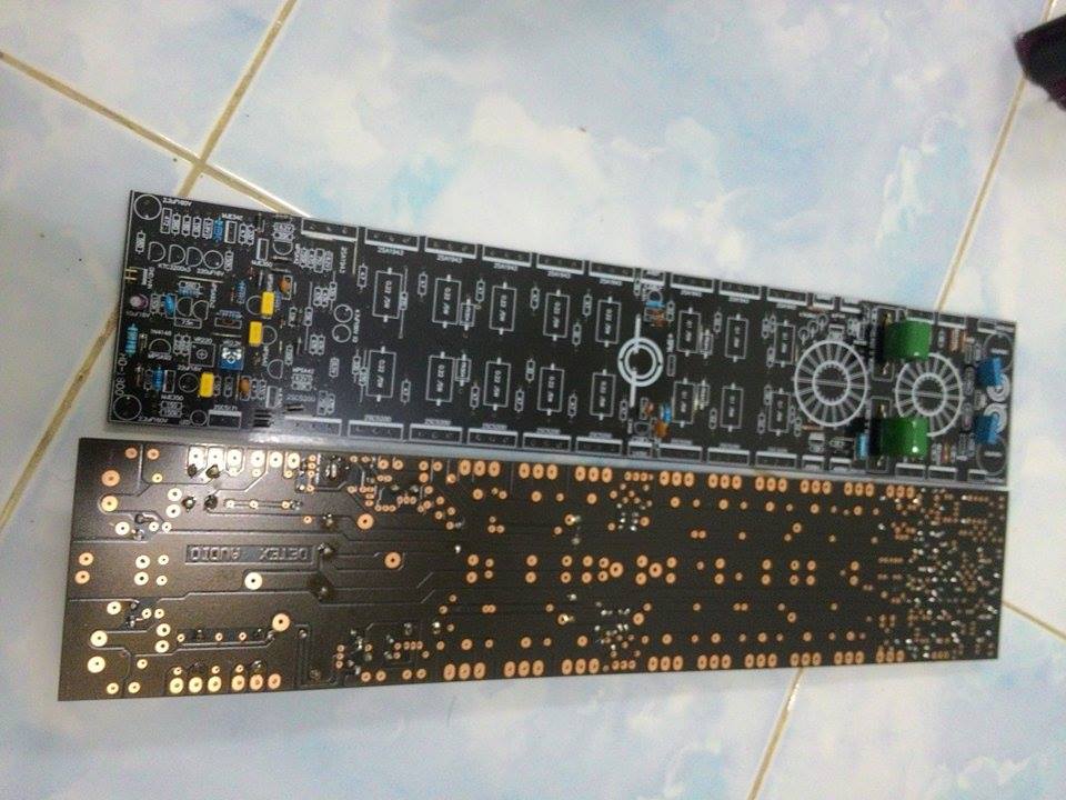

hi hypertiger did you start the forum??
i am planning to do a class h 3tier or simple class td not massive with many transistors like andrews hd but simple one like labgruppens td . please post a shortcut of the forum..
