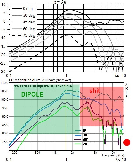

http://www.dipolplus.de/thema4.html ( I painted over Finke's pic)
Juhazi is on point here. What you want are the lines to be parallel, like in the green area of the lower plot. When the lines cross, you are getting nulls or beaming, and this is undesirable. The b=2a case is about the upper limit to the baffle dimension. As baffle size increases the "****" just gets worse, and with diminishing baffle size it goes away.

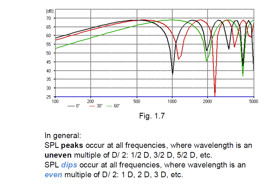

Sound waves cancel each other even if the wavelenght is shorter than baffle
Actually we both right as both things happen at same frequencies so it can be said that diffraction for OB manifest itself as -6dB slope below first dipole peak and series of peaks and dips above it. The difference between box speakers and OB is in that the box speakers have baffle step and OB has full cancellation below first peak. Above first peak there is diffraction ripples for boxes and much stronger peaks/dips for OB.

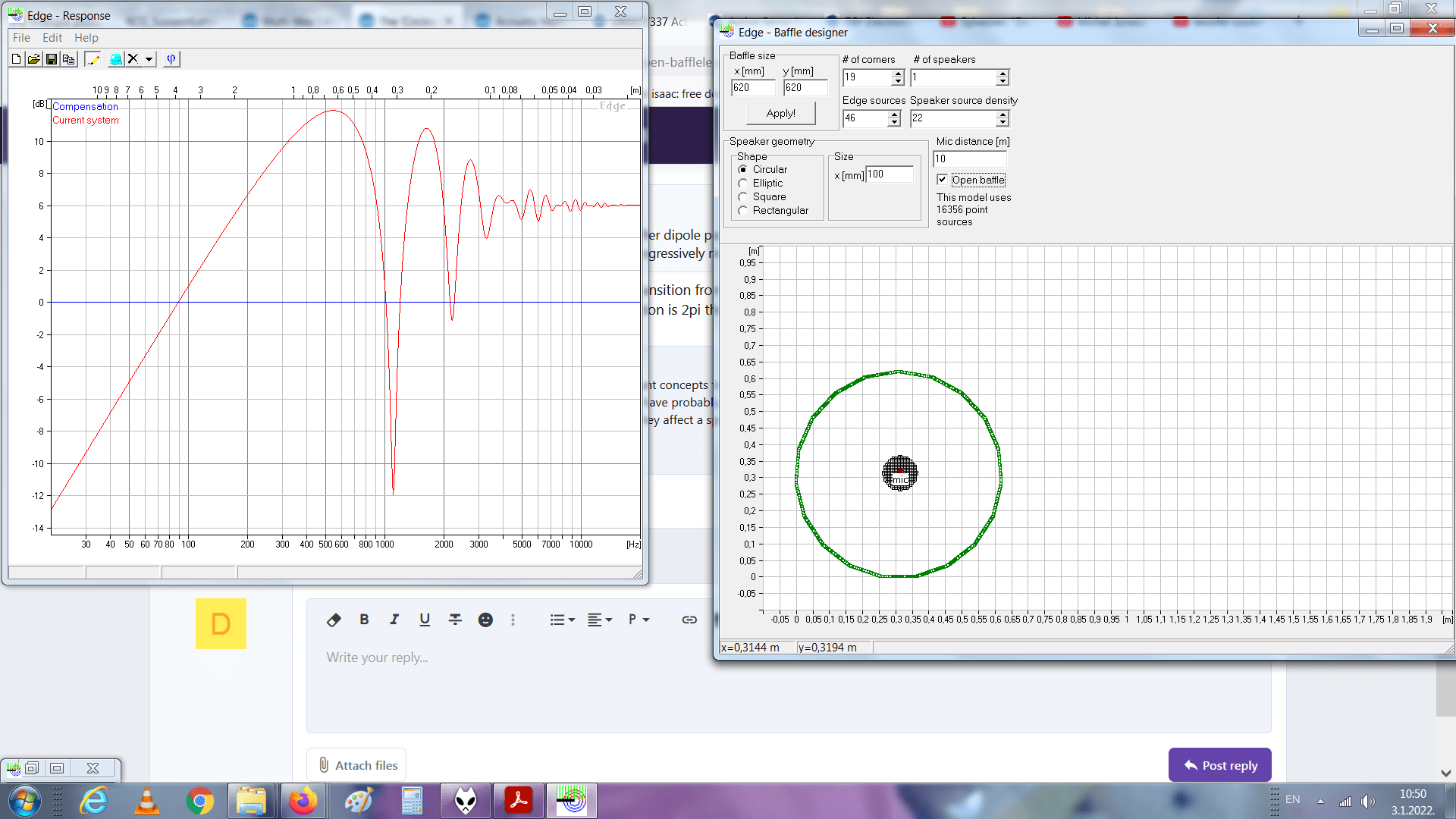

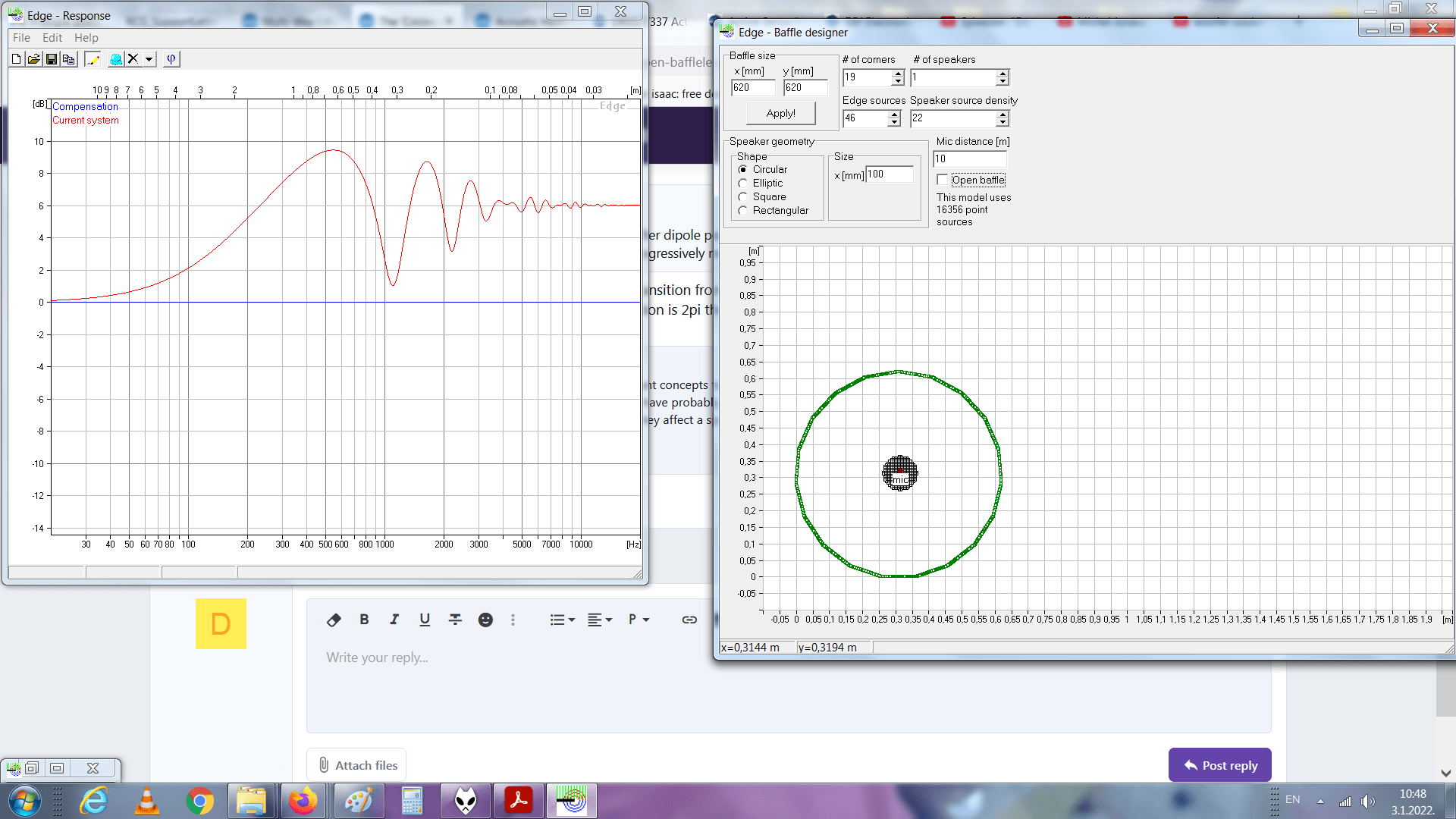

Below are edge simulations for baffle step and OB of same dimensions so difference is easy noticeable. There is picture from Finke paper as well form
View attachment 1011305View attachment 1011306View attachment 1011308
so with smaller or without baffle all that ripples just moving up in frequency.
Something is little bit strange with yours measurements as circular baffle has most pronounced peaks /dips due to equal distance and your measurement show opposite
I suggest you investigate what happens as the ratio of driver diameter to baffle diameter is changed. You are presenting a "worst case" where the baffle diameter (b) is much larger than the diameter of the radiating surface (a). What happens as b decreases so that it becomes only just larger than a?
Reactions: Juhazi
I exaggerated the simulation for better visualization of OB effect. I do not think that anybody will put 100mm driver on 620 mm baffle.
Happens same thing but less pronounced.
Anyway drivers in OB system should be crossed over below its own first peak if we want to utilize all positive aspects of OB system like constant directivity and 4-5 dB higher sound intensity on axis. Both things are lost above first peak. Because of that Linkwitz and Kreskovsky used separate baffle for each driver.
So far it is impossible to do it with tweeter due to size, but as well there is no point to use the woofers without any baffle if we are going to cross it enough low

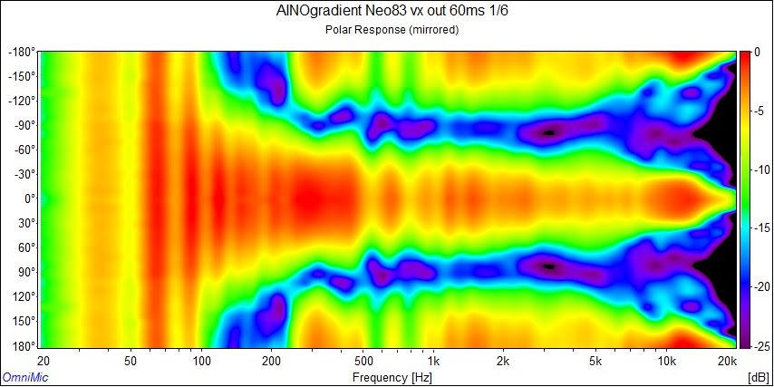

When combining monopole woofer with dipole (low)mid, in transition range we get cardioid response pattern. This I believe was introduced by Jorma Salmi with his Gradient 1.n speakers in 1989. I dated a lady who had 1.3 about ten years later and fell in love with those Gradients! I didn't make a team with the lady, but I had to get or make the speakers... I studied the dipole challenges mainly from Linkwitz pages. later also from Kreskovsky and Finke too, and the minidsp thing came from John Reekie.
Multichannel DSP opened the sky for me, I started AINOgradient project in 2013. I started with LR4 slopes, but LR2 made transition between S and W softer. Biggest problem with that has always been measurement technique, because of the weather and complexity of the system, it has been very difficult to perform outdoor measurements.
https://gradient.fi/index.php?id_cms=9&controller=cms&id_lang=1

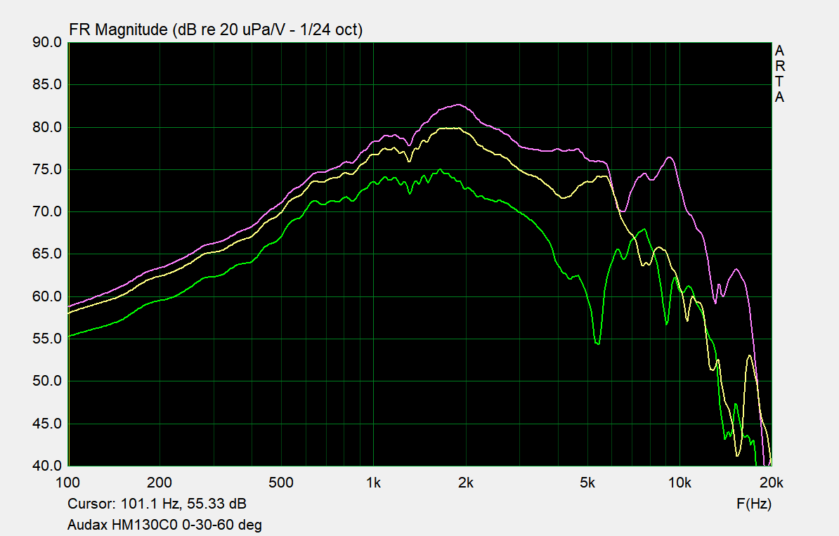

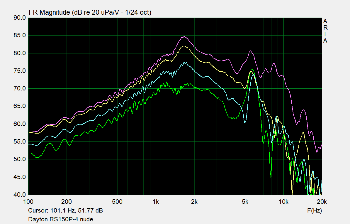

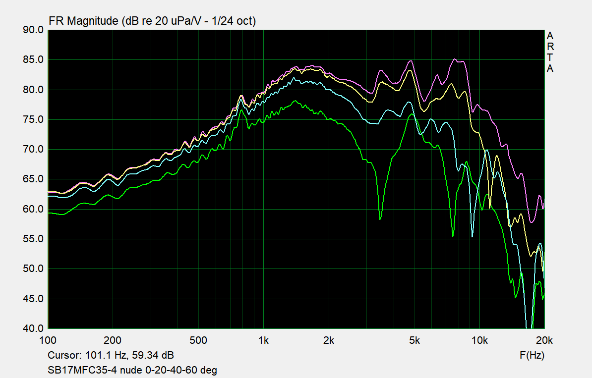

Like I mentioned, you need to find the "right" driver to use it through (and especially above) the dipole peak. For some drivers there is increasing directivity starting at the dipole peak, and this is certainly a limitation. I have attached some quick (indoor) measurements on and off axis for drivers that stay together nicely above the dipole peak until you reach breakup. These are around the 6" diameter that I mentioned, which keeps the dipole peak at around 1.5kHz or so. These are very usable nude with some EQ to smooth and flatten the response. I had to measure many much worse drivers to find these gems.

Nice findings Charlie, those behave like CD horn almost till cone break up.

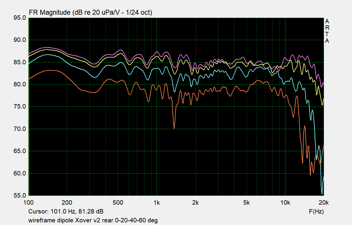

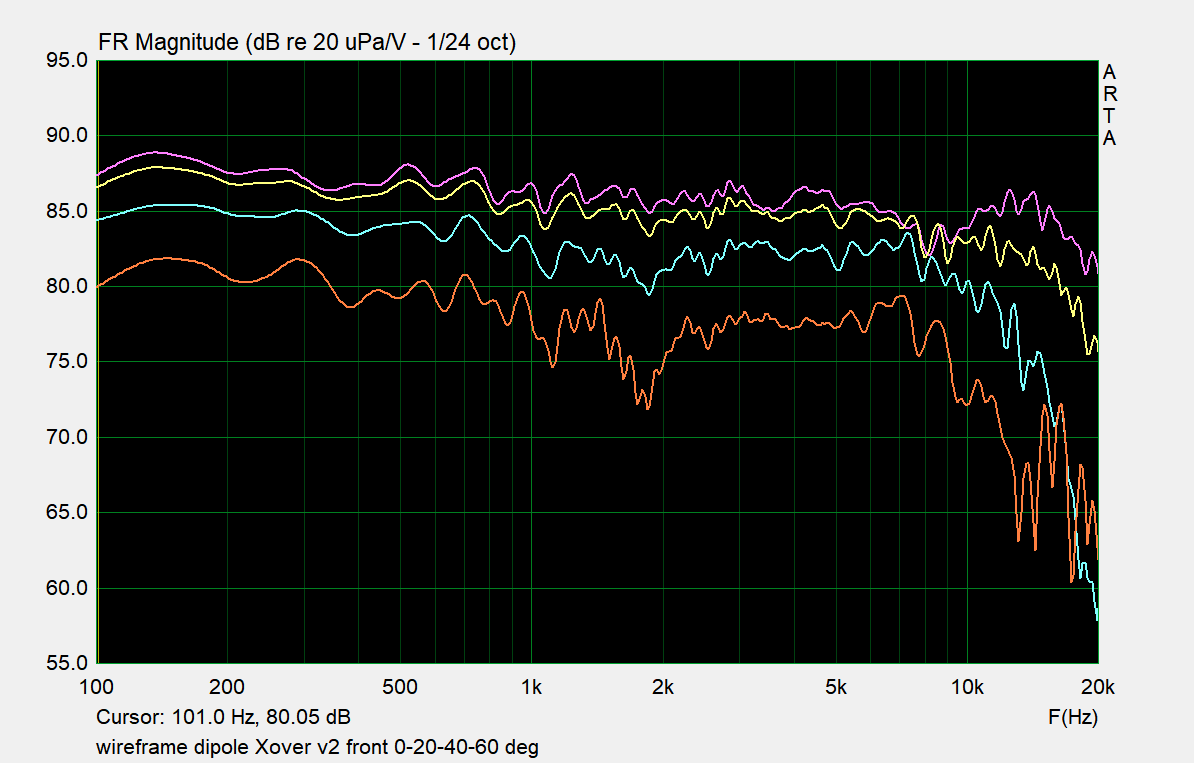

I did manage to get one system going and measured outside before the winter, but the crossover was still preliminary at the time. The midrange was not a smooth as the drivers I showed above, so this system was eventually dismantled. Anyway, I am attaching that data below as an example of the directivity. Not a sonogram (I don't like them all that much) but line plots at a few angles (0-20-40-60 degrees) at least for front and rear.
