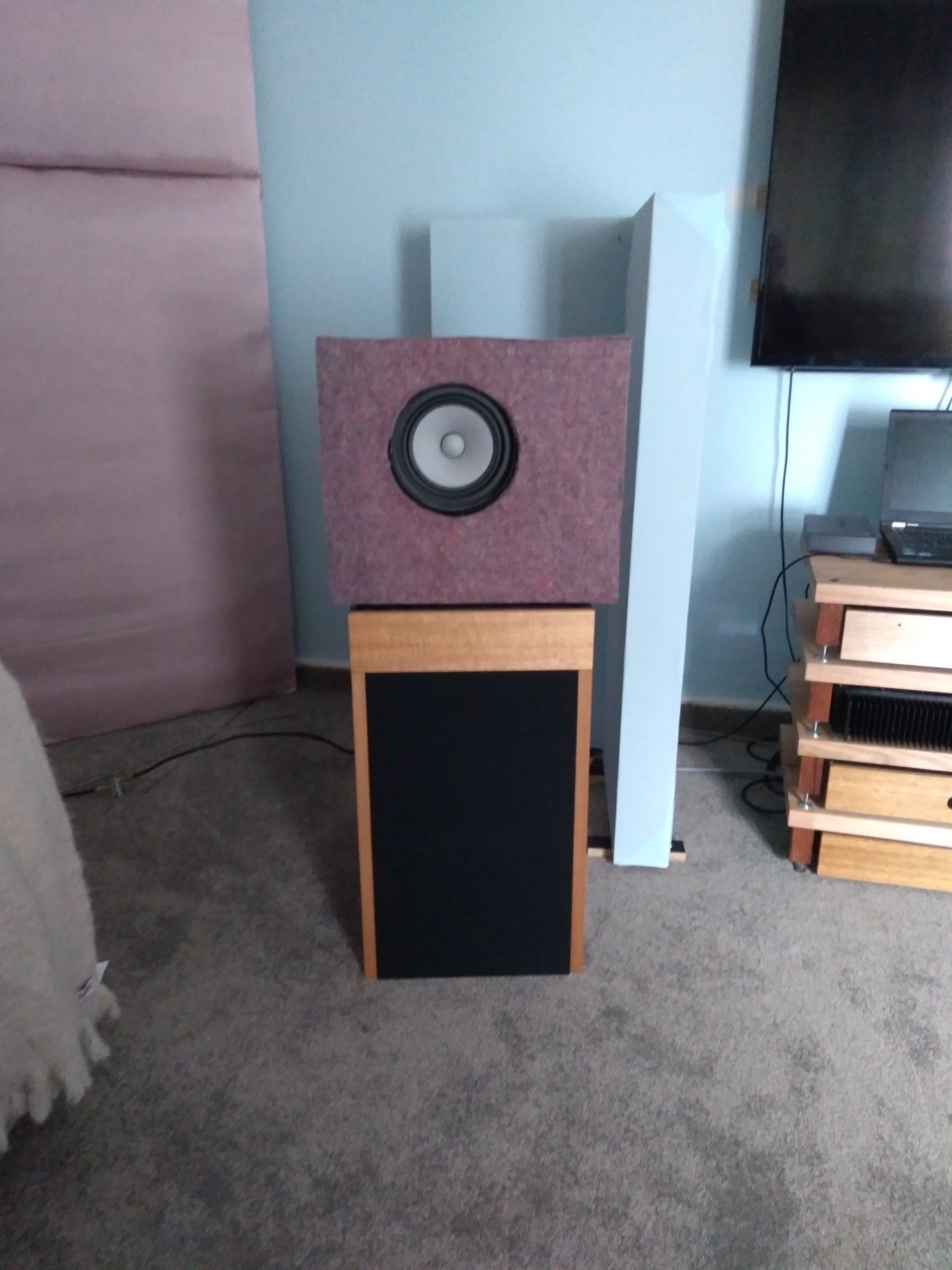

I have the same speakers that I have experimented with baffles. Covering the baffle with felt reduced reflections and improved imaging, removing the baffle altogether improved imaging further, I just had to apply some EQ to the fullrange to flatten it's frequency response, but it did leave a hole in the 200-500Hz range. This will be fixed with some new drivers I have bought.
The key is to have the ability/area to shoot measurements so any baffle can be profiled to provide a smooth response on and off axis. I used an accelrometer attached to the baffle to measure the energy radiated from the baffle, it was not insignificant, 4-6dB SPL in some areas.

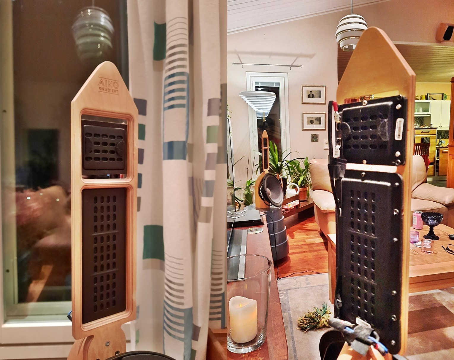

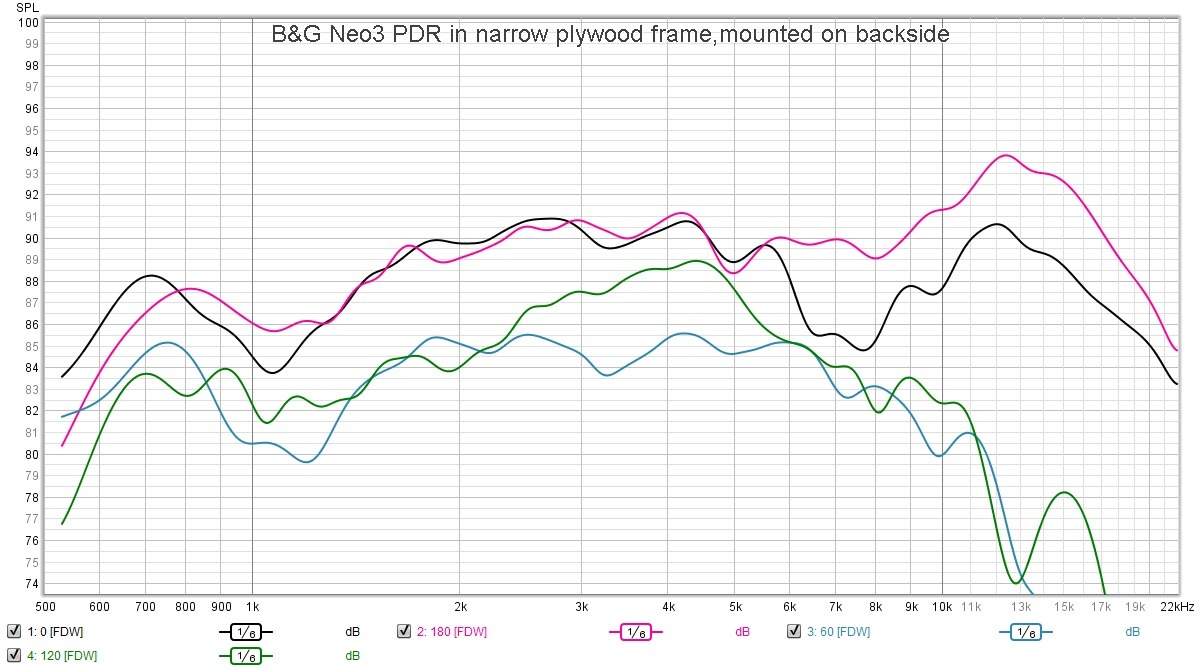

Here are my measurements of AINOgradient's tweeter. It is a planar B&G Neo3 PDR, mounted on the backside of a plywood frame which is 8mm thick. The frontside of the opening is curved with a file. Still we can see remarkable response irregularities based on diffractions, mostly on the frontside. Diffraction effects were even worse before I put those felt pads there. Fortunately vertical dispersion is better and farfield measurements are nice.

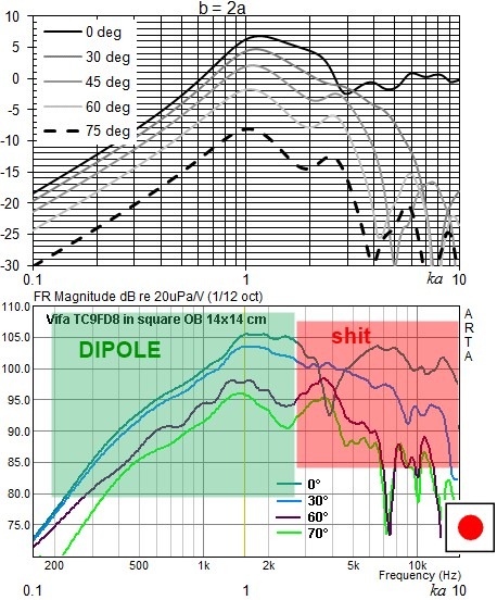

^If you want to have a loudspeaker which has best possible dipole dispersion pattern, you must stay on dipole pattern band with each radiator. Then you also must accept the -6dB/oct loss of spl in that passband. Above dipole peak F directivity pattern goes like rollercoaster, until radiator diameter begins to determine narrowing of pattern. Good luck with trying to find passband with only 3dB p-p variations!

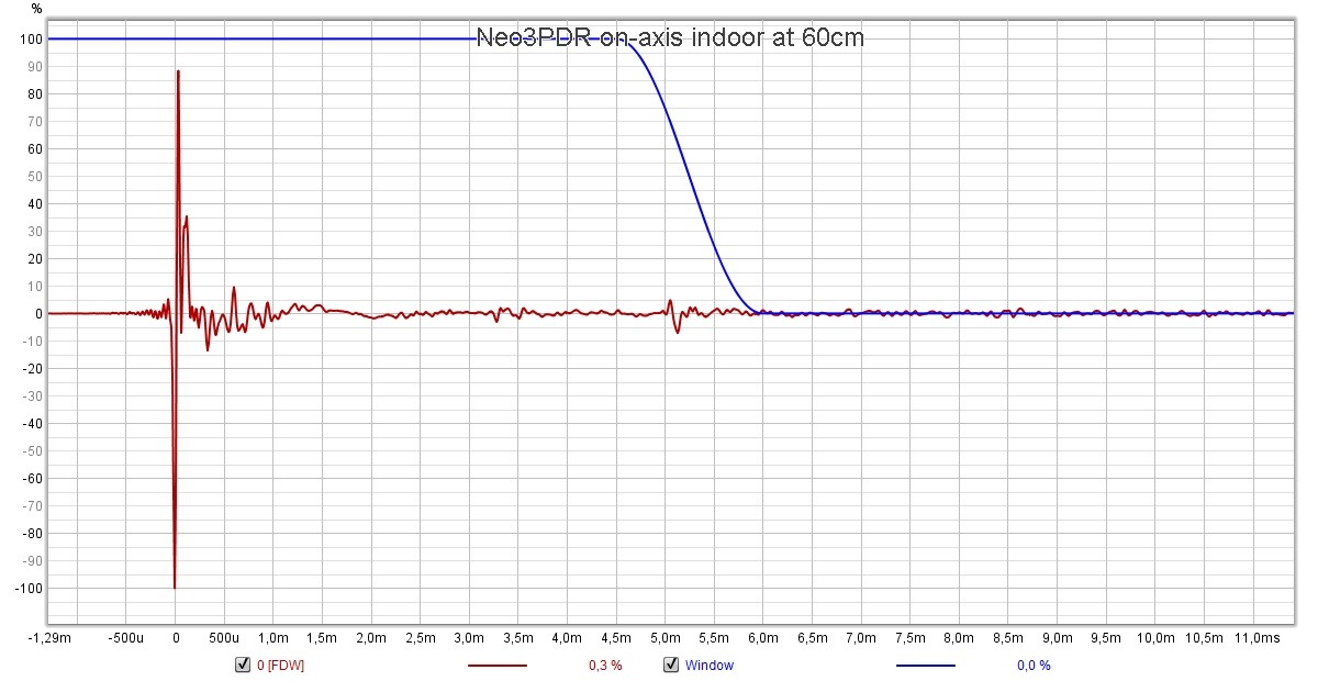

Attached is my indoor Neo3PDR measurement's impulse response. The 6ms floor reflection is quite low in %. Mic distance was something like 60cm.

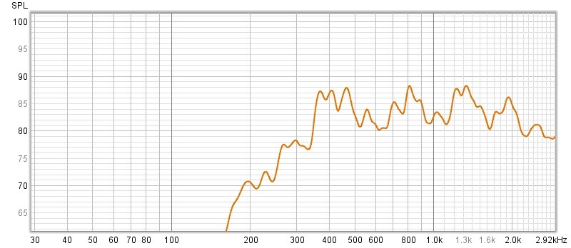

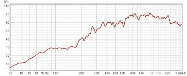

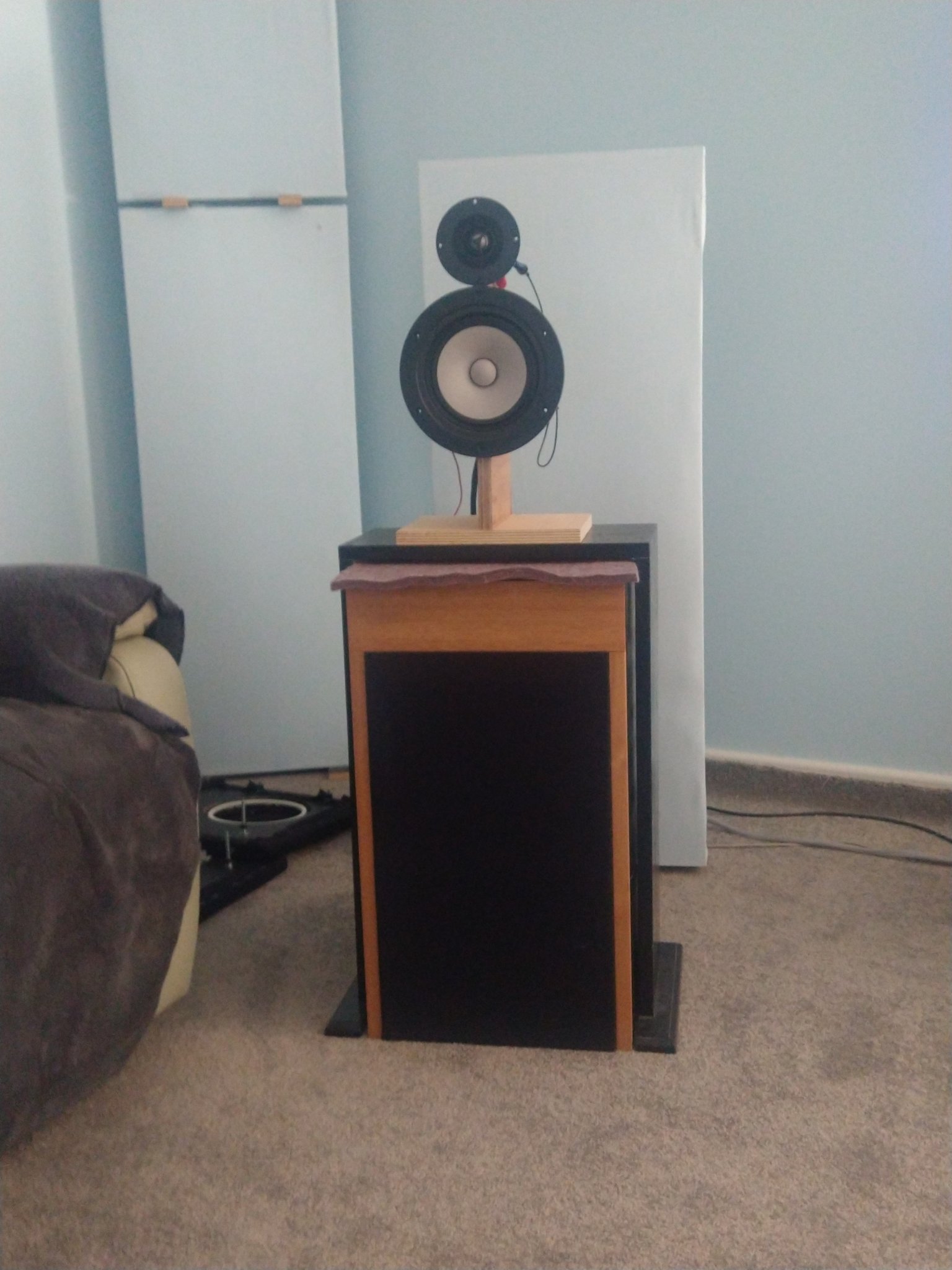

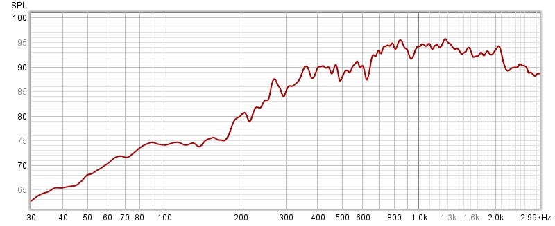

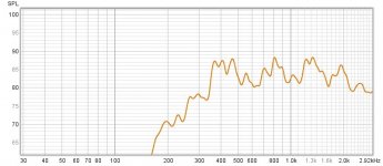

Here are REW measurements of a Mark Audio 12p in a baffle and baffle removed. I have heard this system with and without baffle and without is far more transparent than with, there are EQ issues to deal with in lower midrange because the 12p is close to Xmax at 300Hz.
The baffle measurement still has the XO at 225Hz and the no baffle XO is removed and there is NO EQ. NOTE the tweeter is not operational.
I am not going to exclude this possibilities but ripple after dipole peak is caused by same thing as the first dipole peak and that is phase relation of front and rear sound wave. As frequency rising peaks/dips are progressively more frequent and weaker in amplitude

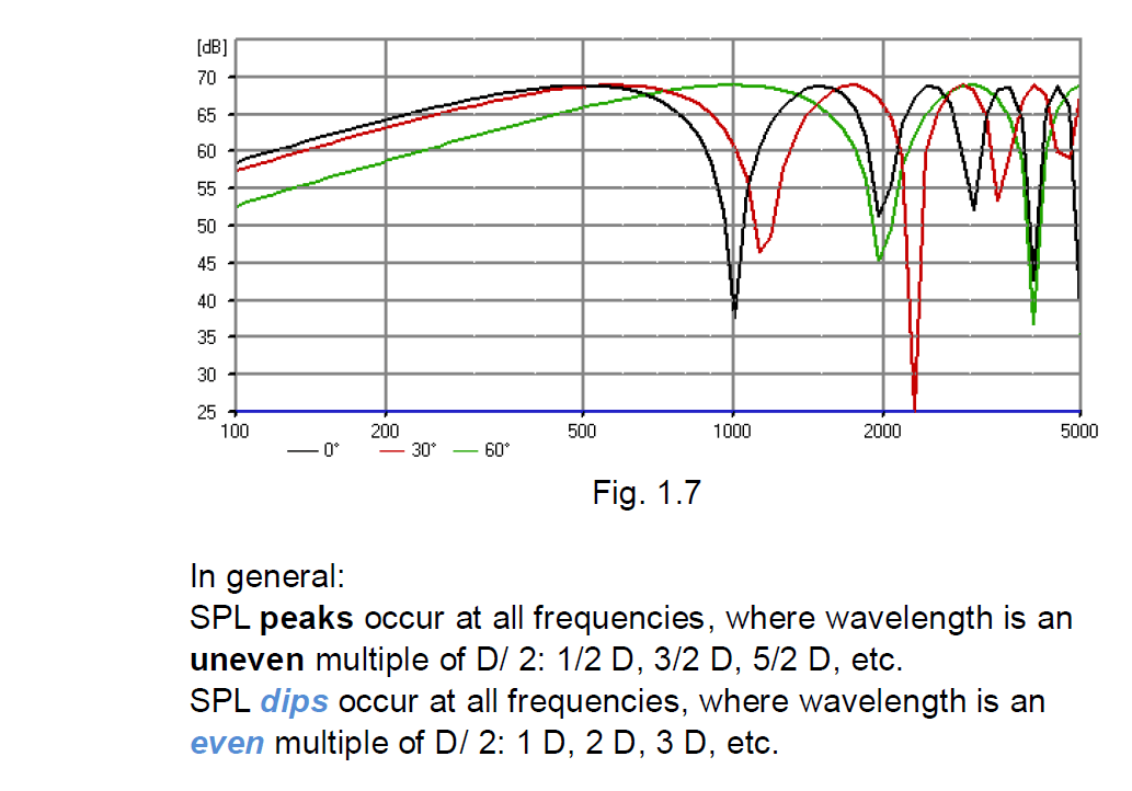

The dipole peak is the point where the driver/baffle transition from 4pi to 2pi radiation, the ripples are caused by reflections off the baffle and baffle edges. Once frequency reaches the point where radiation is 2pi the wavelength is not long enough to wrap around the baffle.
https://www.css-audio.com/single-post/2018/09/14/Understanding-Baffle-Step-and-Diffraction
Sound waves cancel each other even if the wavelenght is shorter than baffle

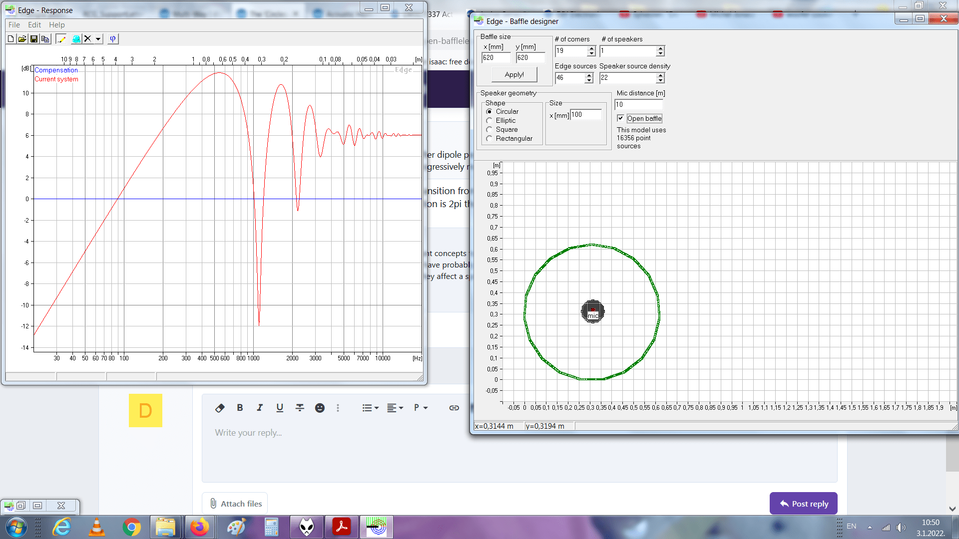

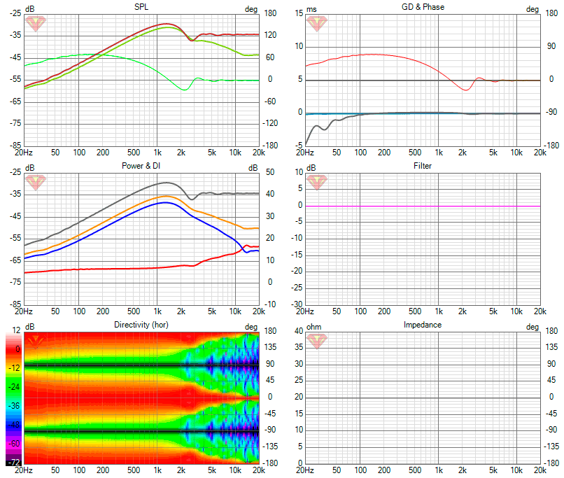

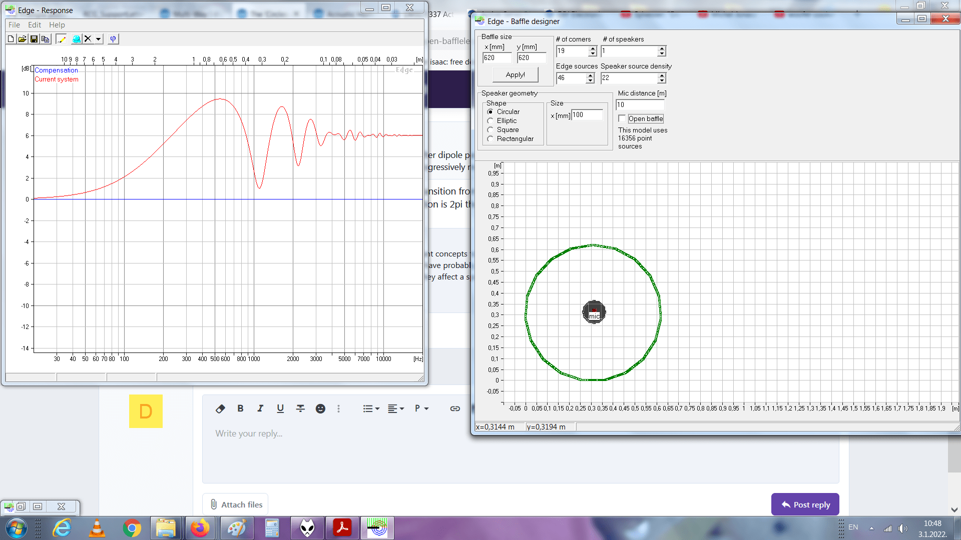

Actually we both right as both things happen at same frequencies so it can be said that diffraction for OB manifest itself as -6dB slope below first dipole peak and series of peaks and dips above it. The difference between box speakers and OB is in that the box speakers have baffle step and OB has full cancellation below first peak. Above first peak there is diffraction ripples for boxes and much stronger peaks/dips for OB.

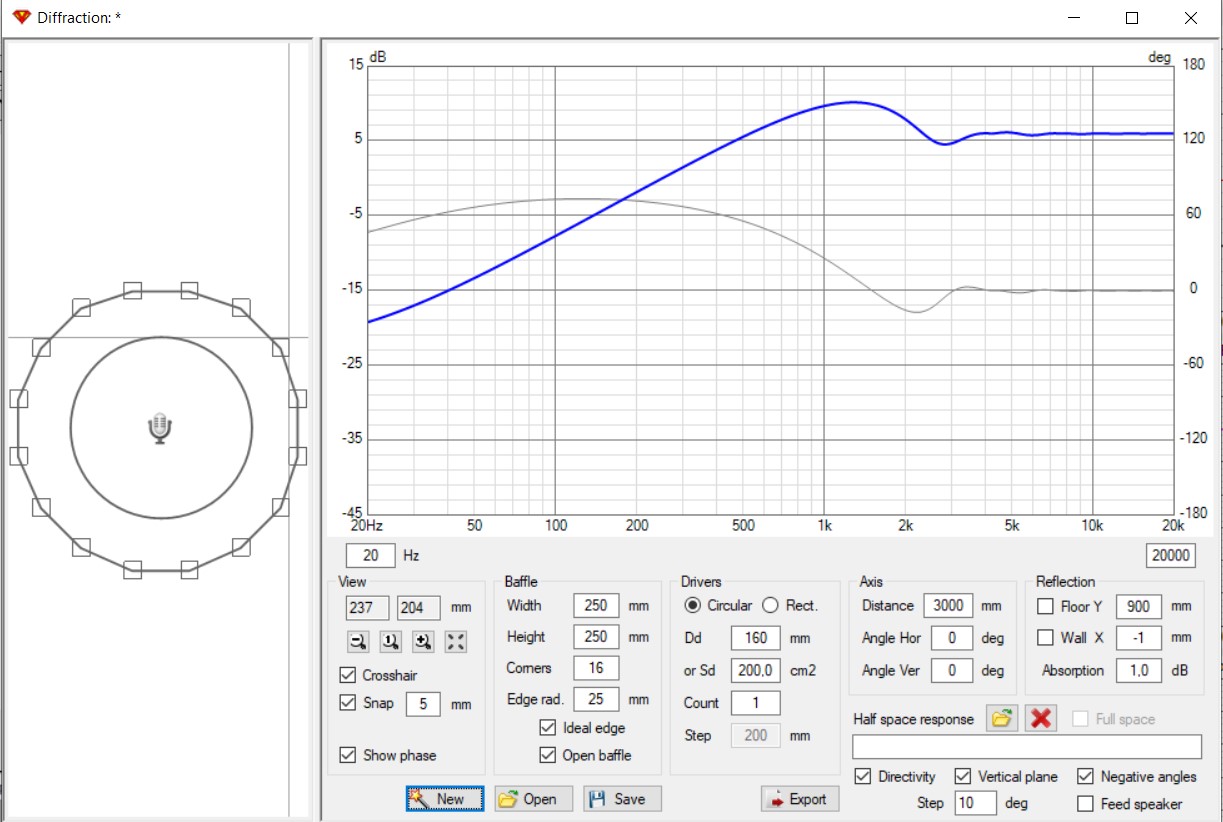

Below are edge simulations for baffle step and OB of same dimensions so difference is easy noticeable. There is picture from Finke paper as well form
so with smaller or without baffle all that ripples just moving up in frequency.

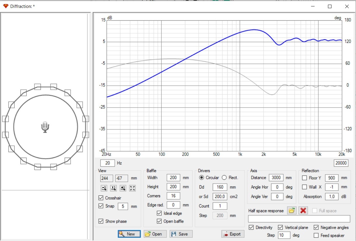

Something is little bit strange with yours measurements as circular baffle has most pronounced peaks /dips due to equal distance and your measurement show opposite
^Warrjon measurement seem fine, perhaps the baffled version has some extra things happening like the baffle vibrating and making extra sound radiation. The naked driver measurement seems legit, you gotta remember that also the self interference of the transducer comes to play as frequency goes up, less sound gets to the edge as the driver output narrows with frequency.

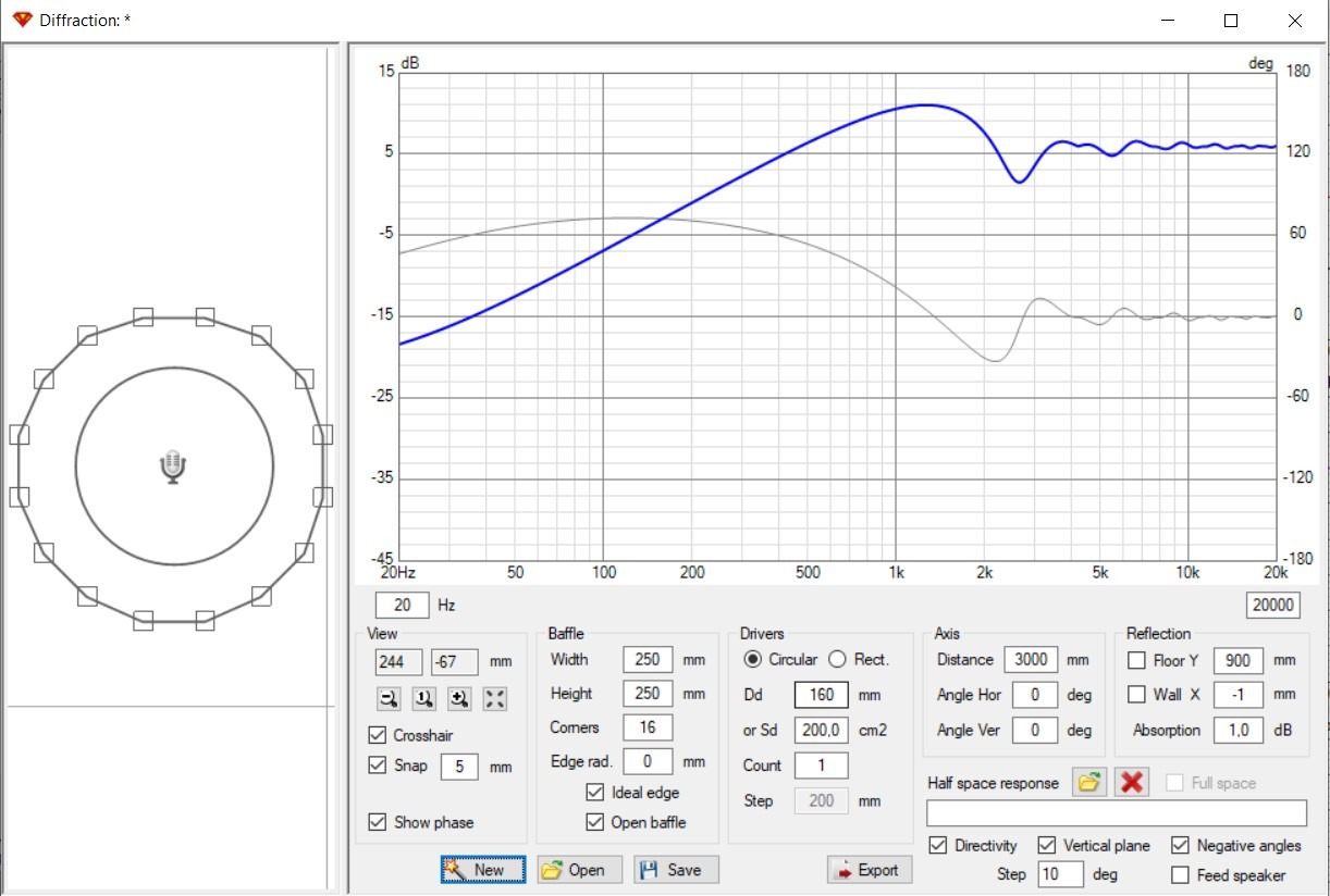

When baffle is small (smallest baffle = no baffle, the driver rim which you can't get rid of), the main hump and ripple is pushed up in frequency, to where the driver beams and ripple gets smaller. One could add round over around the driver to further smooth out diffraction of what ever sound there is left radiating to the edge but this would enlarge the baffle support longer wavelengths taking the diffraction ripple back down in frequency. Minimal baffle gets rid of the ripple above the main peak about as effectively as having huge round overs. Huge round overs need to start immediately at the drivers rim to be effective and would need to have about same radius as the transducer diameter to get rid of the first hump altogether. If you visualize this, the baffle would representing a sphere. On minimal baffle, long wavelengths go around and short beam. There is the main hump still though, with some small ripple above, on frequencies between.
Here is GIF with 8" ideal driver in roughly 20cm x 20cm minimal baffle. Monopole, open baffle and few emulated cardioidish patterns all showing the main peak with various amount of ripple. If one crossovers below the hump (baffle size) on any of these there would not be a problem with the diffraction and narrowing response.

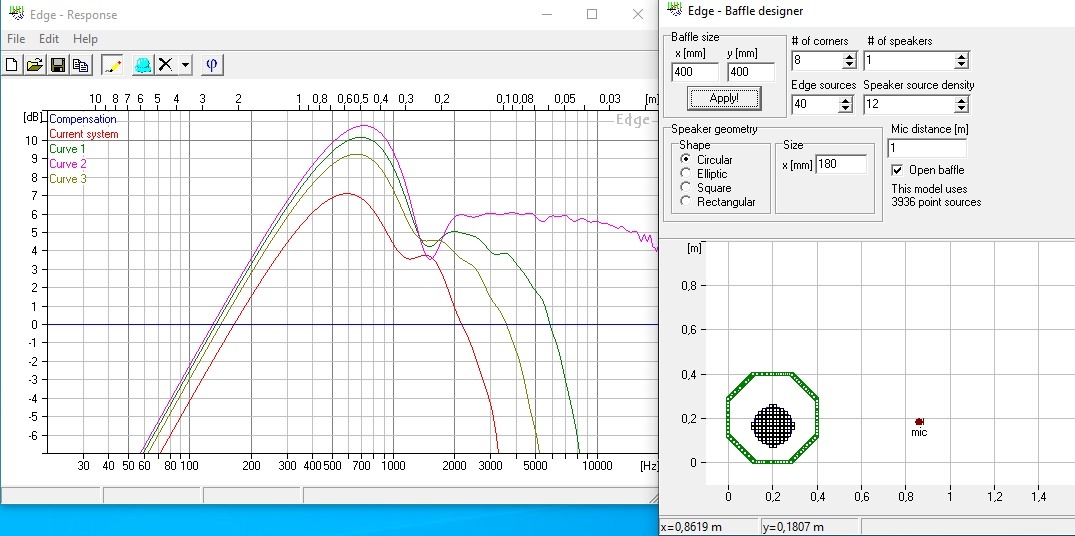

If you do crossover below the hump there won't be any difference. If above, the difference won't be too big. 1" at 1kHz is not big, but higher up in frequency might count (tweeter). In addition, you have to have some structure to hold the system upright. Looks is important consideration as well so go what is practical, don't worry about it too much 🙂 I doubt you could measure difference at listening position after all interaction with the room and objects in it, no idea if it is something audible or not, probably not unless everything else in the system and room is tuned to max already.

Ideal 8" without baffle, with 1" round baffle and third one if the whole baffle was round over radius about 1". There is some difference above hump, the round over one being the smoothest.
