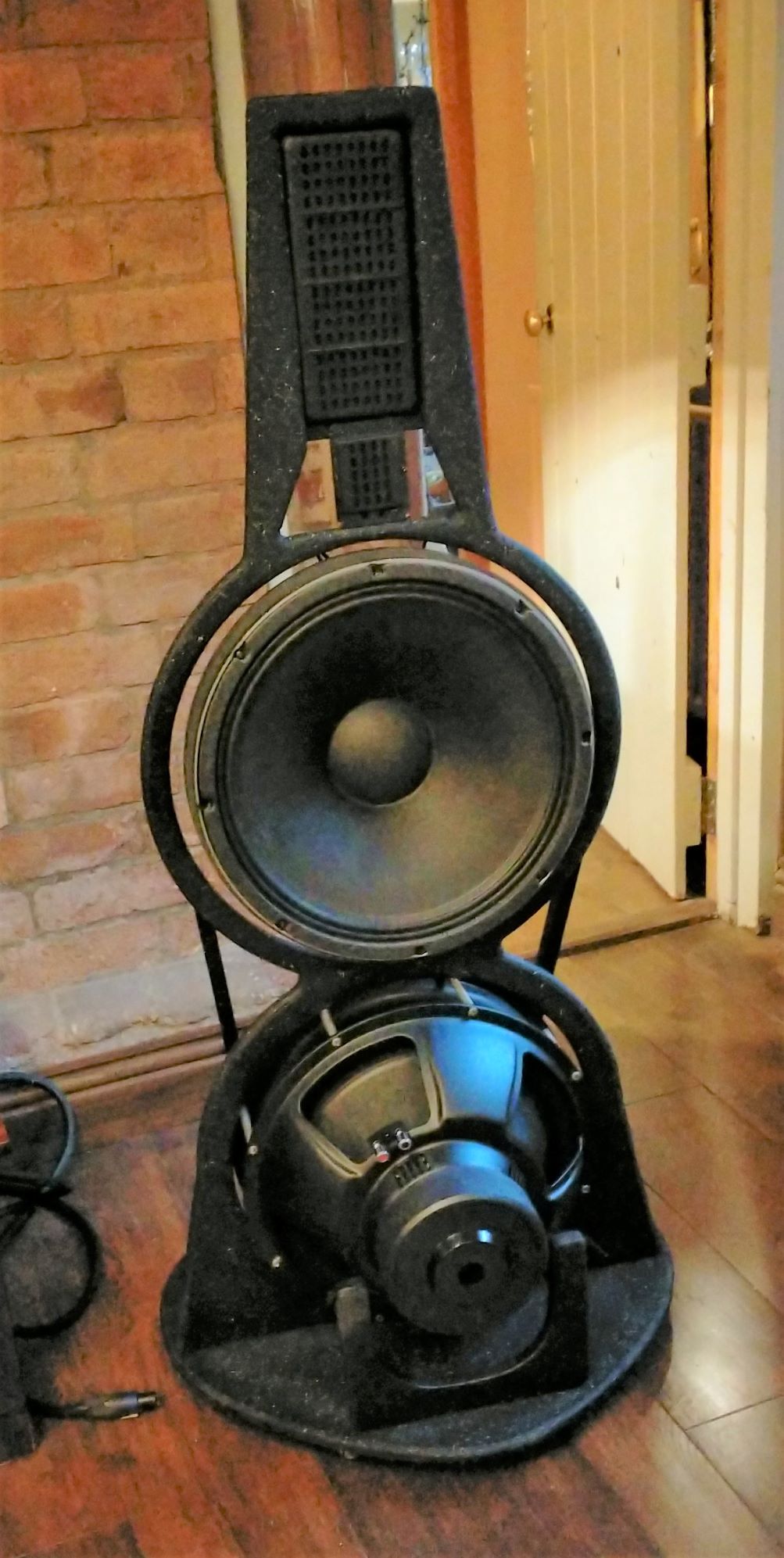

This open baffle 'prototype' system blew my mind.
It sounded better than anything I had heard before in all areas.
So I decided to try adding open baffle bass to this and upgraded the mids to the Neo10 dipole GRS clones...
I will add some photos of the build, more details, and measurements etc when back home.
The 'clamshell open baffle subs' are also a real eye opener.

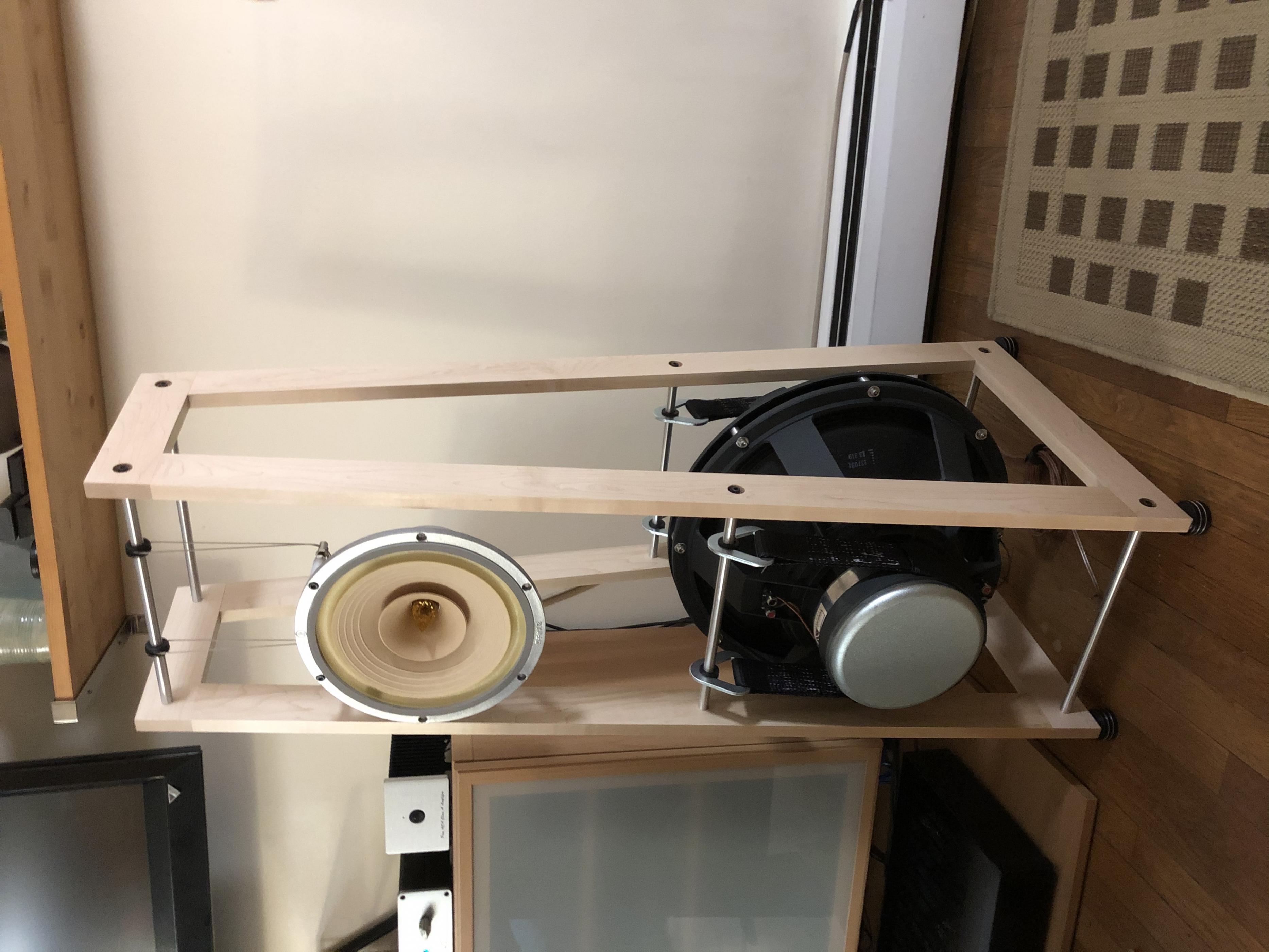

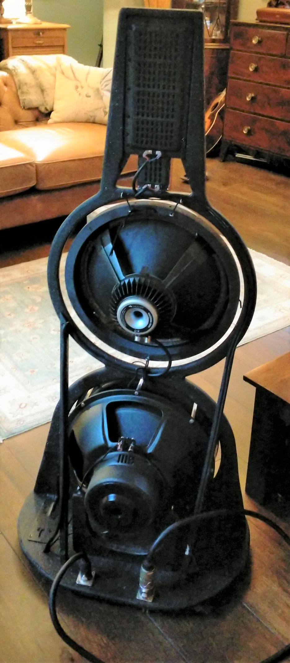

Here are a couple poor quality phone photos - I need to take some shots of them in daylight, but gives you an idea of the general construction.
There is some tidying up to do on them - but you can see how they are suspended and how the clam shells are in hammocks.

I've done a few mock ups of this style of dipole and can confirm it can sound very smooth and powerful. I think it has something to do with how the drivers couple with the air instantly from all sides. Just guessing though.
Low end does not pressurize room however and is an acquired taste. I still love listening to it.
Is the clam shell wired push-push, so force cancelling? interesting
No that would result in no bass output at all as they are baffleless.
I have made push-push sealed subs (if you look in the first photo of this thread you can see them in the background - giant tube subs with a driver at each end).
I have to say - as a sealed or ported sub - push-push are amazing particularly if you mechanically link them as mine are (metal rods bolted through both drivers internally). There is literally no vibration detectable at all when the drivers are going mad).
These baffle less subs are wired push-pull so the move together - which causes lots of vibrations - but because they are completely swinging free in 'hammocks' - no vibration is transmitted anywhere else.
I don't think I would want to mount these big 15" drivers to a baffle - unless it was incredibly dense and heavy - they have very heavy cones, and 22mm x-max!

That looks good. This is similar to how I am building systems these days, except also with all drivers physically decoupled from each other.
I forgot to add - the subs are physically decoupled - they are 'floating on hammocks' with a natural resonation of approx 6 hz.
And the deltalite 2515 is 'hanging' on wires - so completely decoupled.
However the neo10 and neo3 are screwed to the baffle - but they do not seem to create any vibrations at all - even at very loud volumes - presumably because of their design and very low moving mass?
The whole baffle is complete dead even at very high SpL.

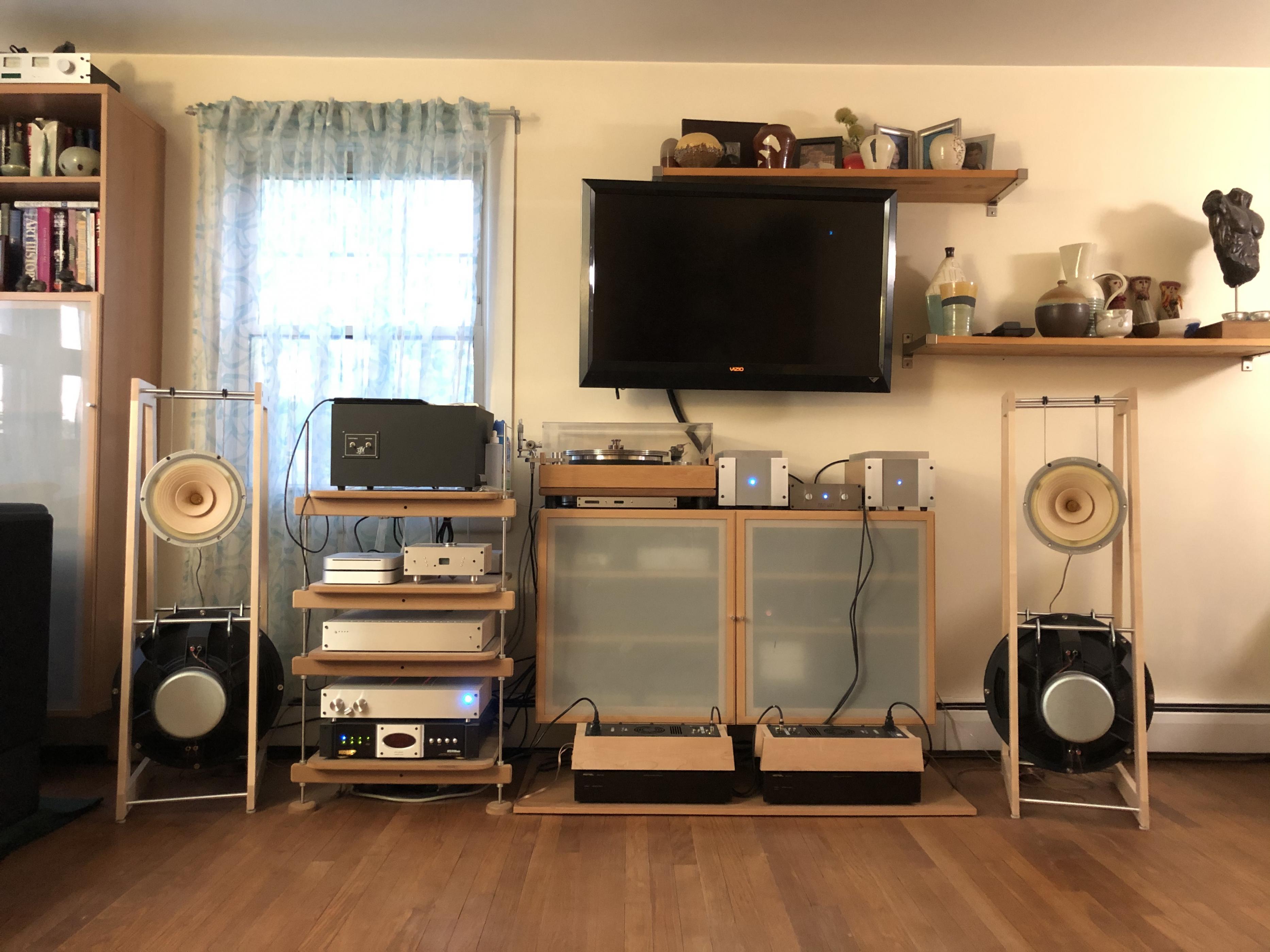

Hi Bush
I had a version of what you’re using for subs up and running for about a month after coming across the idea more than once. Vic from Trans Fi has documented his meandering with the design extensively.
My top end was completely different...Lii Audio Crystal 10 drivers baffless.
I was using (4) AE Dipole 18 drivers mounted and suspended as you are.
I had to wire the dual voice coils in parallel (with reversed phase of one driver on each side) for a 4 Ohm push-pull result.
This application required powerful amps and drivers that can really move air.
I found out the hard way that it is easy to exceed xmax once they get pumping.
It seems that setting my Hypex amps to soft clip at 300 watts into 4 Ohms wasn’t conservative enough.
I believe I bottomed out one of the voice coils when I heard a “Snap!” during a bass heavy Downtempo track that I was playing enthusiastically for my son.
Now the driver has a buzzing sound during playback unless I hold my fingers gently on the cone.
I contacted AE and they said a recone is possible for $150 and that I should check a few things like the phase plug, surround and coil gap for losseness or debris before jumping to conclusions.
I will say that while it was up and running I seemed to be going in a good direction. The sound stage was almost holographic on good recordings at times.
I think the 15mm xmax may not be enough for this design. Vic swears by his Dayton Audio Ultimax UM-18 22...which have 22mm xmax.
I thought the AE’s were designed for OB and I shouldn’t have any issues. I suppose a little knowledge is a dangerous thing.
