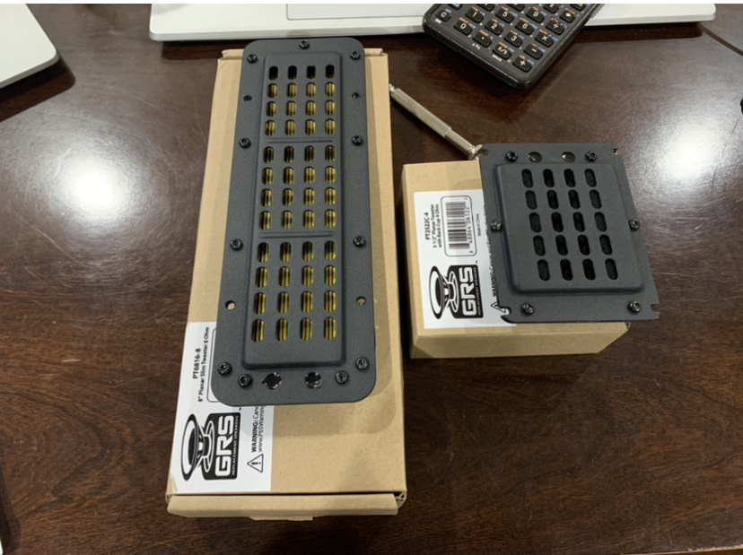

Just listening to the 8in GRS with a 15uF cap and my 8in woofer - man it sounds incredible. That’s a sweet tweeter!
Long time no chat! Honestly - you really, really must get some of these GRS clones and have a go - with your foam core skills - you could knock one up in no time! Not too expensive if you go with their neo3 and neo6 clones....

I don’t often get this excited about a new driver but this is the real deal. It can reach down to 320Hz so could be used as a FAST open baffle with say, an RS225 woofer in a TL crossed circa 900Hz! 🙂
All first order transient perfect of course. Plus, the tweeter can be set on top of said existing TL cabinet and simply set back 3in for perfect time alignment. 🙂

I'm surprised at these GRS3, the polars are pretty good, 'cos similar ribbon tweets usually fall drastically once you get offset.

What do you think of the GRS planars - are you as impressed with them as me?!
I am going to start doing the 'proper measurements' later this week - along with some proper listening impressions, quick and dirty measurements hint at low distortion and excellent dipole behaviour.
Listening tests are even more impressive than my prototype builds - the sound stage depth and detail is like nothing I have ever heard before (and I have heard very good drivers in decent implementations).
I just don't know if this is room interaction, a property of the naked dipole behaviour, the GRS superiority with their planar engineering or a combo of all the above.....I am hoping measurements will help me quantify this.
But for me, there is no doubt I will be moving my 'Balls of Prestige' out of my man cave. I will be sad to see them go - I much prefer their aesthetics and they have been a daily pleasure for me for nearly five years.......but it is no contest.
