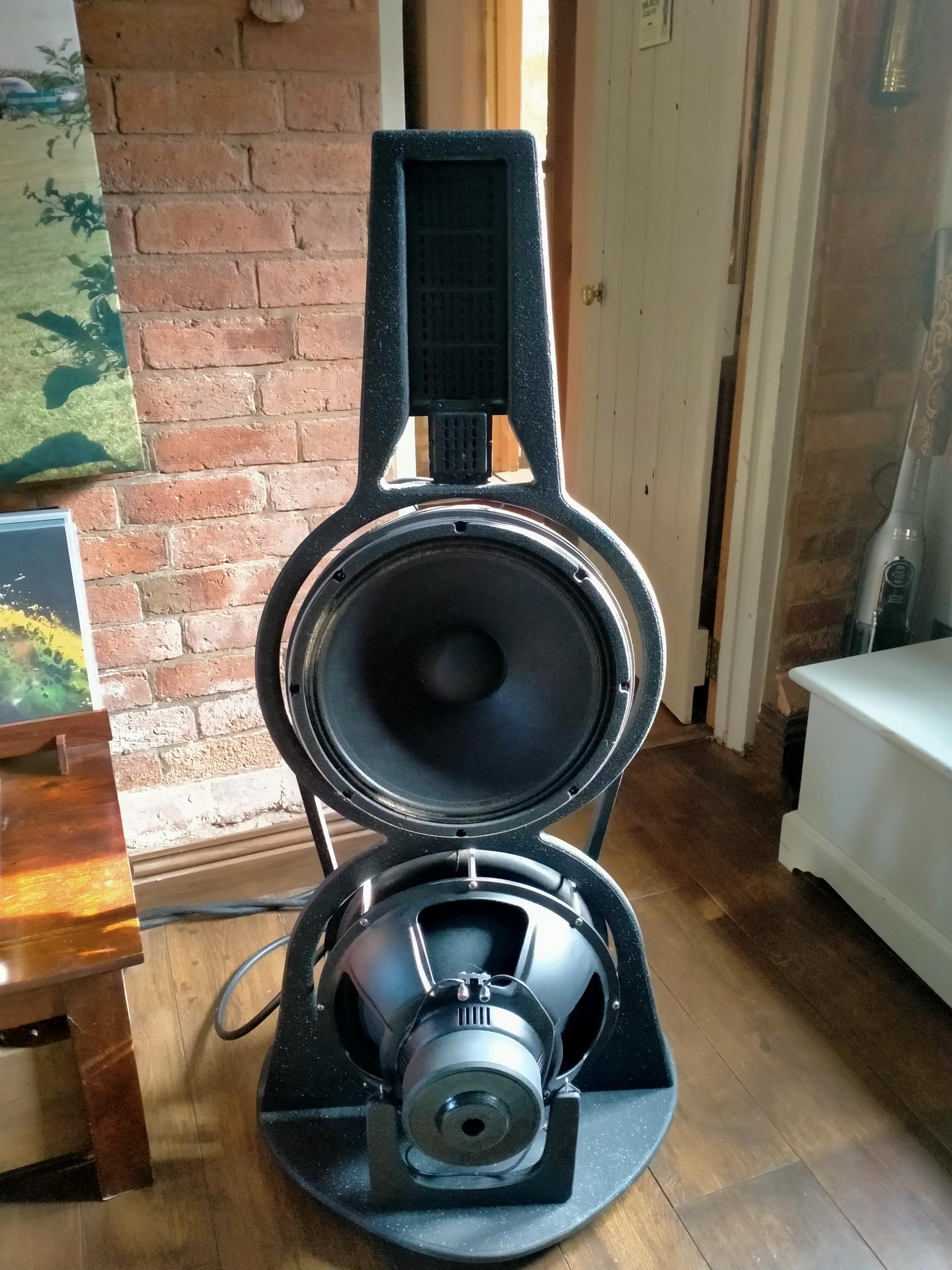

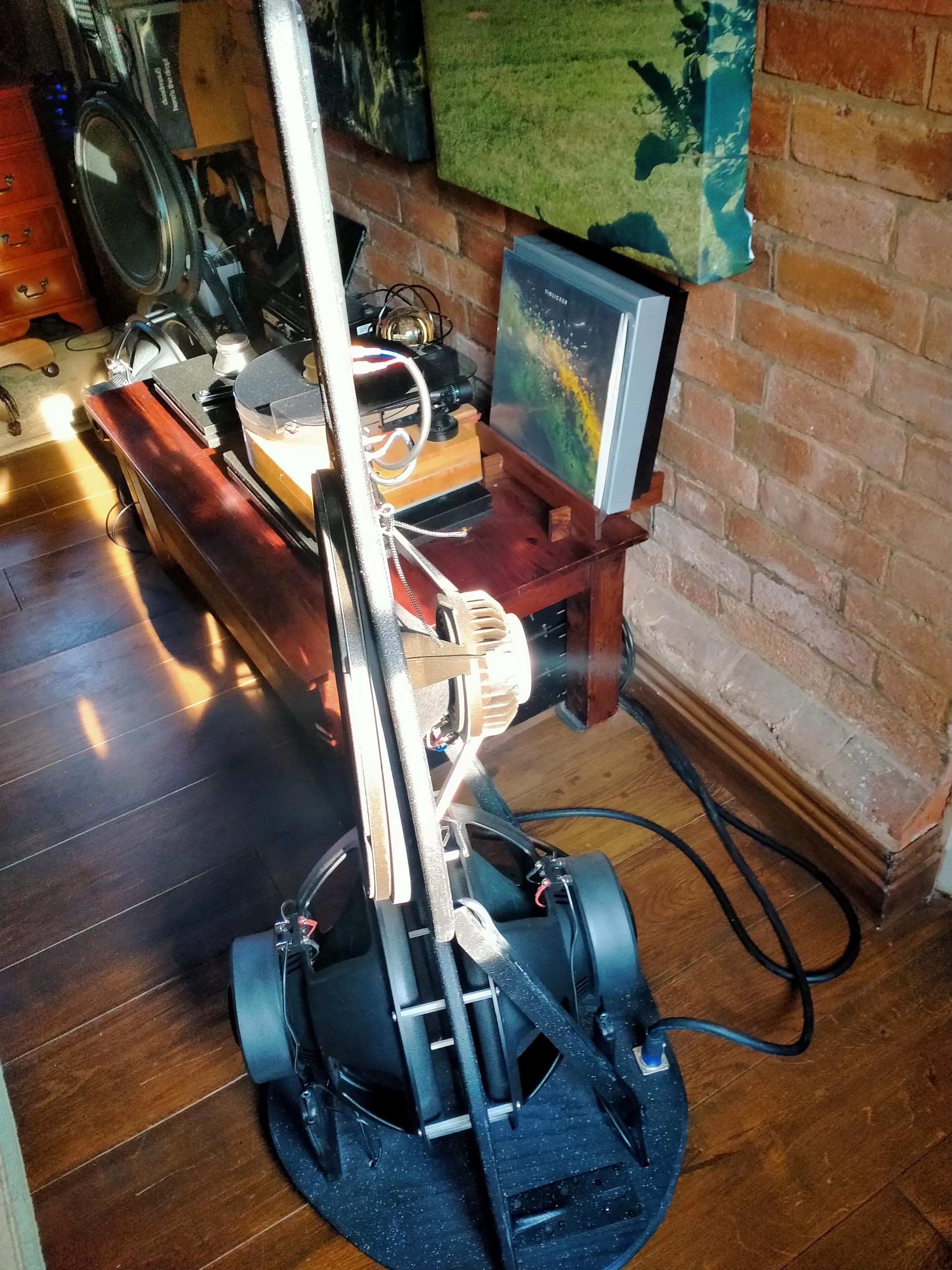

Here are a couple photos taken in better lighting so you can see the construction in more detail.
I decided to go with a 'stone effect' granite finish on the baffle to keep with the industrial feel of them - I didn't feel trying to soften them would work given how they are designed.
The baffle is 22mm BB plywood sheeting with hardwood - oak baton braces.
I was going to CLD them with two ply layers and a CLD layer between - something I have done a fair bit in previous builds - but due to the decoupling of the drivers I didn't feel it was required. There is no movement or vibrations at all even at very high SPLs.
I am using pro- 8 pole and 4 pole neutrik speakon connectors - two per speaker, as the subs have two amps - one each, and then there are three amps for the woofer, mid and tweeter.
Neutrik NL8MPR Male Silver Nickel 8 Pole Speakon Chassis Panel Mount.
These really help with active designs where lots of connections are needed and are really solid. You can see the sub connection in one photo - the woofer/mid/tweeter connector is beside it.
As you can see from the side profile, I have suspended the woofer - the deltalite 2515 at about a 5 degree tilt - this is because it is below the listening axis and helps with the polars a little.
Also I have both the speakers on decent quality 1" castors - these are life changing for me - I can literally roll them about the room with one finger - something I feel is essential for open baffle speakers if you don't want them sitting in the middle of the room all the time. If any of you have open baffle speakers and you are constantly lifting them back and forth - try some castors 😀 Keeps my wife happy as I can push them right back against the wall when not listening.
Thanks to the advice here, I have put a 30Hz high pass filter on the subs - 48dB and this really seems to keep excursion down when switched on (the subs FS is 29 Hz).
I have discovered the dipole bass needs very little room EQ compared to my monopole - literally only one slight peak at 47Hz needs to be addressed with a -5 dB peak filter - much less than the push-push sealed subs - so it is true that dipole bass have very different room interactions.
