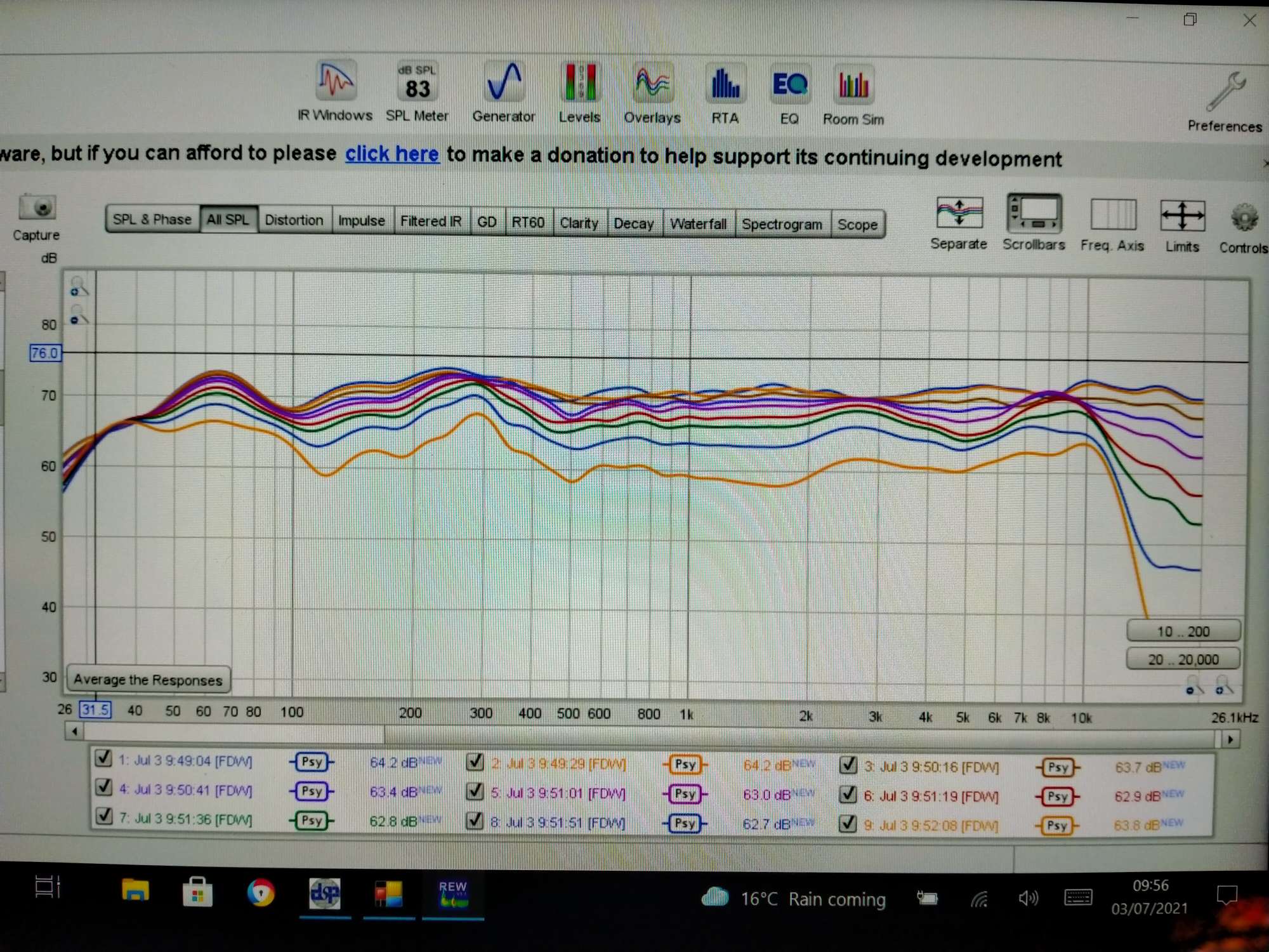

Hi guys.
Here are some 1m.measurements taken at 10 degree increments. There is clearly some bunching at 8000Hz and presumably from defraction, but given this is right out to 90 degrees off axis, this seems to be reasonable controlled dipole directivity and nicely down to nearly 40 Hz.
Need to play with the DSP and crossovers to see if I can make things smoother, but not bad for a first try.
Any suggestions to improve gratefully received!

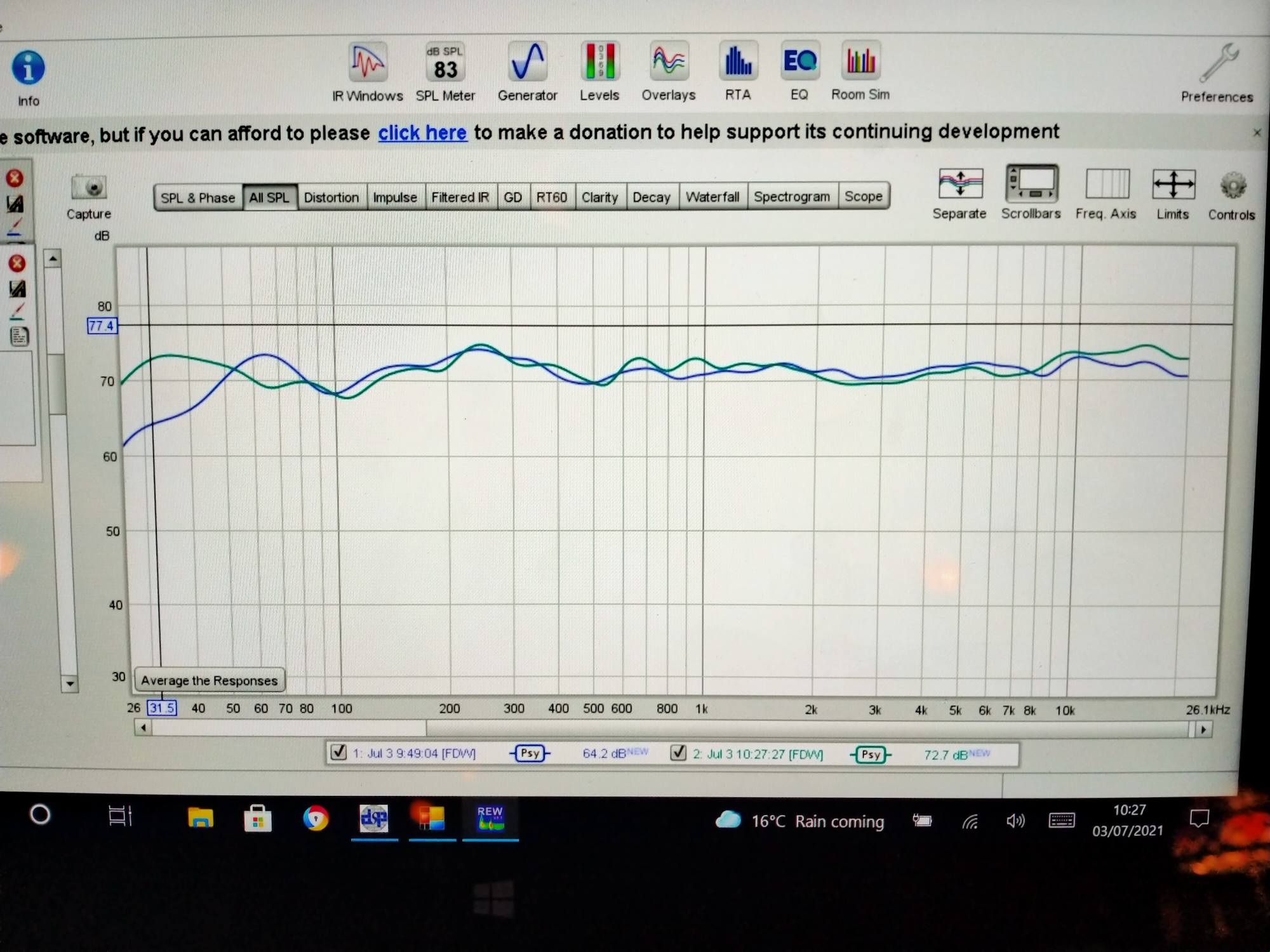

Front versus rear output. Very close as you would expect with these drivers.
The higher rear bass output is because the Mike was in the corner of the room to get the 1m measurement, this is actually much closely to listening position bass output.

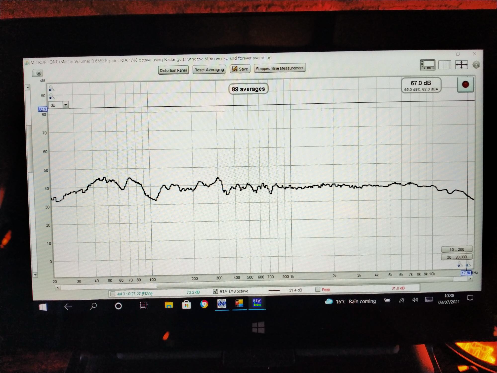

Next some MMM with Pink noise over the listening couch🙂
Clearly some room issues to sort and this is where DSP becomes so powerful, but given I have done zero room correction so far, I am very pleased with the 400hz up listening averages.
To me this shows how open baffle definitely interacts differently with the room

I forgot to add the importance of this rear versus front measurement...
Many open baffle speakers have different rearward outputs to the front - either due to going monopole in the top end, baffle shape, driver design etc.
This means the delayed reflections from the rear lobe that make open baffles so magic will have a different tone/timbre to the forward lobe. Ideally you therefore want the forward and rear lobes to be identical so both direct and indirect sound signatures are consistent.
This is one of the features that makes this type of design different to most open baffle designs. I also think this might be where some of the magic sauce comes from.

Hi guys.

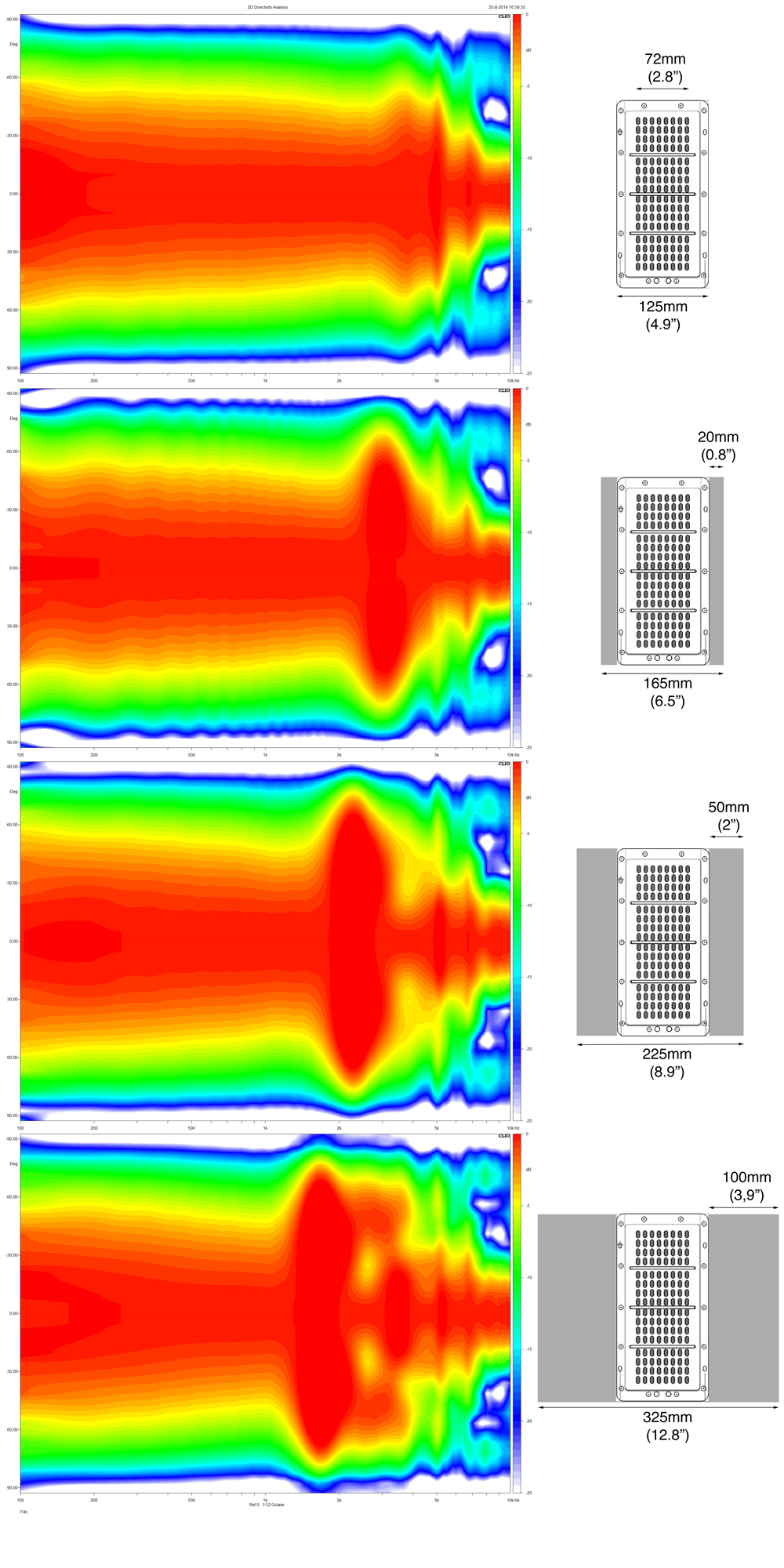

Hi bushmeister! Congrat's on a really nice build!🙂
When looking at your direcitvity measurements I noticed the slight bundling of lines around 2.7 kHz. Have you seen Gerrit Boers measurements of the B&G Neo10 with baffle extensions (https://www.diyaudio.com/forums/att...woofer-neo10-baffle-directivity-compare-jpg)? I would guess that the decreased directivity in this range comes from the small baffle that you mounted your "GRS-clones" in. No idea if this is audible or not - I have both the Neo10 and the GRS-version but haven't yet tried them - but it might be worthwhile to make the extensions even smaller...
You are right I am sure. I may try that later. At present they sound so insanely good I can't believe that slight bunching is audible.
