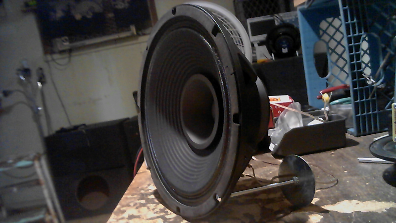

For example, I use an Eminence Deltalite 2515 in such a role. It can work down to about 80Hz nude (100Hz if you want really loud SPLs).

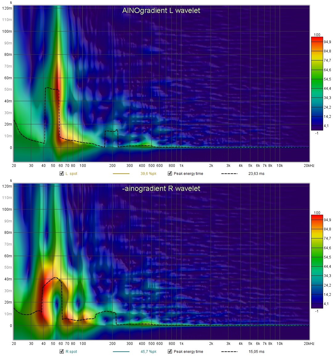

OK guys, please remember that I get cardioid response 100-200Hz and of course I have tried xo around 100Hz. The 12" woofer is a PA unit with only moderate Xmax. Some people praise cardioid bass over anything in audio world! I have been very happy with my system, it works really well with movies, jazz, classical, choirs and pop (perhaps even rock but I don't listen to it)

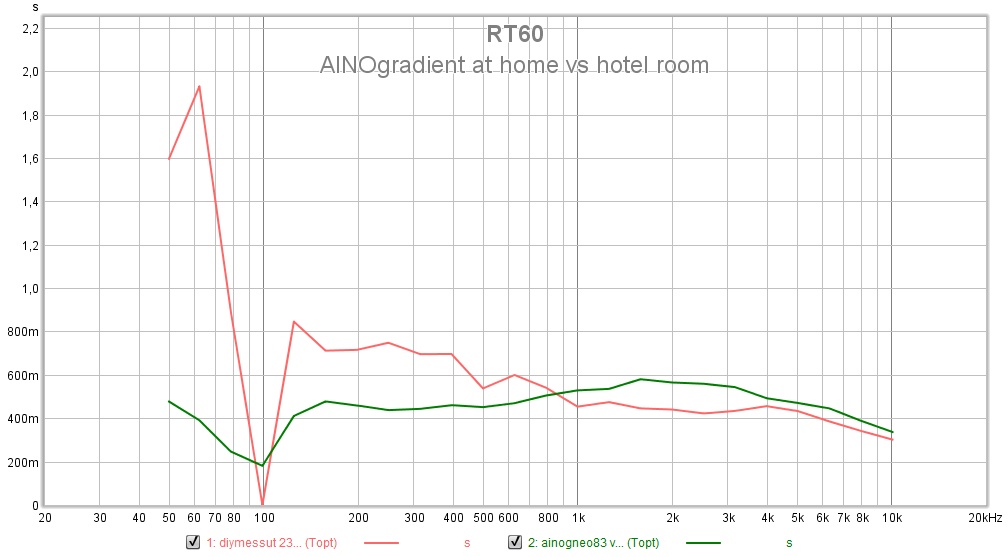

My living room is very open and asymmetrical, has RT around 0.4 and I even don't eq modes (naturally I have tested that)! But OK, I'm getting more and more interested in testing dipole bass! I could swap AINO boxes to 2x15" like LX521 easily, and use old boxes as subs (my Minidsp 4x10HD has those SW channels free) And I have a powerful NHT Power2 2x200W classD amp in reserve...

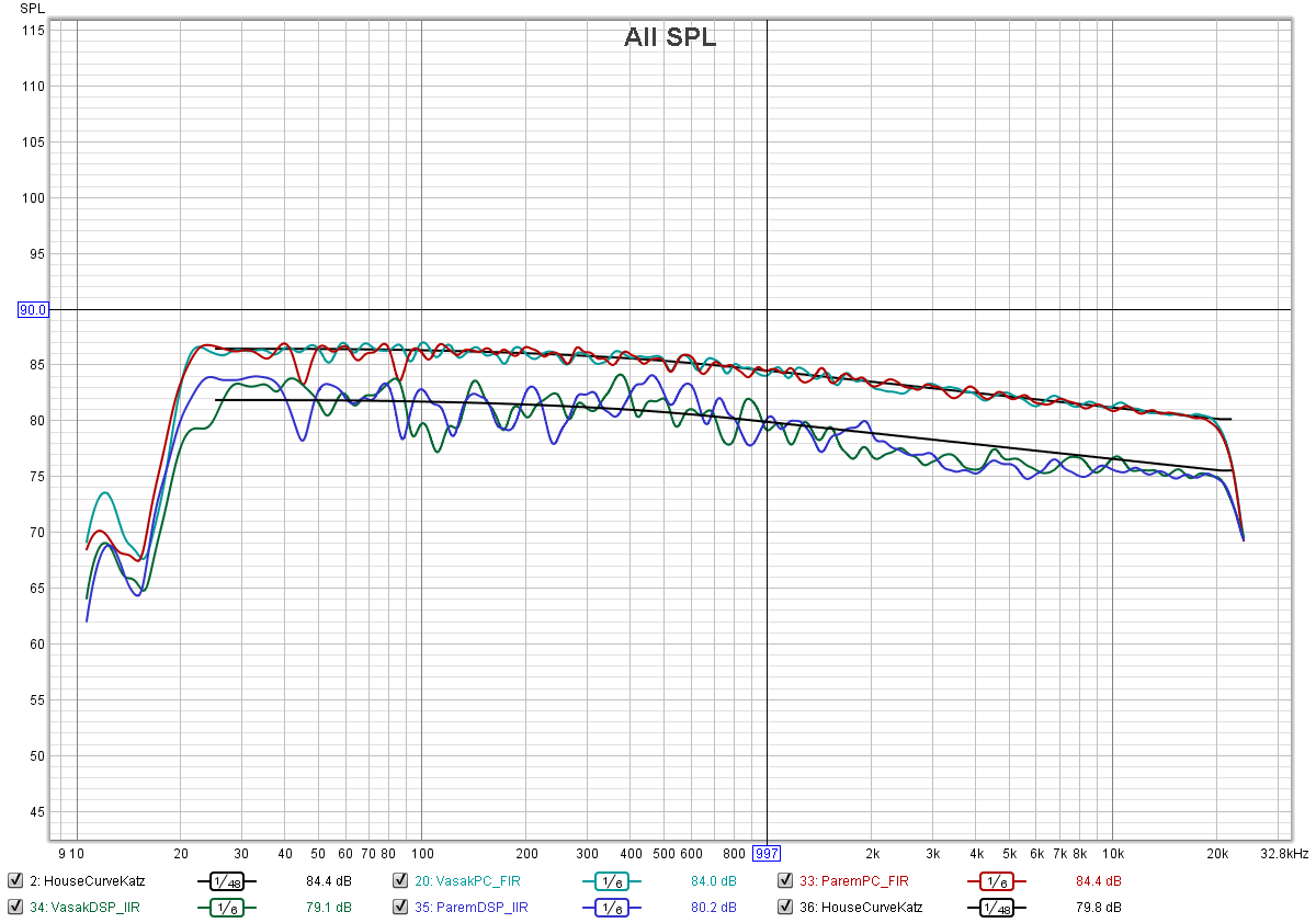

Flat OB bass down to 20Hz.... this I have to experience one day!
This is not very difficult on moderate SPL levels.Flat OB bass down to 20Hz.... this I have to experience one day!
I had it with Selenium 18" on 300mm U-frame. On image 2 versions DSP IIR and PC FIR filters measured at listening position.
When you connect both drivers are they simply in parallel? I think 6dB gain is from combo of double the area and half the impedance. This is usual benefit of taking two 8ohm driver in parallel for 4ohm. 6dB gain for same drive voltage.

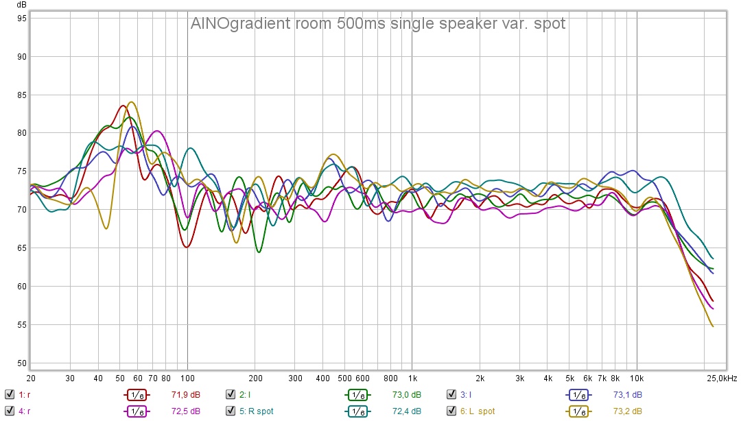

Turns out my room has a mode at 35Hz, which even after extensive trapping with helmholtz resonators is still having an impact. And the DIY sealed boxes weight 100lbs without driver and amp -heavy.So you are saying bass between 20 and 35Hz with dipoles won't be better than sealed. But what about 35Hz to 70 or 80Hz? More content is expected to be in the latter range.
