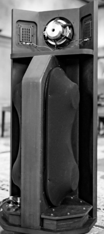

I smell some problems with those twin tweeters and dipole mid in a wide baffle with angled wings... But the SLOB bass system is nice!
Very little info on the website. 6moons says more to come... https://www.lindstromaudio.com/products
Very typical 6moos stuff, extravaganza of loudspeaker design, beyond basic acoustics and common sense designs (IMO sorry)

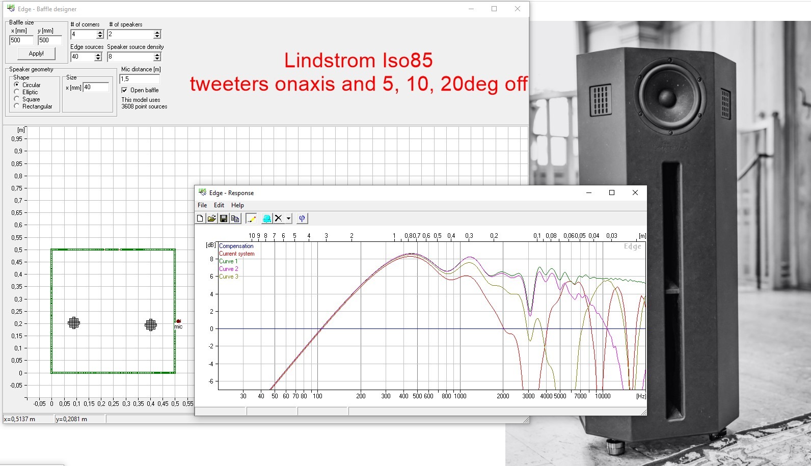

in this Edge sim tweeters are on a plane board. But in Iso85 they are almost at 90deg angle to each other, so on-axis spl is very low compared to off-axis. It would be very interesting to see good measurements of this thing! Midrange looses dipole pattern around 600Hz, starts beaming around 2khz. No idea where xo is...

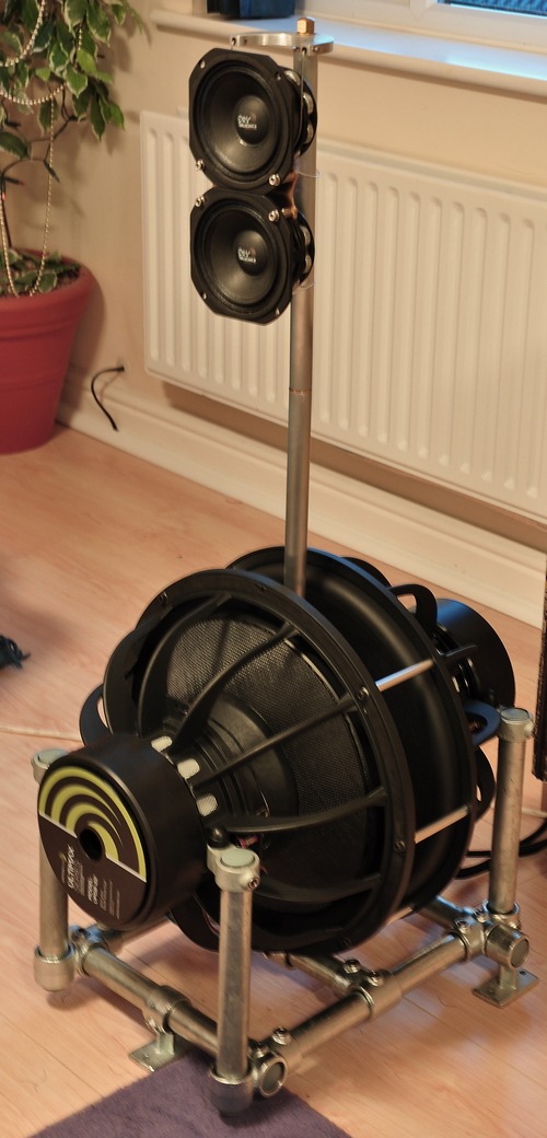

I'm wanting to build something very similar to the circles, except the drivers suspended between 2 slim vertical poles.
a naked grs 3", naked grs 8"/10", under 10" naked midbass (not sure which yet), clamshell 12"/15", linkwitz Thor.
I would prefer to use the 10" grs, but money is any issue, and I already have the 8". I could go to 12" for the midbass if necessary for cost.
The Thor will come in at 50hz. Can I get away with a 12" clamshell? And if so what are the cheap options. Ideas for cheapish midbass too?
I've never built a speaker before. Will use active xover, Except the analogue one I already have with the Thor that I also already have. I actually have 2 Thors. I'm very Thor'd.
