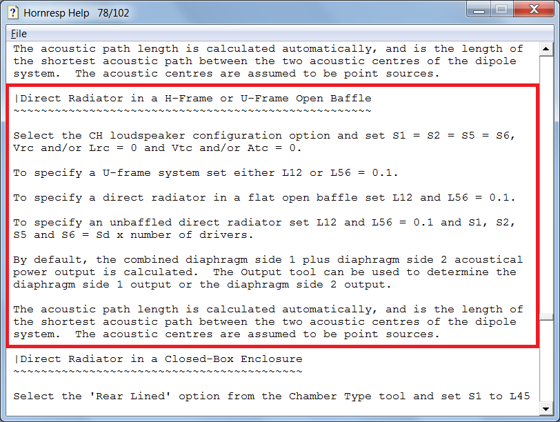

It's not so easy to model it a priori (with the exception of perhaps HornResp)

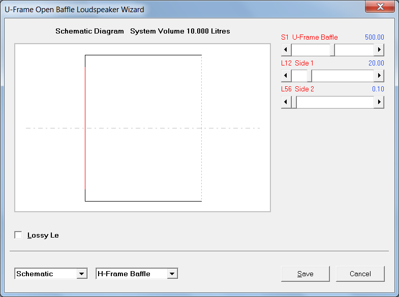

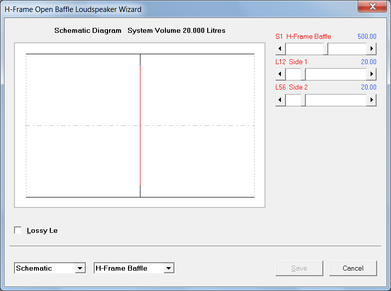

The Hornresp Loudspeaker Wizard can simulate H and U frame loudspeaker designs in real time using theoretical models developed by 'bolserst'. The model predictions have been validated against measured results.
