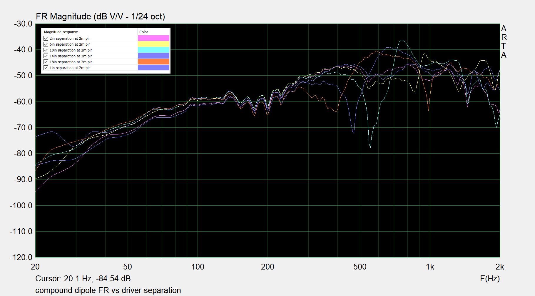

The issue with U- and H-frames that limits their upper range has to do with what is called a "tunnel resonance", meaning that the air enclosed by the frame acts as a slug that can resonate and cause peaks and dips in the response as well as differences between the on and axis responses at a given frequency at and above the frequency where these resonances begin to appear. Wall treatment of the tunnel will do nothing to change that.
Correction via DSP (IIR or FIR) is not useful because peaks and dips occur at different frequencies depending on the axis you look at.
You mentioned using a shallow frame and a goal of using the compound dipole up to 500Hz. You can just place the drivers very close together and get up to 500Hz already, so this is kind of a non-problem.
If you look at the plot below (my data) for example the yellow line would be fine up to about 500Hz.
