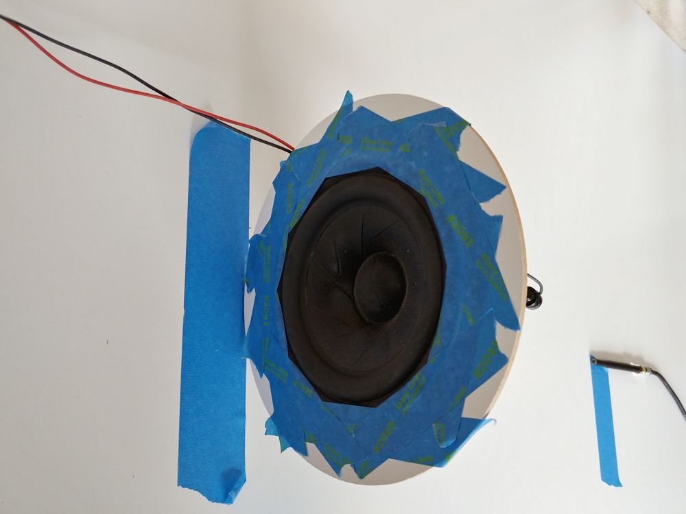

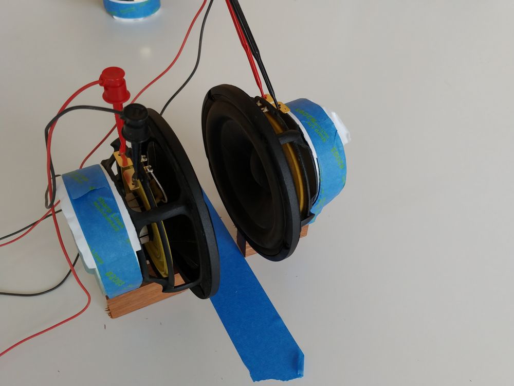

Well here is an interesting one. I made a ring that extends the driver radius by 30mm increasing the diameter to 210mm. I compared this driver with a pair of drivers spaced 60mm and the results are quite striking. First, pictures of the two setups.
attachment.php
attachment.php
And now the results. Single driver is red, clamshell dual driver is green:
attachment.php
It's difficult to recommend a clamshell arrangement that requires a second driver over (in this case) a 30mm ring of 3mm MDF. Remember the driver with the ring of MDF was drawing 1/2 the power from the amplifier. Had it been a 4R driver and been compared with the pair of 8R drivers it would have had a 3dB advantage over the clamshell arrangement with the same input power.
This result confirms my thoughts about how the clamshell arrangement behaves.

Another experiment. This time I measured 1,2,3 then 4 drivers, all with the same 90mm spacing with the front driver facing cone towards the mic, as seen below:
And the results. This time I included the dipole peak from these small drivers. No surprises here.
Note this plot is 5dB/
Ok so, not very scalable it seems.
2 dB more max by doubling from 2 to 4 drivers does not seem to be wurthwhile

I explained it a few posts back, but I'll try again.
When an unbaffled driver moves its cone forwards it pressurises the air on that side. If only one driver is used this high pressure air moves around to the other side of the cone to the low pressure region that is there. If two drivers are used in a clamshell, the low pressure region is not on the other side of that cone, it is on the far side of the furthest driver. The volume between the cones is at atmospheric pressure and doesn't change appreciably during operation.
When the path between the high pressure and low pressure sides of a driver in a dipole arrangement is increased the output of that dipole also increases. You'll read more about this on SL's site and elsewhere. What also happens is the dipole peak and first null goes down in frequency. All of these phenomena occured when I increased the baffle diameter and when I clamshelled the drivers. Using these two methods I increased the pathlength by 60mm and ended up with identical results. In my mind this proves my hypothesis correct.
