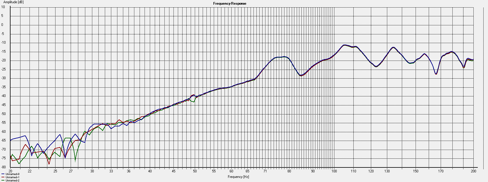

I take the question to be something like "why is there gain over the basic +3dB from doubling the power" and believe it is not trivial.
The Linkwitz model, *with* the approximations in the last step, shows that one gets the same result by multiplying a single dipole response (amplitude) by two.
Aside: it's interesting to play with the full result numerically. It reveals where the model diverges from that of a dipole with 2 units of amplitude. As expected response shapes get complicated as the clamshell spacing and wavelength become comparable.
As I think has been noted, the Linkwitz model is for point sources - so the driver/source in front does not block radiation from the one behind.
Therefore, the big question from my point of view, is whether or not such obstruction of the rear driver is important. I do not see an easy way to answer that.
By implication, I tend to agree with those who expect air-load and coupling effects to be relatively small. Consider that mms and mmd don't differ much for the drives in question (and half of the air load is on each side). There's not much sign of changing resonant frequency away from fs (unless I've missed it). We can't see fs in William Cowan's measurements which would probably be the most revealing of any coupling, if there's enough snr at fs=32Hz.
+6dB across a wide range of frequency implies that, from the microphone's point of view, the driver in front is not blocking radiation from the driver behind. That's equivalent to the assumption of point sources and the resulting factor of two as a good approximation.
The measurements suggest that can be the case, or nearly so. I don't see a good way to see why that should be the case.
I did a quick test to try to get a feel for the effect of an obstruction placed in front of a 14" driver on a baffle (not the same situation, I know). I held a cone-sized dinner plate 7 or 8 cm in front of the cone and saw almost no change in the signal on-axis at 1m, 45cm above the floor (blue curve, no plate, others with plate). The measurement shown is the raw signal in Holm Impulse, i.e., no gating or averaging. The blip near 50Hz is due to the UK line frequency and noise dominates the low end.
The presence of a baffle makes it unclear whether this measurement has relevance to the clamshell, and I don't have a spare driver of similar size to test separately. However, I did not expect the curves to overlap as closely as they do, to better than 0.5dB from 50Hz, to 190Hz.
Arguments can be made based on diffraction (big waves, small obstacle, ...), but the measurements are well within the "Fresnel" range - I thought there might be at least hints of a shadow as close as 1m.

I hope to make my own set of measurements with a pair of 15" drivers in the next day or so.

Did a couple of quick sweeps to test off axis behaviour of the clamshell vs. single driver (but still in clamshell mounting). Results inconclusive, not identical 90 degree curves, but one not clearly better than the other, either. This would need more rigorous testing.

So if I read some pages back it seems that the mistery is why two identical woofers in clampshell (with some distance in between) position output 6db more SPL?
Maybe I missed something, but that has always been the case... Two speakers sum coherently at low frequencies, so power is times 2 (+3dB) and SPL is times 2 (+6dB).
What essential thing am I missing in this discussion? Why is the 6dB not as expected?
