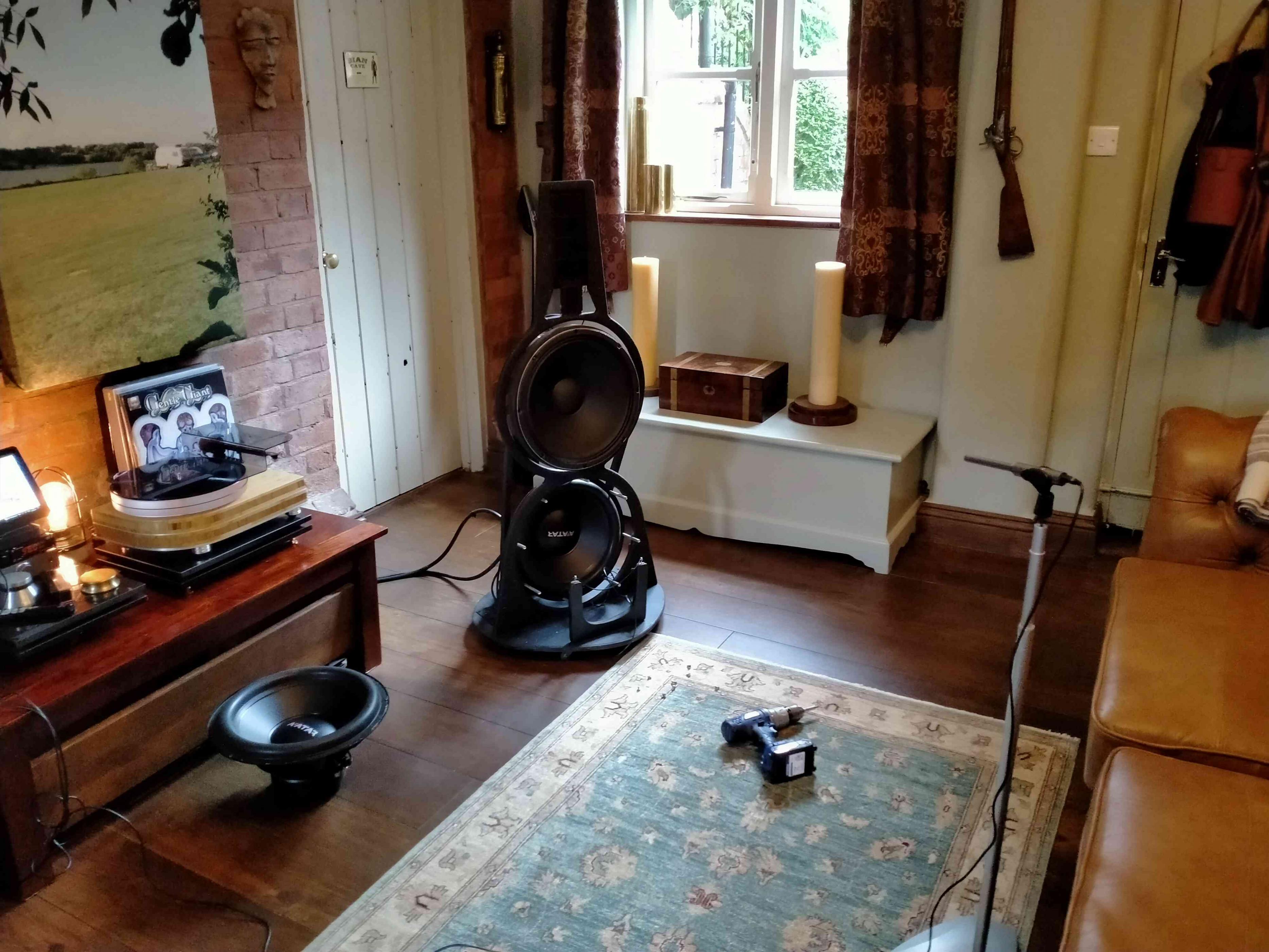

Interesting topic.

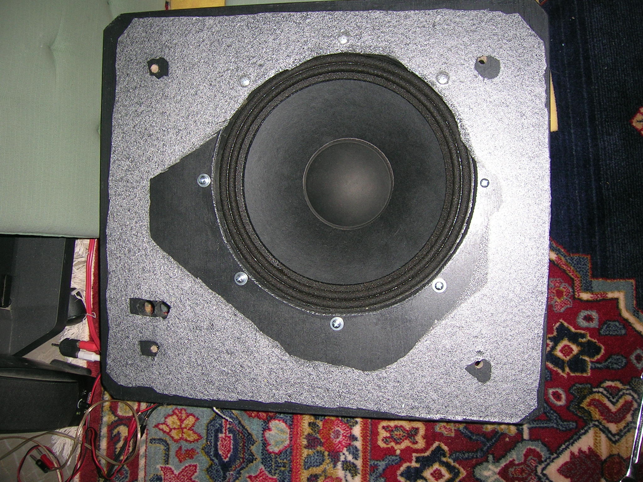

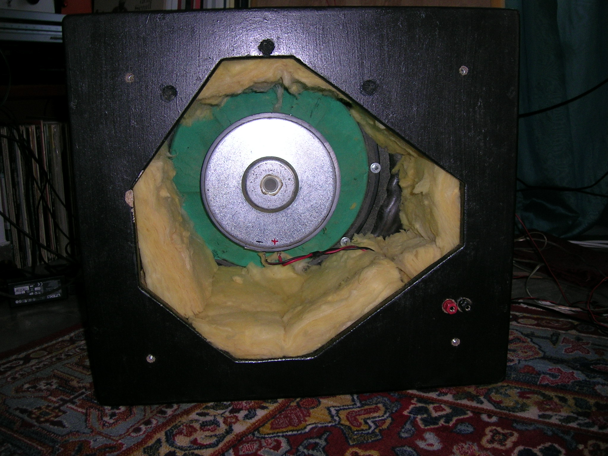

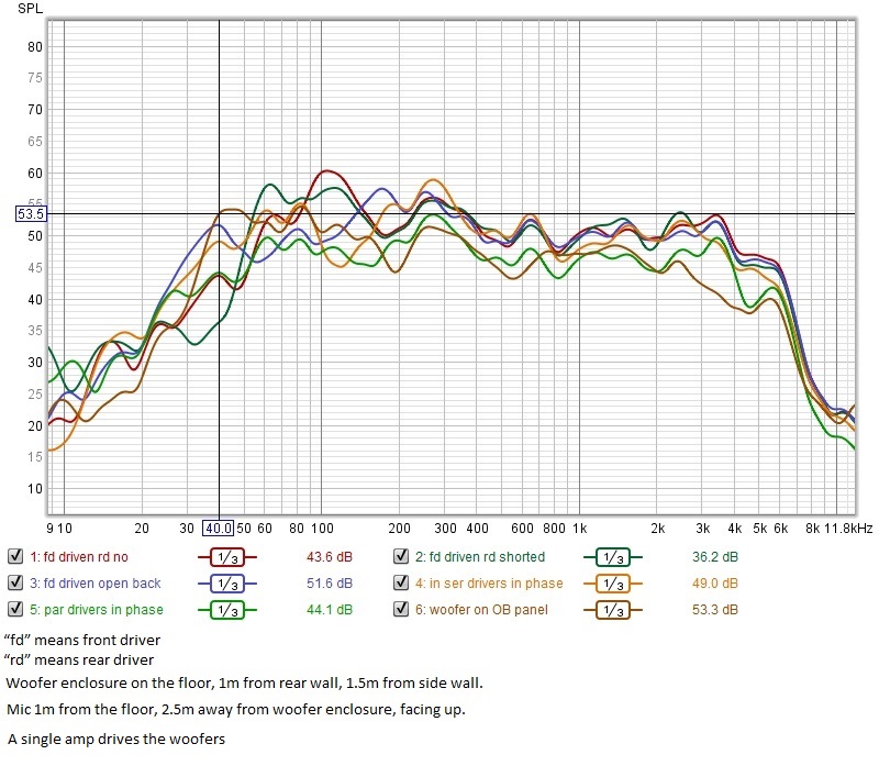

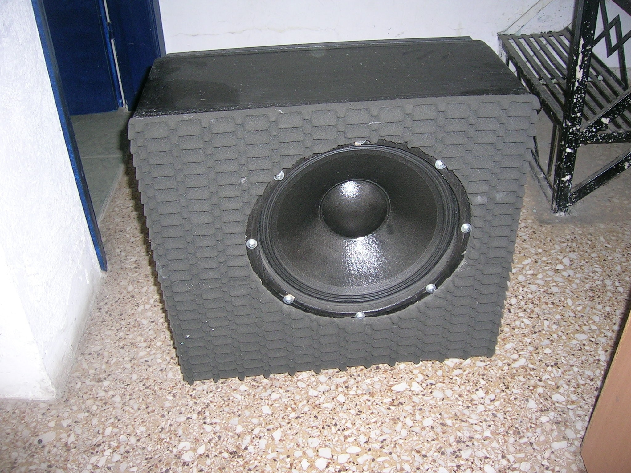

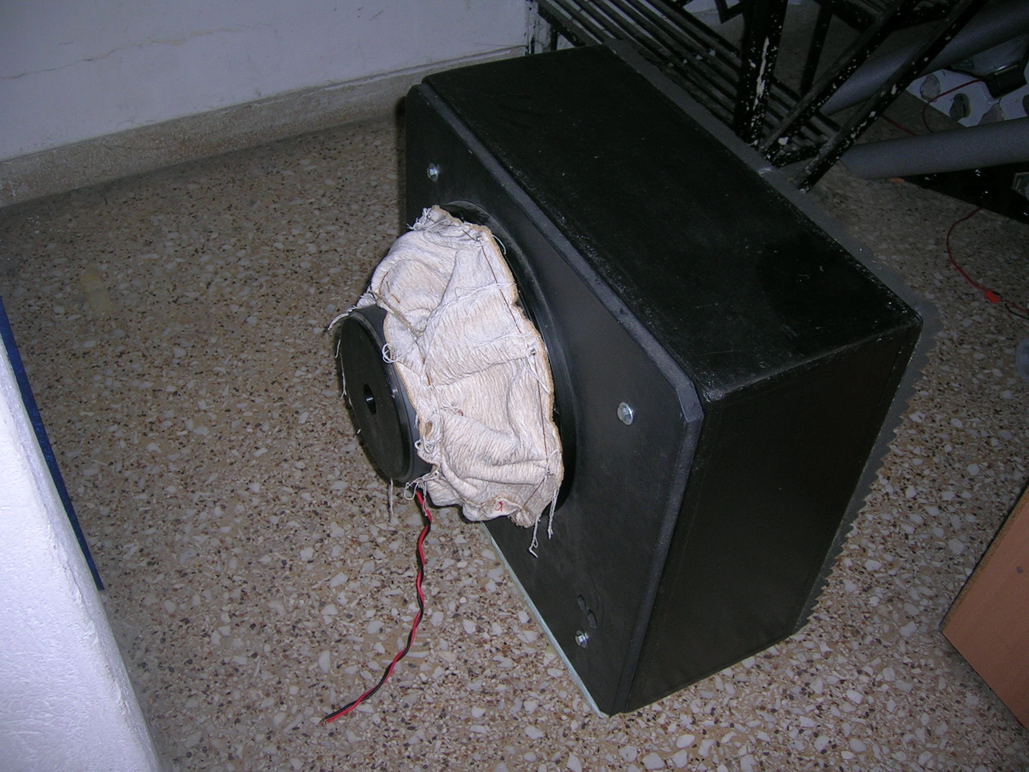

I had built (*) two small sized woofer enclosures (internal dim. In mm: Width 470, Height 420, Depth 155) intended as multimode woofer jig for 12inch woofers.
One woofer fixed on front panel, one woofer fixed on rear panel.
That rear panel could be removed (turning into one woofer open back enclosure) or replaced with a normal panel (turning into one woofer sealed enclosure).
When with two woofers, both could be driven, in series, in parallel or individually, in phase, out of phase. When one woofer only driven, the electric terminals of the other could be left open, shorted or loaded with a resistance.
All these can be tested on this rim to rim compound woofer at discussion (with small excursion woofers, no spacer is required).
I have withdrawn those boxes from use. I had better results with a single woofer (*) on an open baffle
IMHO for woofer and focusing on in-room bass, mic measurements give comparative results with acoustic feel only when mic is placed >>1m from the drivers, especially so when there is more than on woofer at play.
(*) as helper woofer for a FR on OB

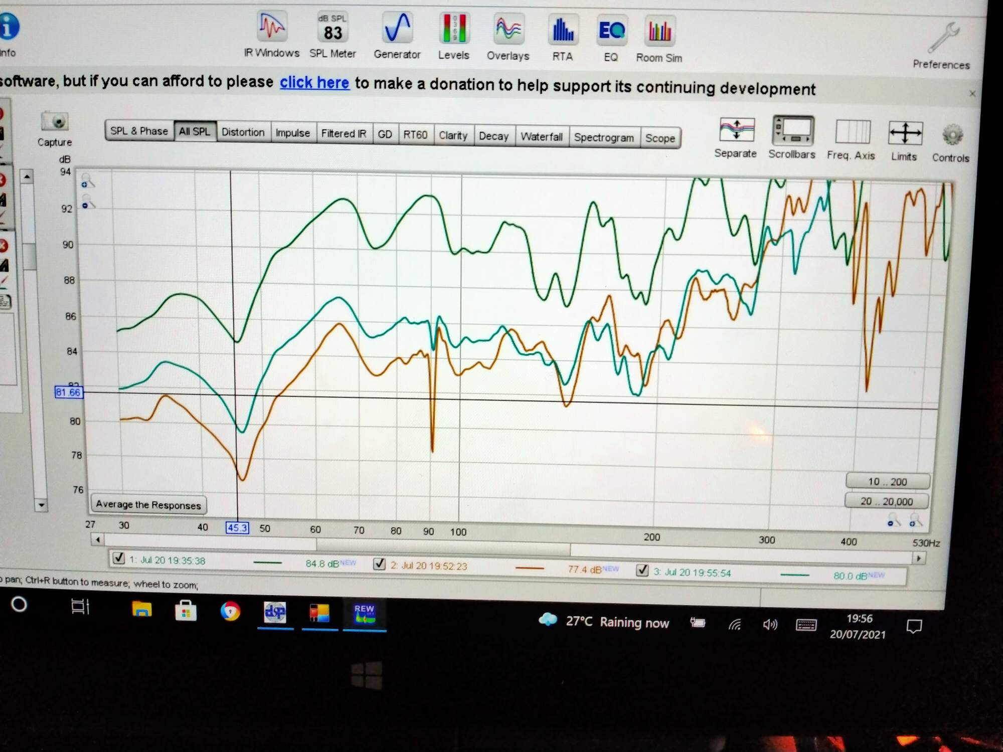

Difficult to eye ball, but it seems that you have 6 dB only below 70-ish Hz? Above that it’s more like 3 to 4?
Yeah - I think this is not real - further measurements after this confirmed 5-6dB fairly well, I actually wonder if this is to do with the dipole behaviour of this configuration ('super dipole' dispersion) and room modes - not something we have yet dared to try to measure! Or because the acoustic centre was altered by removing one driver......possible none of the above. 🙂
Really if we are trying to get to the bottom of this - it will require two identical amps, two identical drivers, and an outside measurement rig, to do proper polars outside at a decent distance over 1M - a fair bit of work....
Maybe over my summer holiday!

William - a couple of comments.
First, thanks for the measurements. The more data we get on different arrangements and with different sizes of drivers the better we will be able to understand what is going on. I hope to make my own set of measurements with a pair of 15" drivers in the next day or so.
I think we have to be careful at this point to draw conclusions. The dip could be related to the chassis diamater, or it could be that the distance means that, at that frequency, the sources are no longer "acoustically close", which was an underlying assumption in SL's model. Measurements over the same range of separation but with e.g. larger drivers might be able to differentiate between these two possibilities.
Attributing the effect to an increased rear-to-rear pathlength would seem to go against SL's model. I have pasted the page below. The separation distance between the driver centers (he uses d2 for that) does not contribute to the magnitude, H(f). Rather it is only d1, which is the effective front to back pathlength for a single driver. It seems counter-intuitive, but that is the result he presents.

[image]The plot with the drivers sealed in a tube vs nude suggests to me this arrangement is behaving as though there is a slug of air simply moving back and forth between the two drivers, when they are mounted reasonably close together, not two different to b. in this image:
[image]
The top plot also suggests this is true up until it all falls apart around when the spacing aproaches the chassis diameter.[/image]
I believe the measured gain is simply from the increased path length of driver one rear to driver two rear as opposed to driver one front to rear. Linkwitz calls this "D" in his calculations. A second driver, a larger baffle or a winged arrangement (eg H baffle) can be used to increase D. A second driver can only increase D by so much.
