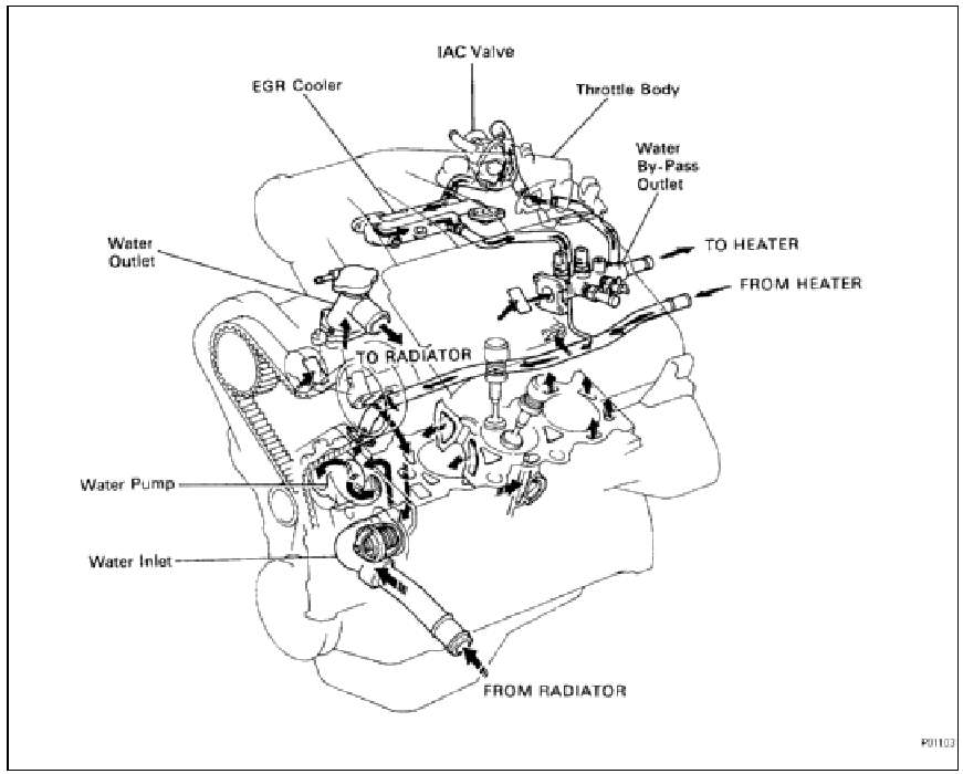

I think I found the misfire problem that I was having with my 3VZ-FE.
There are two small hoses both the same size, one vacuum and one hot water, one going into the top of the intake manifold and one going underneath the intake manifold into the heater pipe which runs the entire length of the block to the other side where the water pump is.
I think I might've accidentally switched the two around and the engine was sucking water into the intake manifold for a short while when I took it for a test drive about 6 months ago or more. Hence the misfire.
Easy enough to mess up... Hopefully it won't have a bent conrod, engines with blown head gaskets don't get bent conrods.. so it should be fine and dandy.
Anyway the problem has been corrected now:

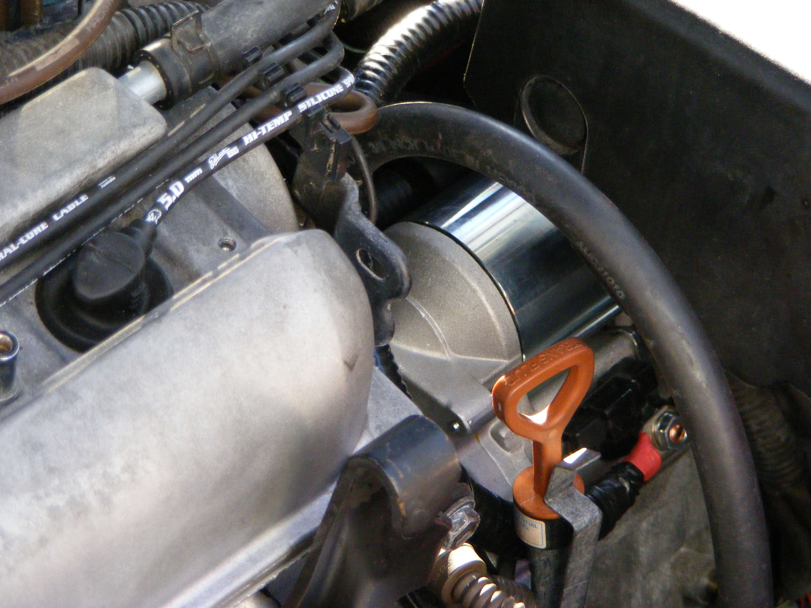

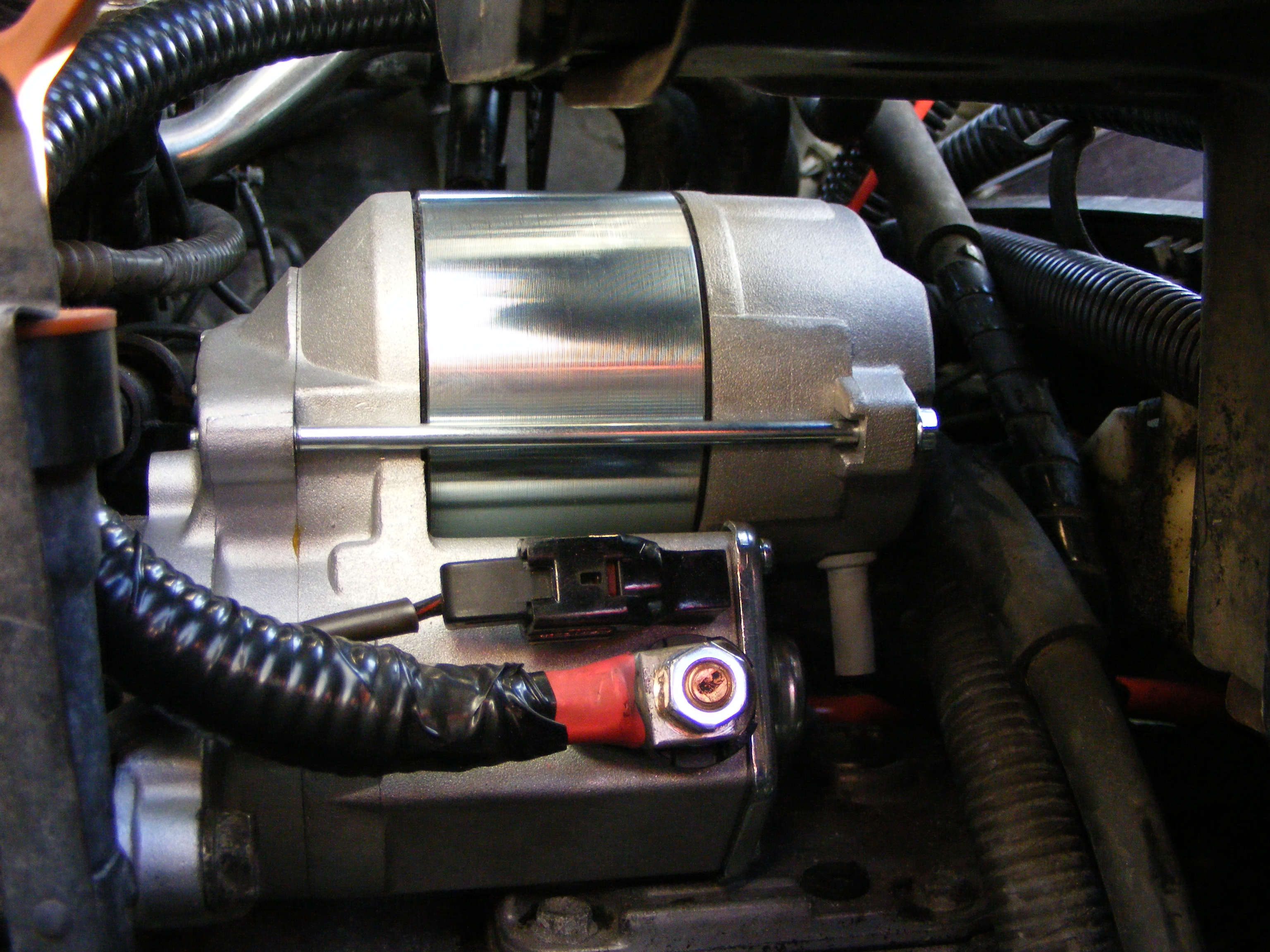

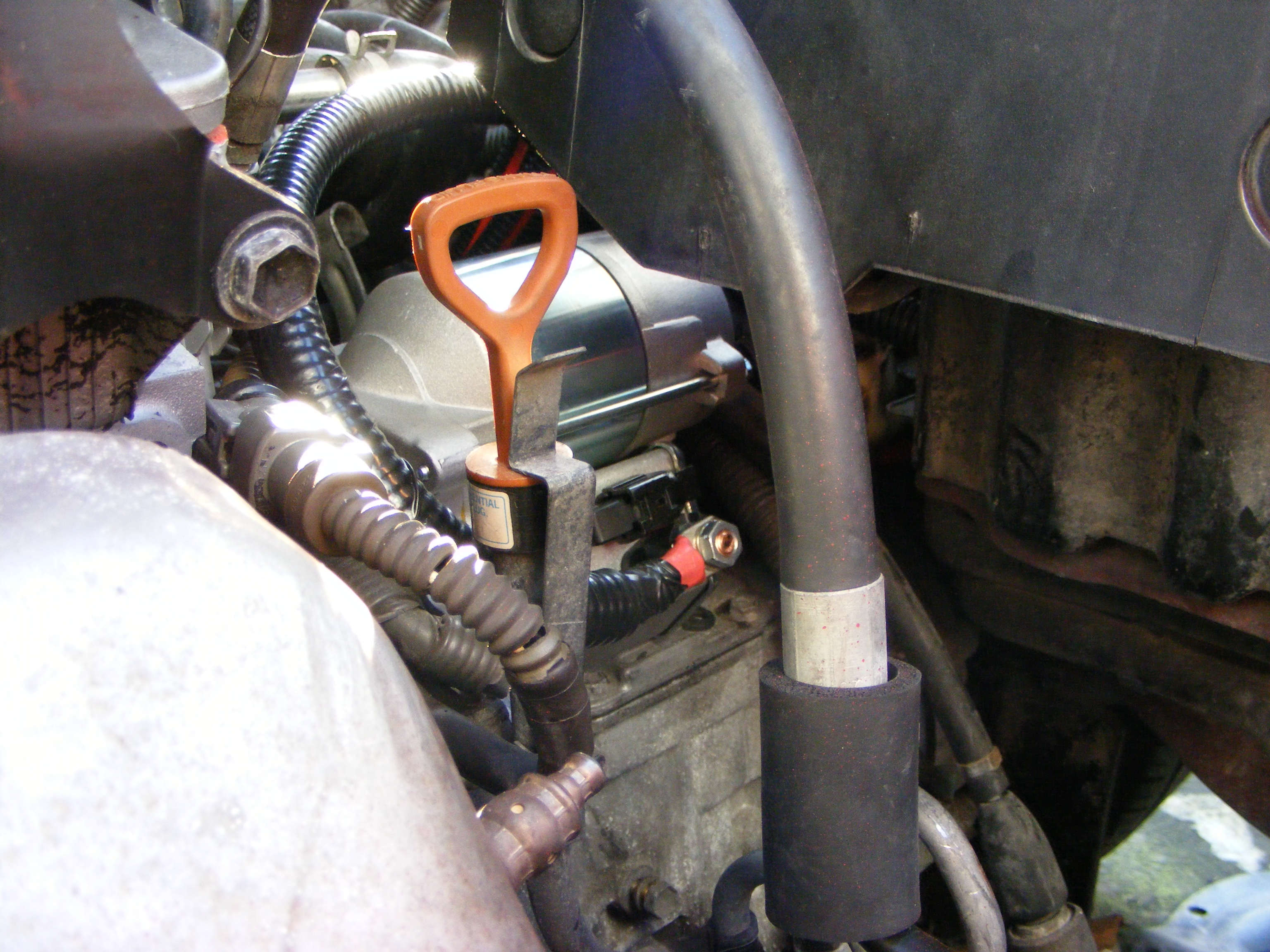

2) Replaced the starter motor.

But I now suspect that it may have been water leaking into the intake manifold and where the intake hose is plumbed into is where number 5 and 6 cylinder intake valves are located. Anyway I did remove the spark plugs and I did notice a small amount of water residue on the piston in number 5 cylinder (front cylinder bank), no other cylinders were wet like this.
I assumed at the time that the injector was bad and that it was stuck open, hence the white smoke from the exhaust, but I now suspect that it was water leaking into the intake manifold. So mystery solved!
So when I start the engine up again sometime this week NONE of the original symptoms will be there and the engine will purr like a kitten.
The fact that it was an intermittent fault and it would sound perfectly fine for up to a minute with no loud sounds tells me that there isn't any permanent damage done to the engine and it sounded like that before I shut it down.
But who knows for sure...
A precautionary tale.
In the image below with that hose returning from the EGR cooler mounted underneath the intake manifold/throttle body, that paticular hose may have been crossed over with a vacuum hose that goes to the same IAC valve and the intake manifold which is in the same area.
Silly design.

Does the coolant smell of exhaust by chance?
If not it doesn’t have any solid bearing on whether the gasket is bad or not, the water can go into the cylinder while the exhaust gasses don’t pass into the water jackets, and visa versa.
Can you borrow a compression tester ?
It sounds from witnessing the water in the cylinder that you are in for a head gasket replacement, but it is always good to have more than one indicator.

Either one is preventing it from starting. The battery is sitting at 12.00v and I've got it on charge overnight.
Shame really, it was a really expensive Supercharge Gold Plus battery.... it is a few years old now though.
I remember fully charging it before I disconnected it from the car... it may have a problem if it can't hold a charge over 5 months.
But I'm betting that its a faulty starter motor. the starter motor relay won't even engage. I've checked the circuit going to the relay on the starter motor with an indicator light and it IS getting power so I'm thinking that the starter motor is fubar.
I couldn't even get a single crank out of it and no sound, zilch, came out of the starter motor. So I'm thinking we have a faulty starter motor.
I'm not 100% sure that its the battery, the interior lights didn't dim when I turned the key which means that the starter isn't even drawing current from the battery.
Tomorrow I'll hit the relay with a hammer and see if that fixes it.

I ripped out the dead battery and went off to Walmart. The exact same battery that cost me $79 6 years ago was now $119. I put it in the car, and tested the voltage, 12.7 volts. Starting the car yields 13.9 volts, so the alternator is indeed alternating.
Bosch starters were the preferred unit on the old 2.2 L Dodge / Chrylser turbo engines because they handled the heat better than the Japanese or American starters. They also had brushes that could be replaced without taking the starter apart.
A long period of non use can cause some sort of non conductive film to develop on the brushes. Usually spinning the armature by hand or with a screwdriver (if possible) will clear it. The old GM (Holden) starters used a copper disk in the solenoid. A green corrosion would grow on the disk making them inoperative. Disassembly and a wire brush was the fix. I don't know how your starter is built, but no current is likely a corroded part somewhere.

Its a brand new Bosch starter tubelab... If it came pre-corroded when I bought it then that doesn't bode well for the rest of its service life.
There shouldn't be anything wrong with it at all. I even have the test slip right in front of me.
Unless maybe the corrosion is somewhere else. Possibly on the 35mmsq cable that I didn't cover in corrosion inhibitor on either the transmission housing or the body of the car.
There was a bit of corrosion around the crimp of the lugs on the negative leads but I didn't think it was going to be an issue in starting the car. I think I'll go down there this morning and see whats up with an ohm meter.
I'll probably clean them all anyway and seal them up with RTV silicone just for good measure.

Maybe then the water pump bearings have gone and the timing belt is losing tension. That I would believe. Because guess what, the water pump is driven by the timing belt!
And there is water leaking out around where the water pump is but its covered by a plastic timing belt cover so I cannot see properly for sure, and this cover is a pain in the *** to get off.
I'll have to pop open the timing cover and take a look.
I pulled the timing cover off to get a good look at a few things and I think one of the timing bearings (or the power steering pump, it is a bit low on oil, I'm filling it up at the moment.) is making that noise, anyway it went away after a few minutes of running the engine. I had a good look at the whole area with a HID spotlight. As you say tubelab its not the timing belt, everything is tight in there despite the squirrelly bearing coming from somewhere. I placed a listening stick onto the water pump, power steering pump and timing belt bearings and I couldn't narrow it down but that doesn't mean its not bad. I think its a timing bearing anyway.
No water leak from the water pump at all. The water pump is tight as a drum.
