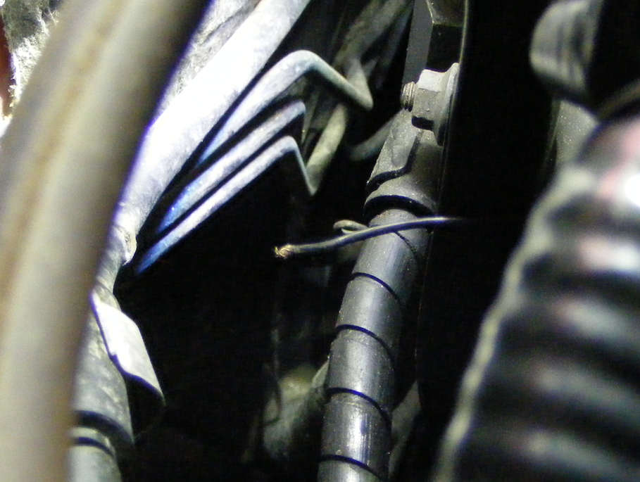

Here I am ready to get all technical about diagnosing a faulty O2 sensor and I do a visual inspection on the thing and its not even wired up, in fact the wire going to the O2 sensors plug is snapped off at the female socket side.
I even got the old analog multimeter out and was ready to start counting oscillations of the O2 sensors to see if they're finicky...
Well THERE'S your problem!

I repaired the wiring and made a new cable run going to the rear bank O2 sensor. I then did the O2 sensor test.
