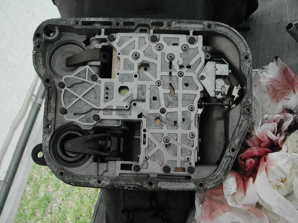

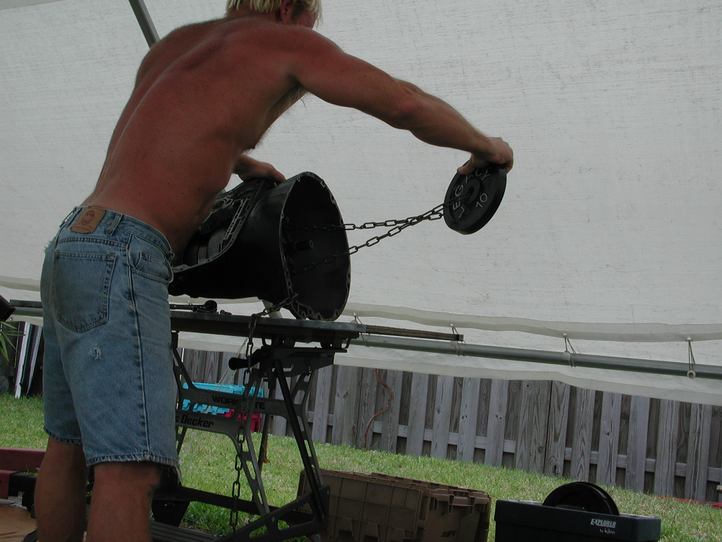

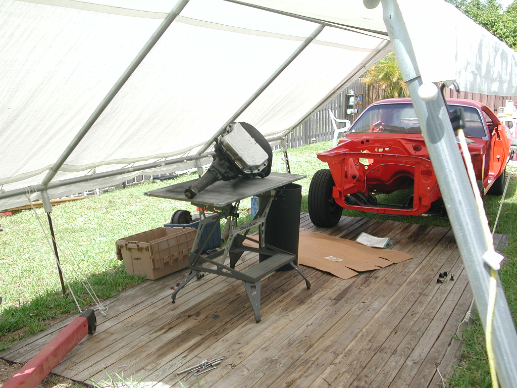

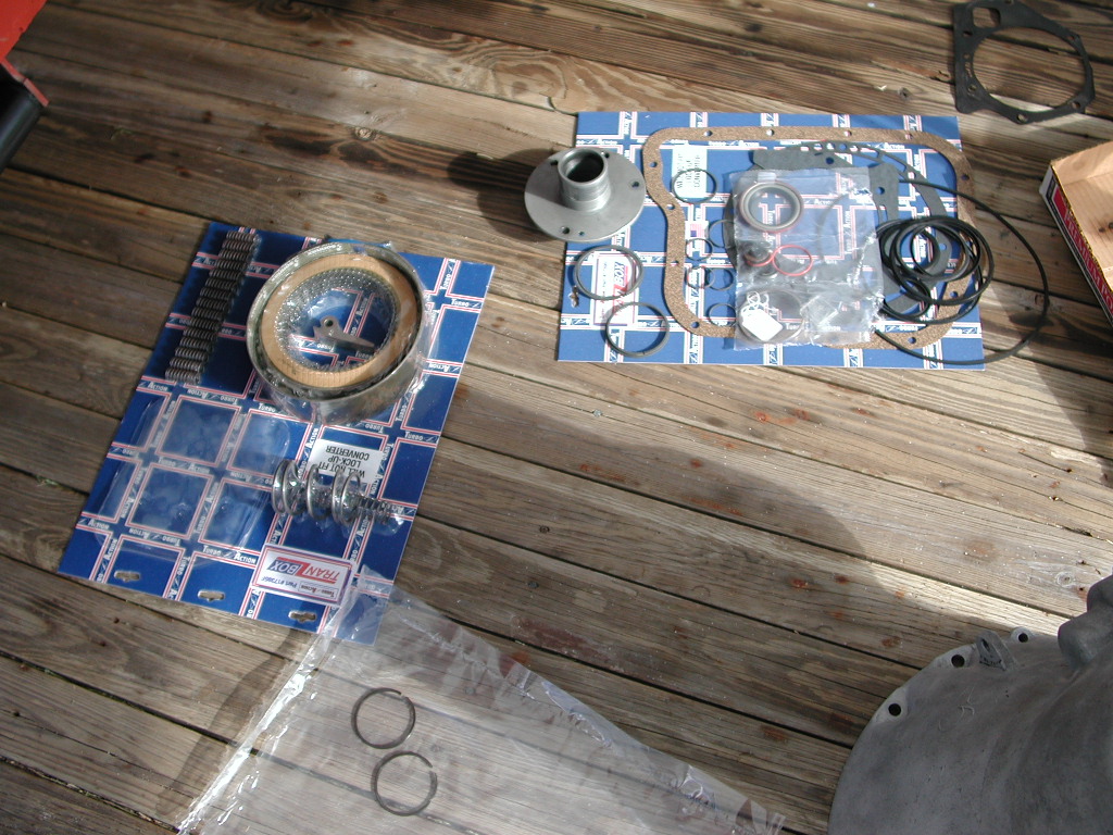

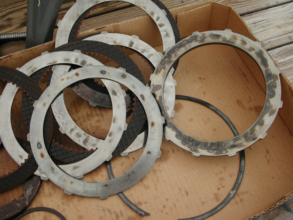

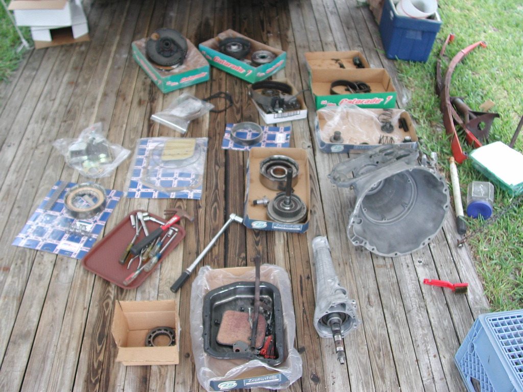

Way back in the mid 70's I had a 1973 GMC (Chevrolet) van. It's automatic transmission had blown and I decided to rebuild it. I had already rebuilt the engine since it was sick when I bought the van (cheap). I took it out of the van and disassembled it one piece at a time taking a Polaroid picture of each piece numbering and making notes on each picture. The digital camera had not yet been invented.
So this greasy, dirty 25 year old kid (me) shows up at the local Chevrolet with a broken part or two and a stack of pictures looking for a replacement. At first the older guy behind the parts counter is not happy about looking up the internals of a TurboHydramatic 350 transmission, but eventually lets me look through the breakdown book to find the part numbers, and he orders me some parts. By the time those parts come in, I need more. On about the third trip, he asks if it would help if he gave me an old (discarded) version of the breakdown manual. He was basically making life easier on himself by getting me out of his hair, but that breakdown manual was a big help when it became time to put that thing back together. We became friends through these visits and I talked to him at the Chevy store whenever I went there. After about 3 years and 50,000 miles of abuse from being between a hot rodded V8 engine and a 4,000 pound van being driven by my lead foot, the trans would blow again. This time I went to see my friend with one long list and got a 10% discount on the parts.

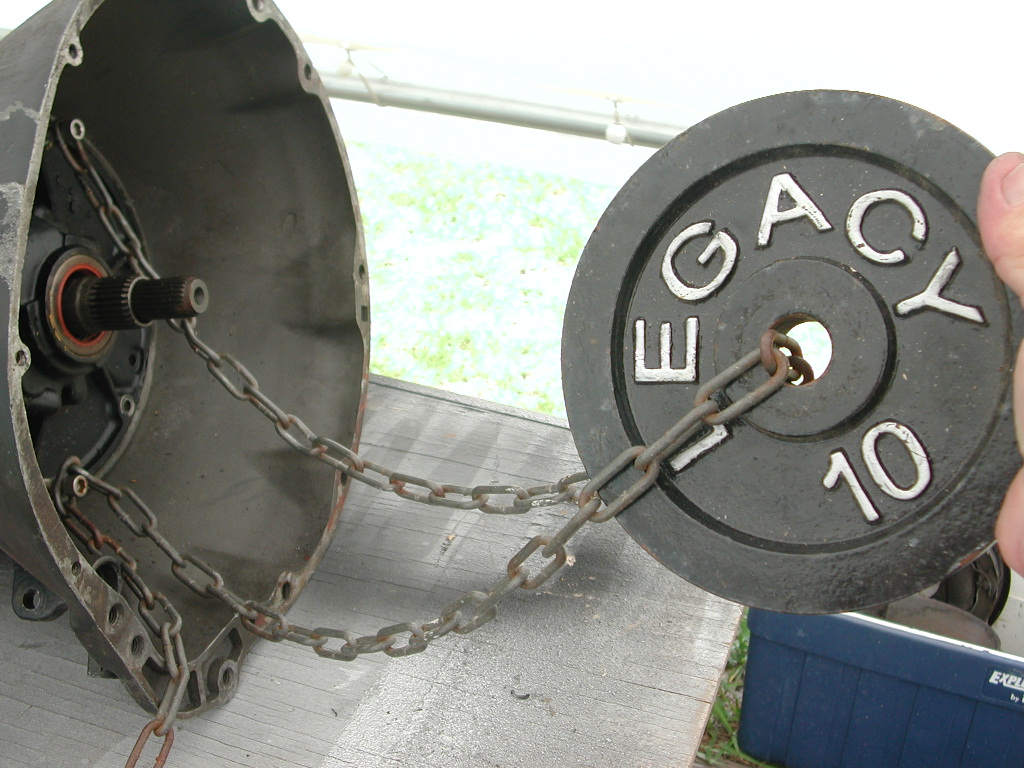

Fast forward to the mid 2000's. I am building the "last hot rod." The TorqueFilte 727 needs rebuild as did EVERYTHING in the car. This time app parts are sourced from the internet and the photos are digital. Primitive 3 megapixel digital, but a step up from the old Polaroid instant camera.
The transmission is on the "operating table" which is a steel shelf on a Black and Decker Workmate under a makeshift awning in the back yard. The car has been stripped and painted and reassembly has begun. The front and rear suspensions, Sure Grip rear end, and braking systems are new or rebuilt. A 500+ HP 440 Cubic inch (7.2L) engine is built and waits nearby. So does several packages of transmission parts.
The book will tell you that a special puller is required to get the front pump housing off. The dumb blonde will show you how to do this with a piece of chain, two bolts, a 10 pound exercise weight, and a bit of momentum.
About 100 pictures were taken of each step during the disassembly. All parts suitable for reuse were cleaned and sorted by subassembly. Replacement parts were ordered for anything that didn't look suitable for abuse.
Complete transmission kit, some assembly required.....

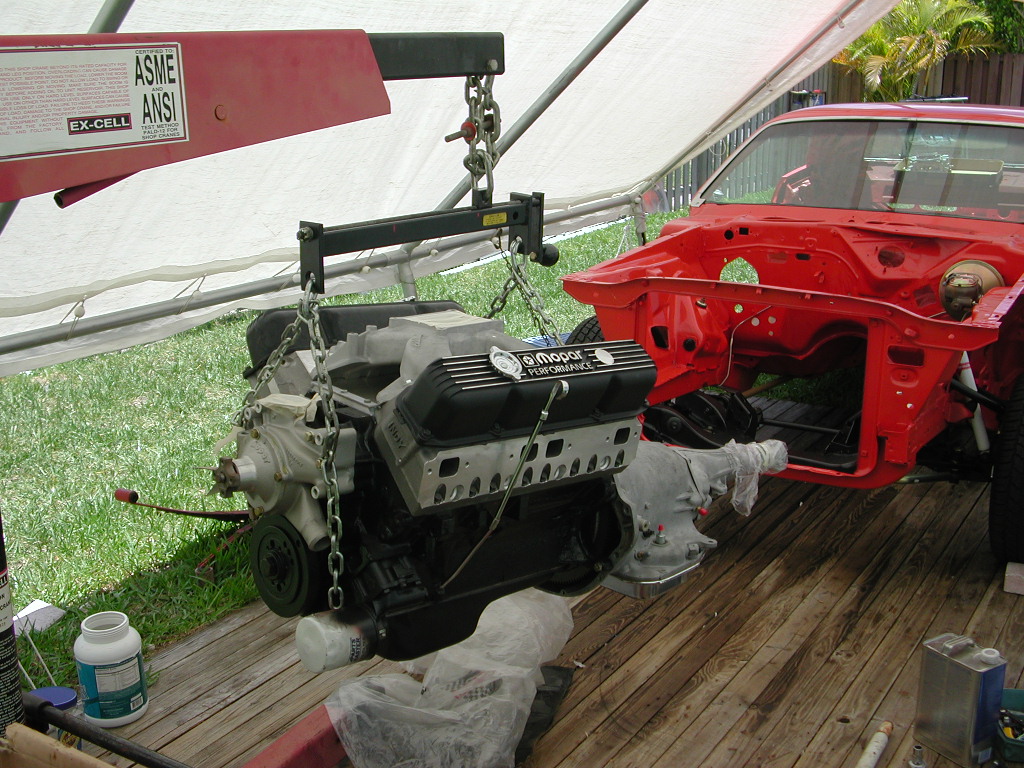

OK lets hang this thing......about 600 pounds of heavy metal.
OK, there's enough parts on this thing for.......a big smoky burnout.
The ninth picture shows the house across the street. The brown car in the driveway is a Mercury Comet, which is also sold as a Ford Maverick and I believe was also the basis for the Aussie Falcon in the early / mid 70's.

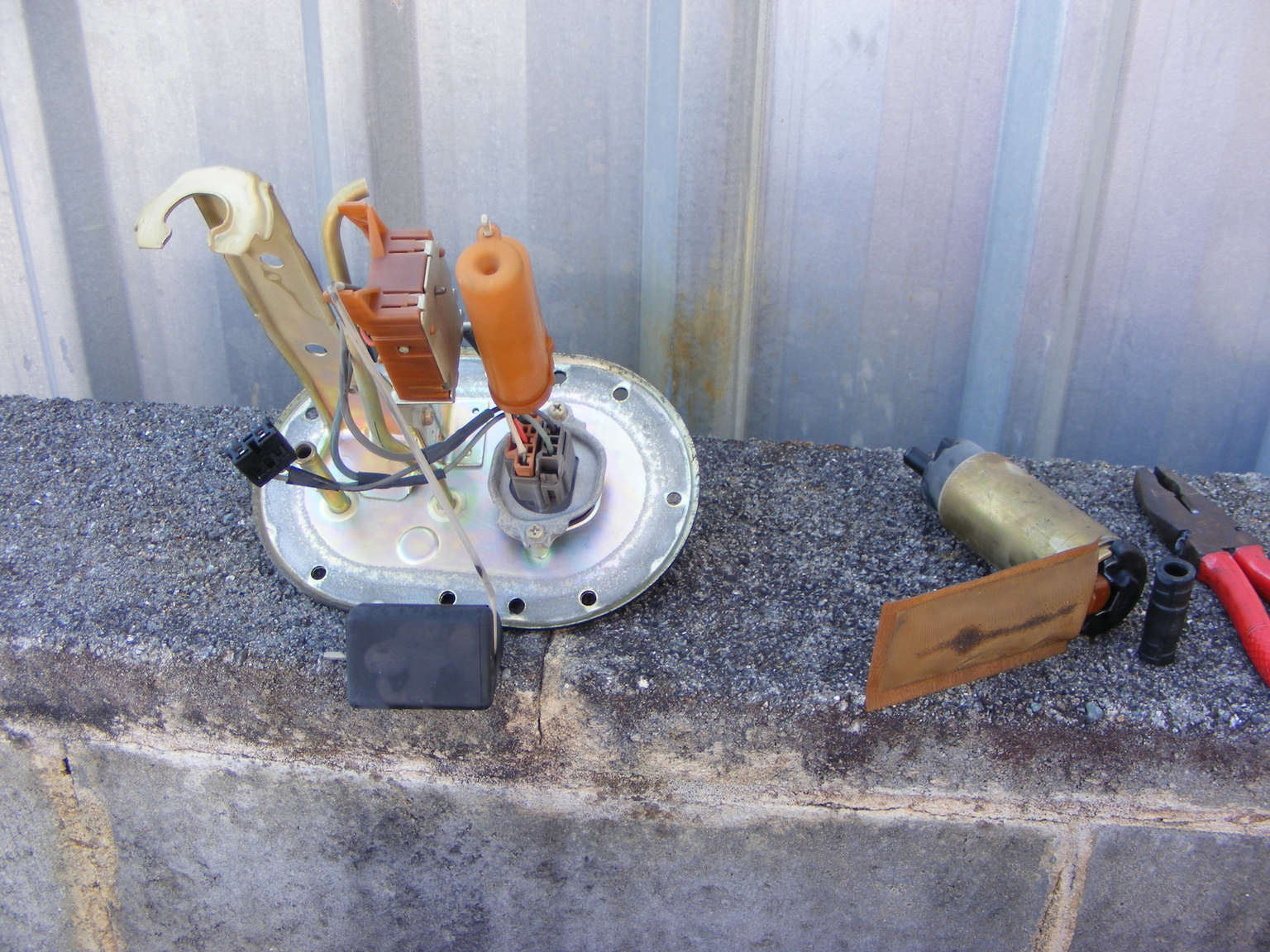

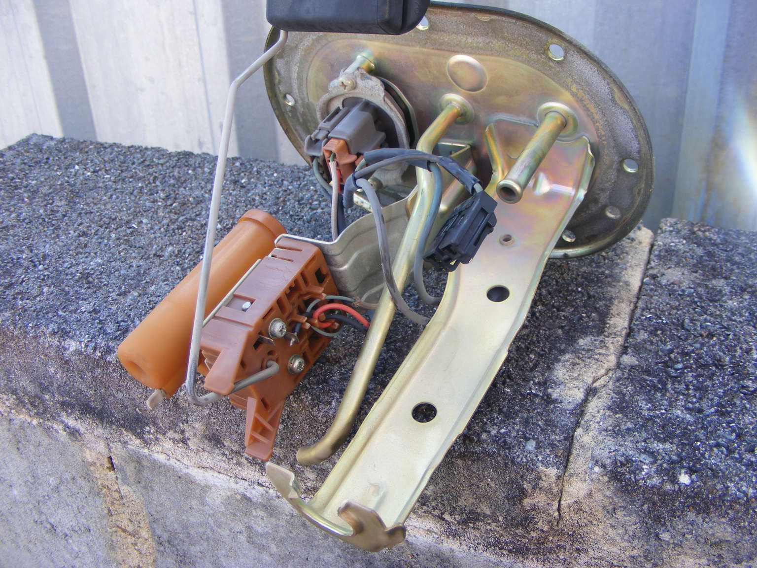

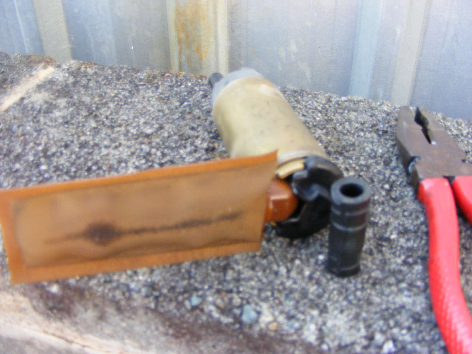

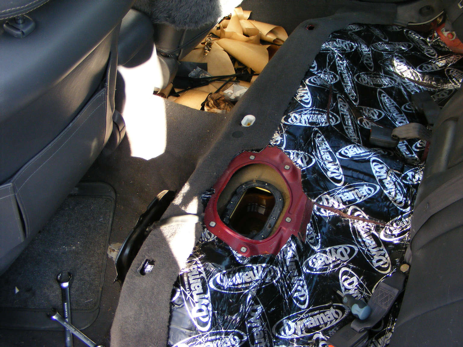

Got the old fuel pump out. Rang up Toyota and after politely giving me the Toyota part number (23221-28280) , I asked for the price of a new one... $751 AUD.
Anyway. I rang up Bursons after that and they said they can get me one for the VCV10R Camry for $200 and its a Denso so I'm going to go for that on Monday.

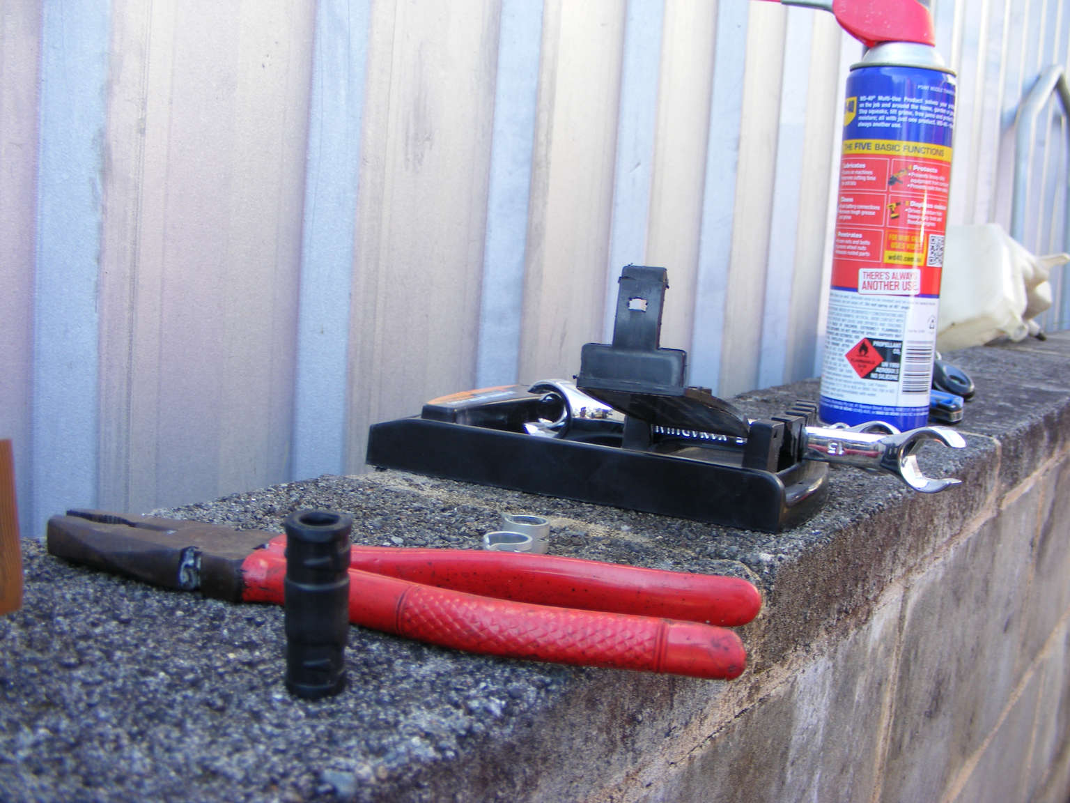

Today all I did was go down to Bunnings and bought some cheap indian flare nut wrenches for $21. I don't have much money until next pay next week so can't do anything. My neighbor came over and helped out with cracking the fuel hardline nuts for me with a big monkey wrench. I owe him a Pizza.
All he did really was hold the smaller line really steady with the huge monkey wrench and then broke the other nut off with the flare spanner. It took quite a lot of force and I was constantly bending the lines with my two small flare spanners so in came the monkey wrench. He then sat on top of the fuel tank and in between his legs undone the nuts getting some good leverage with the monkey wrench there.
I kept all of the doors open when I was poking around in the gas tank to keep the fumes from building up and then closed it up again when I was finished by putting the sender unit back on top and putting all of the screws back in, then I put the cabin/firewall cover back on over the top of that. Its probably not a good idea to use flash photography around gas tanks either so I just took a few shots without flash.
With all of this wind about I'm really nervous about static.

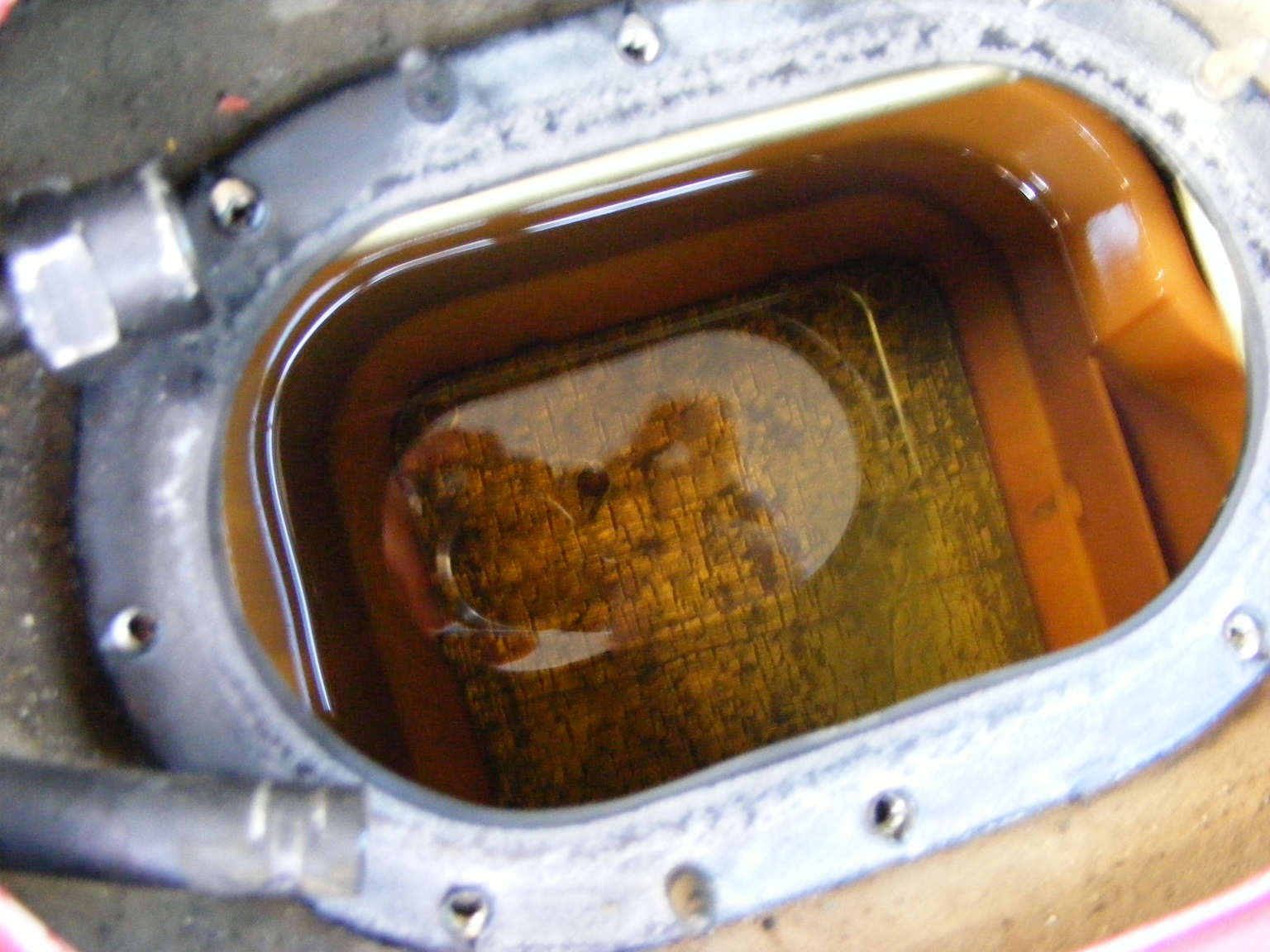

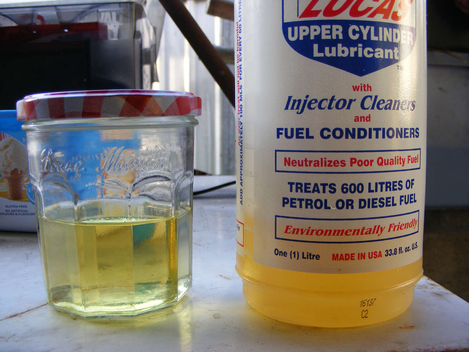

I'm gonna go get a glass jar and take a sample of the fuel in the fuel tank. See if tubelab is correct in it being contaminated. It does look quite yellowed in the photos but that could be just tarnishing of the metalwork and plastics in the tank.
Something tells me that the Lucas upper cylinder lubricant and fuel injector cleaner that I put into the tank 6+ months ago is still in there.
This sample would be a mixture of old fuel (which was mostly gone when I topped it up) and probably 3/4 of fresh fuel.
But if the fuel stabilizer in Lucas is any good then the fuel should still be good too.
So weighing up those options I would have to say that the fuel isn't bad. It looks JUST LIKE stale fuel though...

Fuel injection is under pressure. I can't see that if the fuel pump delivers the correct pressure when on flat ground that that would change going up a hill. If the pump is so weak that it can't pump fuel up a 10% incline (most hills are not more than that) then it should not be strong enough to pump on flat ground either I would think.
The usual problem with up hill would be if the fuel level was low and the pickup was uncovered thus sucking in air.
It won't hurt to replace the pump, but I'm not convinced it will fix your problem...

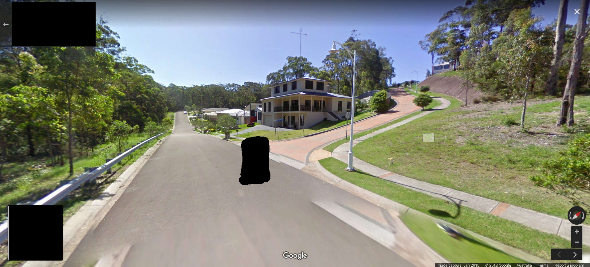

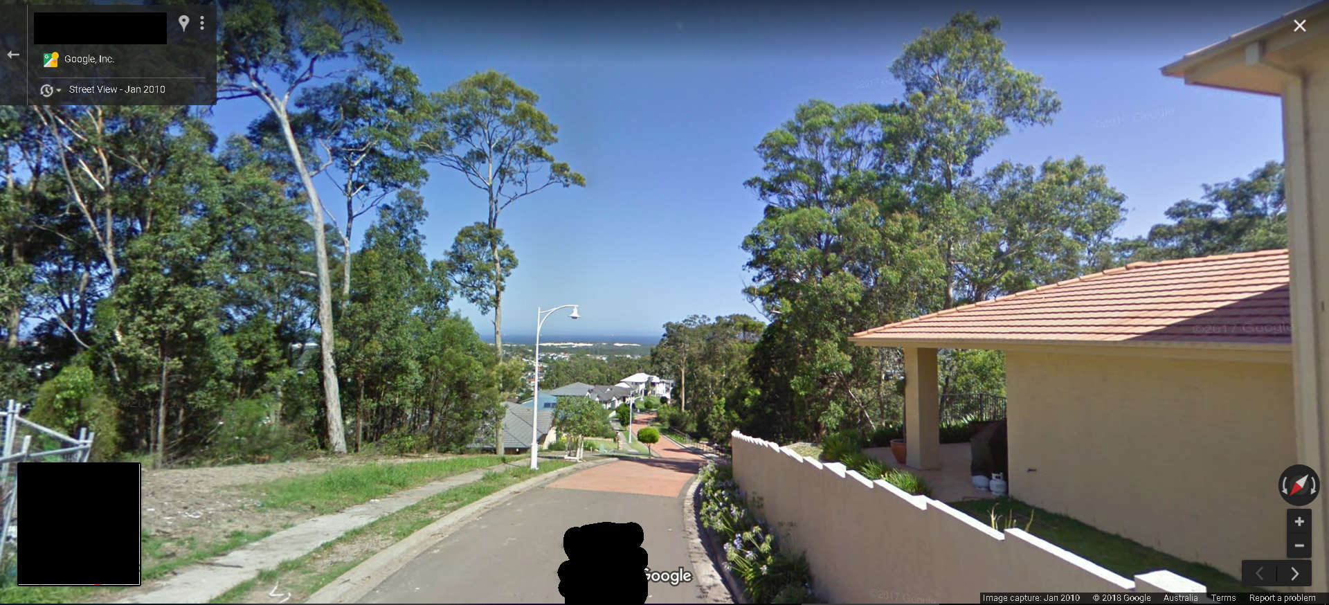

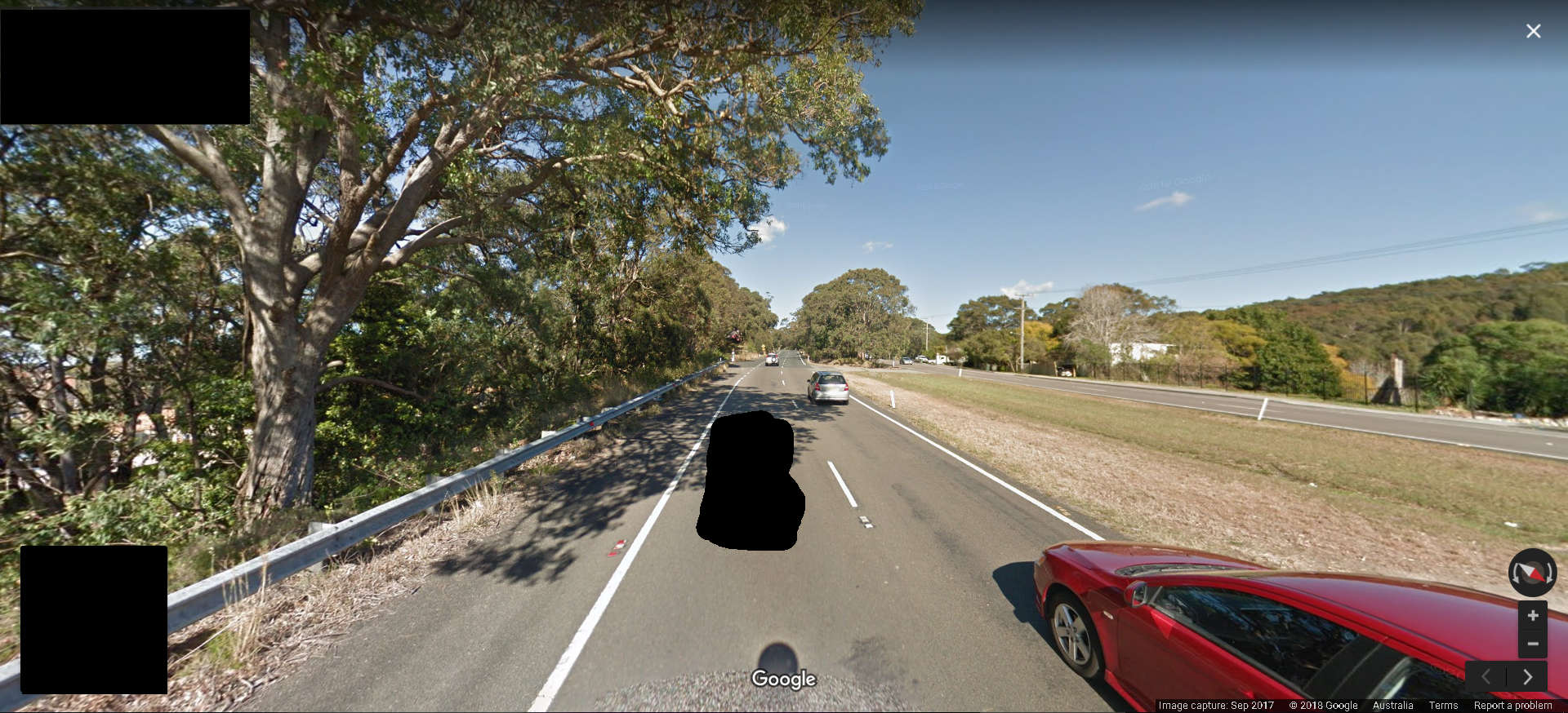

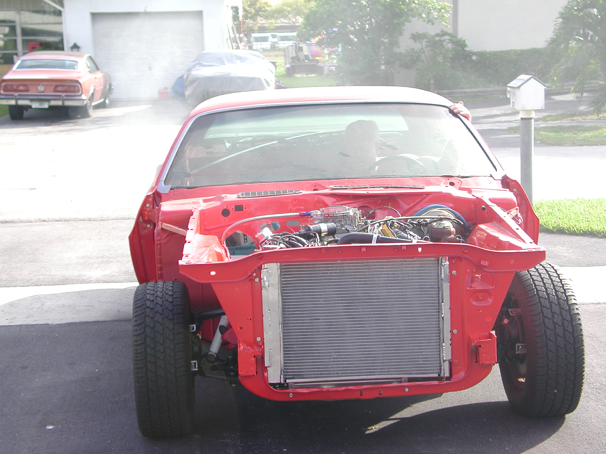

You mean the road that I use as an acid test before buying a new car? A road nearby here is easily a 20 degree incline.
But my car couldn't even get up a 10 degree incline not far from where these pictures were taken. In the 3rd pic is the stretch of highway that my car failed to climb and I had to throttle back greatly to prevent the engine from conking out completely, which lead me to the conclusion that it may be a possible fuel starvation issue. It still climbed the hill at a lower RPM and it stopped misfiring when I did so.
And yet my car could get up this hill (as shown in pics 1 and 2) when I bought it on the same 1/4 tank level of fuel, but now it doesn't. But I'm sure having an engine that is flooded with fuel would do that haha.
First picture is the view from the top, second is from the bottom.
With 3/4 of a tank full of fresh fuel and 1/4 of old fuel with the fuel gauge reading at just over 1/4 full. I still find it hard to believe that the 1/4 of old fuel still left in the tank was enough to cause it to cough and sputter and struggle to get up the 10 degree inclined hill.
And it is that which has led me to believe that the fuel pump was at fault.
