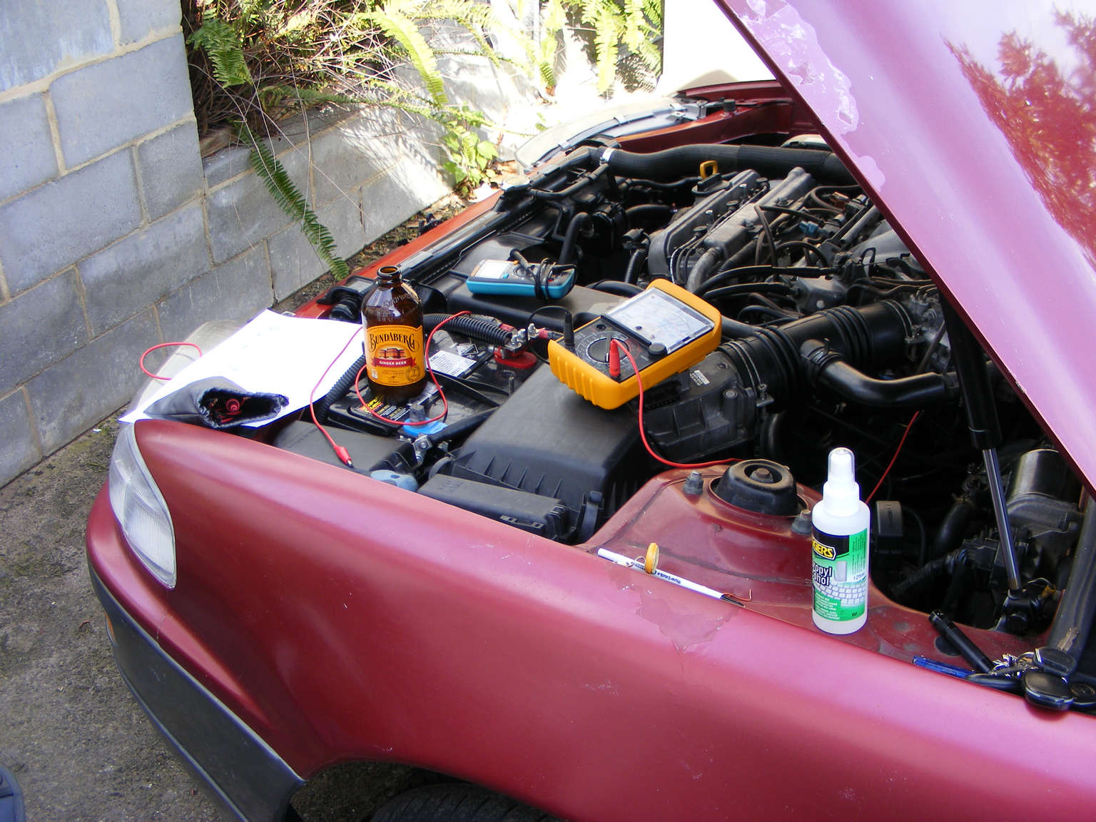

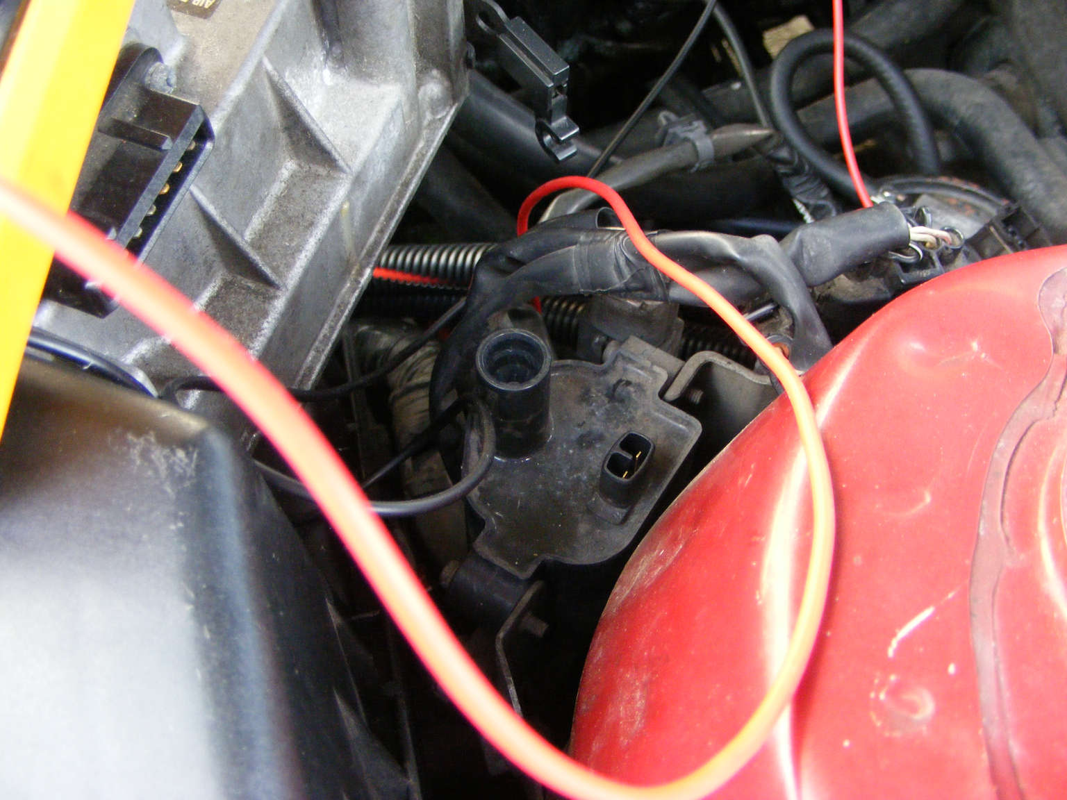

We can test the ignition coil! with the service manual and a digital multimeter.
We can also test the throttle position sensor for any dead spots/and or any shuddering in the readings on the DMM.
And that is what I intend on doing today.

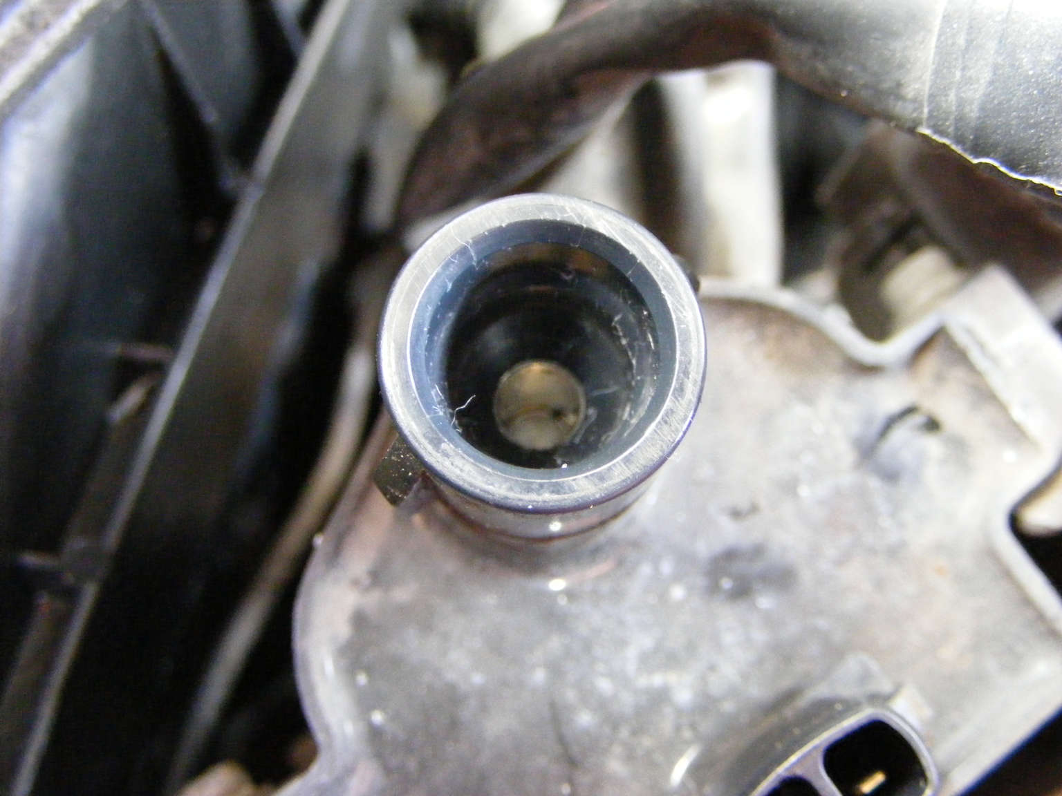

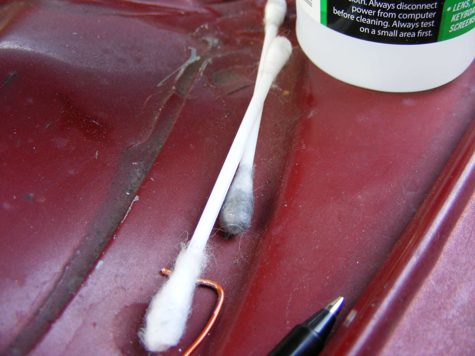

I'm also going to clean the insulator tower on the ignition coil with a q tip and some isoprop.

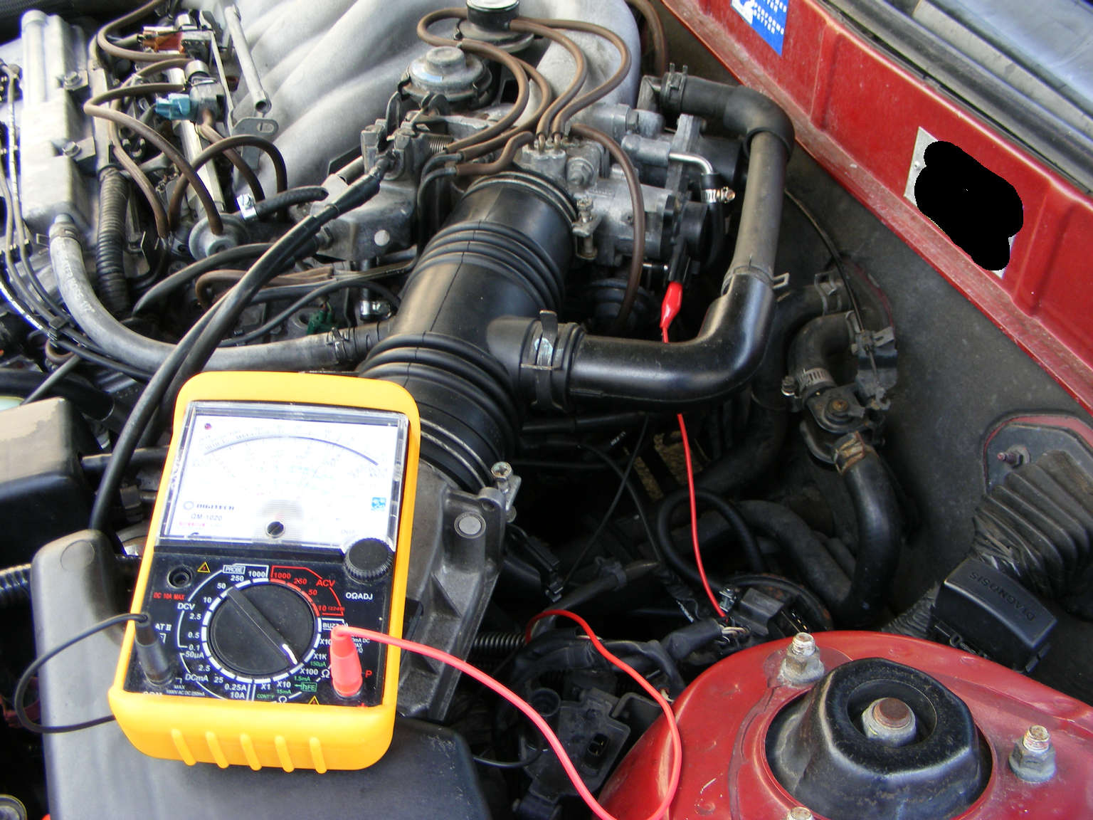

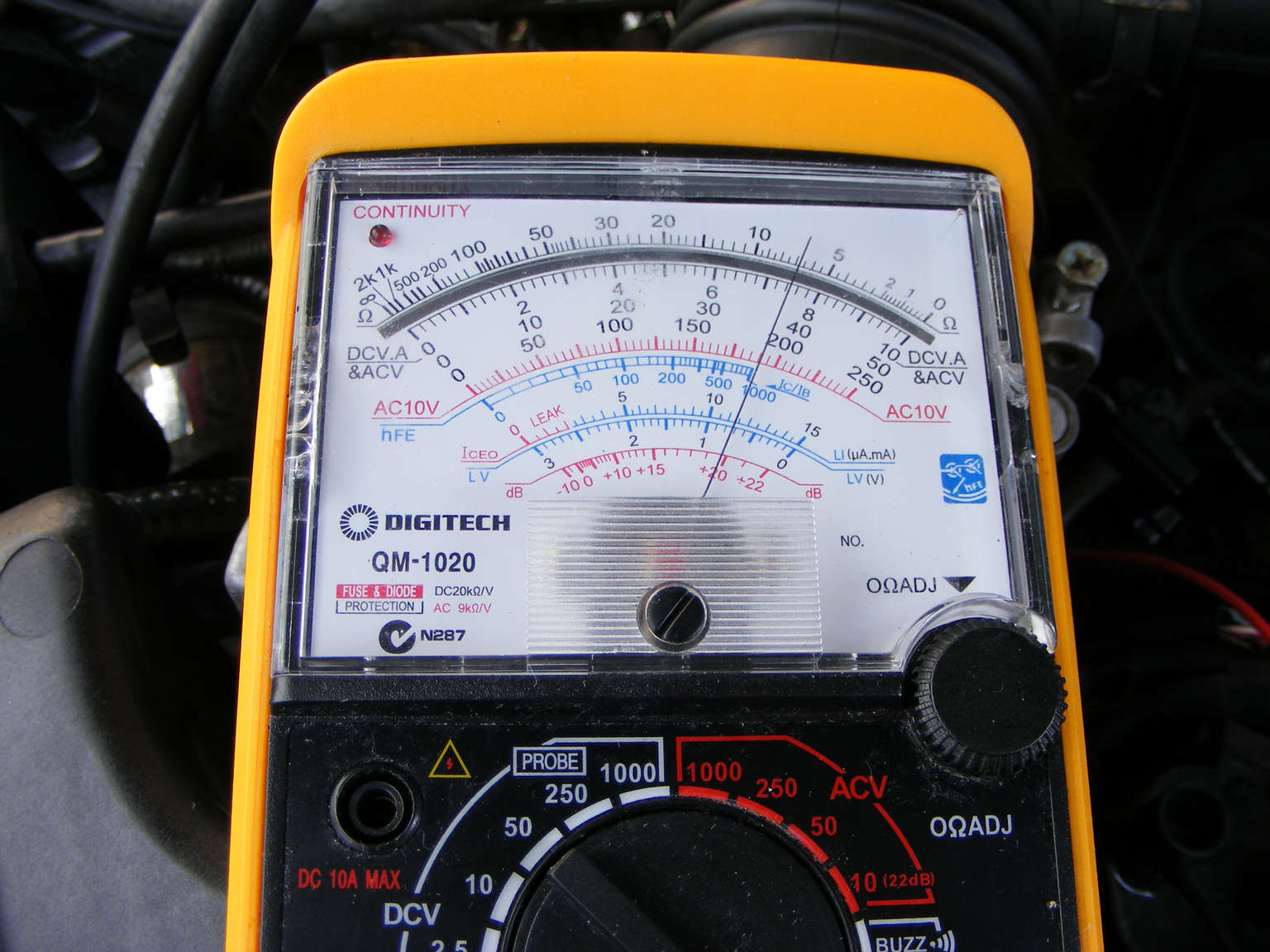

Ignition coil is within spec according to my DMM.
0.3 ohms on the primary winding side (factory specs are 0.2-0.3 ohms)
8.54k ohms on the secondary. (factory specs are 6-13k ohms)
Cleaned the insulating tower and got a lot of gunk/dust buildup out of it as can be seen from the evidence left on the Q-Tip.
Inspected the throttle position sensor but I didn't do the test properly (engine needs to be running or I need to produce a source of vacuum to do the test properly). I just inspected it for any dead spots with an analog and digital multimeter, none were found, and all measurements were within tolerance of what it says on the specs sheet. No "jitteryness" was found either, readings were smooth as butter.
Fuel pump replacement time?

Hokay what did we learn today.
Service manual says the fuel pump resistance should measure between 0.2 and 3.0 ohms.
Fuel pump actual reading is 2.5 ohms.
Also done a current draw test on the fuel pump with (A Destructive test >>>a bucket of water<<< A Destructive test) and a small SLA battery. Made the connection on the battery side and used my good alligator clip leads.
Maximum Current draw when the output of the fuel pump was pinched with a pair of pliers, no leaks, was 5.6 amps.
Free running on air current draw was 1.0 amps.
I think this fuel pump is rated for 6 amps maximum but I'm not 100% sure.
What does this information tell us?
Well the high resistance reading tells me that the fuel pump's brushes are probably worn.
But the high amperage draw when the output was blocked off with a pair of pliers tells me that the fuel pump is okay and is capable of producing a large amount of pressure.
But if the brushes are on their last legs then it COULD conceivably produce the problem symptom which I have which is that the car misfires suddenly and randomly or whenever the engine is under a heavy load ie going up a hill. if the commutator brushes aren't making contact all of the time then I can see them making an intermittent fuel delivery problem and that is exactly what I'm experiencing.

I'm convinced now that the problem is the IAC booster hose leaking. its cracked on one end of the hose.
.... What does this information tell us? Well the high resistance reading tells me that the fuel pump's brushes are probably worn.
If the conductive path is through the carbon brush, doesn't it suggest that the brush is not worn down or the high resistance is elsewhere? i.e. short brush should be less resistance, since there is less material to resist?
Assuming a DMM is trustworthy at measuring these very low resistances. I don't know the answer to that.
