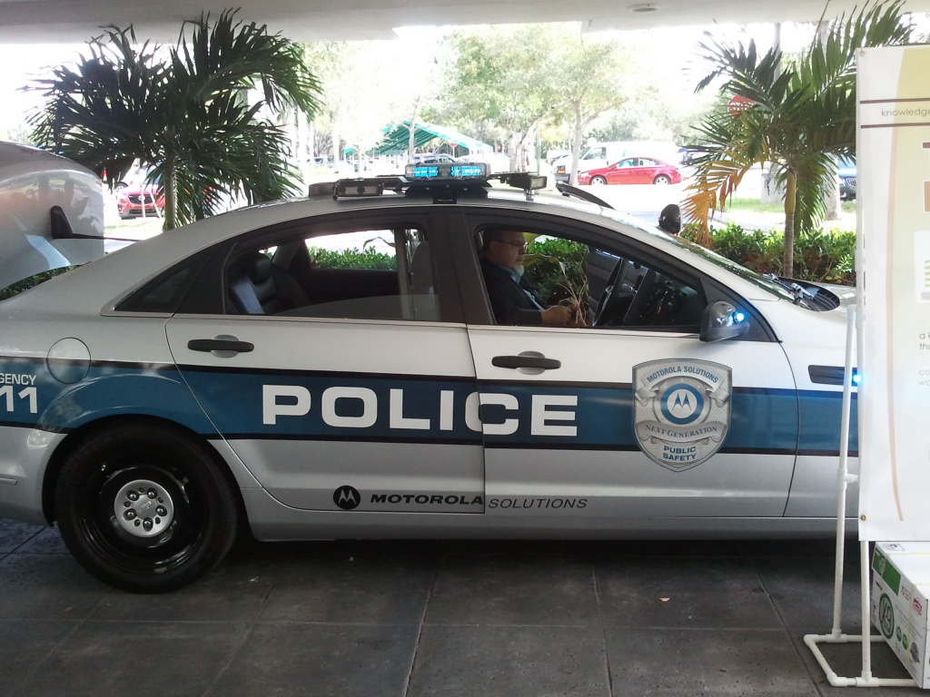

Probably not unlike this one. The GTO (Monaro) and the G8 (Commodore) died with the Pontiac brand, but that didn't stop GM from making a few bucks.
This is the Motorola Cop Car, a modified Holden Commodore wearing Chevrolet badges and sold "only to fleet buyers" usually in police trim. Some were sold as "Chevrolet SS" to enthusiasts in an attempt to get the body style qualified for Nascar. I don't know if you can still get them.
This car was custom built as a rolling police technology showcase. There are all sorts of police type gizmos from a gun dispenser that will unlock the shotgun into the officer's hand but not allow anyone else to take it, to the latest radio tech, to the "big brother" machine (last picture).
The officer just needs to drive the car. Big Brother automatically scans every license plate in visibility and runs them through NCIC and other agency databases for "wants and warrants." Show it a DL or other form of ID from the in car camera and it will run those too.
I had a "discussion" with the guy driving the car about Chevrolet's lack of RWD for cop use. I was assured that it was indeed RWD and then offered a ride as proof. Astonished at the car's potential we opened the hood to reveal the 6.0L aluminum Escalade motor......The old saying from the 60's is still true........you can outrun the cop car, but you can't outrun Motorola.

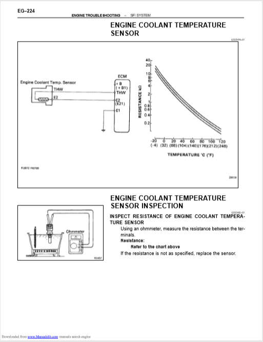

EDIT: AHA! EUREKA!
The engine coolant water temperature sensor is out of specification!!!
Its reading 3.0k ohms when in fact it should be within 1.48k - 1.58 k ohms! (When tested at 80c, I did warm the car up earlier.)
Which means, if the computer thinks the car is still trying to warm up it will continue to dump fuel into the engine to warm it up. THIS IS WHAT THE PREVIOUS OWNER WAS COVERING UP with the butchered and hollowed out thermostat!!!
I think I've found my problem folks!!!
A faulty coolant temperature sensor!
And my problem appeared at about just the same time that I replaced the thermostat and did the big 3 wiring upgrade...
I can't be 100% sure it is the coolant temp sensor but it looks like it might be it. I was wondering to myself why the car was taking a while to warm up according to the thermostat reading inside of the car when I was running it today.
I'll pull the sensor out tomorrow and do a test on it.
Irrelevant to the test data as this engine has two temperature sensors, one for the thermostat on the dash which is located up on the intake maniifold and one for the EFI computer/ECU which is located down on the thermostat housing.
So what did we learn today? Well a reading of 3.0k Ohms on a Engine Coolant Temperature sensor is a bad thing because these sensors are NTC type and therefore reduce in resistance as the temperature rises. But the engine is all warmed up and has been running for a while and the coolant is at least 40 degrees centigrade. So why is the 3.0k Ohm not lower? Because the sensor is faulty.
This makes complete sense too in the sense that the computer is dumping fuel into the cylinders even though the engine is warm.

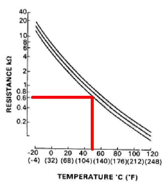

I've confirmed my findings this afternoon. The engine coolant temperature sensor is DEFINITLEY faulty.
It is reading with the ohm meter at 2.955 kOhms when the engine coolant housing is sitting at 47-50 degrees centigrade. As measured with my awesome little multimeter.
According to the charts below the ECT sensor should be measuring 0.6 kOhms.

I now suspect the rear bank O2 sensor. Today I'm going to go and confirm my findings by testing both as indicated by the service manual.
Its possible that it could've unplugged or the wire could've broken when I was back there working on the rear bank and moving things around.
Today/Yesterday I unplugged the rear bank injector connector on cylinder #1 and nothing changed in the tone of the engine. Not entirely sure what that means. But I did the same to the 3 front injectors and the engine tone changed/engine almost conked out.
It might be possible that the front bank O2 sensor is faulty. Who knows.
